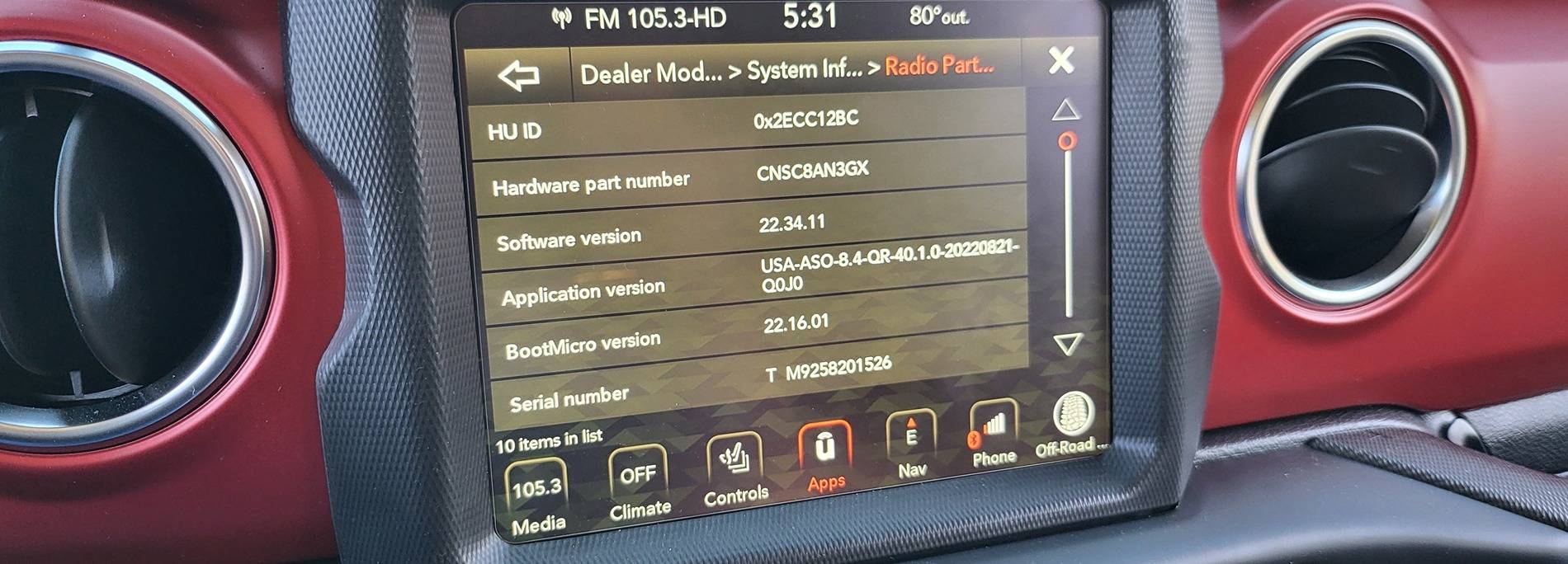

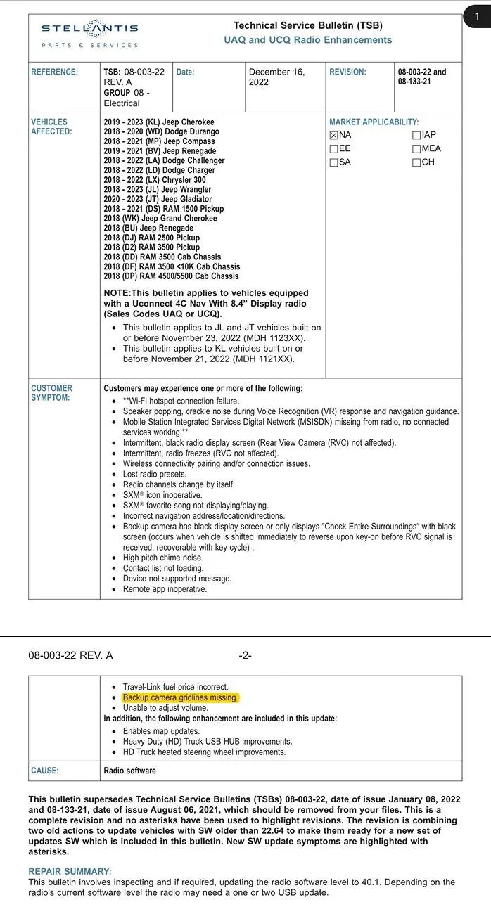

So here is something I found rather promising.
Fits the year, model range and one of the indication which is the "backup gridline missing". Repair summary states the solution is to update to Version 40.1.
I will report back tomorrow after the update. Keeping my fingers crossed.
I hope it works for you. Our 392 is on 40.1 but still has the intermittent, black radio display (Rear View Camera (RVC) not affected) issue.

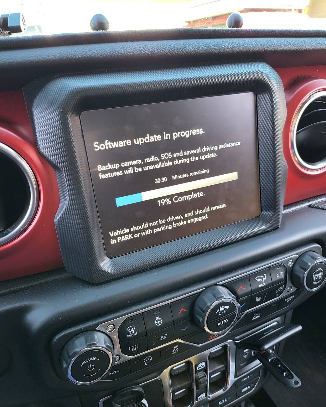

Just started the update process...
Jeep Gladiator Mopar Trail Cam DIY Installation - 2023 Diesel Gladiator Rubicon 1000011430
Keeping fingers crossed but shall see.

WTF.. updated fine without any errors. I will give it time till tomorrow.

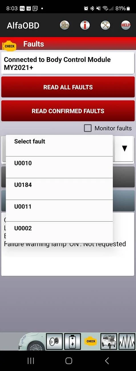

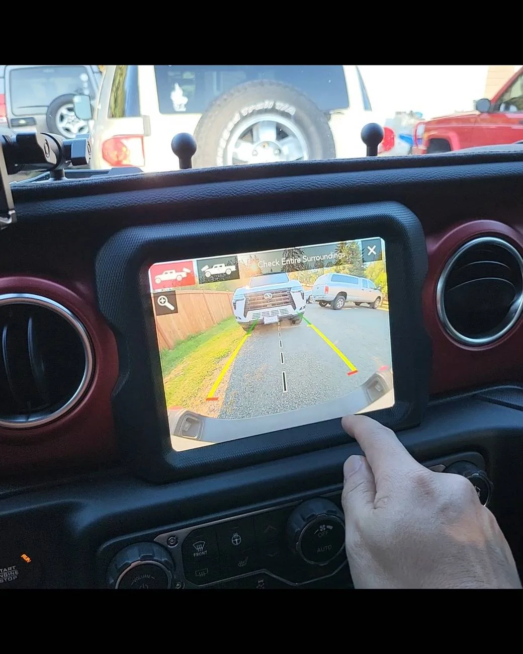

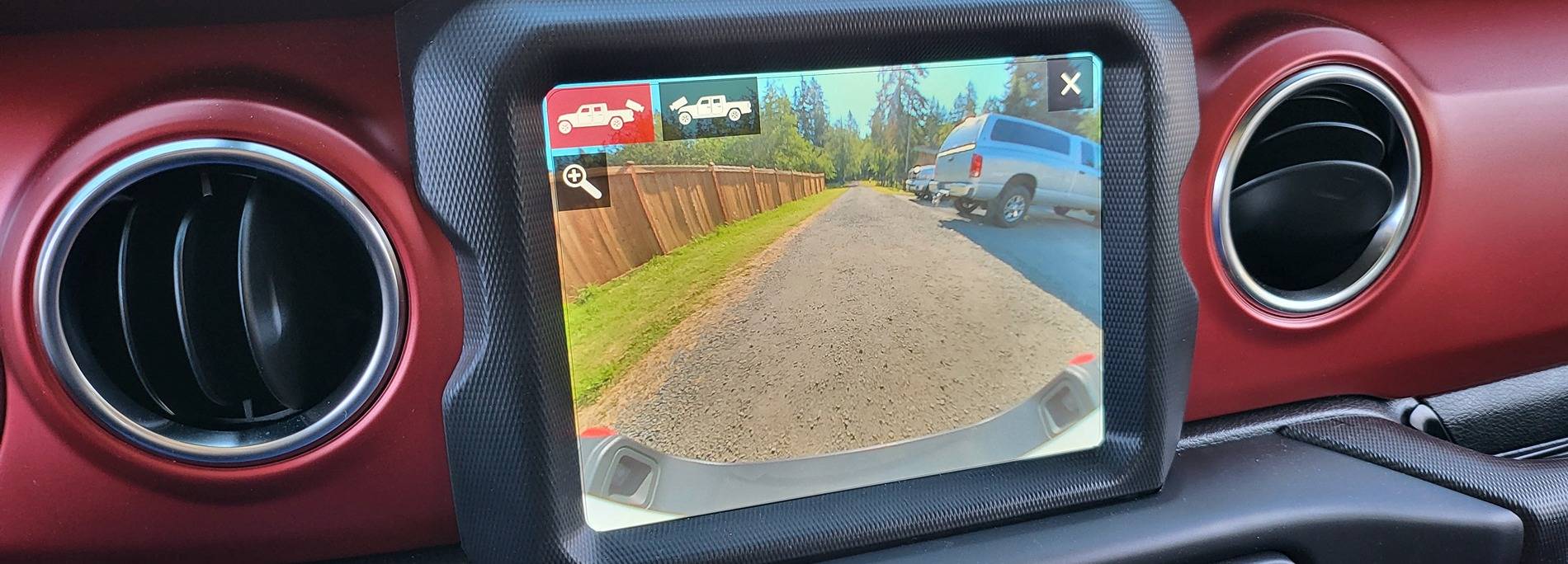

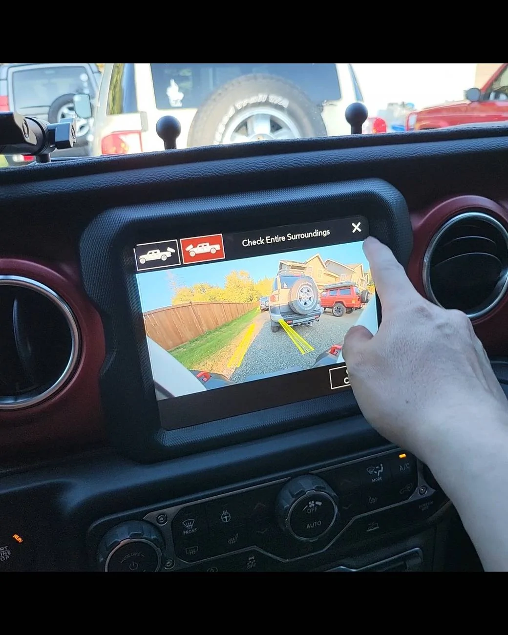

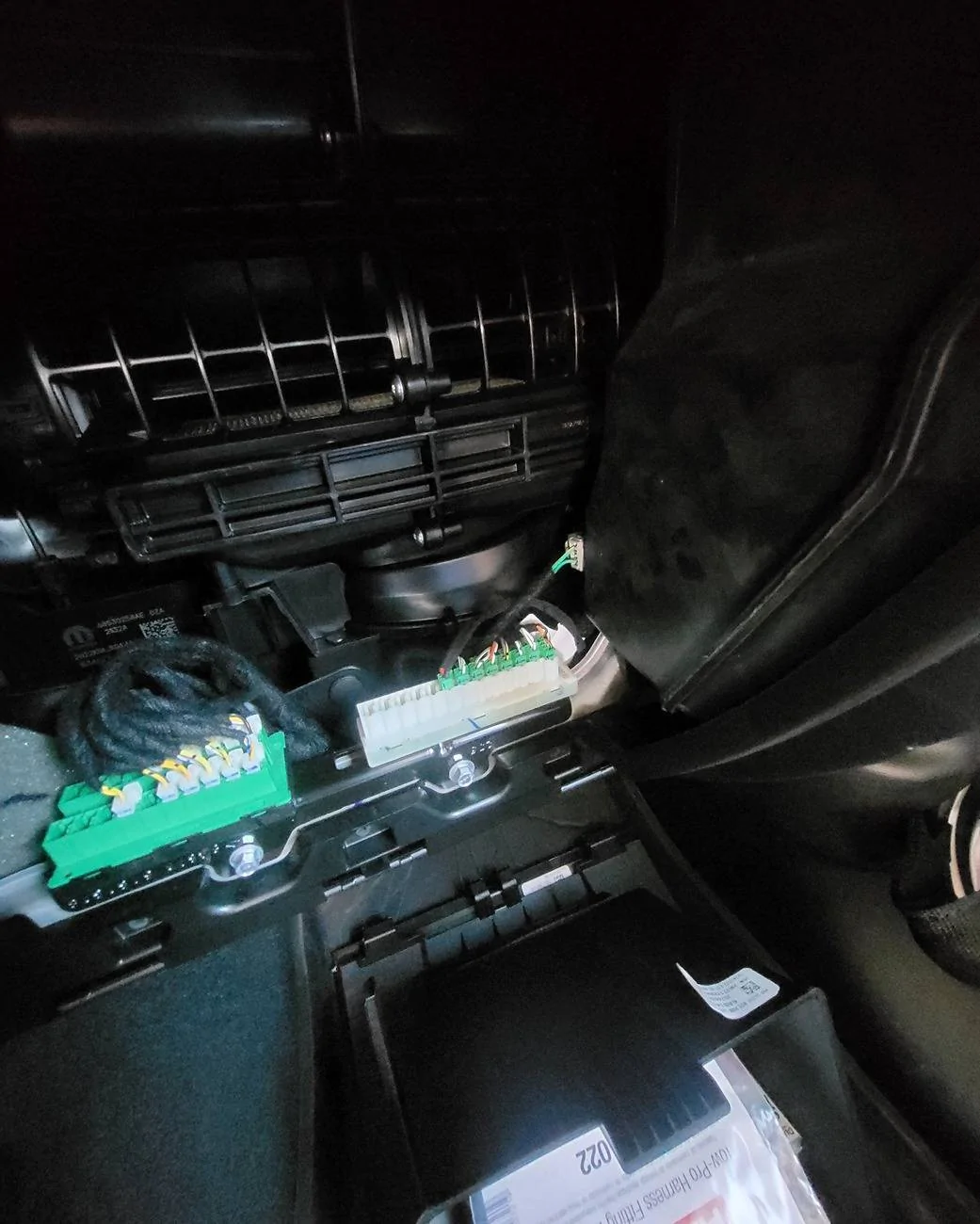

As I was chasing this intermittent TrailCam/Parking guideline issue. I finally decided to plug in the AlphaOBD.
Jeep Gladiator Mopar Trail Cam DIY Installation - 2023 Diesel Gladiator Rubicon 1000011441
Then cleared the codes but upon restart U0010 remained.
While engine running, I tried disconnect power to CVPM and see if power cycle will reset but no luck.
Jeep Gladiator Mopar Trail Cam DIY Installation - 2023 Diesel Gladiator Rubicon 1000011466
Then I decides to check CAN IHS bus connection for the CVPM. I pulled on the connector and it just pulled out without any resistance. These supposed to positively lock and not pull out that easy. When I reseated, it clicked in and would no longer pull out. As soon as I did that the TrailCam and reverse cam with guideline appeared immediately when selected.
Jeep Gladiator Mopar Trail Cam DIY Installation - 2023 Diesel Gladiator Rubicon 1000011476
Jeep Gladiator Mopar Trail Cam DIY Installation - 2023 Diesel Gladiator Rubicon 1000011478
Happy to report this seems like just a fluke of my installation where the CAN bus connector not being seated properly.

7/13/2024 Morning after the firmware upgrade was ineffective, but reseating CAN IHS connector for CVPM at the bus fixed the problem. The data cable was not seated all the way causing intermittent connection. Interesting how the rear cam still worked. USB update for Uconnect added.
7/12/2024 Unconnect has been successfully updated to V 40.1 but parking guide lines are still missing and the trail cam is still inaccessible. We will see how it is the morning after.
7/11/2024 Uconnect controls the video display: Previous Park Gridline Issue TO BE resolved with UConnect update to v40.1 per a TSB.

Here is the underseat module being accessed from below the seat as deployed.
The protective cover
