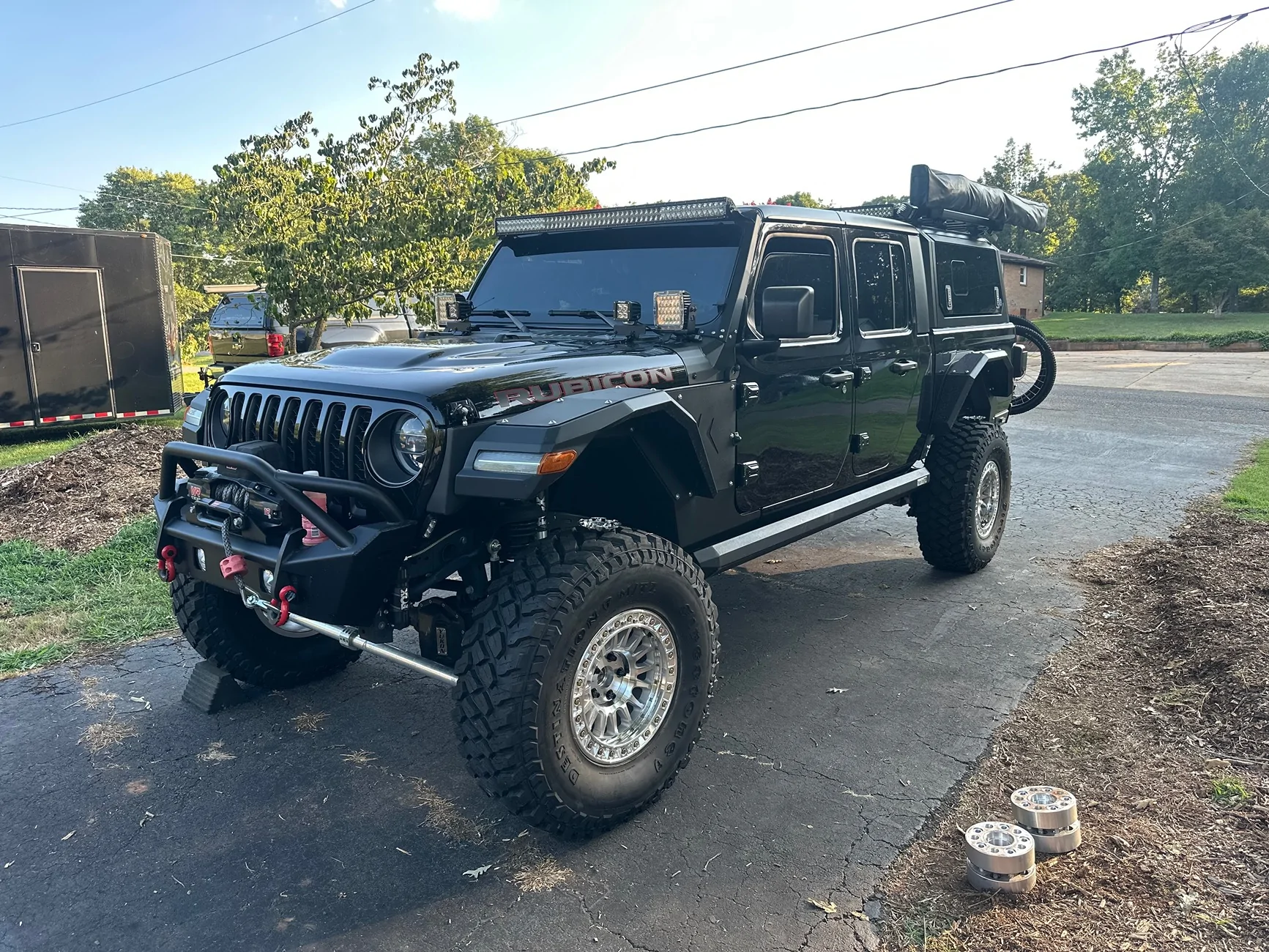

I’m running Fox reservoirs. They are pretty good. Handle my weight in the back well. It’s not too soft imo
