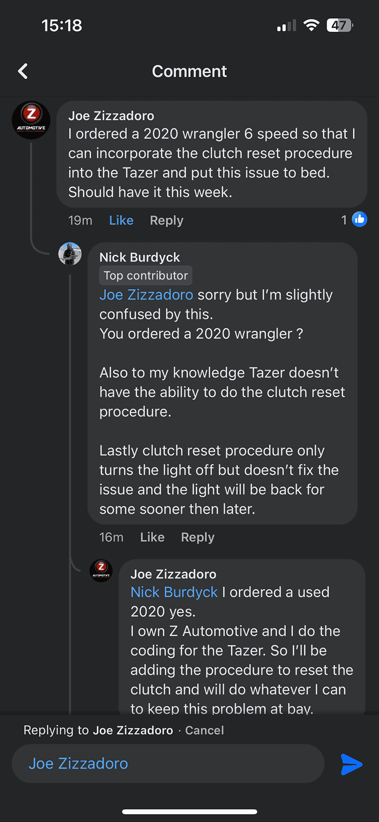

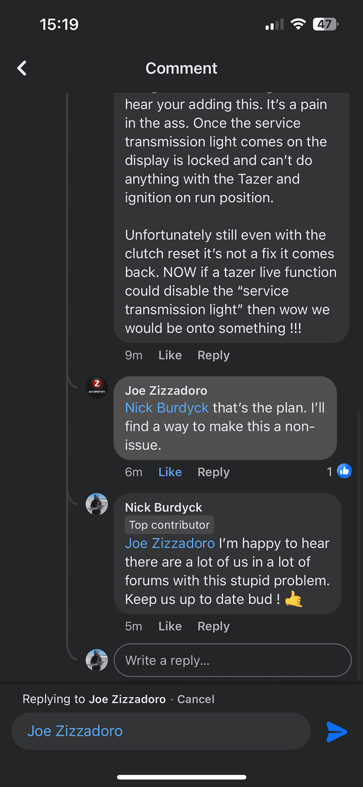

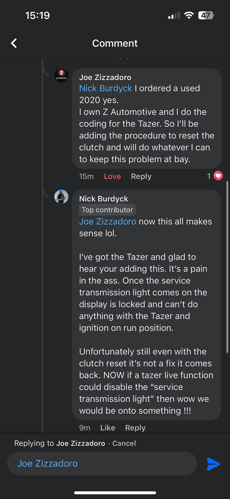

Todays update :
my service light come on still anywhere from 1 mile to 100 miles between resets.
always seems to be taking off from a stop in first.
Today 2 times I’ve had it reset with out using JScan….
Both time I started the Jeep and shifted into reverse almost immediately to back up.
After reversing I shifted into first and the service light was not on. Please note I have park sense so shifting into reverse turns on the park sense in the display. No idea if this does something strange with the code or not. But it’s worth a try and I’ll keep messing with it.
Lastly see attached. On Facebook ended up talking with owner of Tazer. He has a 6speed wrangler and is going figure out what his product can do to shut this light off for himself and us. So stay tuned!
Attached is the conversation. Cheers ?
