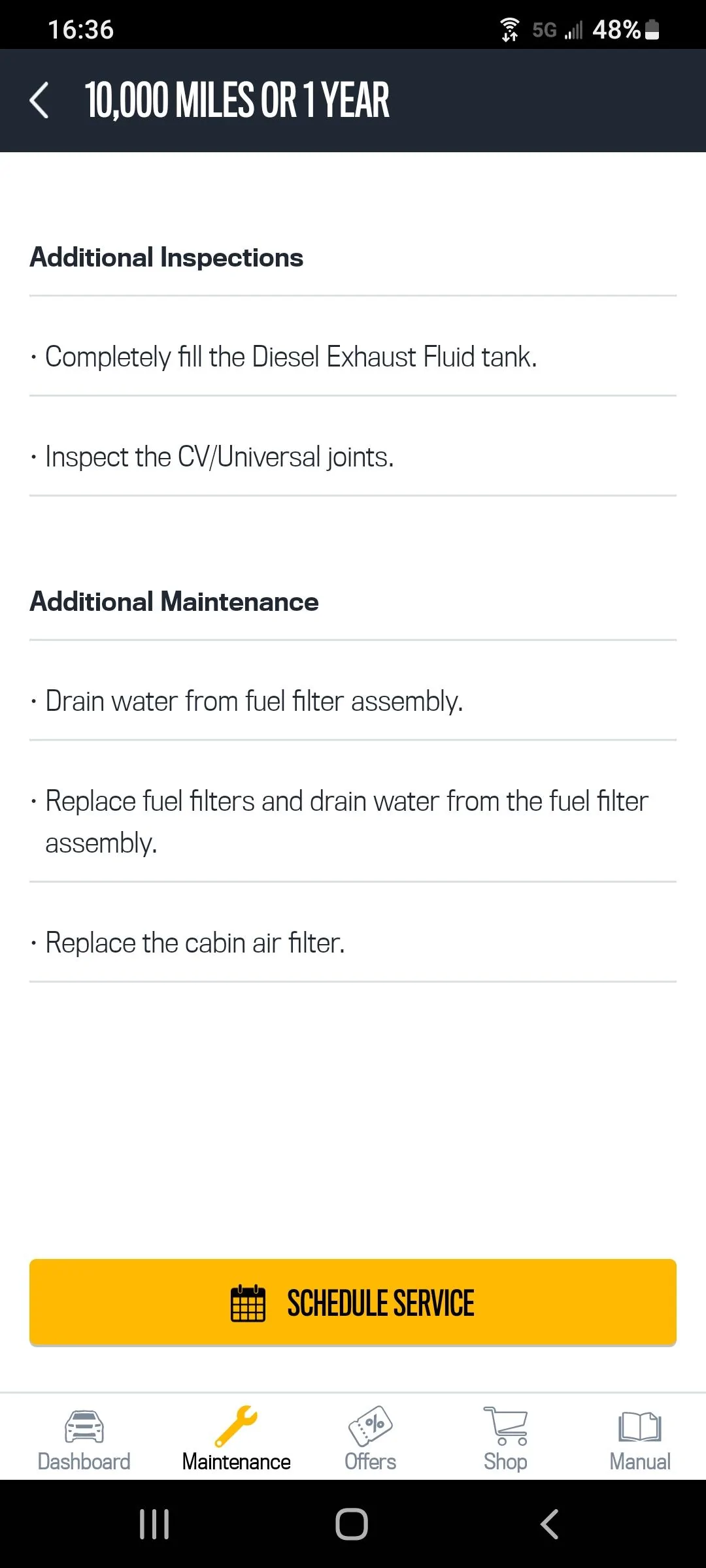

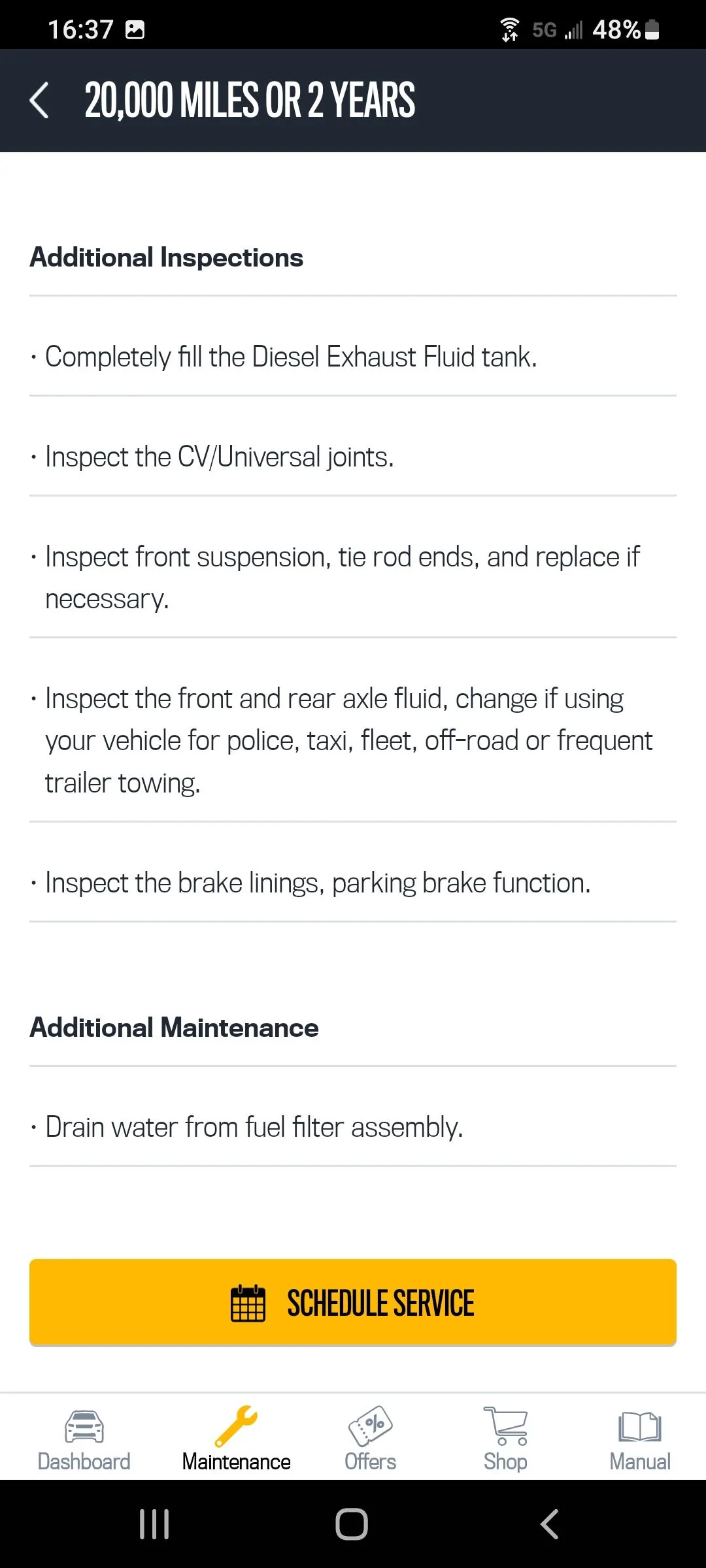

Gotcha.... I was getting my info from the dashboard on the Jeep/Mopar app. It says 10k and mentions nothing about replacing for the 20k service.
I really need to look at this fuel filter interval because it’s an expensive part of the service.
My selling dealer gives one free oil change and tire rotation, aside from my free Jeep Wave maintenance benefits, which I’m getting this week at around 8k miles before heading out on another road trip.
So maybe I won’t be getting off totally free if get the right stuff done? I know damn well they’re not gonna give me a free fuel filter. Or, at least, I’ll be stunned if they do.
