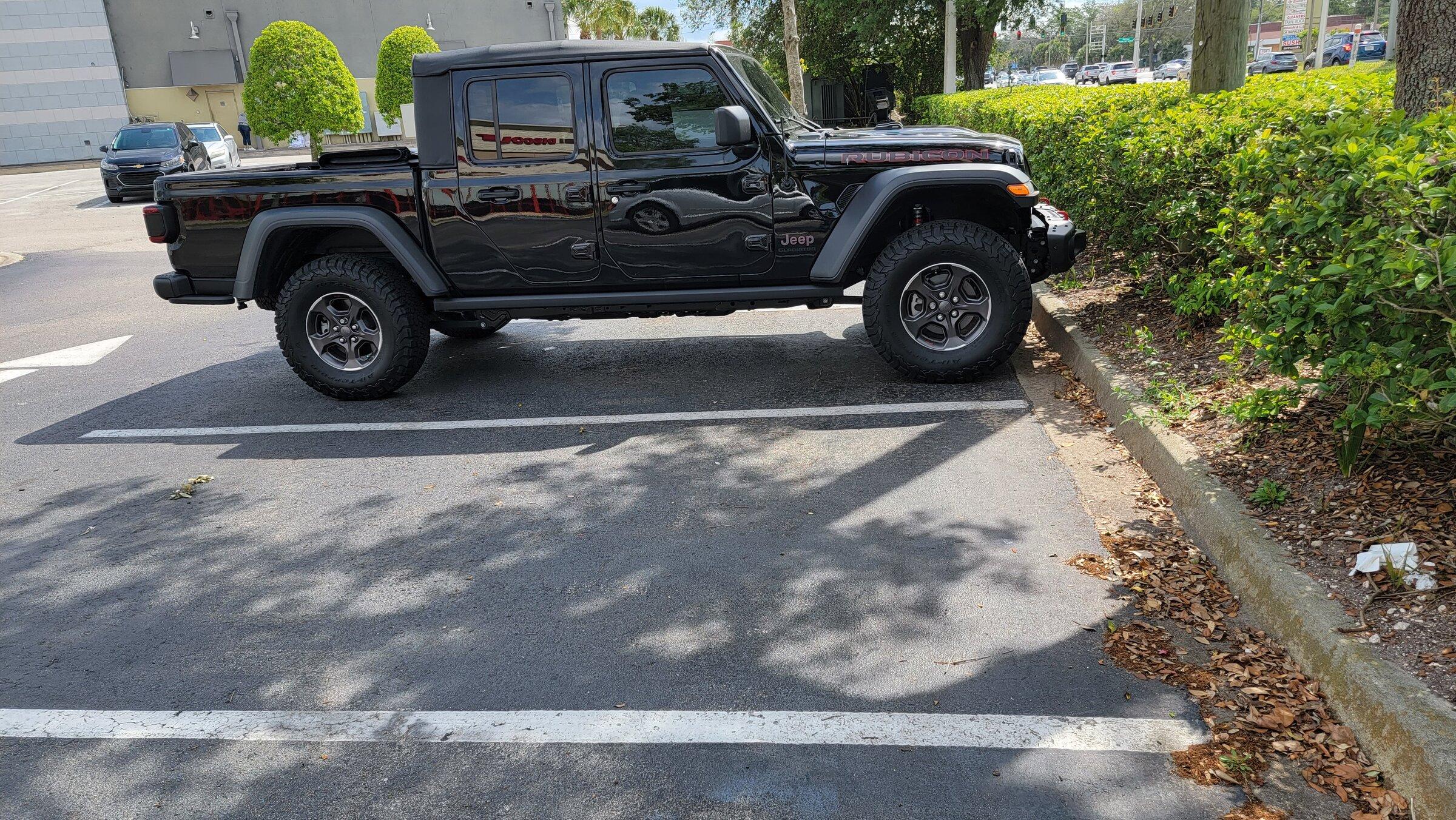

35/12.5/17 KO2'S WITH TERAFLEX LEVELING KIT.

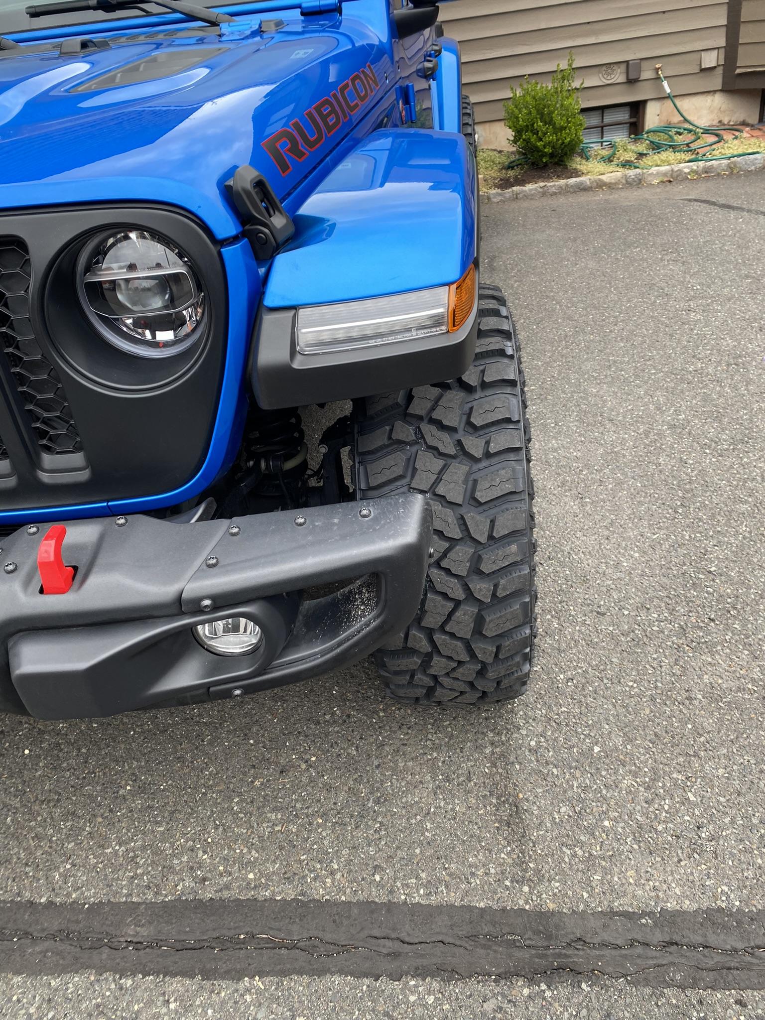

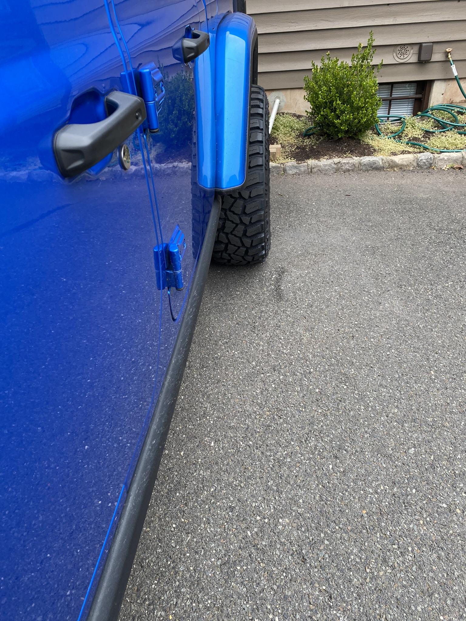

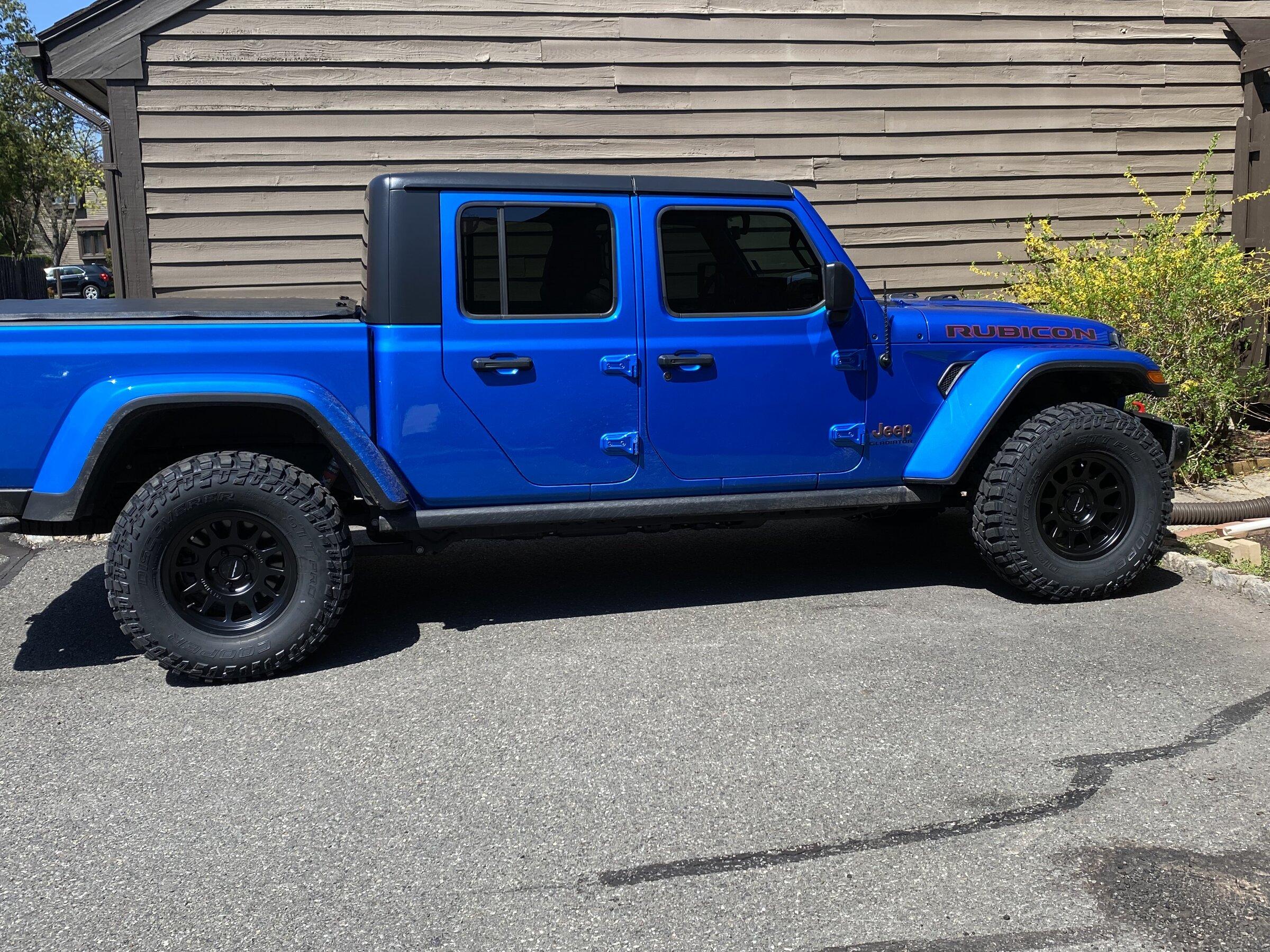

315 70 17 Cooper STT Pro
Method 703 0 offset
No lift no rubbing plenty of room in the wheel wells.
Do you have a side view to see the overhang?

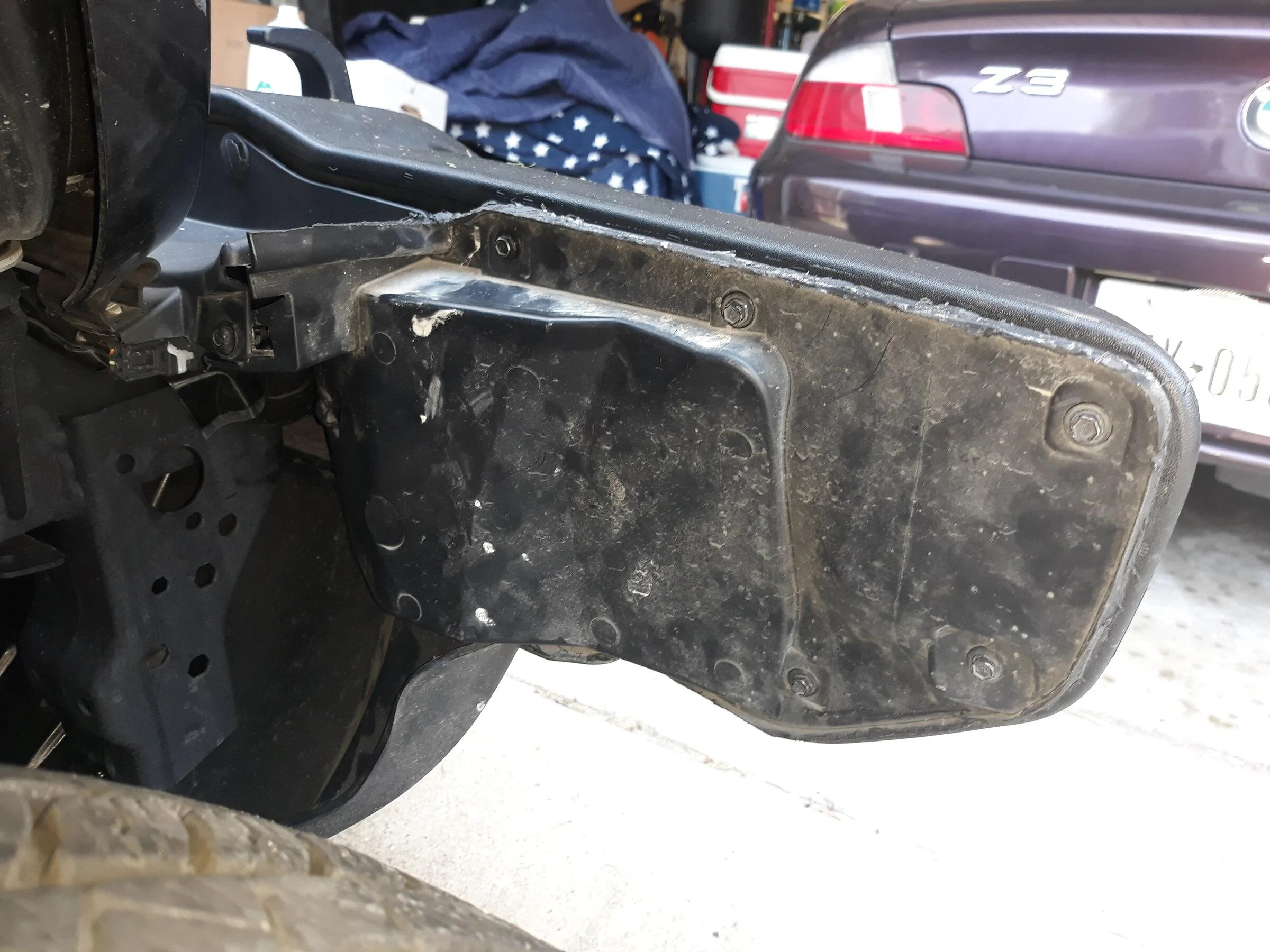

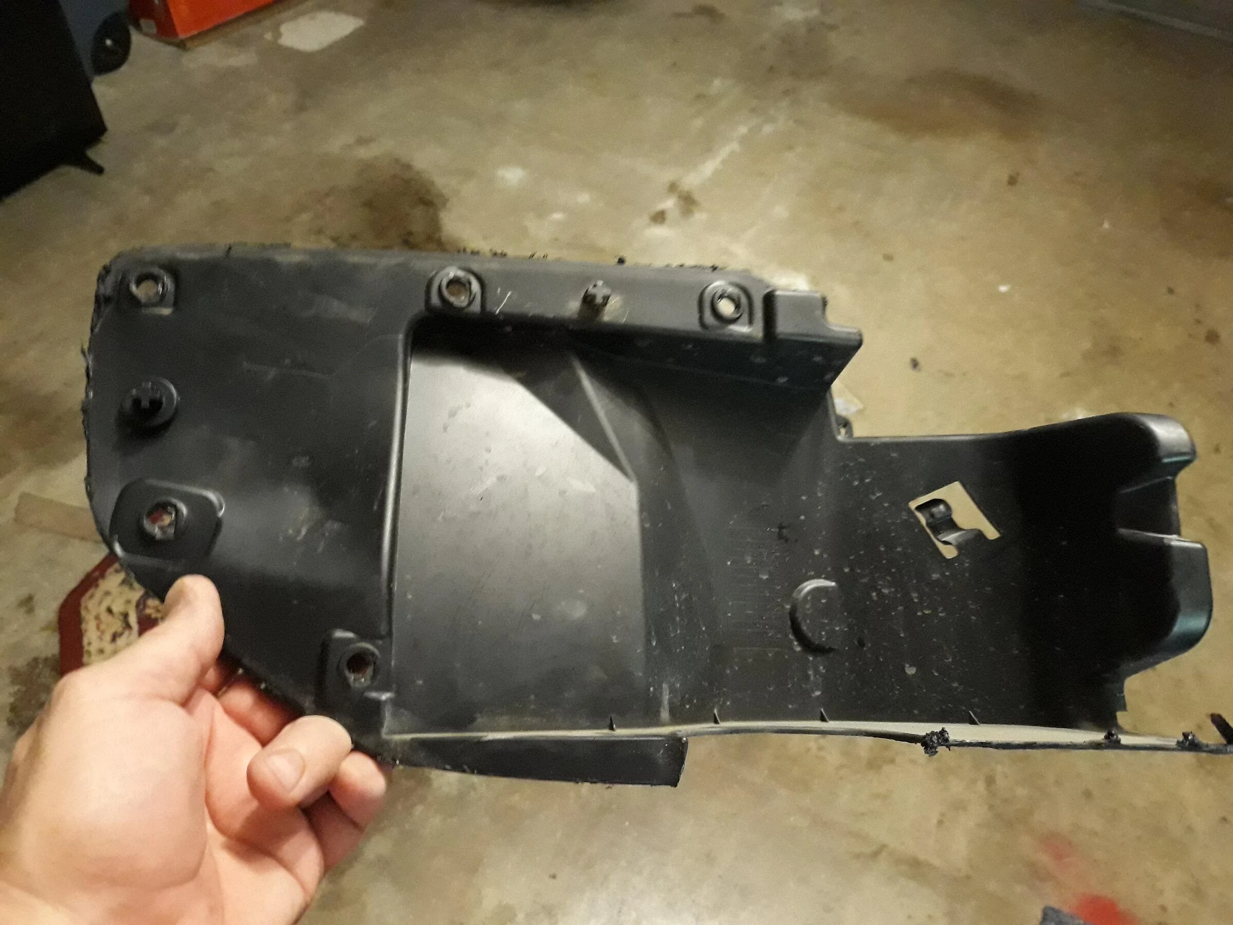

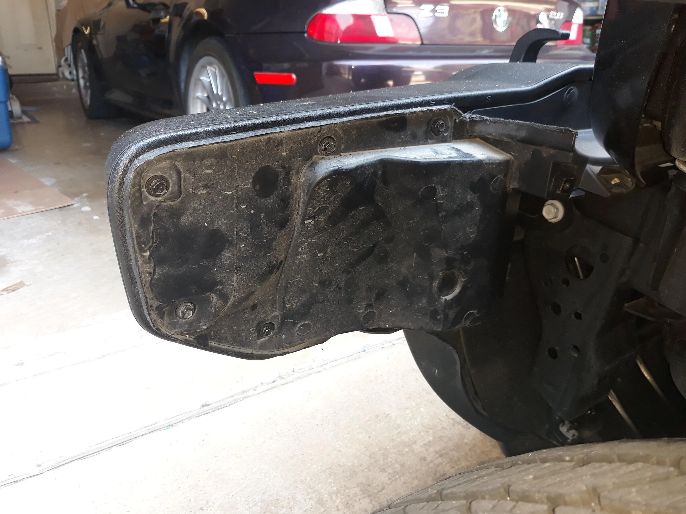

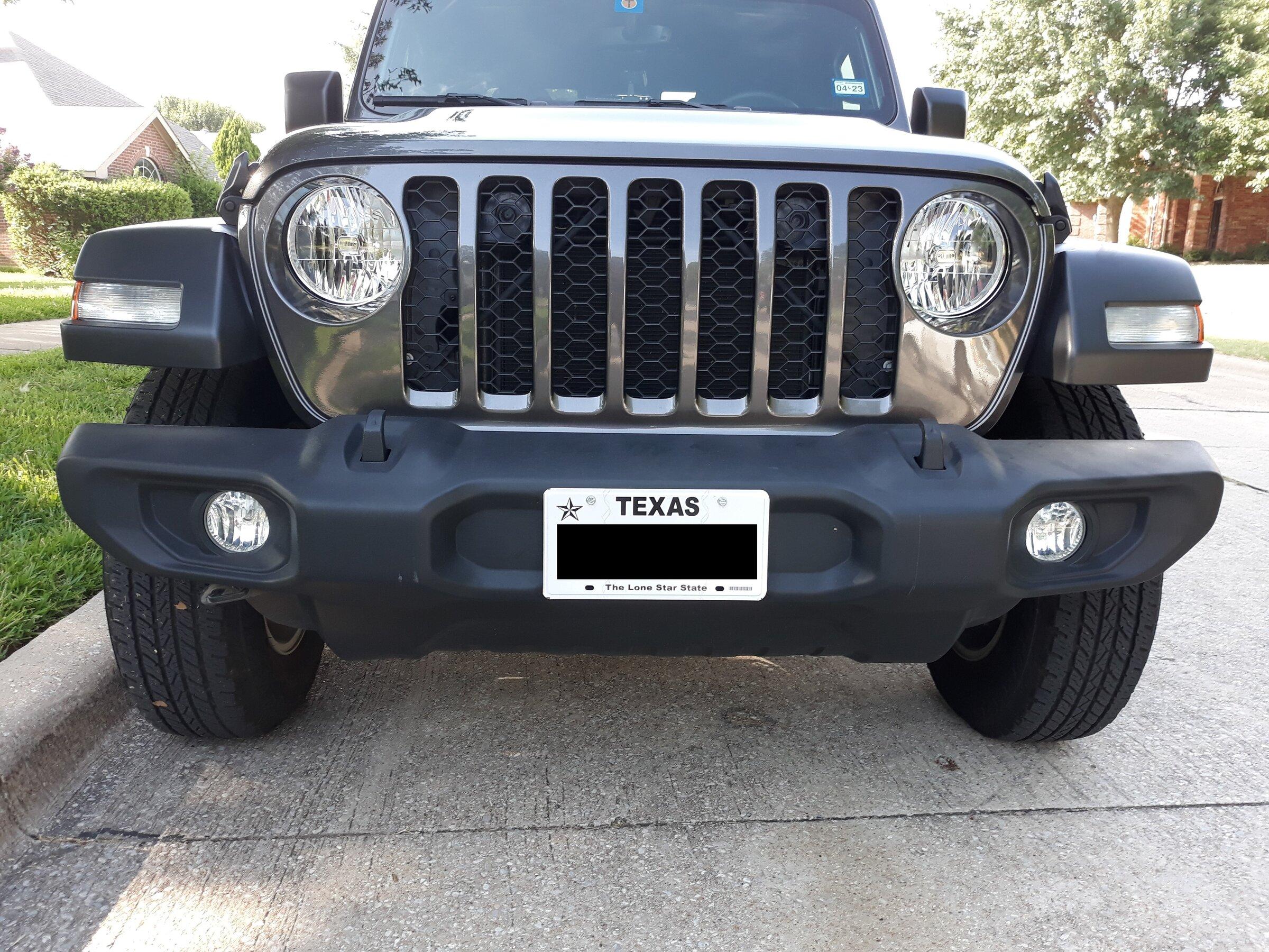

I have a 22 Sport S with no air dams.
The base sport still comes with them tho. I originally ordered a base sport, but had the dealer cancel it and ordered a Sport S with more options. Jeep still sent the dealer the canceled base model and it came with the air dams.
Don't fret about the air dams. They come out easy enough, there are a bunch of screws and push pin-thingies but they will come out, then if you're handy with a Dremel, you can trim the floodlight covers and really do it up right.

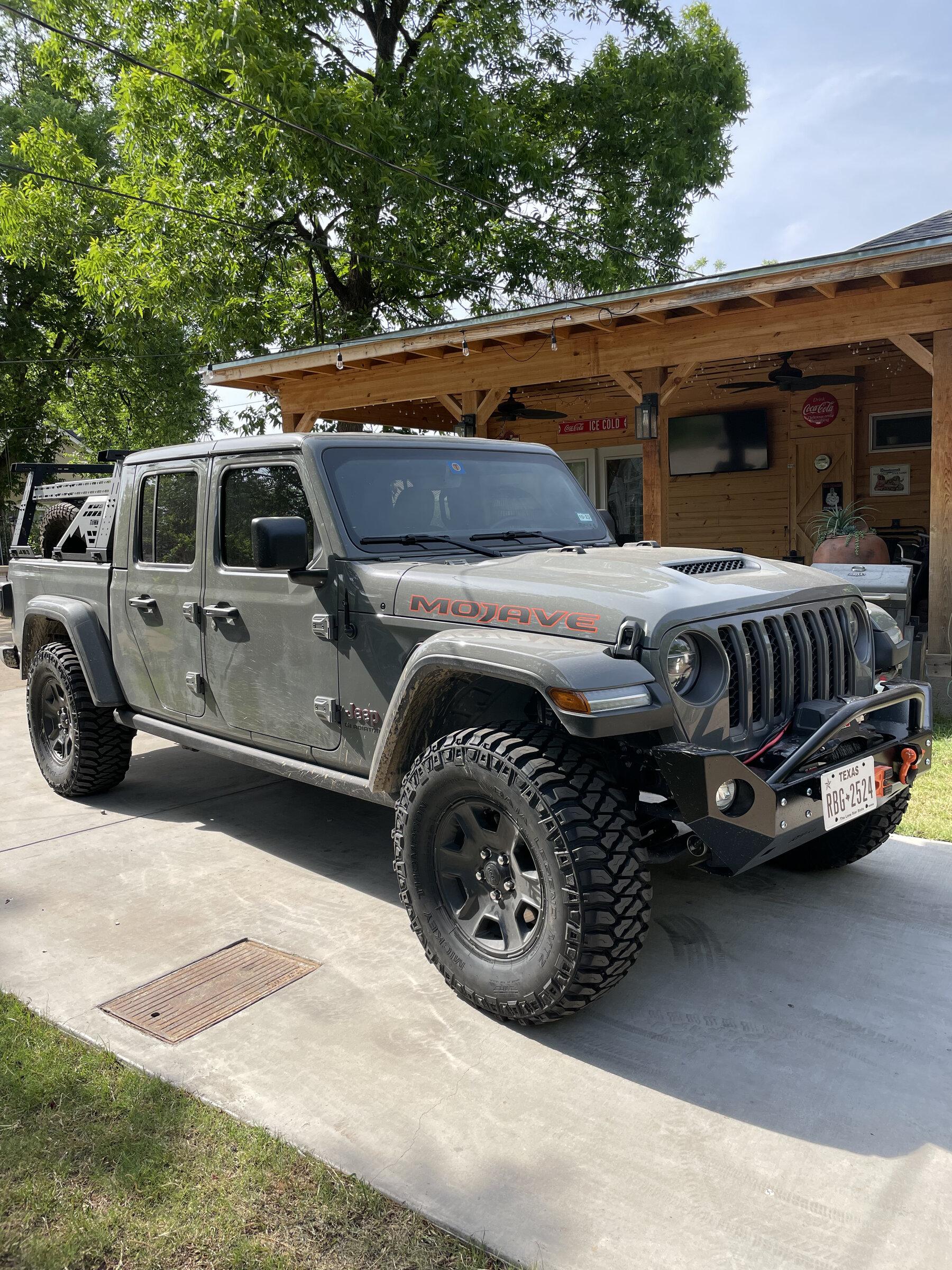

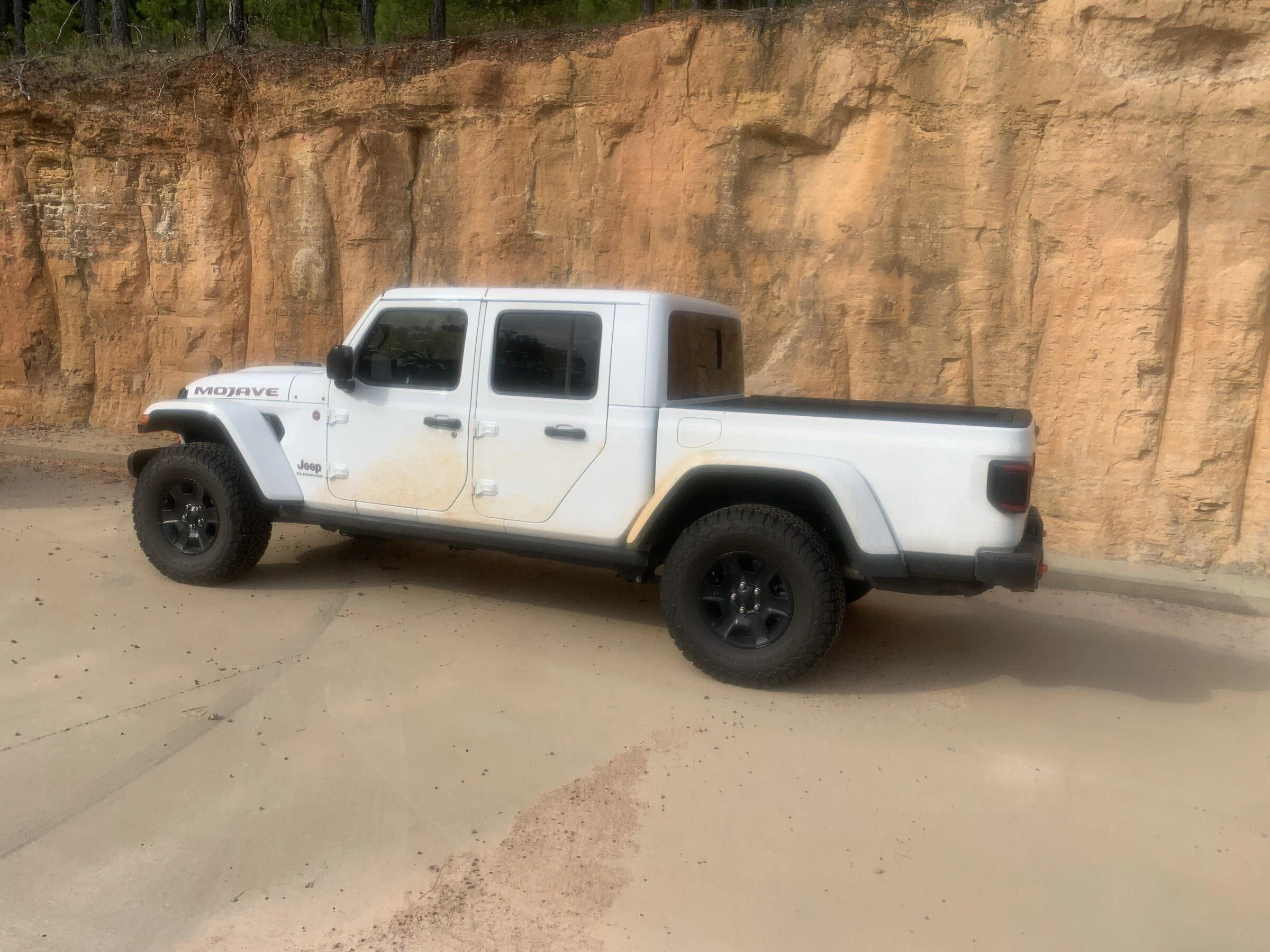

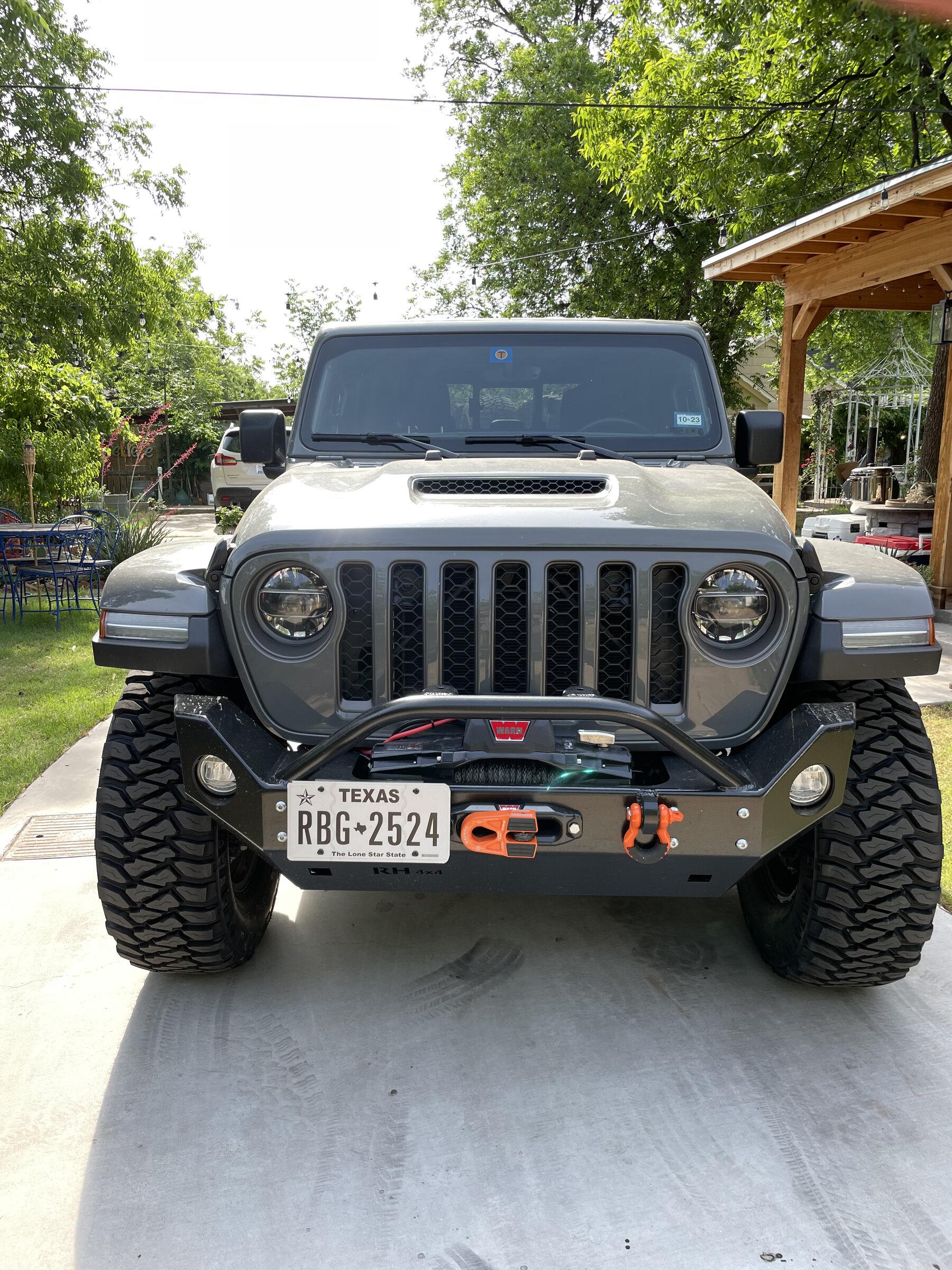

Here’s mine…35x12.5x17 on the stock Mojave rims…no lift…

Thanks. I think I can skate by in New Mexico with that slight overhang. With zero offset, full articulation, especially with the Mopar 2" lift should be no problem.
