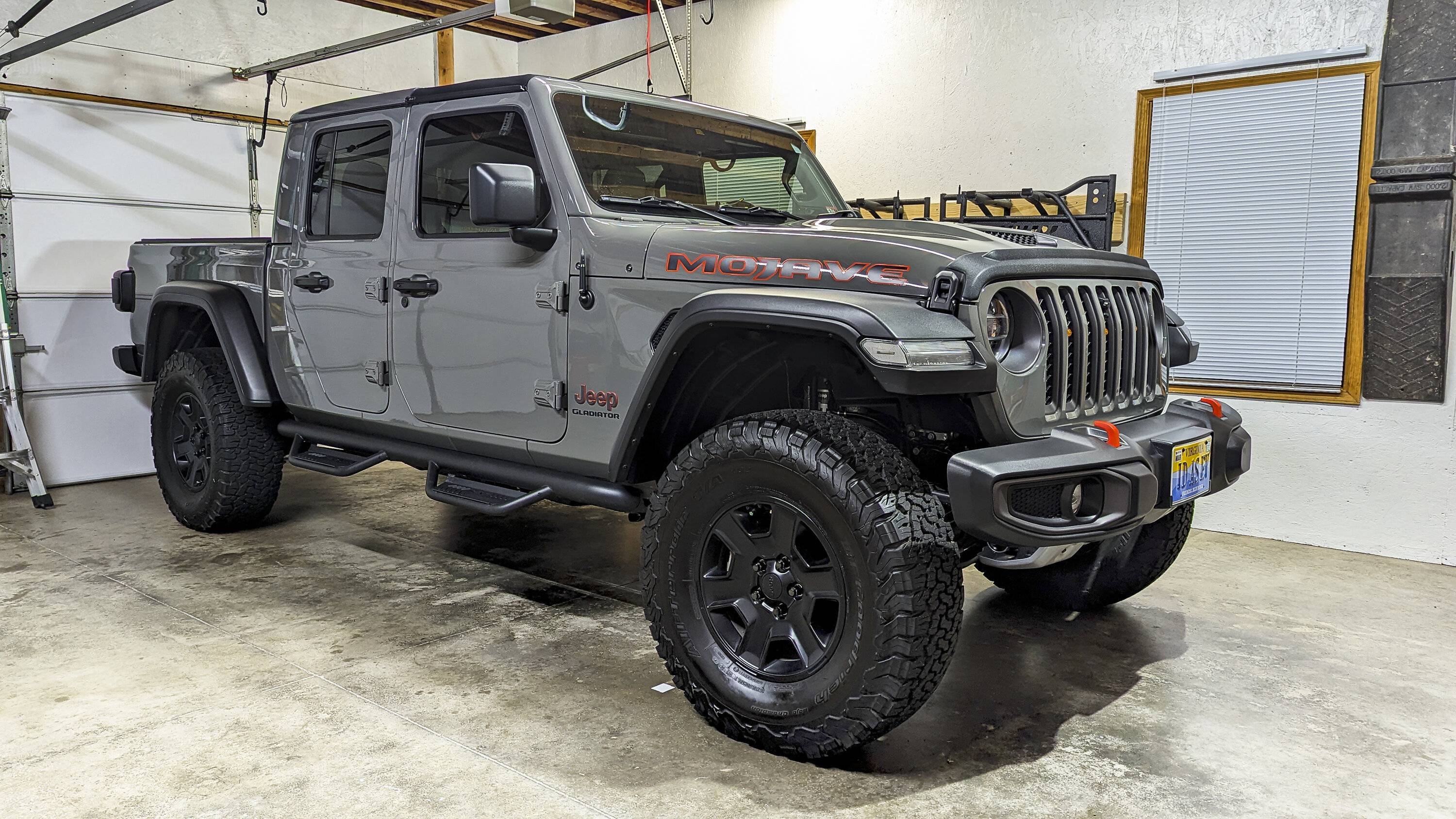

Am planning to also go with 35s if I can keep the weight the same or less. The factory wildpeaks work great, but they seem pretty heavy to me. For your KO2s I’m seeing mixed specs online, what’s your finished tire/wheel weight, are you close to 93lbs?
for reference, on my wife’s HA ( meant for a different purpose ), the combined finished weight is closer to 70lbs. That 20lbs difference, per corner, is a HUGE difference.

When I had stock wheels on mine and 315 70 17 K02's my combined weight was 88lbs total. The wheel is 26lbs and the the K02's weight was 62lbs a tire in the E rated tire.
I was only at 98lbs with 37 12.5 17 Kanati Trail hogs and stock wheels. The Kanati's weigh 72lbs a piece.
So far, the Toyo’s are the only ones that I’ve seen where you could switch from the Wildpeaks, go up to 35s, and still be only 1lb or 2 off of stock ( with C or D rating of course)

Never saw a light Toyo at all so I'm assuming the wildpeaks a heavy tire. I've ran Toyo's in 35's in the open country and some M/TS and the weight was 69lbs on the open country and 72lbs on the M/T's just tires, that was when I had my JKU. The KO2 and Kanati's are lighter and I think Yokohama Geolanders are lighter as well in a 35. The Kanati's weigh the same as the KO2 in a 35 and the Geolanders A/T is 66lbs.

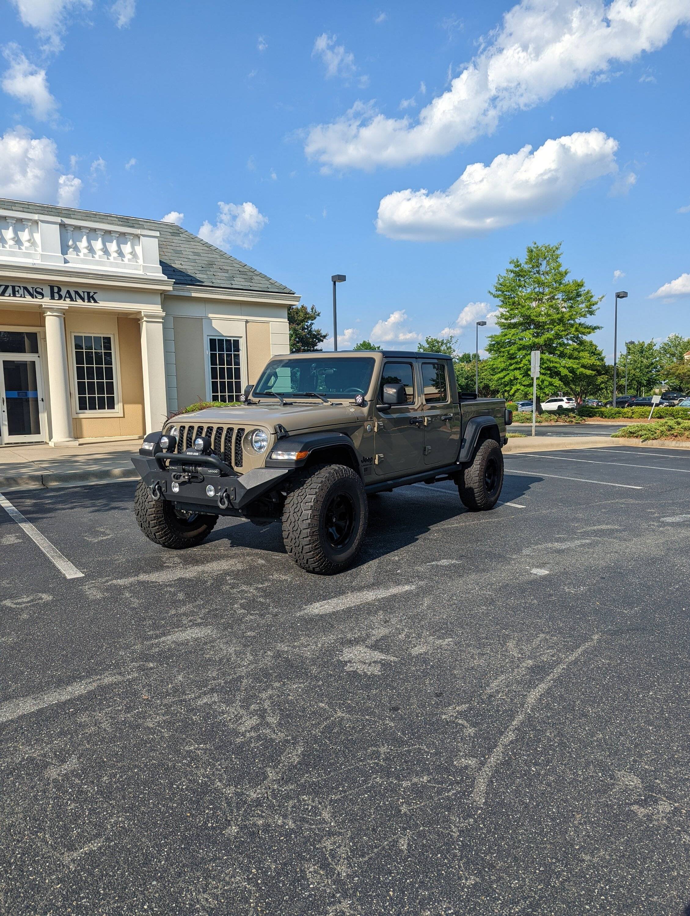

No regear on mine and running 37 12.5 17 Yokohama Geolanders X-AT
Jeep Gladiator 35s, why did I wait so long PXL_20220601_213734217.MP
and I still see 8th and over 17 mpg in mine around 18 to 18.5 on longer trips. About 3-1/4 inches of lift with the Readylift SST 2.5 lift kit and Rubicon takeoffs installed. I went 315 70 17 KO2 second day of owner ship And 15,000 miles in 37's went on. I should of done it from the beginning. This is mine with the Kanati trail hog AT-4 37 12.5 17 on it. I would of went back with those tires but got the Geolanders for $1087 shipped to the house from Walmart back I'm February .Couldn't pass that deal up.
