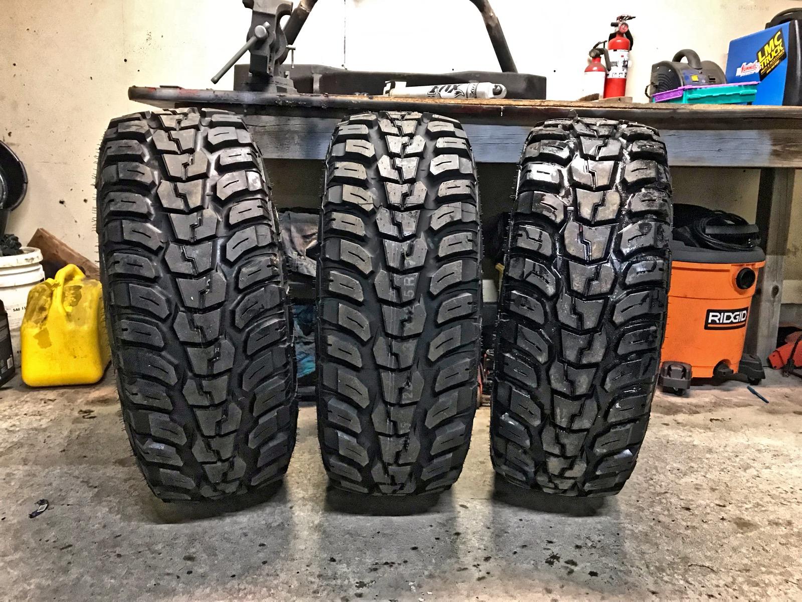

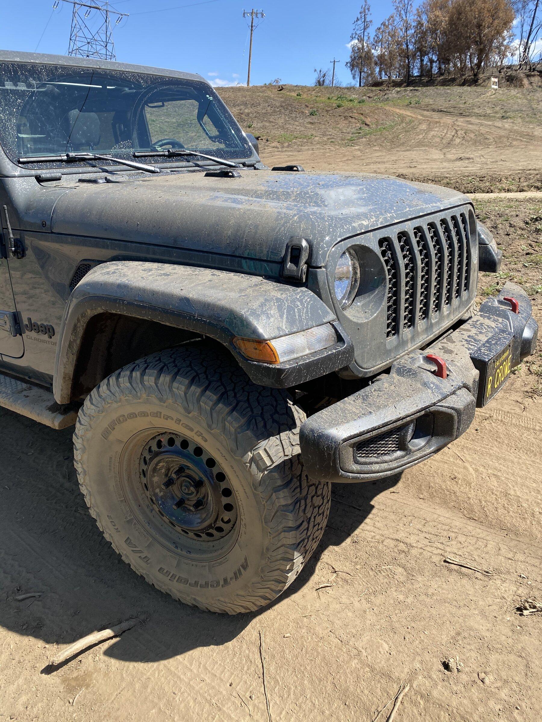

I’ve tried searching through my photos, I’ve personally seen a spacer fail. My good buddy ran them for a short while on his TJ, we just got out of a trail we were on all day and travelling down the highway when the wheel came off
Thankfully we never stopped to reconnect so he never lost control and it was a quiet day so no traffic (a lot of our highways are just 2 lane up here) for the tire to hit
I still prefer a proper back spaced wheel, but will still run a spacer if needed. Just check them after every ride lol
I do have a good comparison picture of the same 35x12.5 on a 10”, 9” and 7.5” wheel
Jeep Gladiator 35x12.50 17 on 7.5 stock wheel 5E393DE9-1D44-4E77-B3DD-0F6CBD9C002F
That's a neat visual comparison!

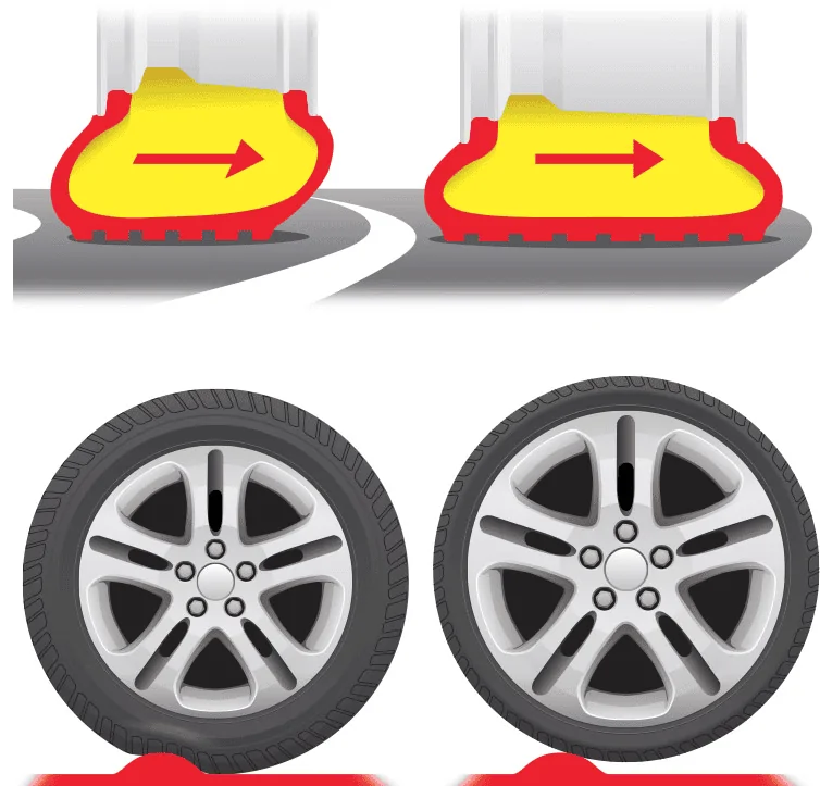

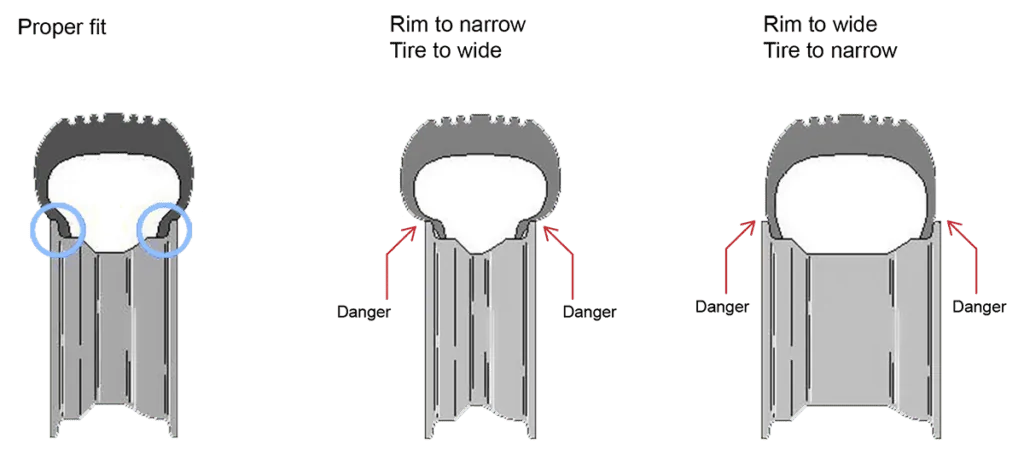

You can do it, you could be fine, but if you aren't fine you won't be happy. The issue is the tire is looking to spread it's inner locking mechanism a certain width to seat properly. If it isnt spread enough it will not be seated properly and more prone to failure. I would say this is more a nono long term than spacers. At least spacers will be held in by loctite, too narrow a rim will open up to poorly seated tires with no remedy like loctite.
The issues can become more pronounced in cornering where the tire is kinda left on it's own with no structure from the rim to guide it.
on a 7.5 or 8 inch rim? I don't think that the bulge at normal operating pressures are that bad. I'd also like to point out that different tires hold/position that weight differently. At least with my 12.5 inch nokians, the contact patch at comparable PSIs is VERY different than the AT3Ws I run in the Summer. The "bulge" between the 12.4 inch tire with the 7.5 inch rim vs my 10.5 inch rim with the 12.5 inch AT3Ws isn't massively different either even with two more inches of rim. I get your point about what is supporting the tire but we aren't talking sedan tires either. These are all reinforced truck tires comparing things relatively. I'd imagine that as long as PSIs are maintained in an optimal range and that tires are rotated properly and don't have massive uneven wear, I just don't feel like there would be a tangible risk. Never say never but is that risk any more than driving down the interstate any day or time? All I know is that the factories that make the tires have recommendations and they wouldn't have those recommendations if liability was an issue. If a 12.4 inch tire can be mounted to stock rims, I would be amazed and stunned if a 12.5 inch tire can be any different. For my Nokians, 12.4 was okay on a 7.5, the Discount Tire guy was ready to argue but they looked up and found it's within their recommended wheel width.

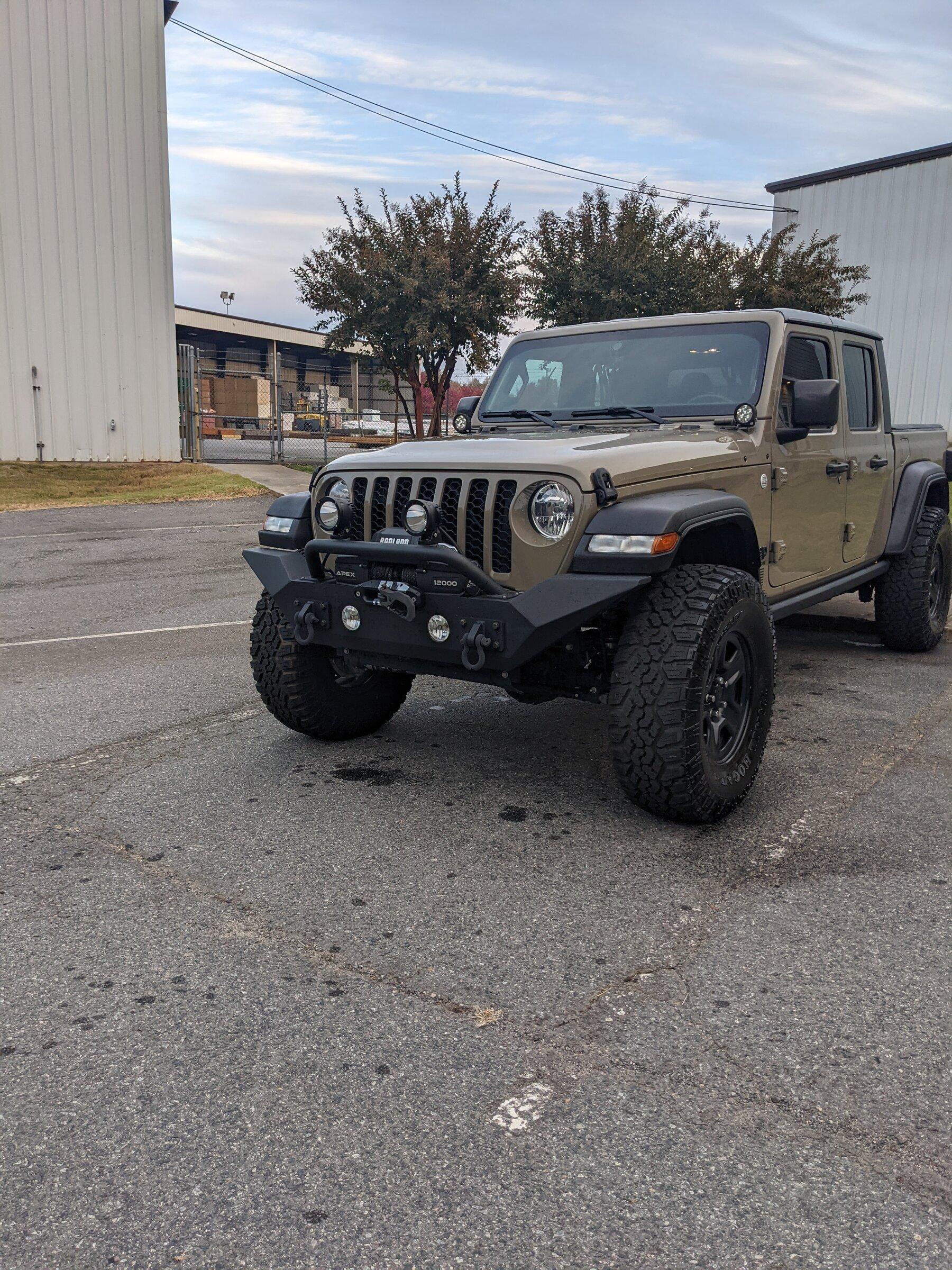

Really like my Kanati Trail Hogs, they are a Hybrid tire and did great in the recent ice and snow storms we had over the last 14 days here in North Carolina. They also are great in the rain, maybe one of the best tires I've ran in the rain. I'd even Go as far as to say they are at least equal to the BFG KO2S in the rain and that use to be my only go to tire before I decided to try these. I have not been disappointed and they have a aggressive tread design. I've been running them since October and have just over 10,000 miles on them so far and they are wearing great.
Jeep Gladiator 35x12.50 17 on 7.5 stock wheel PXL_20211111_121139651
