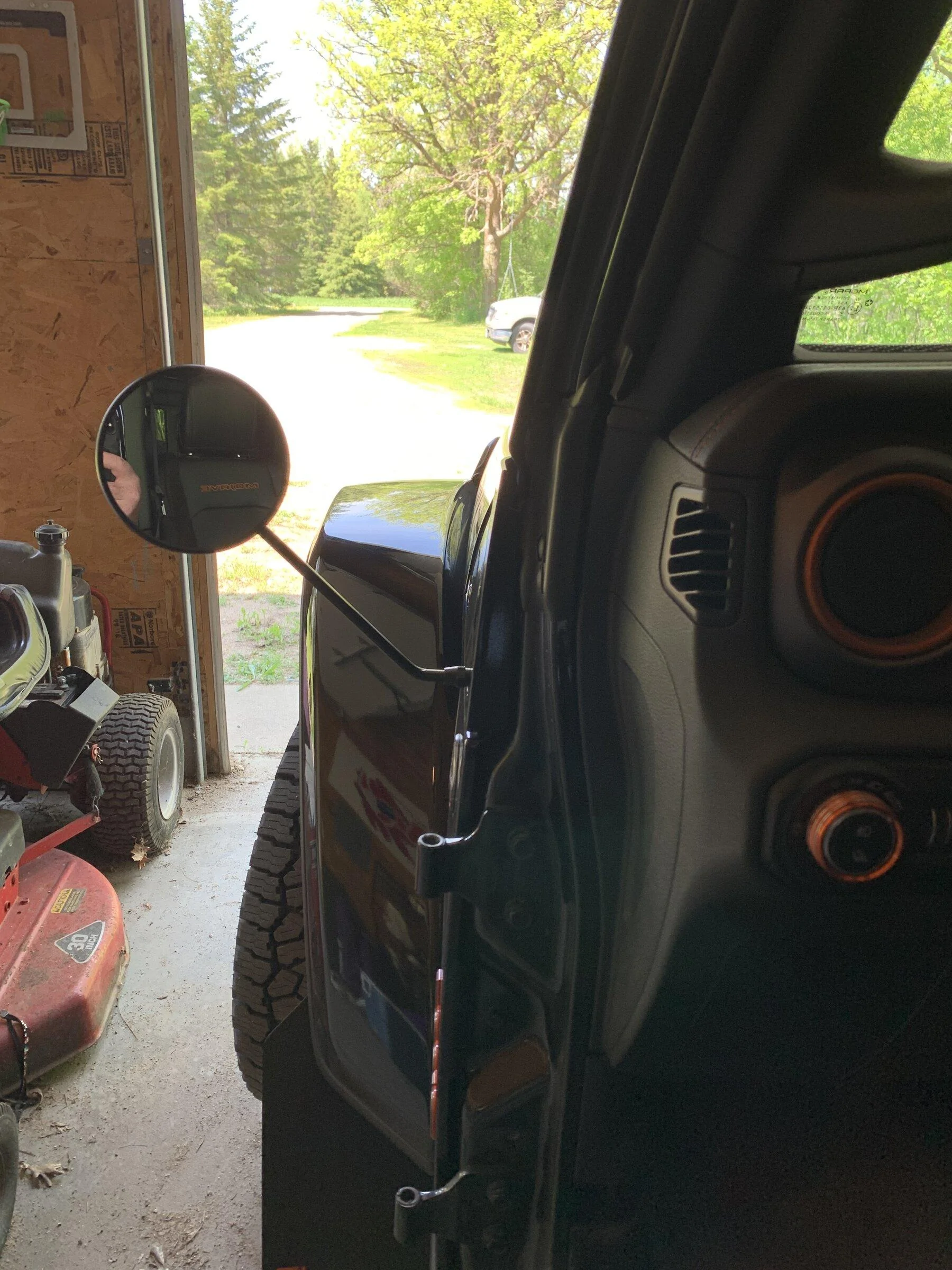

$4 mirrors, couldn't be happier. Don't pay more.

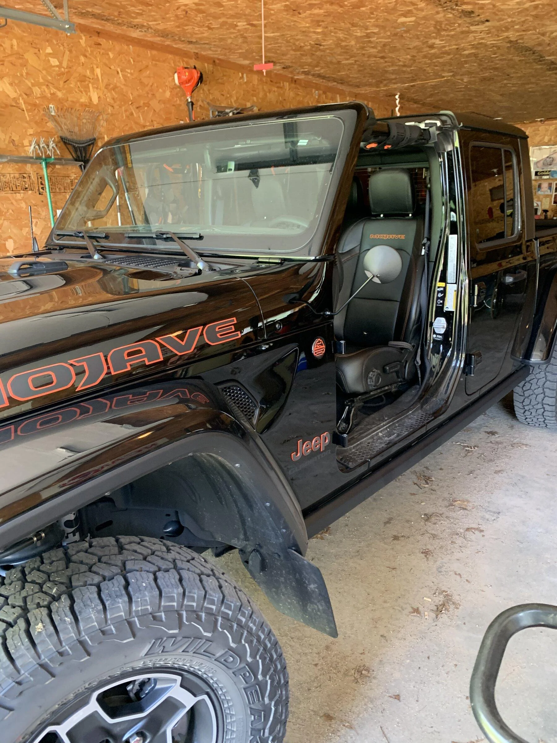

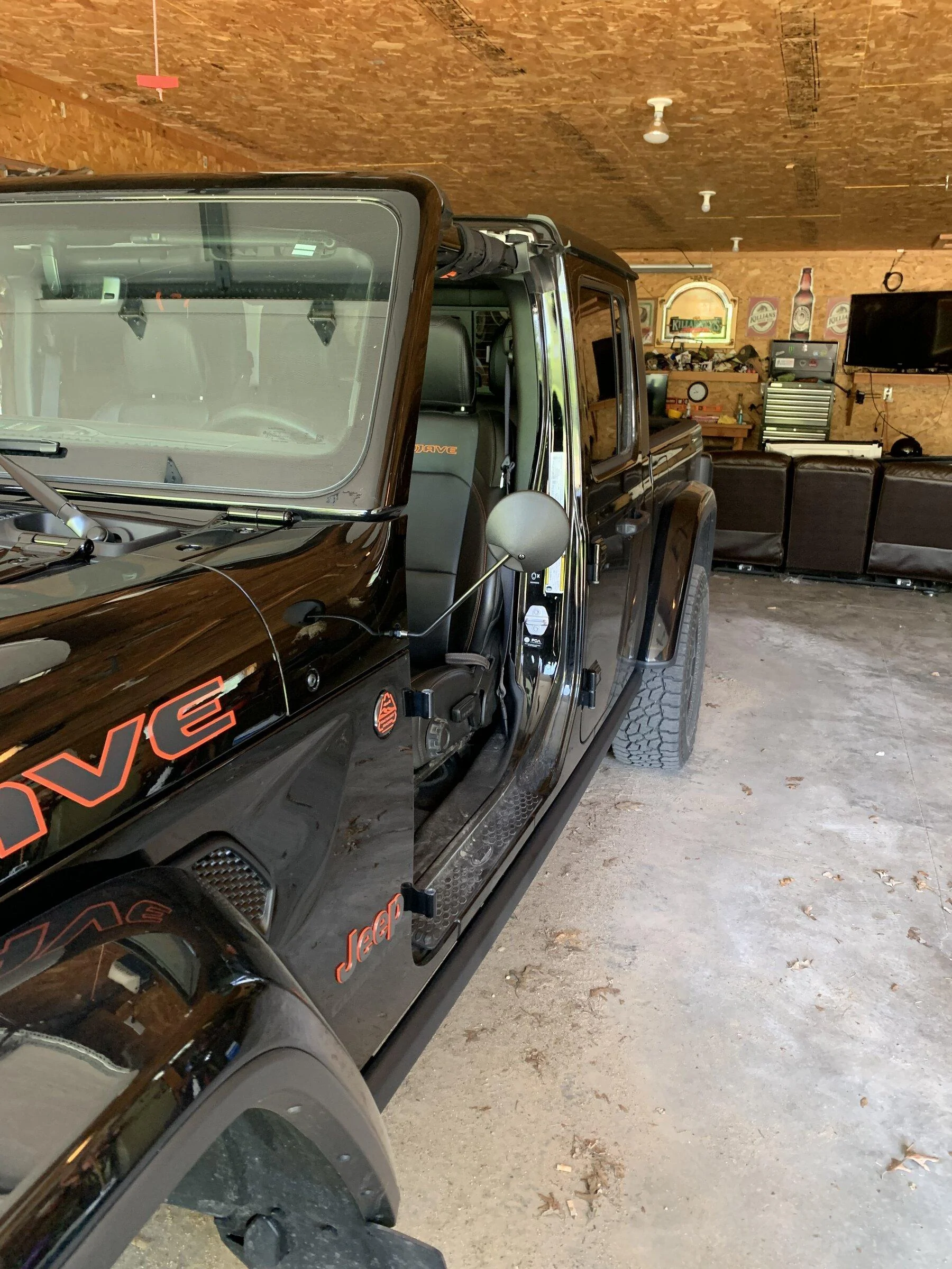

$20 on Amazon and $1.10 for nylon spacers at Ace.
Jeep Gladiator $4 mirrors, couldn't be happier.  Don't pay more. B2C6E7F6-DC15-474C-BA03-4254FF35579F
Jeep Gladiator $4 mirrors, couldn't be happier.  Don't pay more. 55ED7452-15BE-48BD-A392-B21B87365FC3
Jeep Gladiator $4 mirrors, couldn't be happier.  Don't pay more. 061D71A1-F8FA-4E9C-8002-EDD84B5CF371
Jeep Gladiator $4 mirrors, couldn't be happier.  Don't pay more. 8DBE7D45-9692-47E2-9069-A189C95E3279

I keep meaning to look for black anodized coupling nuts that would be longer and I wouldn't need the spacers anymore but I keep forgetting. Gotta put a reminder in my phone.

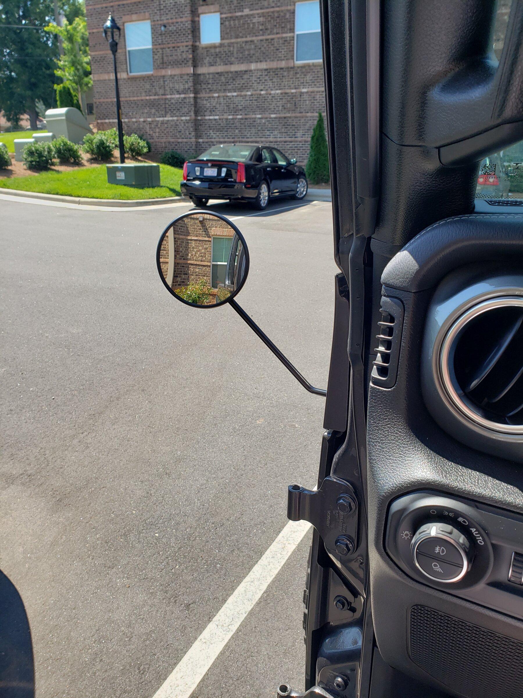

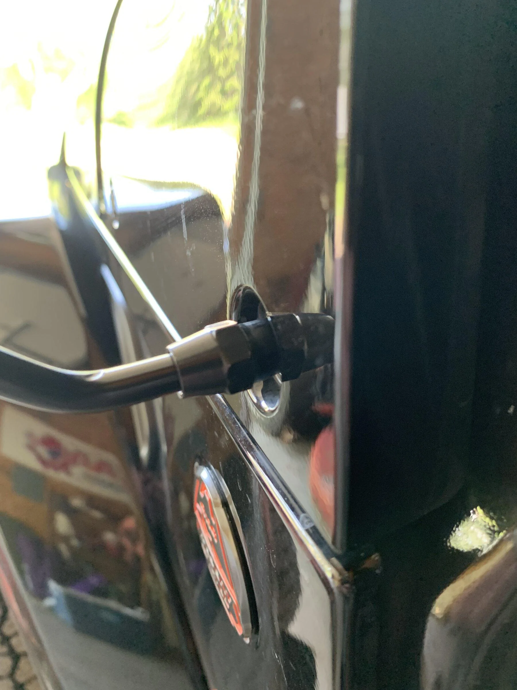

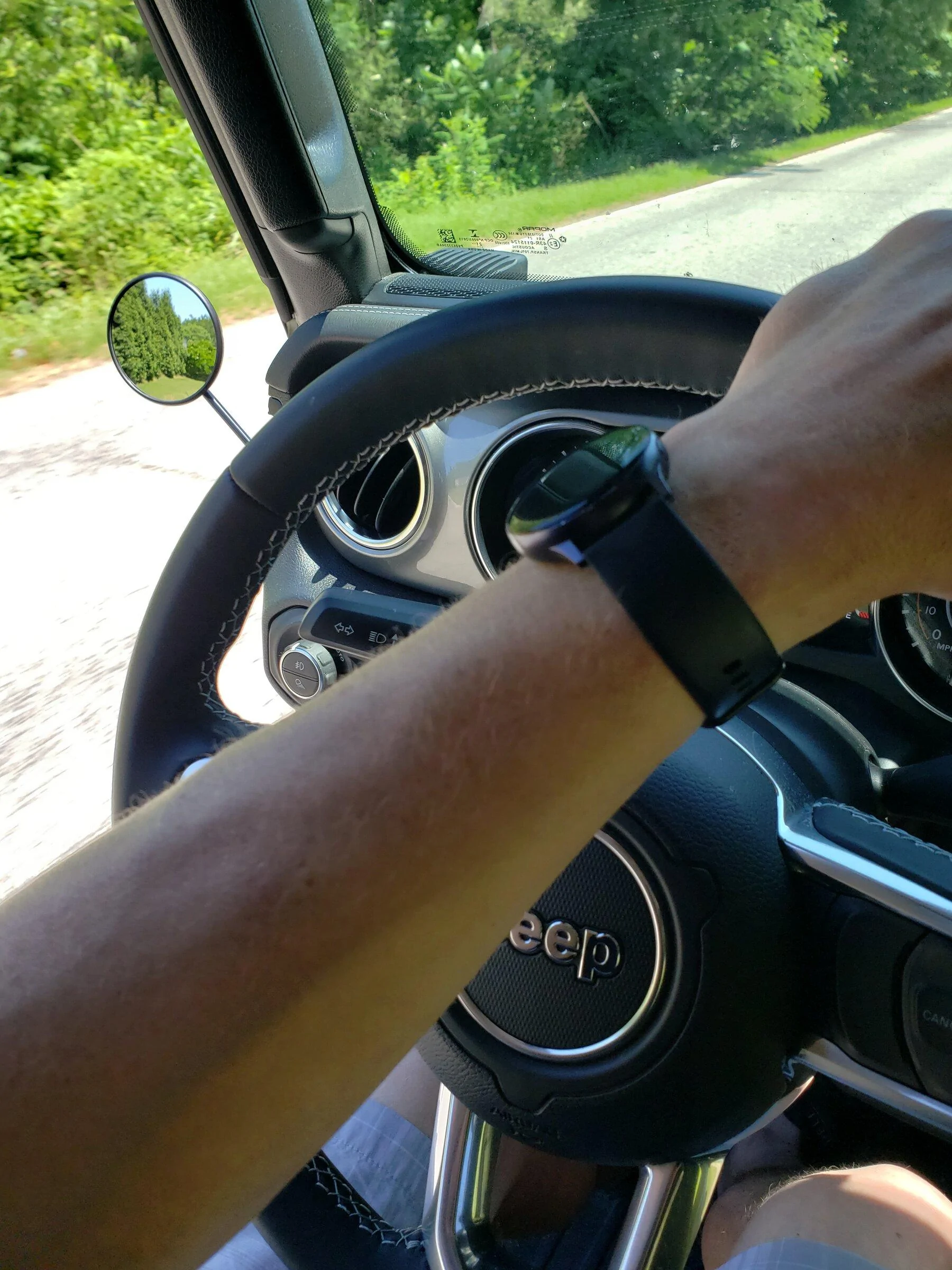

I ordered these scooter mirrors for $3.99 each (no seriously, the shipping was more than the mirrors). Finally got to try them out last week when I took my doors off for the first time. They are absolutely fantastic, I cannot fathom paying any more. They thread right into the cowl panel holes when you remove one of the bolts. You'll see a white nylon spacer in there, I only put that in to keep from scratching the paint around the recess with my little adjustable. 30 second install. Did a 4+ hour trip at 70+ on the highway and they are nice and stable.
The one on the passenger side is a little obstructed by the dash but still usable. But even if you're not worried about using it, it keeps you legal for your municipality. The driver's side one functions perfectly.
If you have the means, I highly recommend picking one (or two) up.
- paraphrased from Ferris Bueller
The same mirrors are available anywhere but I can't see paying a stratospheric $7.99 when Autozone has them for $3.99:

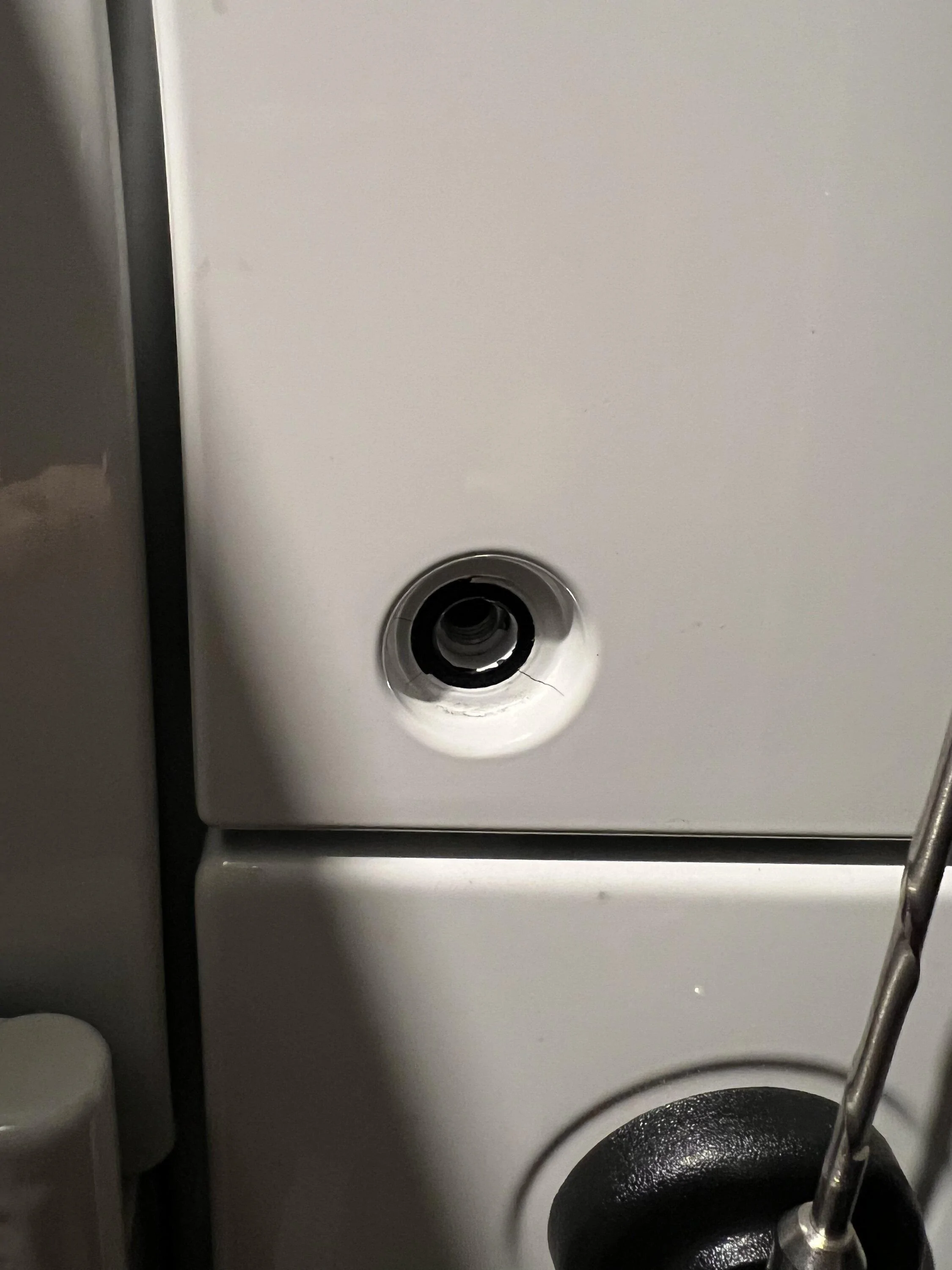

I know the panel that these screw into is plastic, but recommend a nylon washer if preserving the paint is important to you. I removed mine to day to put my doors on for a trip, and I guess I tightened them too much.
Jeep Gladiator $4 mirrors, couldn't be happier.  Don't pay more. 74851780-44E8-472A-9D4F-489B085B8E58
