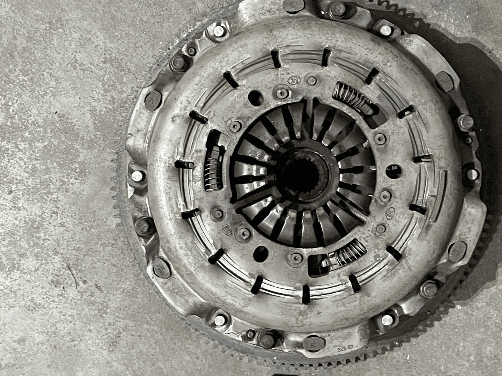

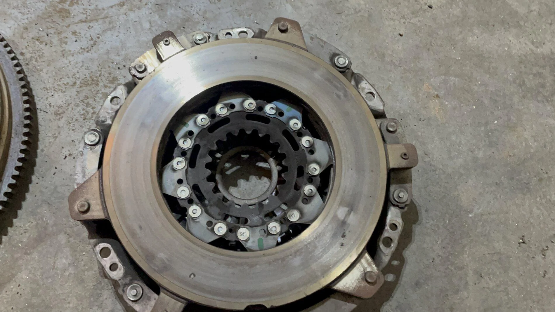

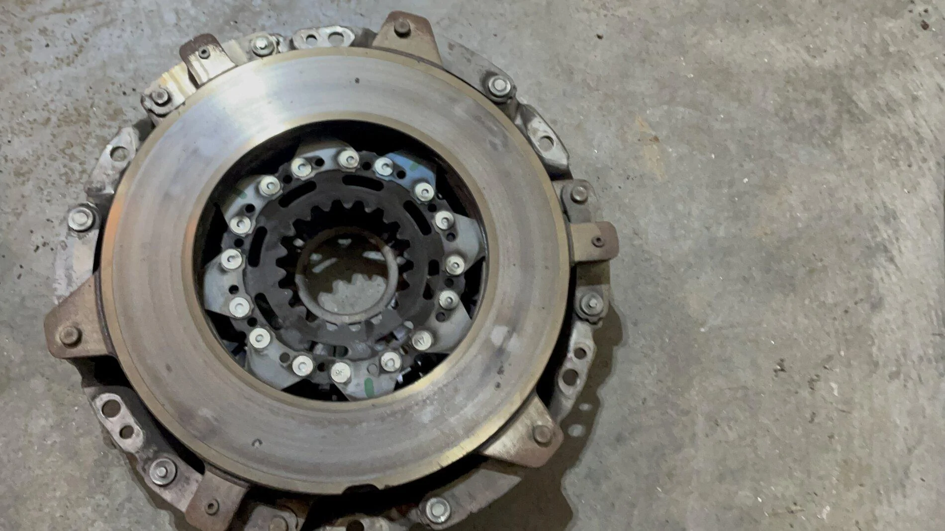

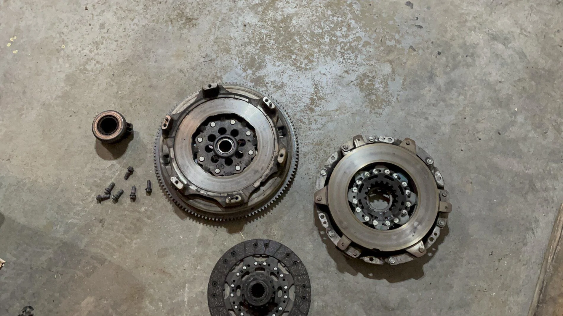

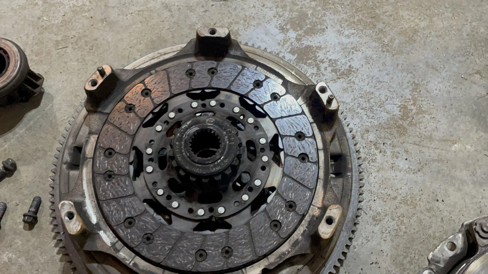

pics of old clutch. I'll do a quick video soon (soon as I find some time - traveling this weekend) on my Youtube to describe it. Definitely looks like twin discs (I didn't tear into it but there is another disc / friction surface inside the piece connected to the flywheel). and small/lightweight compared to the Centerforce single disc and beefy flywheel I put in.

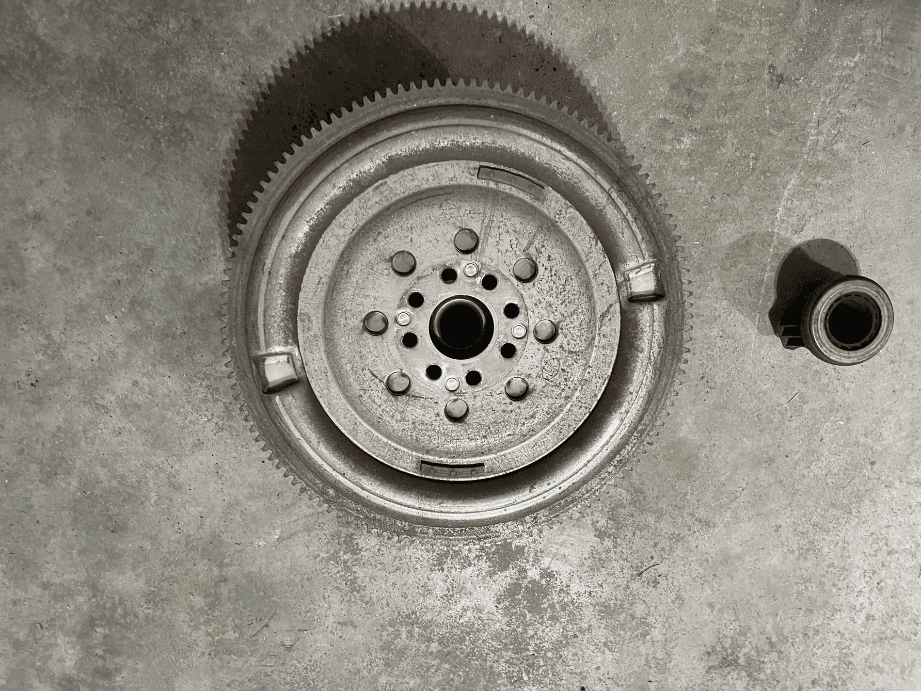

Is that dual disk also dual mass ? The back side of the flywheel sure looks funny. And the clutch "basket" seems to be separate from the flywheel.

Certified Emergency Manager
Seems to be dual mass based on my limited understanding. The entire assembly weighs less than the Centerforce single mass flywheel by itself.

Programer
Interesting. My assumption is that the dual mass is mainly for the autostart system and is a negative otherwise.
Sound right. The Centerforce single mass /single clutch system seems so much better, more positive and stronger. I can basically ease off the clutch and it will just go with minimal gas - even with a ~2700lb trailer attached. Before you really had to get in the gas to get going and engagement was vague. I have start/stop turned off via Tazer. Seems like a lot of wear and tear fit very little girl savings.
