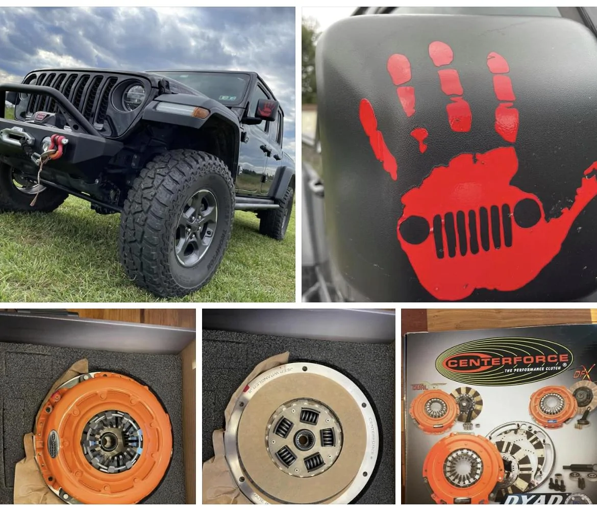

Got Jtrspartacus back from Keystone 4x4 with the new Centerforce Dual Friction Clutch. Initial thoughts from the 65 mile trip home are ….WOW! So much more positive engagement from the clutch and much lower pedal travel. I also don’t need to give it any gas to reverse or get started in 1st. I’ll post the 20 degree hill test comparison to my YouTube after I break the new clutch in ….soon. My gut tells me it will walk right up that hill with no throttle applied.
I’ll also post up pics of the stock - LUK clutch setup for the good of the order.
Nice to have first hand feedback!
Hows the overall acceleration and shift speeds. Any changes noticed?
By lower pedal travel do you mean less movement or closer to the floor?
Not really doing too much speed or acceleration shifting. Taking it easy for break in. However I think it will be pretty good. It definitely has more pedal effort required and feels like a properly bled clutch.
Lower travel is both - way closer to the floor and it positively engages like every other clutch I’ve driven with in the last 30years. The stock clutch was weird, very vague when it was new and got better over time but it engaged way at the top of the travel and seemed to have a wide, mushy zone and then a on/off binary point with no feel. I actually moved my seat closer 1 click to be in better position for the new engagement point.
I’ll do some more driving and break in and report back.
Thanks for feedback. We installed a centerforce in my sons Mustang last year. More pedal pressure for sure but seems indestructible and offers good control.
When you get time please do some mythbusting and set the record straight on the stock clutch.
