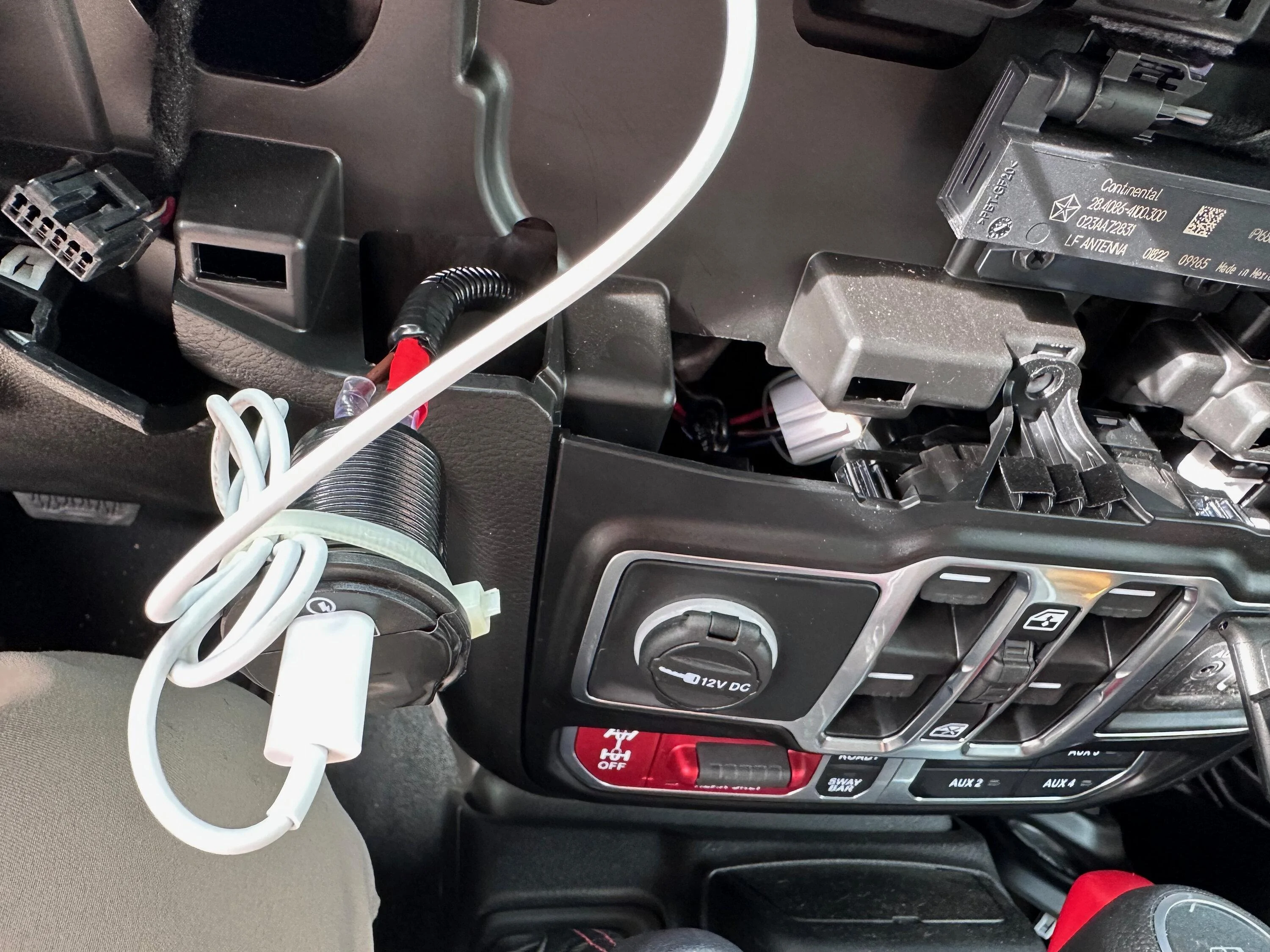

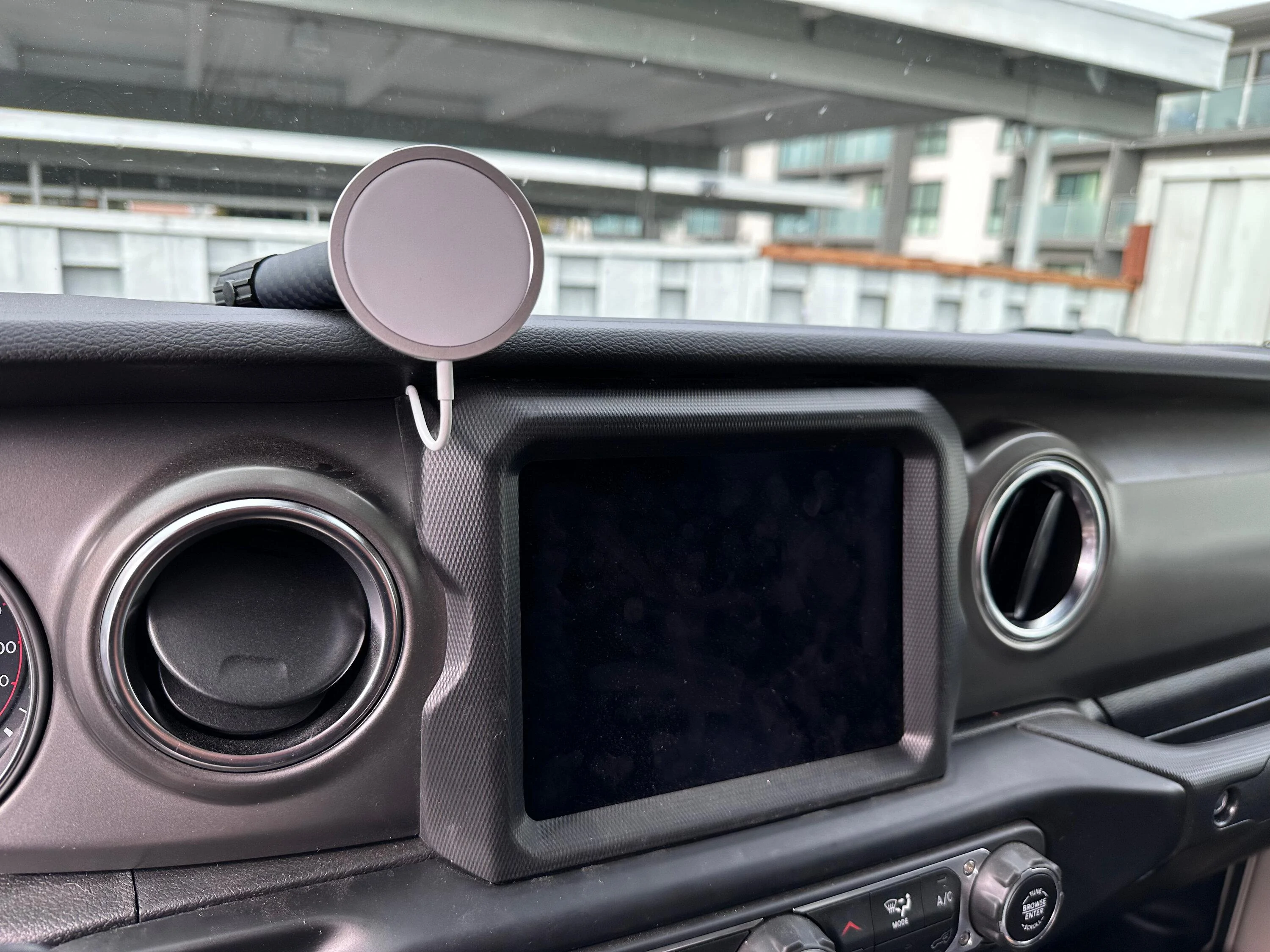

Thanks! I thought pretty hard on it before going this route. I used the Apple MagSafe charger. That just magnetically attaches the Bulletpoint magnetic mount. Nothing special there at all. I was pleasantly surprised that it is rock solid in attaching that way.

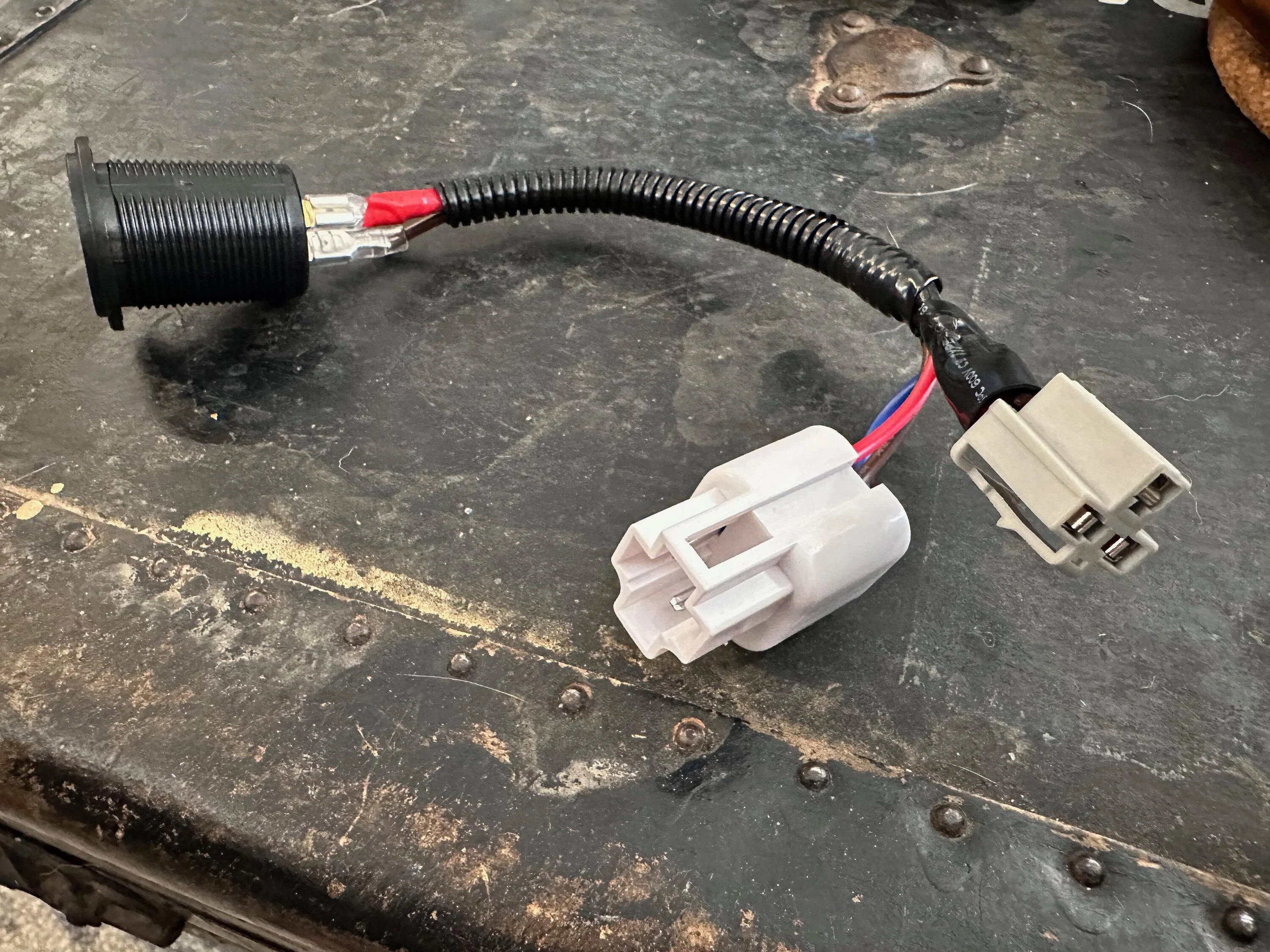

I used the splitter linked below to splice off of the 12 volt cigarette lighter and the 12 volt usb dual charger linked below to plug in the MagSafe charger. There was plenty of room behind the dash to the left of the cigarette lighter in a pocket next to the steering column to tucker it all away. It was a twenty minute project in all. I did get a good trim kit set to pull off the panels so I didn’t worry about screwing anything up with the dash panels.
https://www.amazon.com/gp/aw/d/B087KP7QJH?psc=1&ref=ppx_pop_mob_b_asin_title
https://www.amazon.com/gp/aw/d/B07NV9D61R?psc=1&ref=ppx_pop_mob_b_asin_title
I just wanted to boost this post! I noted this post a while ago, ordered the same parts, and put off installing because I figured it would take forever. Couldn't have been more wrong, this really is a easy 20 minute job. The panels pop right off, and there's plenty of room behind the dash. I spent a little extra time cutting down the longer-than-needed harness to something more minimal (trimmed off extra wire, a junction on the 12v line, fuse holder since the 12v socket is already fused,, extra loom), but there's really no need.
