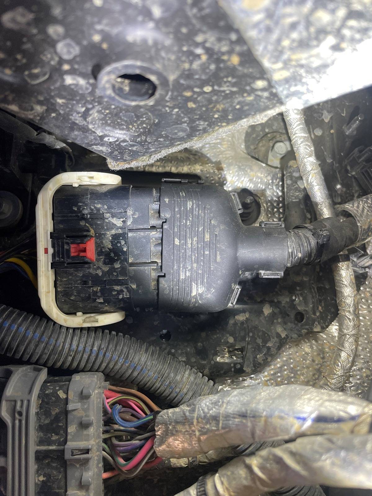

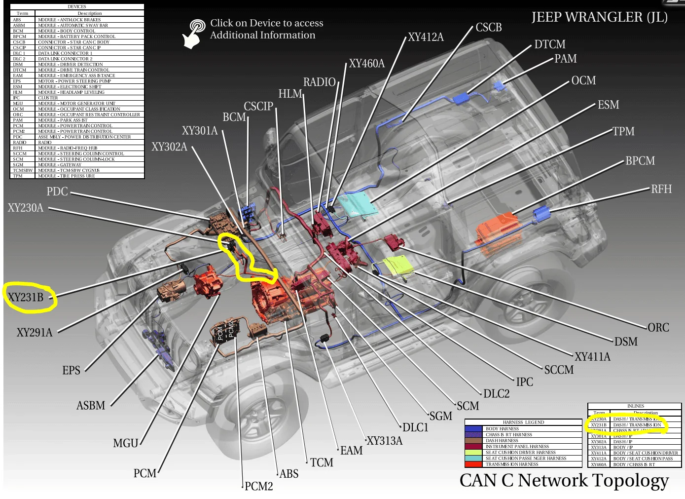

Jeep Gladiator ELECTRICAL WARNING TO ECODIESEL OWNERS: Shifter Controller Wiring Harness (Service Shifter error message) Jeep Trans Wiring Diagram
This is the harness to follow, it is located under the front passenger wheel well towards the cab of the vehicle. (TOP)

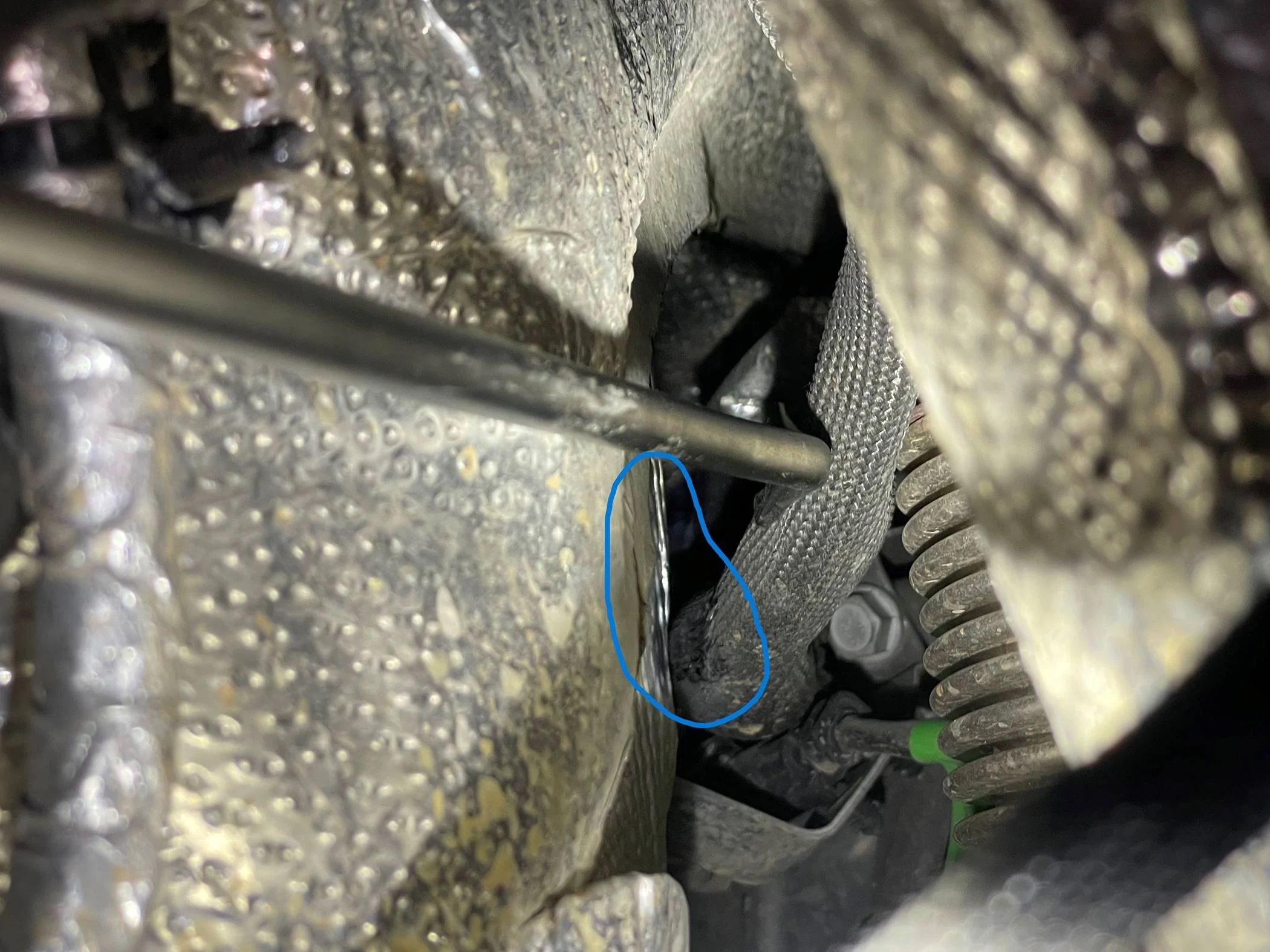

The Problem
the issue as shown is a heat shield located against the center cab of the vehicle entering from the passenger side wheel well. the factory heat shield is actually rubbing a hole through the protective jacketing of the wiring harness, i know you cant see from the photo provided, however there was copper showing in the orange wire shown. i did confirm its grounding out on the heatshield intermittently with a volt meter, hence why this seemed to trigger the "Service shifter" during vibrations while driving... there are some videos on youtube that show a gentleman showing you the exact path of the issue that he was having, (shown here) however his fix as well as the dealerships was to press a harness clip that was not attached to the chassis of the vehicle, my Jeep is a 2022 i believe his is a previous year. please note the location of this problem.... is an absolute problem...... a hand cant fit in the space, from any direction, top, bottom, side, there is 3 ways to gain access to this location and fix the issue the RIGHT way,

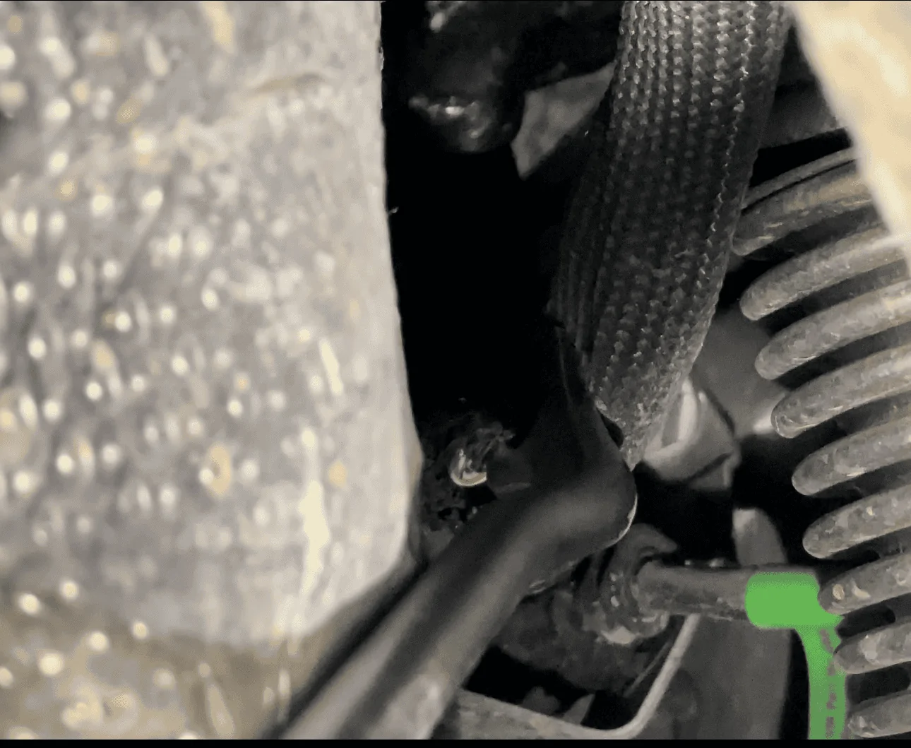

Is the picture with the blue circle is that the front passenger side coil spring? Just trying to get a good idea of where the location is to check...
The Problem

no its not the coil spring (kinda looks like it through!) If i remember correctly that's the EGR Pipe, if you actually lift up the wheel well liner towards the cab of the vehicle, you should see 2 wiring harness plugs the larger one (TOP) is the wiring you will need to follow its approximately 20 inches in the youtube video shows it pretty well, i recommend giving it a watch!
Also, i thought that as well, however with the EGR right there temps.... id assume are a lot higher than any plastic can take before melting, i did purchase some items, however i wasn't able to put them on or around the damaged area of wiring due to inaccessibility :(

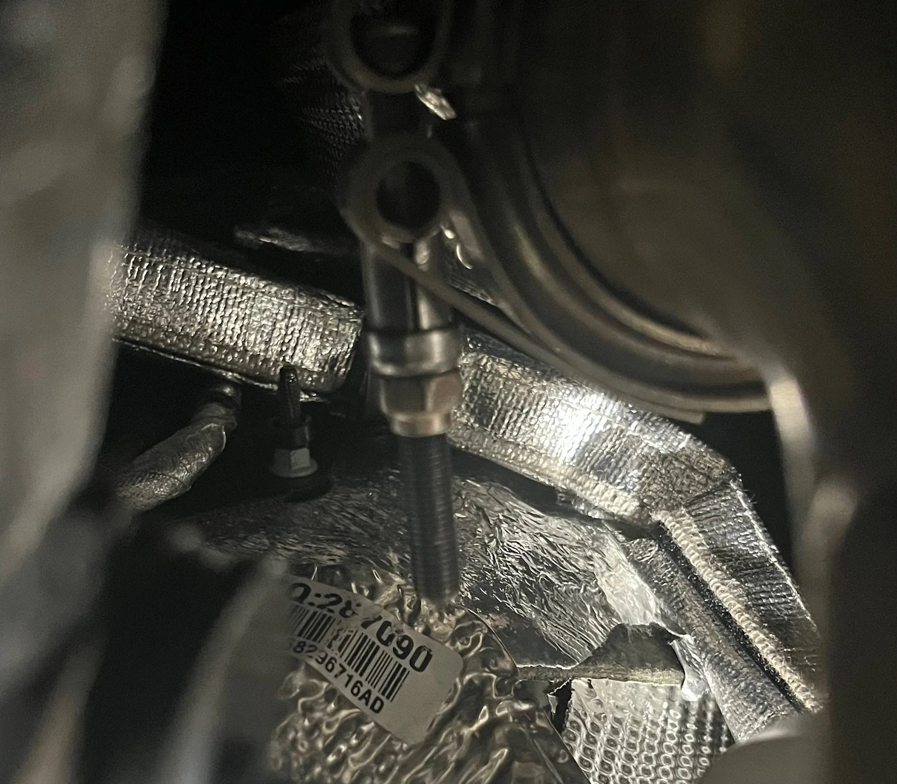

There is another way to reach this location. Although it does require a few hours it’s much easier than pulling the body or engine out, and that’s to simply remove the DPF to gain access.
After purchasing my new gladiator I immediately installed an added layer of protection to hopefully eliminate this problem.
I installed Design engineering heat shroud around the length of the harness and zip tied it up a little better.
With the DPF removed you can gain access to it.

I found unbolting the exhaust from just before the rear axle and removing sections of it from there making your way to the front to be the simplest for one person and no lift.

4. i began to dig myself........ after a few youtube videos, searching, and searching, and searching..........i found that the issue had to do something with the transmission communication ... not the shifter itself......... i stumbled across a wiring diagram. (See below outlined in yellow) I traced the wiring harness back untill i found a little surprise.....
The Problem
1. remove the engine (no im not joking)
2. remove the transmission (nope, not joking)
3. remove the full cab of the vehicle from the frame.... (again, no im not joking)
4. even then after the ENTIRE WIRING HARNESS for the vehicle is replaced, the issue may replicate if the heat shield is not addressed or a product is purchased that can withstand the heat and is abrasion proof.

so, with my discovery, i went BACK to the dealership....... I SHOWED THEMTHE ISSUE, where it was located, how it diagnosed it, the video and photos i took.... i provided them the 3 ways i know how to access this spot, after 4 techs came out, tested what i had stated, looked all over on accessibility, they came to the same conclusion of removing the 3 large components for accessibility and to replace the wiring harness ( note the dealer stated the harness is the entire harness for the vehicle, they weren't able to get the harness from the point of connection at the plug under wheel well to the plug at the transmission... forcing them to then replace all the electrical wiring harnesses.
Me at this point being frustrated at the fact i had to do all the work for the dealership, not to mention the lack of ability from them to perform basic troubleshooting methods and procedures, absolutely floors me.... currently i have no faith for them (the dealer) to perform such a task on my vehicle, after they mess up after performing such a task am i to be without a vehicle for months.... its not worth it....
I did, however come up with a solution ............... its the best i can come up with and can be a preventative measure to stop this from happening..... high temp RTV... yup, this isn't my way of fixing things, however im either stuck paying for this with a competent shop that has employees that know how to wipe there a** and breath the correct way with out having someone to show them how, or this RTV solution LOL...
i ended up getting some permitex 900 degree RTV and put some on the end of a flat head screwdriver, shoving a ton inside the wiring harness, and RTV'd the harness to the heatshield so it cant rub across it anymore. though i dont have photos of the work....... the purpose of this post is to inform everyone of what can occur and what could happen, i did check 3 other Eco diesels, they all started to fray the jacketing of the harness... some were at 9k miles some were at 17k-ish.
please note, there are other issues that if frayed or shorted this particular harness can cause some dangerous issues.... I have heard from the similar issues i have had from this particular harness but cant confirm the issues are - loss of power jeep will turn off while driving, loss of steering, dash cluster illuminates (Christmas tree affect)

In your 1st picture, it appears that the connector is not fully seated or connected. Unless I missed it, I didn't see or read about it in your description.
