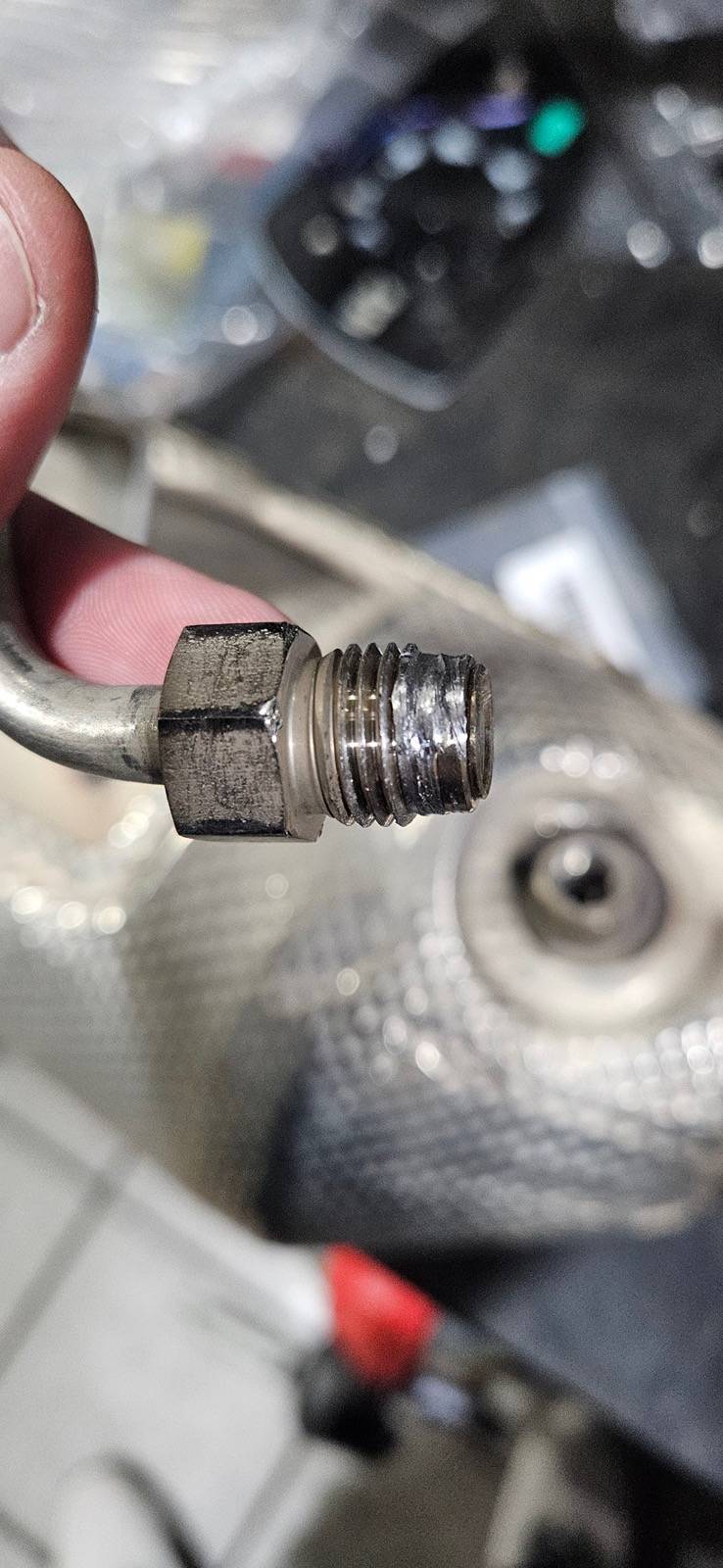

For an update, I took my Gladiator to the dealer on 4/19, showed them the issue and left it there for the repair under the factory warranty. They said that they would drop the exhaust to fix it. Called today, 4/23, since I hadn’t heard anything. I was told they had to order a new line that attaches to the DPF because the threads stripped when they removed it. This is what they sent me:
Jeep Gladiator ELECTRICAL WARNING TO ECODIESEL OWNERS: Shifter Controller Wiring Harness (Service Shifter error message) 1713894682268-sv
Now waiting to hear when the part will be in. Wanted to show this in case anyone is doing this at home.

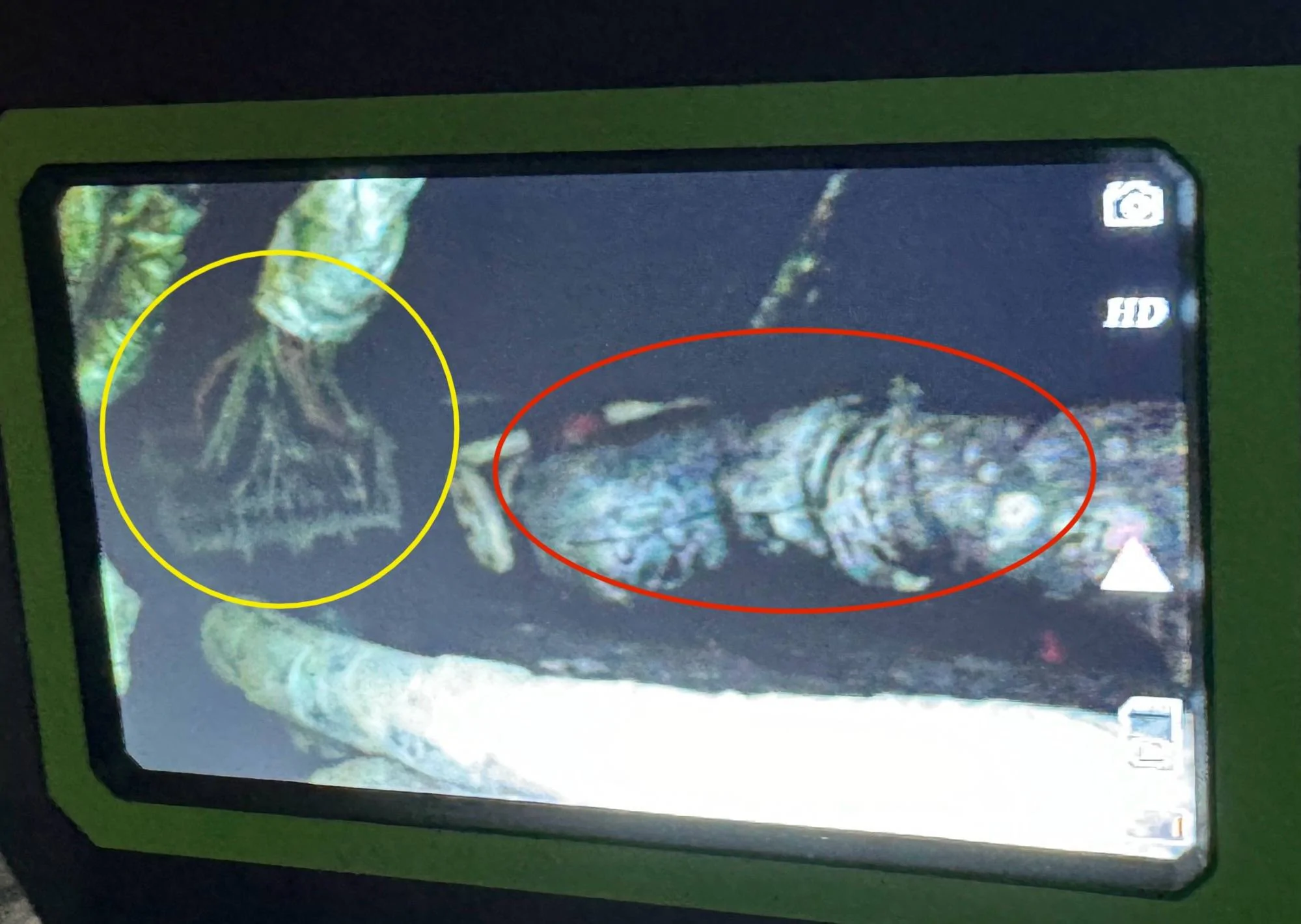

Ecodiesel snuff film
Jeep Gladiator ELECTRICAL WARNING TO ECODIESEL OWNERS: Shifter Controller Wiring Harness (Service Shifter error message) IMG_3857

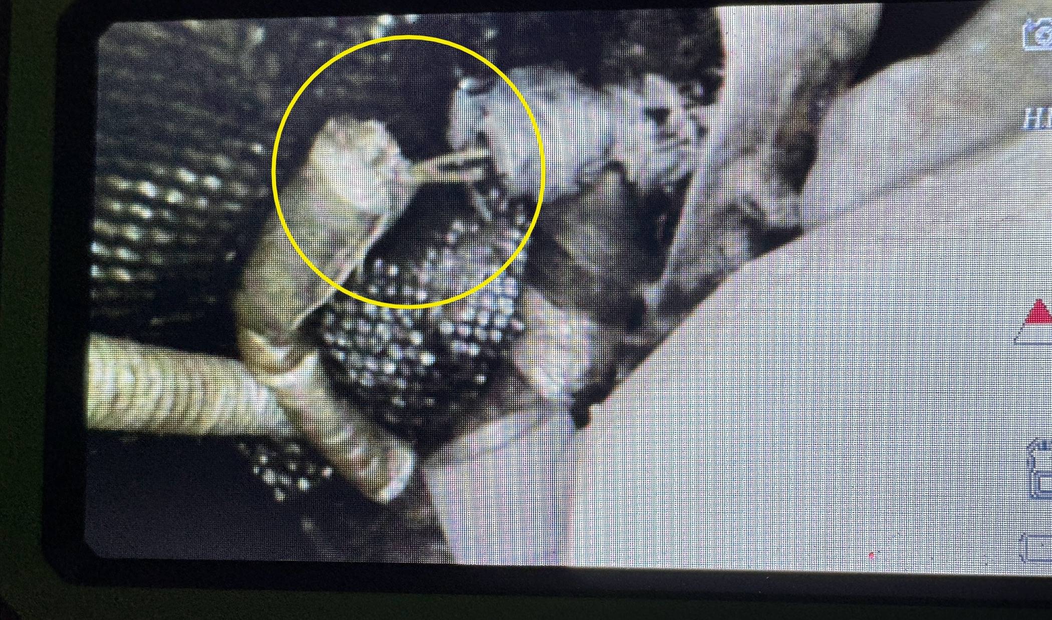

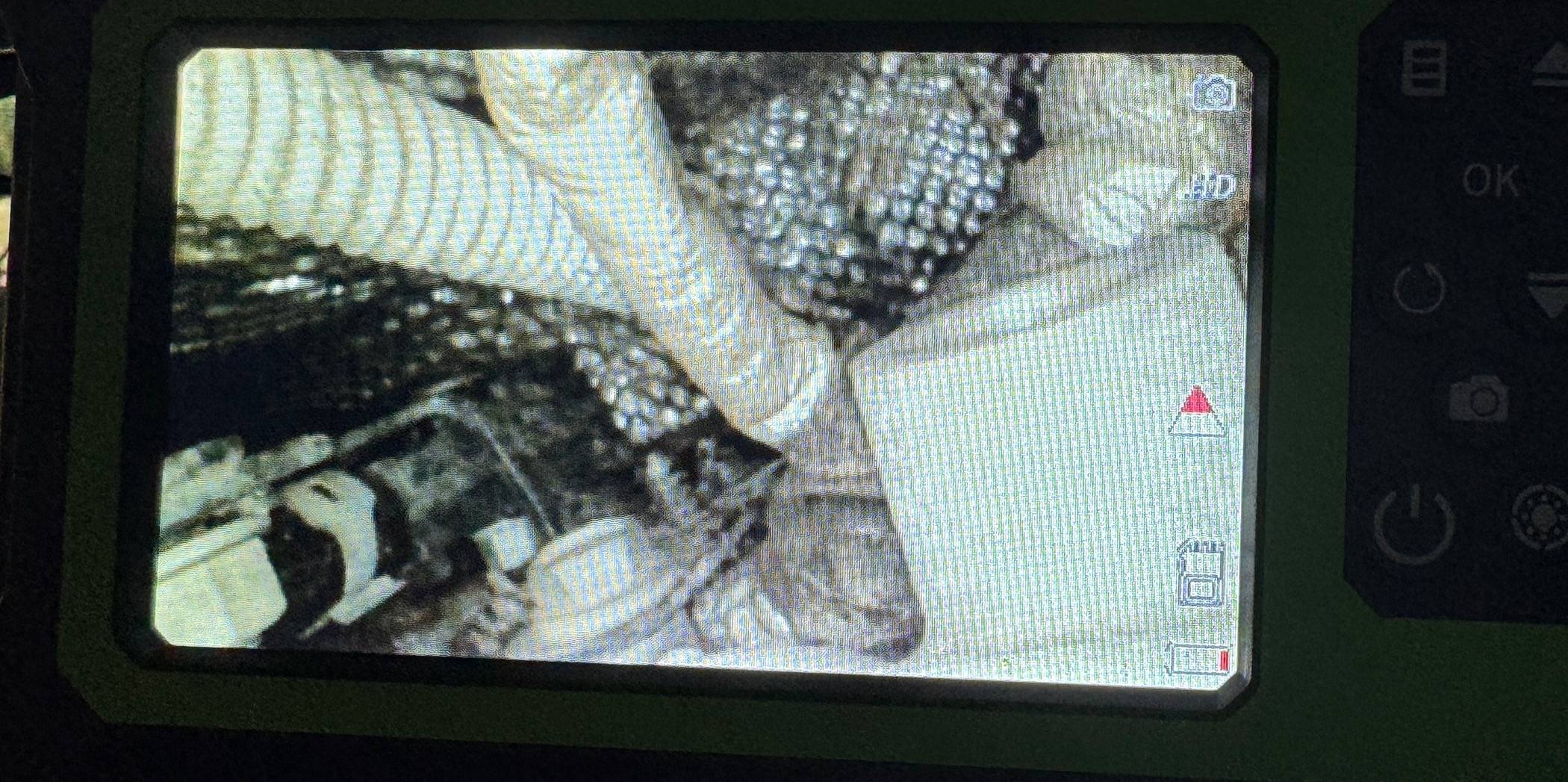

I found the harness but couldn’t track where it goes with my dying inspection camera and the daily hurricane force winds we now apparently have. I’ll look again tomorrow. I’m blow away at how much random crap is under here going in every direction. It’s like this truck was made in a barn in some post apocalyptic future. Fallout 5: Toledo
Jeep Gladiator ELECTRICAL WARNING TO ECODIESEL OWNERS: Shifter Controller Wiring Harness (Service Shifter error message) IMG_3850
Found the gizzard
Found the gizzard
I’m a fan of fallout! Trace the red one back

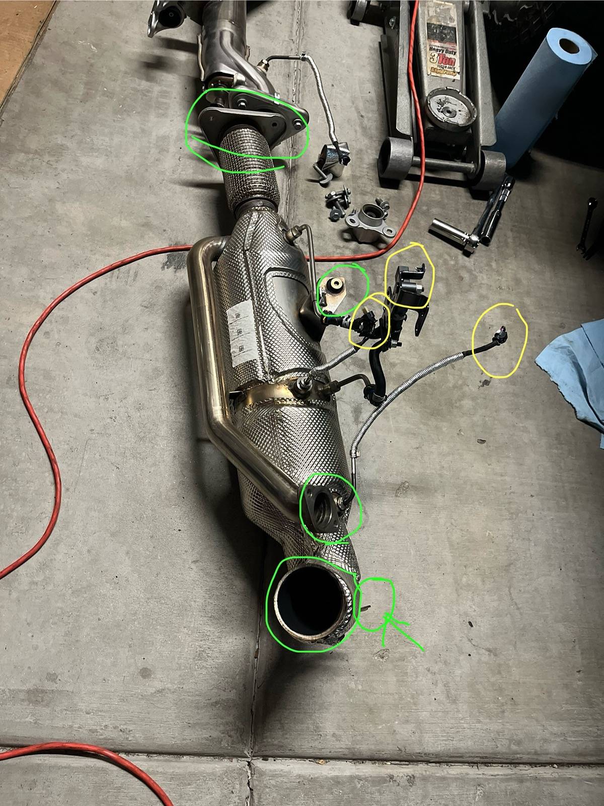

This is what the DPF will look like removed.
The yellow circles show the 3 electrical connections that need to be disconnected. They are near the top of the transmission and do require some finesse to reach. You could also remove them from the DPF if it’s easier for you to access that way…
The green circles are the mounting locations.
1 vband clamp holding it to the down pipe.
1 mounting location to side of bell housing.
2 bolts attaching the EGR tube
1 holding the DPF assembly to the transmission
3 bolts connecting it to the aft portion of the exhaust.
hope this helps.
