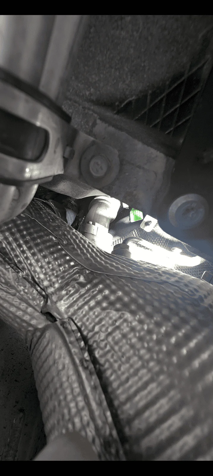

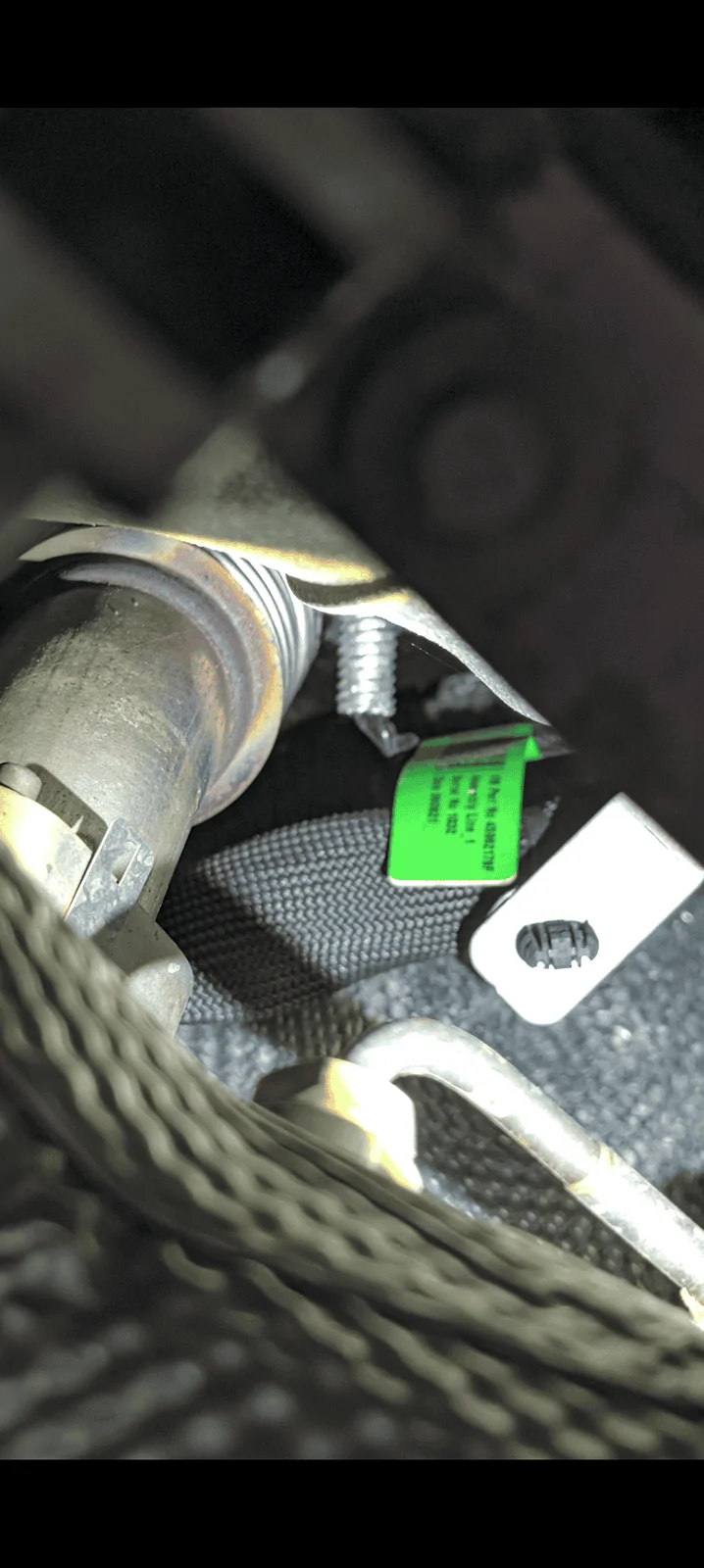

Can someone confirm this is the harness of concern ? If so mine looks to be located properly with the bracket. I could not see any rubbing
Yes that's the correct harness but the rubbing occurs farther up against the firewall near the mounting stud that its zip tied to.
Ok thank you, what's your easiest vantage point ? Down from above or do I need to pull the fender liner ?

Is there a chance that Jeep remedied the issue by the time my Gladiator was built in December of 2023?
Mine was built 12/23, looks like the picture above. Bunch of BS. Same level of brain dead BS that showed up on both my TRX's. Dumped both of them due to all the stupid beginner level mistakes on both those trucks that the dealer could never resolve. Here we are again with same issue of brain dead BS.
