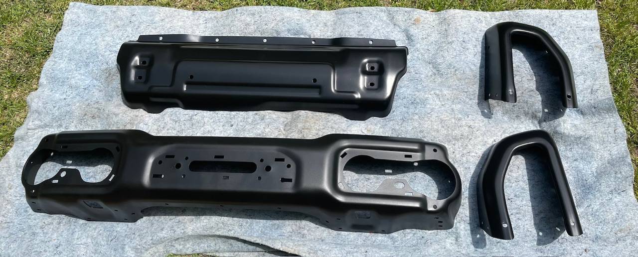

btw, I never liked the powder coating on my front bumper so I used their rollbar paint and 1k satin clear and it gave a very stock like, durable finish that cleans easily. I had to let it cure for a week before I could clear it though. I’ve never run into that before.
