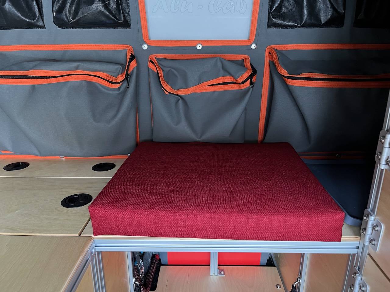

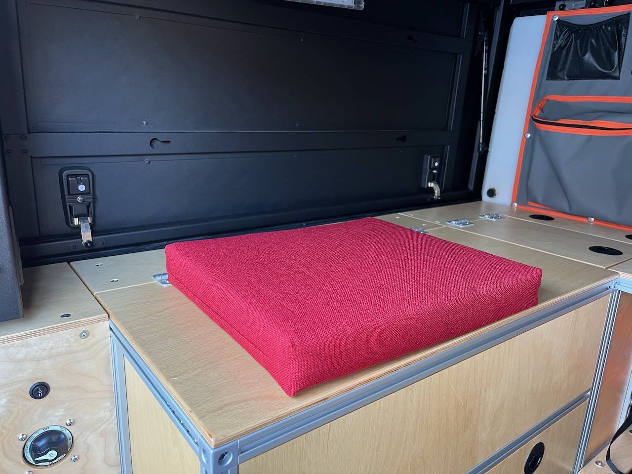

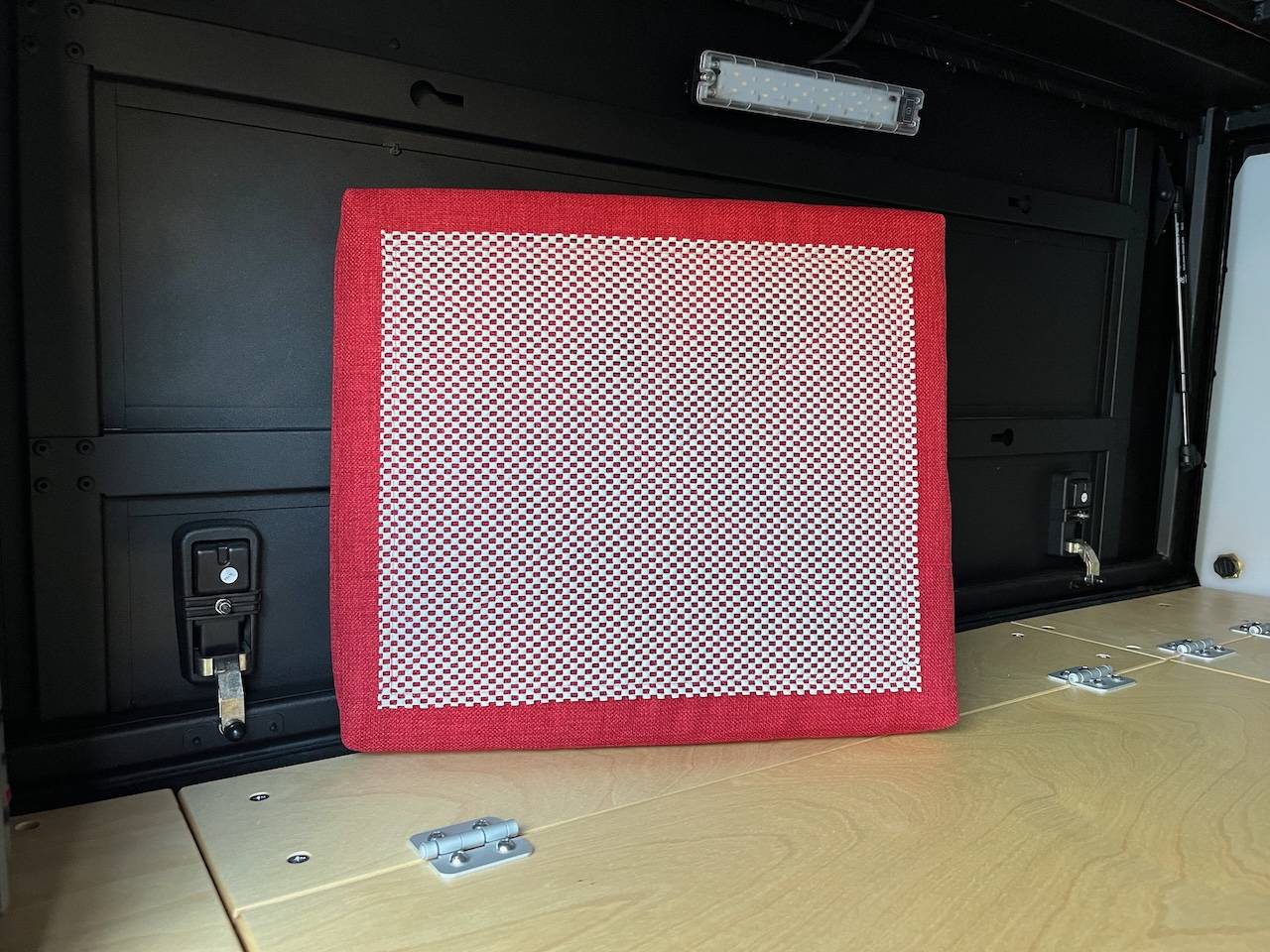

More small improvements. Seat cushions for inside the camper:
Jeep Gladiator A new hope ... (build journal and component reviews) IMG_6370
Jeep Gladiator A new hope ... (build journal and component reviews) IMG_6371
And they can stay in the camper when driving since they have anti-slip mat sewn to the bottom:
Jeep Gladiator A new hope ... (build journal and component reviews) IMG_6372
Now, just need to get that backrest done and it'll be comfy ... tiny, but comfy.
We didn't want full on cushions for all surfaces, just big enough to sit on nicely and that's it. Otherwise they are harder to stow away if that should be necessary.

And to answer a question I got elsewhere: yes, these cushions are made, not bought. My wife made them.

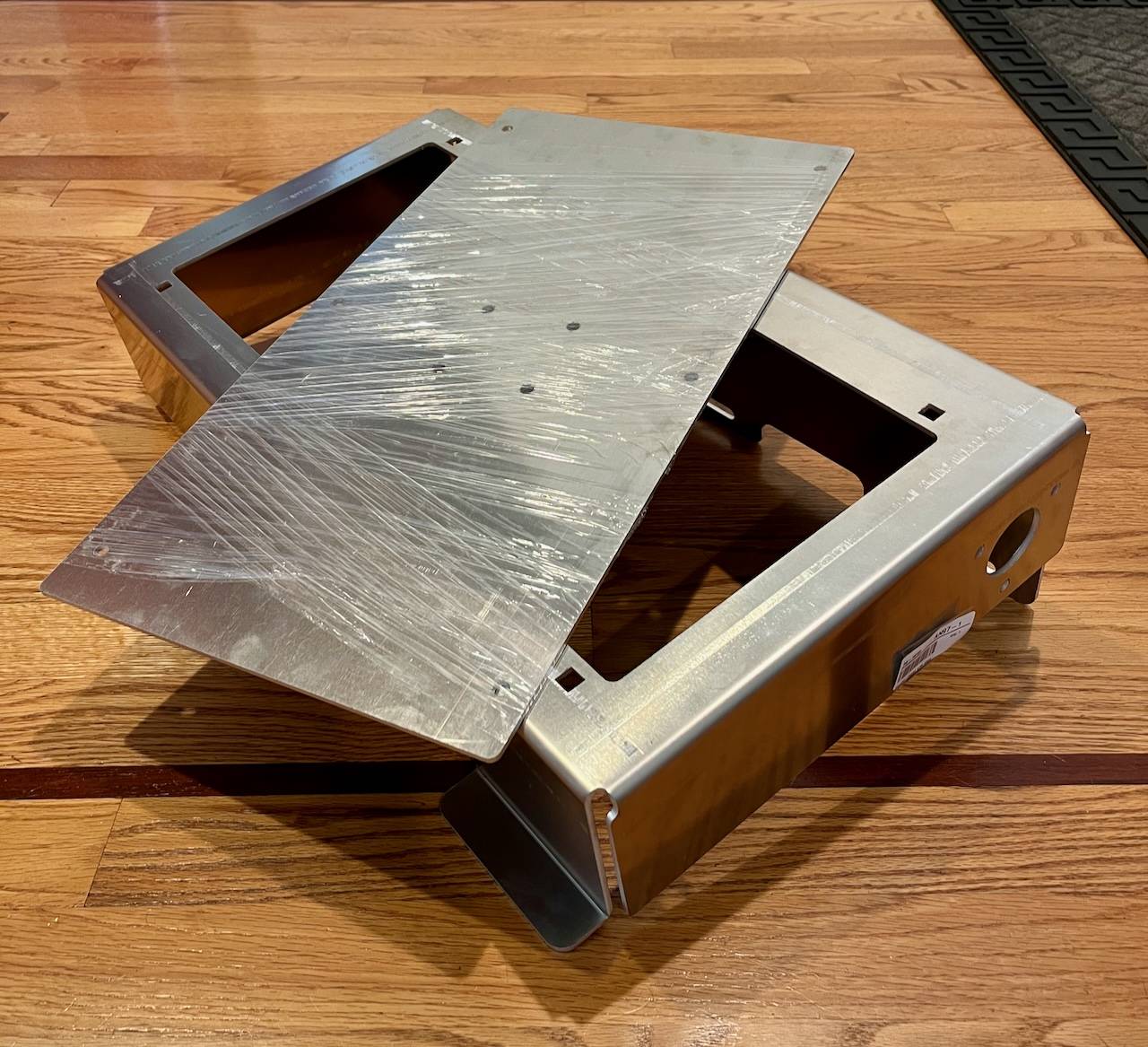

Soooooo, a long awaited item arrived this morning, the "diesel heater component panel":
Jeep Gladiator A new hope ... (build journal and component reviews) IMG_6374

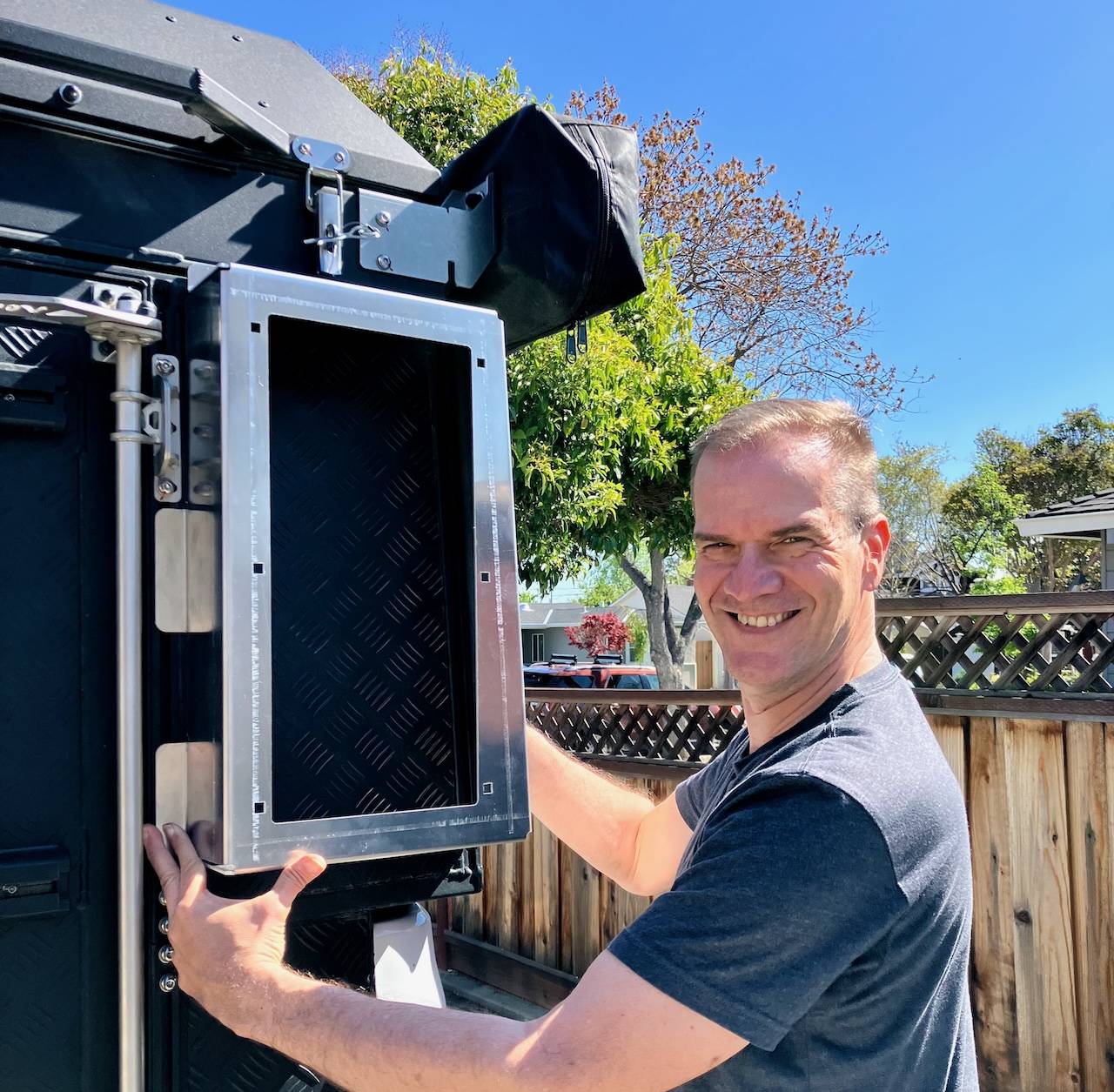

It'll get installed like this:
Jeep Gladiator A new hope ... (build journal and component reviews) IMG_6267
Basically the same way as the Alu-Cab molle panels.

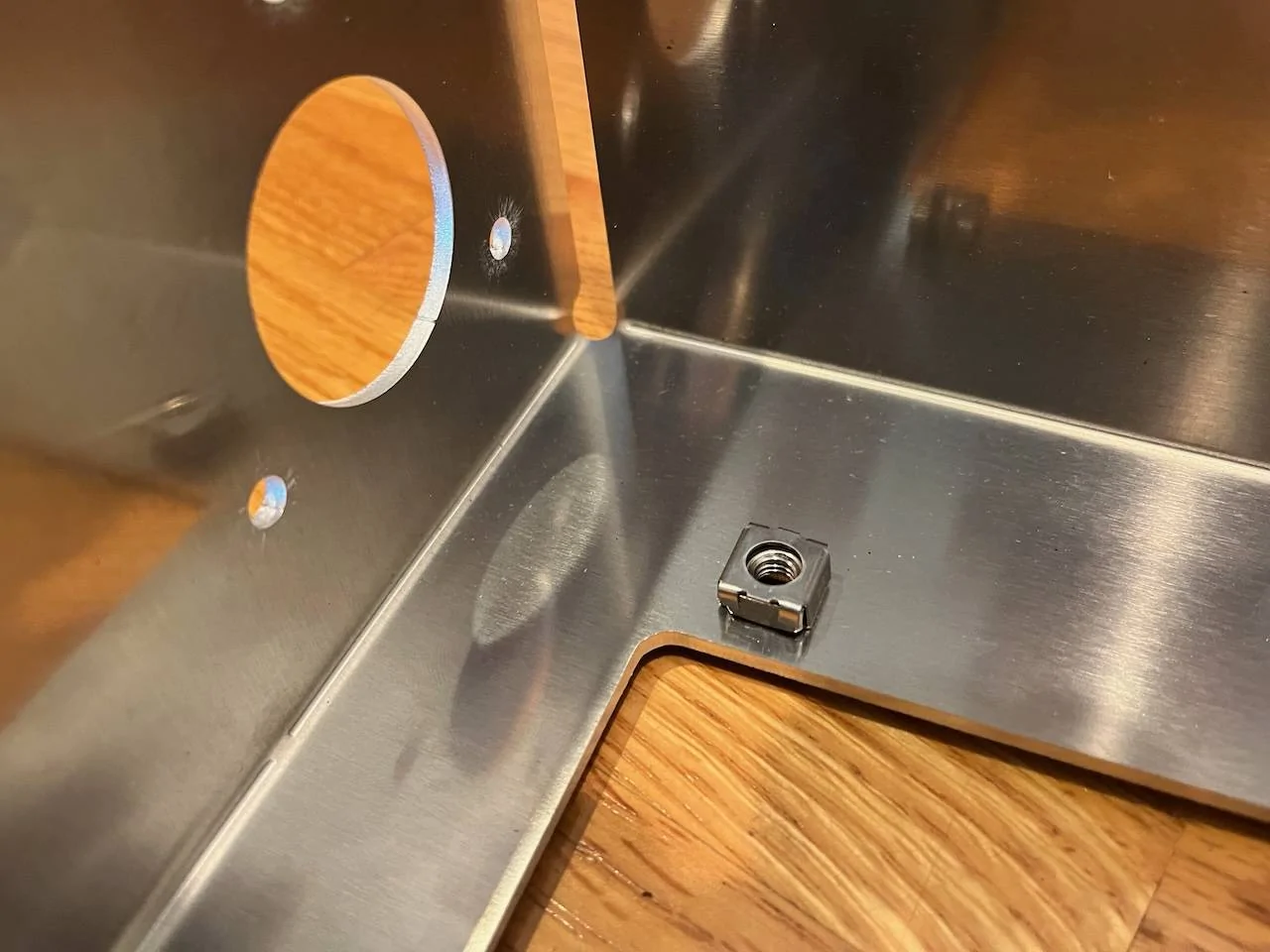

The lid will be mounted with M6 cage nuts and some M6 bolts (like 99% of the stuff we've built for the camper), that's why there are square holes on the front:
Jeep Gladiator A new hope ... (build journal and component reviews) IMG_6381

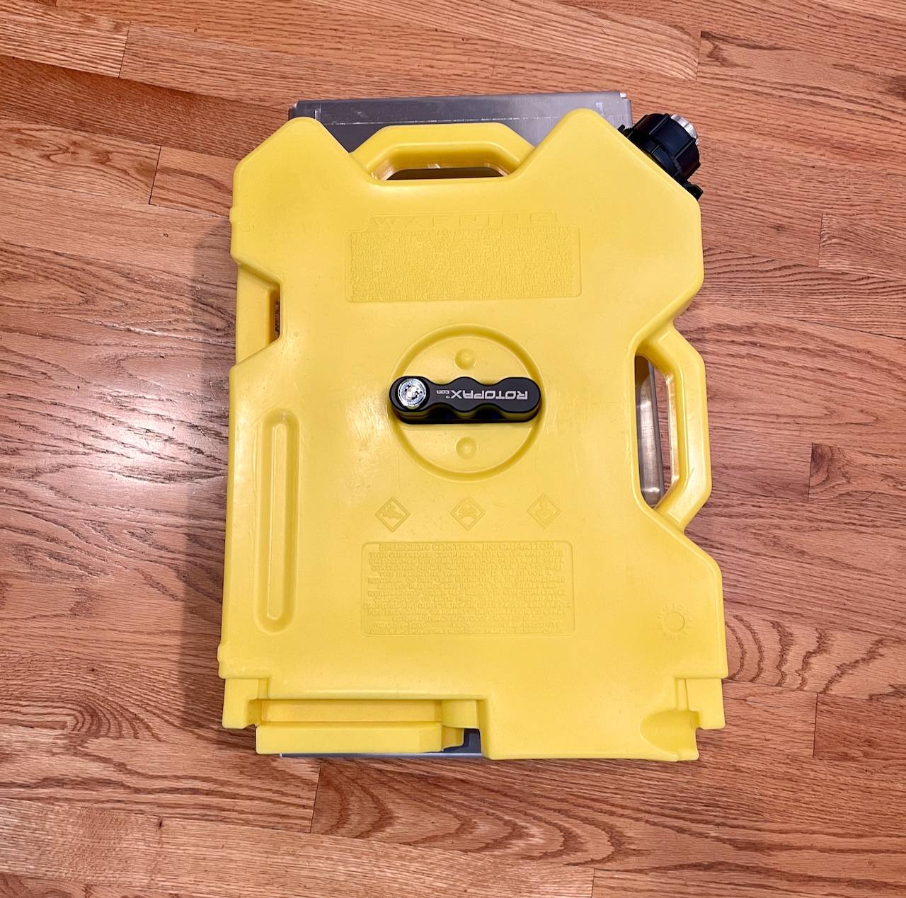

On the lid is a Rotopax mount pattern, to mount a one or two gallon Rotopax container:
Jeep Gladiator A new hope ... (build journal and component reviews) IMG_6379
Stuiff we plan to put inside the "box" (it isn't really a box, lots of venting going on around the edges, bends, etc., more like a deep panel):
Then the Rotopax with a fuel line disconnect on the outside.
The actual diesel heater will sit inside the cabin, with the ports going through the camper wall underneath the above panel.
Once we have all components sorted, additional holes drilled and everything lines up properly, we'll get the thing powder coated black and can finally mount it. That'll happen at some point in June since I'm away from the truck for a few weeks.
But, so far so good ... one big ticket item worked out.

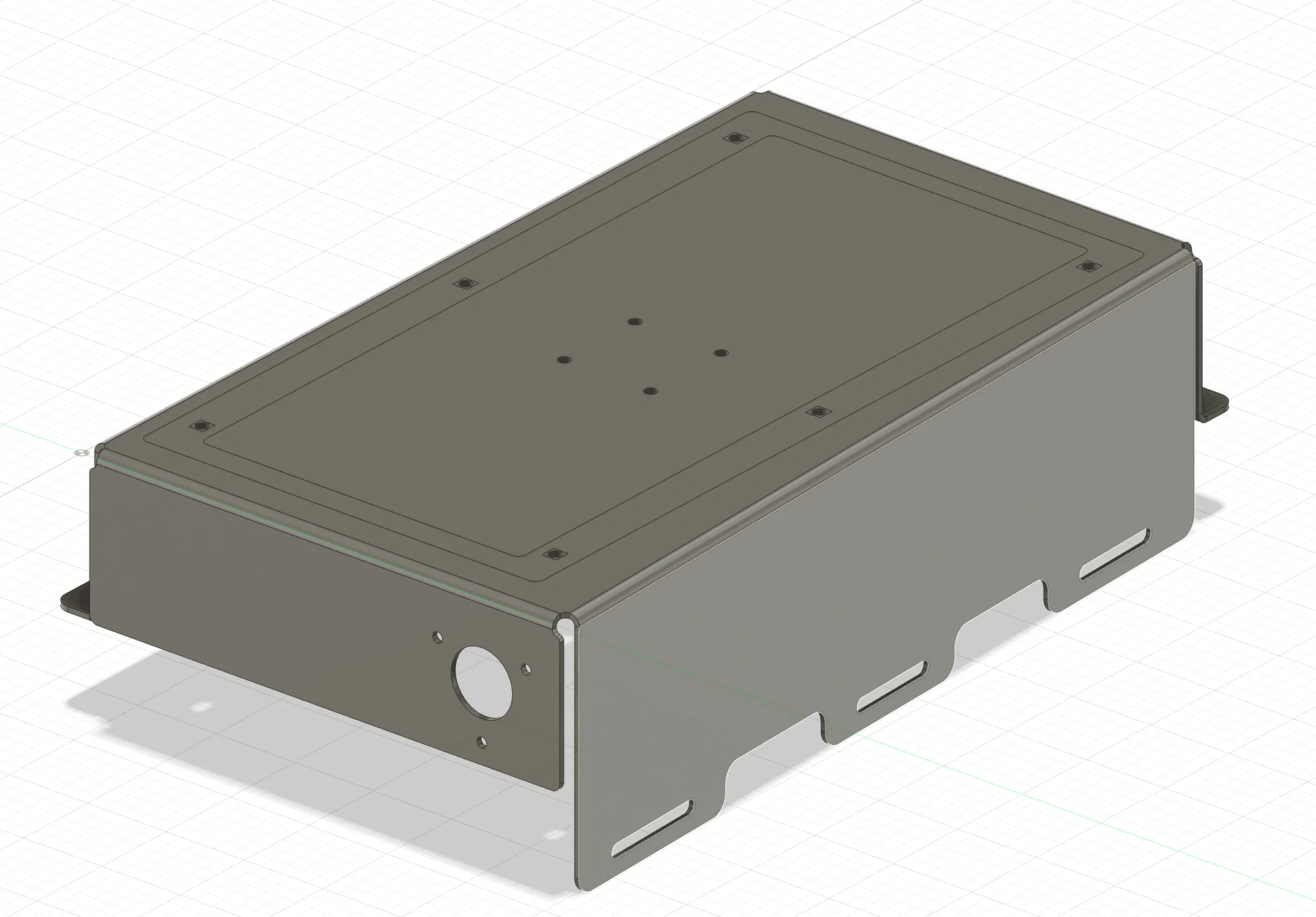

So, from this:
Jeep Gladiator A new hope ... (build journal and component reviews) Screenshot 2024-04-20 at 11.36.51
To this:
And there's only one stupid mistake – one of the top flange mounting holes doesn't work out, the horizontal c-channel in the camper is just 5mm too short. Actually, I had to switch from slots to holes and didn't think to make sure there is c-channel all the way to the edge ... grmbl.
