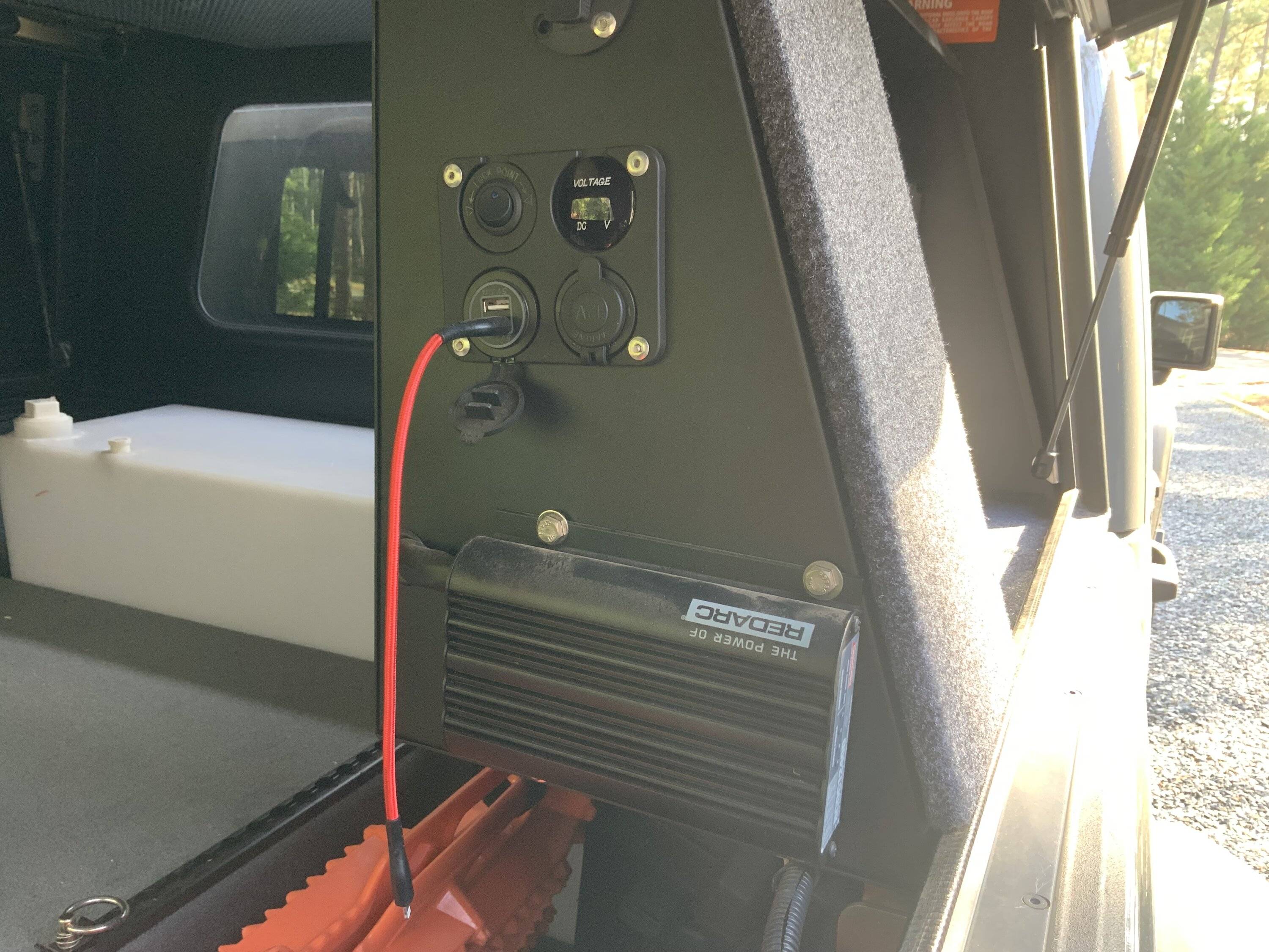

What kind of camping/overlanding will you be doing? This is at the heart of determining what you’ll need. I wired my truck myself even though I had minimal knowledge in the area, but it was fun to learn and like you said I now have complete knowledge of how the system works and if I would ever need to do any trail repairs I’m confident in my ability to handle it.
As far as battery monitor goes I ordered this:
https://www.amazon.com/Upgraded-Cha...1994665&sprefix=12+volt+,aps,172&sr=8-10&th=1
and it has worked fantastically. Here’s a picture of my set up in the back of my Alu-Cab with my Redarc below it on the side of the cabinet.
Jeep Gladiator A new hope ... (build journal and component reviews) IMG_1135

Ah, that's interesting, I like that panel. And I like the mounting you have done there.
Overall, this really isn't rocket science, I have enough electrical knowledge to understand what not to do, but not enough patience, tools, and experience to get wiring as clean as I would like it. I know a lot of folks who could help, but they are all in Europe.
Again, I think I might go with the EGON, but will likely follow your recommendation to avoid the Manager 30, since it's overkill (e.g. I don't need to monitor water tanks or do any remote switching. I might even go down the Victron route for the simple reason that we have these in our Land Cruiser in Europe and doing it by myself here with a very similar setup, I get a better understanding of that that car's electrical components "for free" instead of learning about a different set of typical problems ... ;-) But that part is still undecided.
But it all goes more and more towards a flexible setup that I can add to as needed instead of an integrated power station or having it wired by the shop.
Thanks for the pointer regarding the sale, unfortunately, that's not going to work for me this time since we are leaving for Europe soon and I will have to continue the build in late June / early July. I was considering the Battle Born batteries, two of the 100Ah should do the trick.

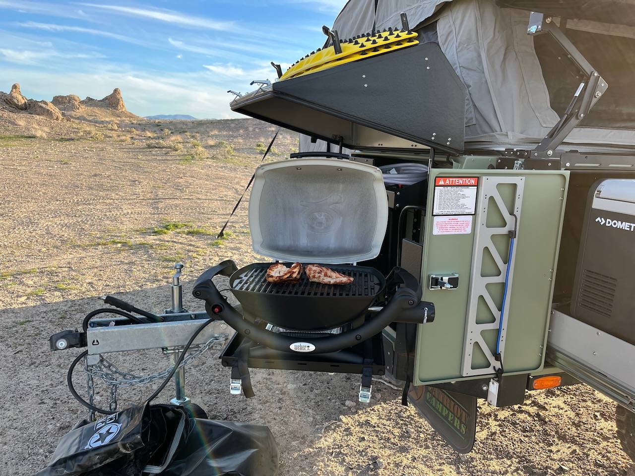

The biggest thing I'll be missing when not using propane at all is this one:
Jeep Gladiator A new hope ... (build journal and component reviews) IMG_5239
Jeep Gladiator A new hope ... (build journal and component reviews) IMG_5240
