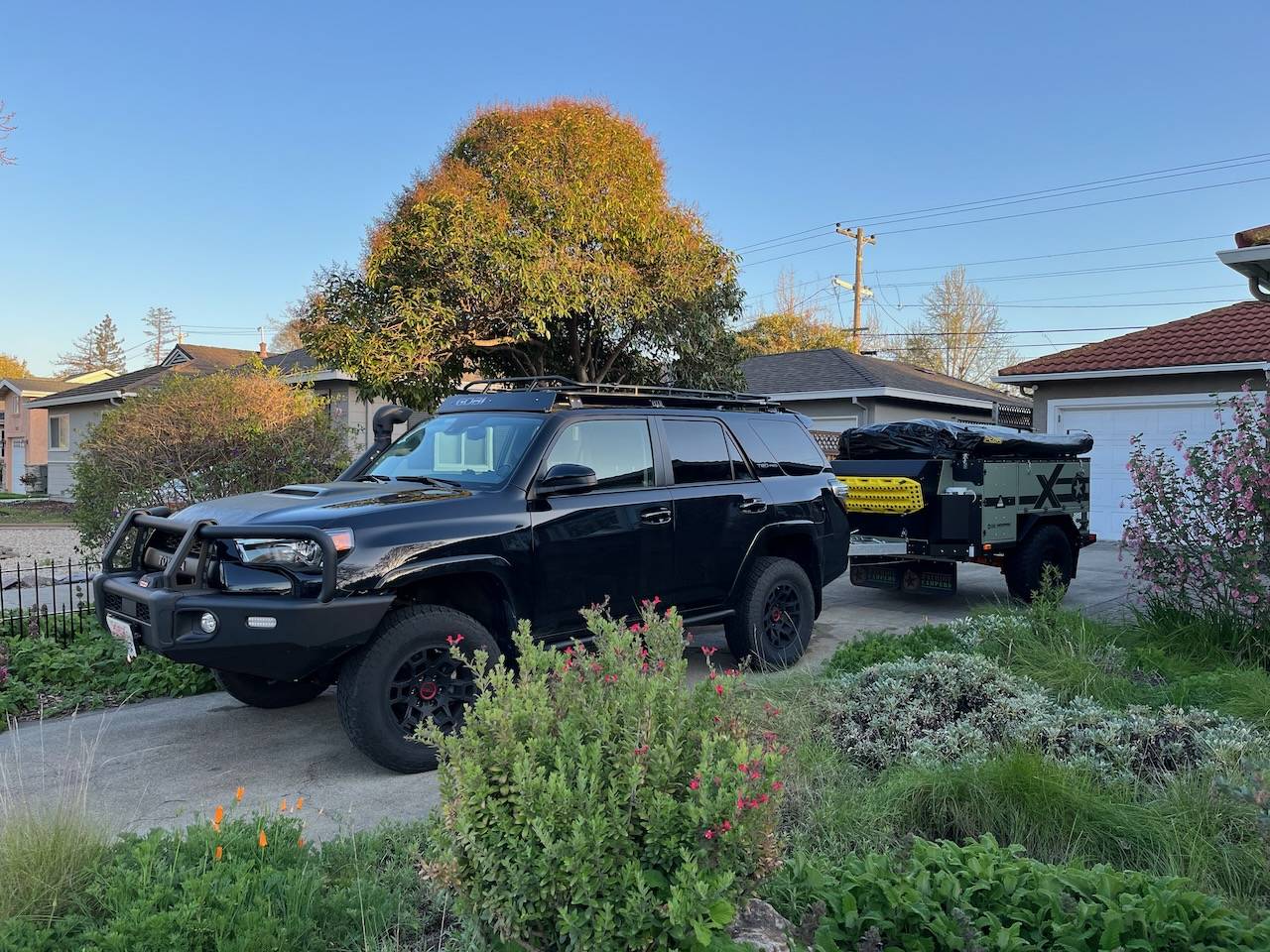

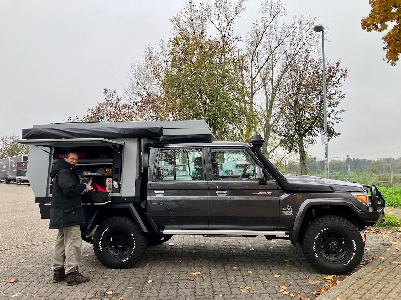

That Forerunner looks awesome!
That's the Land Cruiser 79 with the 4L V6 engine and manual transmission. It's still a thirsty engine, but due to the more efficient transmission it's about the same with the camper attached as the 4Runner all by itself without towing.
This is the 4Runner:

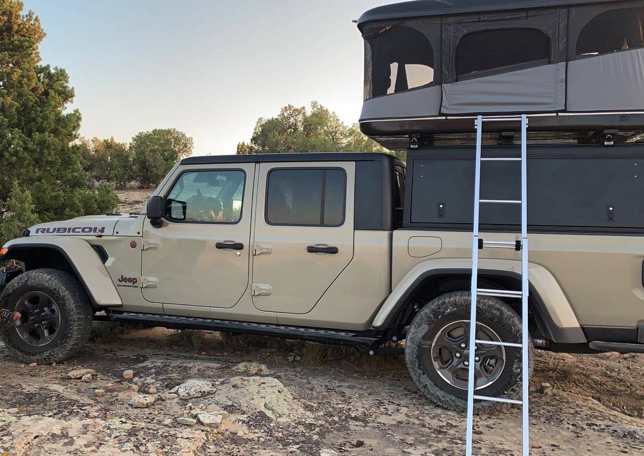

For comparison, I went from this:
Jeep Gladiator A new hope ... (build journal and component reviews) _ComparisonBefor
To this (with slightly bigger tires and lift):
Jeep Gladiator A new hope ... (build journal and component reviews) _ComparisonAfter
But the bottom line is, I don't squat under the load and don't bottom out my suspension on the trail.

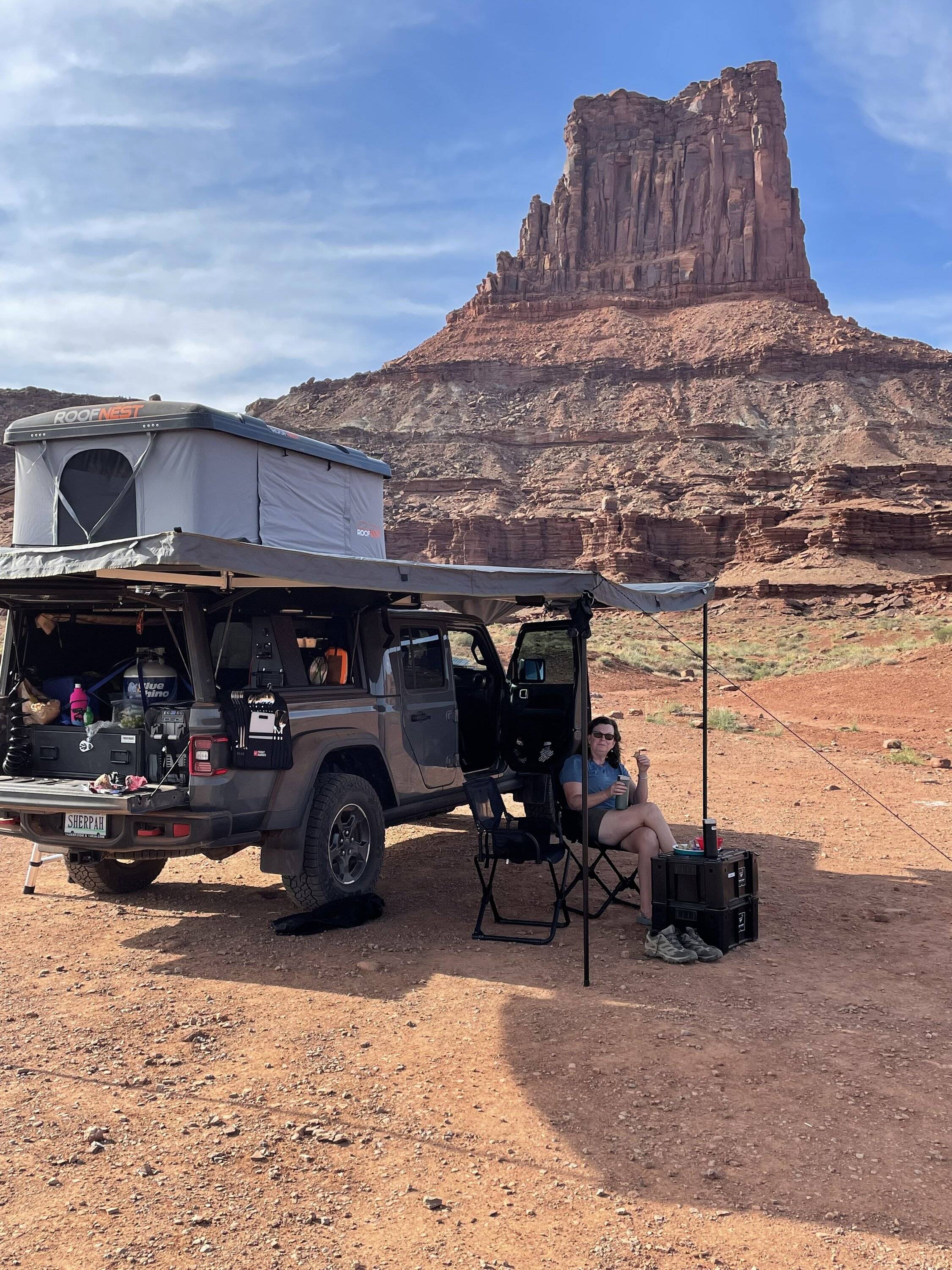

My set up is somewhat similar but I have the gas engine and since I already had a RTT just got the Alu-Cab canopy and outfitted the interior with water storage, second battery, fridge and a custom drawer set up.
As far as tires go I will be using the original Falken AT tires until they need to be replace later this year but will go to a 285/75R17 E rated tire that is just a bit taller (34”) but will also be lighter so hopefully it will be a net benefit. Those Falkens are very heavy! Of course tire choice is a highly personal thing but I have never felt that MT’s were necessary and that includes overlanding in Africa and South America. But that’s just me.

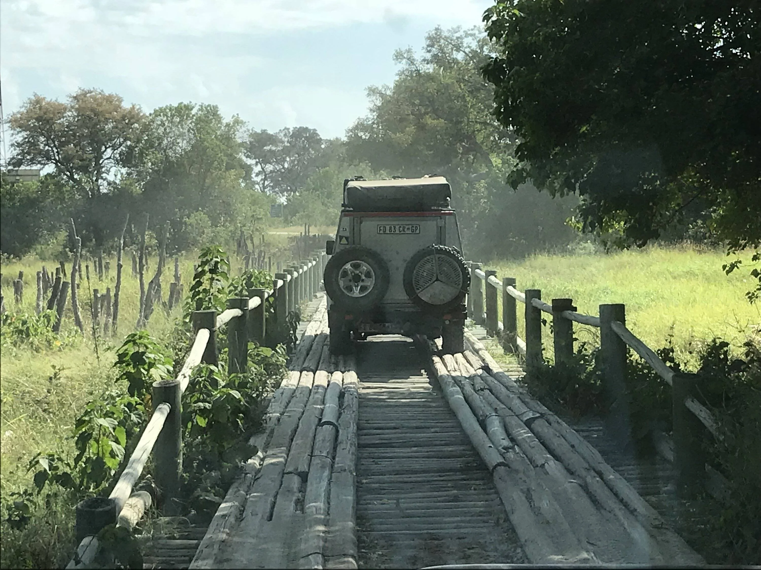

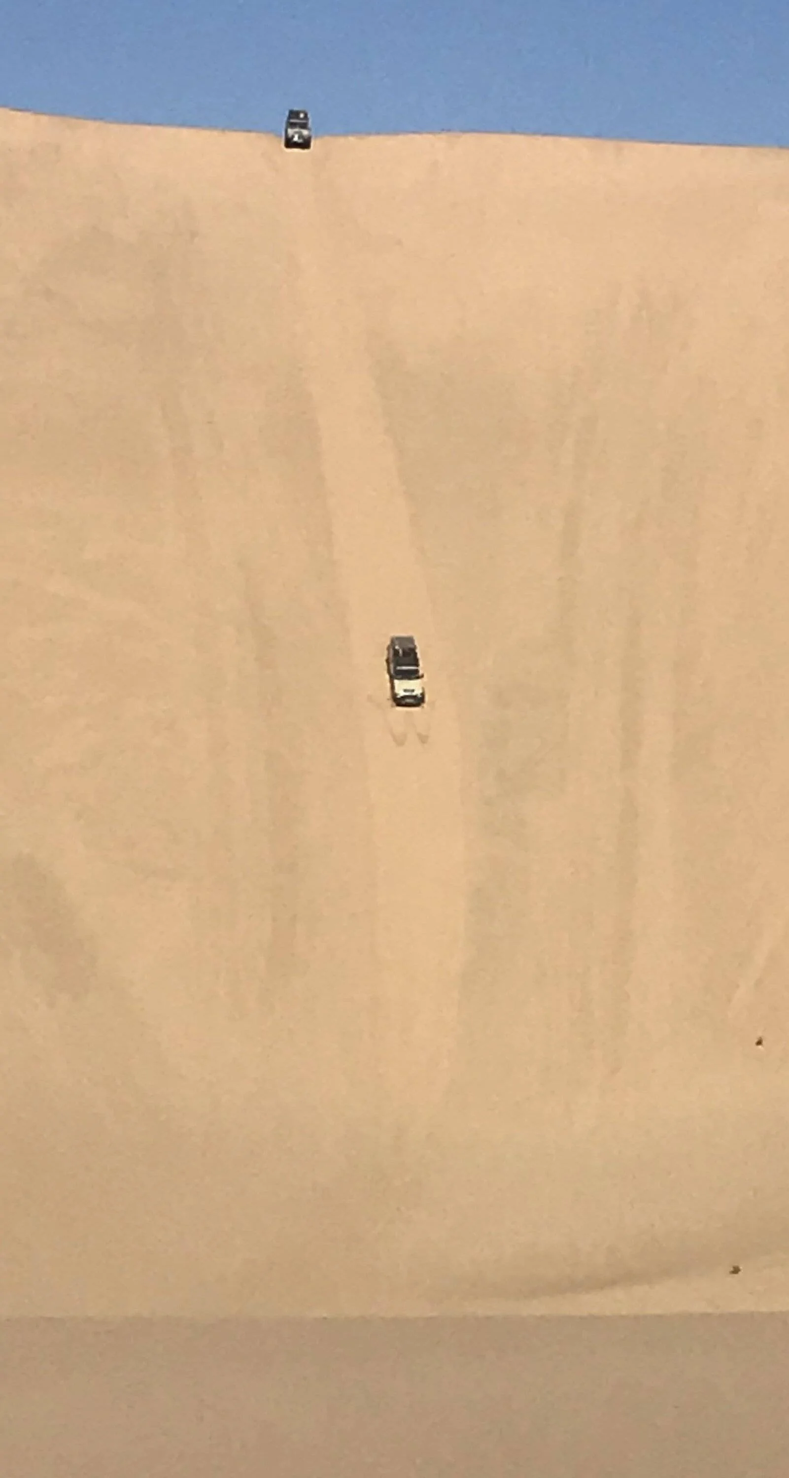

Like you, I’m very familiar with the 79 Series but in my case they were diesels. Truth be told if I could have bought one of those I would have but it’s not really possible given that they can’t be brought into epa compliance and crash test approval. Those trucks can carry a bunch and are very reliable plus they’re super easy to repair if needed.
Here’s a couple of pictures; one from Botswana and the other from Namibia
Jeep Gladiator A new hope ... (build journal and component reviews) IMG_0062
Jeep Gladiator A new hope ... (build journal and component reviews) IMG_0021

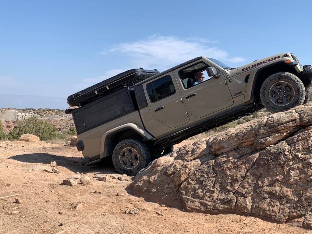

This is spot on! It's a truck and way different than other overlanding rigs. Here is a picture of our first outing to test everything out. I am literally pinned on my receiver hitch and required winching out.
Jeep Gladiator A new hope ... (build journal and component reviews) IMG_1707.JPG
I knew I was squatting pretty bad but figured I needed to understand the limits of the stock suspension...and I found it. LOL

LOL. I probably would have built a small ramp with Maxtrax boards, but this is also a situation where I might have gotten stuck ...
