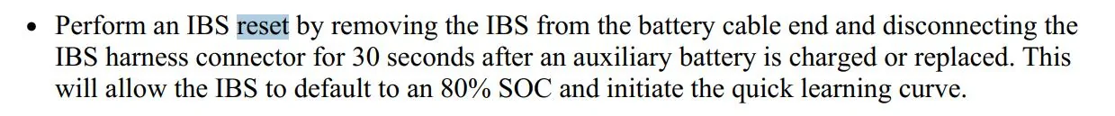

Disconnecting for twenty to thirty minutes isn't necessary to reset the IBS. Unbolt it from the battery post, disconnect the harness connector for twenty seconds, then put it back together.

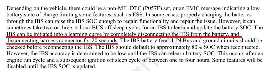

I like this! But highlighting the removal of the ibs connector for 20 sec isn't doing much good. Removing the ibs from the battery like it says is a better option. It doesn't make sense to reinstall the ibs on a less than fully charged battery.
Leaving the ibs installed and only disconnecting the ibs connector and batteries is sufficient, giving time for any remaining charge to dissipate.
One fender ground and one connector is far less work than disassembling the main negative post cables and cleaning it all up before reassembling. That takes time too.

Glad you like it, but you obviously need to read my post again. I never said to only disconnect the IBS connector, nor did I highlight anything that says to do only that. I highlighted and it states, "The IBS can be initiated into a learning curve by completely disconnecting the IBS from the battery, and disconnecting harness connector for 20 seconds." Please note the part in bold. It's not saying to remove all battery cables from the battery and disconnect the harness connector, it's telling you to completely disconnect the IBS from the battery, ie, unbolt and remove the IBS from the one battery post and disconnect the IBS harness connector for 20 seconds.
I also stated, " Disconnecting for twenty to thirty minutes isn't necessary to reset the IBS. Unbolt it from the battery post, disconnect the harness connector for twenty seconds, then put it back together. " At no point did I recommend to only disconnect the IBS harness connector, nor did I recommend to completely remove all battery cables from the battery.
Leaving the IBS installed on the battery and instead disconnecting both cables is not what the procedure calls for, nor does it need to be disconnected for twenty to thirty minutes for a reset. Following the factory procedure is perfectly sufficient.

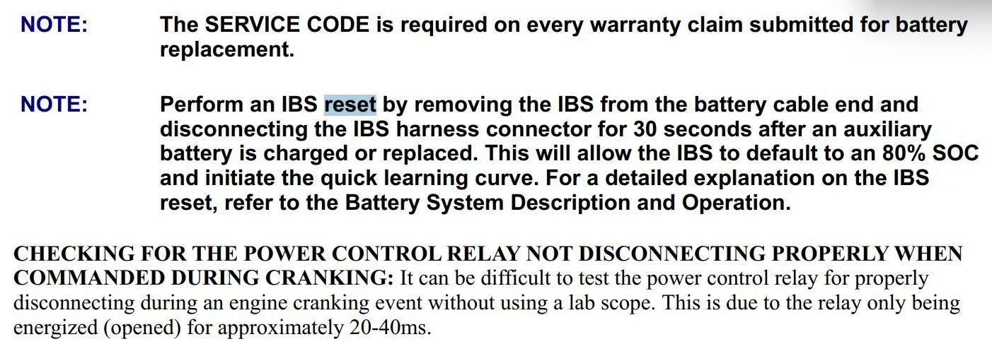

Here is direct from an FCA training document and applies specifically to Jeeps with the aux battery
Jeep Gladiator A Queichie! 1745517297454-86
Jeep Gladiator A Queichie! 1745517504057-qd
