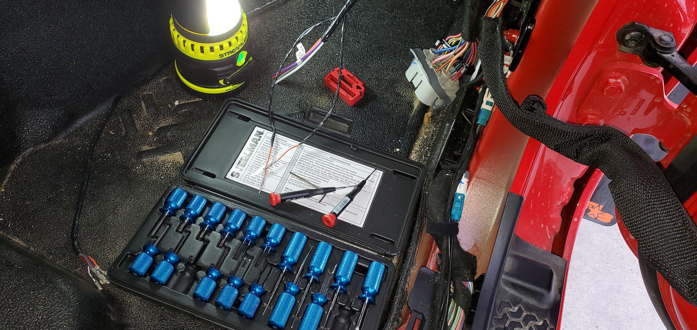

I've spent 3 hours trying to depin the orange wire. Depinning set. 50 videos. No luck. Insane. No pic or video has ever been posted about wtf you actually do with the depinning tools or small screwdriver. They just gloss over it...boom...click! Depinned. Probably going to finish the install except for the orange wire part and have the dealer do it. Can't 'practice' on my own truck.

@Fishee any tips on getting that orange wire out? 4 hours now. Not getting violent so as not to damage it. No amount of finesse or any of the 32 depinning tools I have do a thing. I can't understand the procedure.
I did manage to get the Aux harness and the power wire for the front cam CVPM through the nipple!
I dont think you want any tips from me. I ended up messing up my connector. Got the orange wire out and when I slid new one in it would bottom out and not "click" I could just slide it in and out. So I held it all the way in and snapped the red holder back on and it seemed to stay in place. But who knows cause my switches won't work. Didn't have time to mess with troubleshooting yesterday because I was trying to get ground fixed.

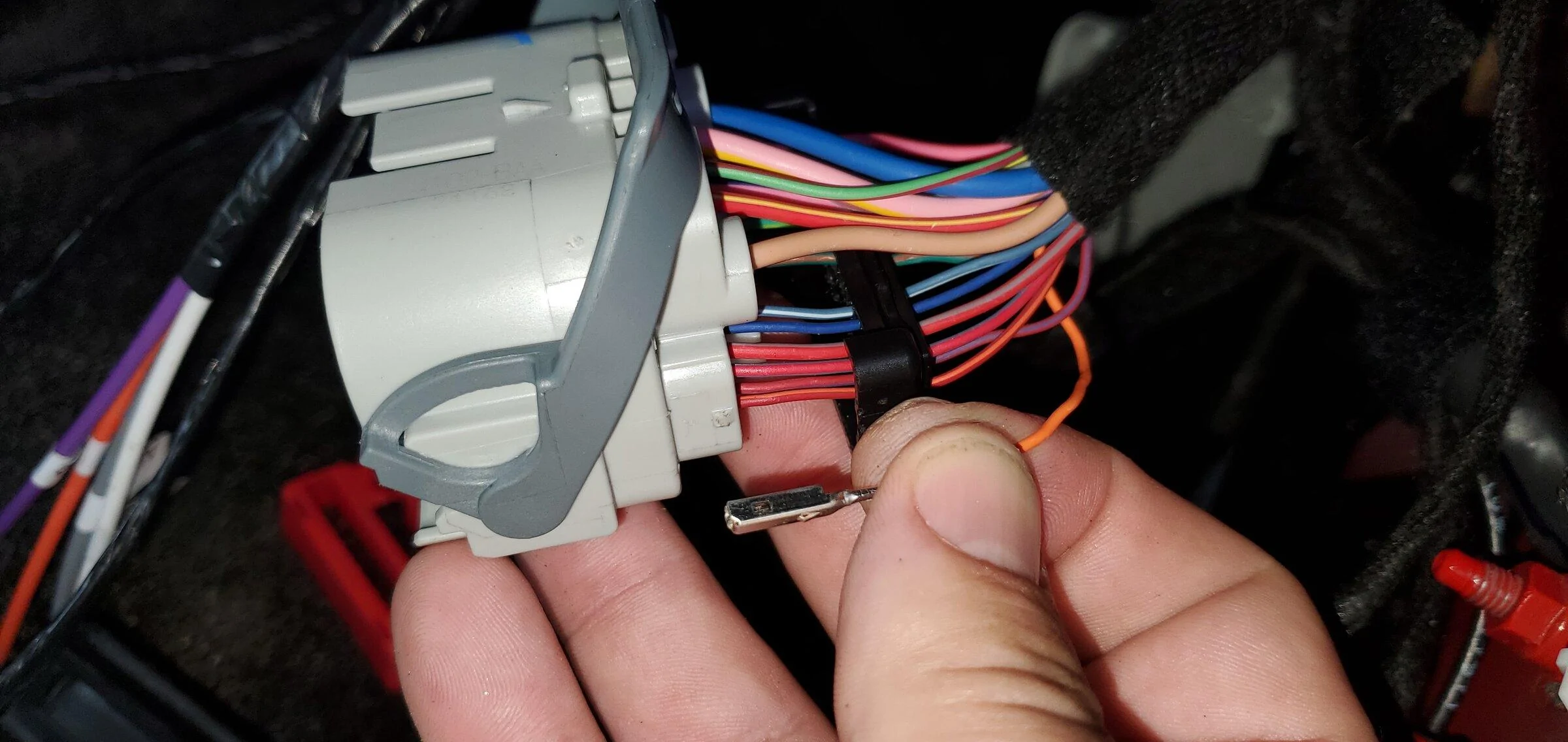

My life for 5 hours now. Still hasn't budged. Wtf is the secret sauce?
Jeep Gladiator AHHHHH!!!!WTF? Aux switch help! 20220402_072329
Fishee
Fishee
Feb 28, 2021
338
475
Ohio
2021 Jeep Gladiator Willys NACHO
Took that pic. Put phone down. 30 sec later...
Will make a video explaining.
Hope the video isn't 5 hrs ? that's what happened to me, bout to give up and boom it comes out. Again, I messed up my connector though
