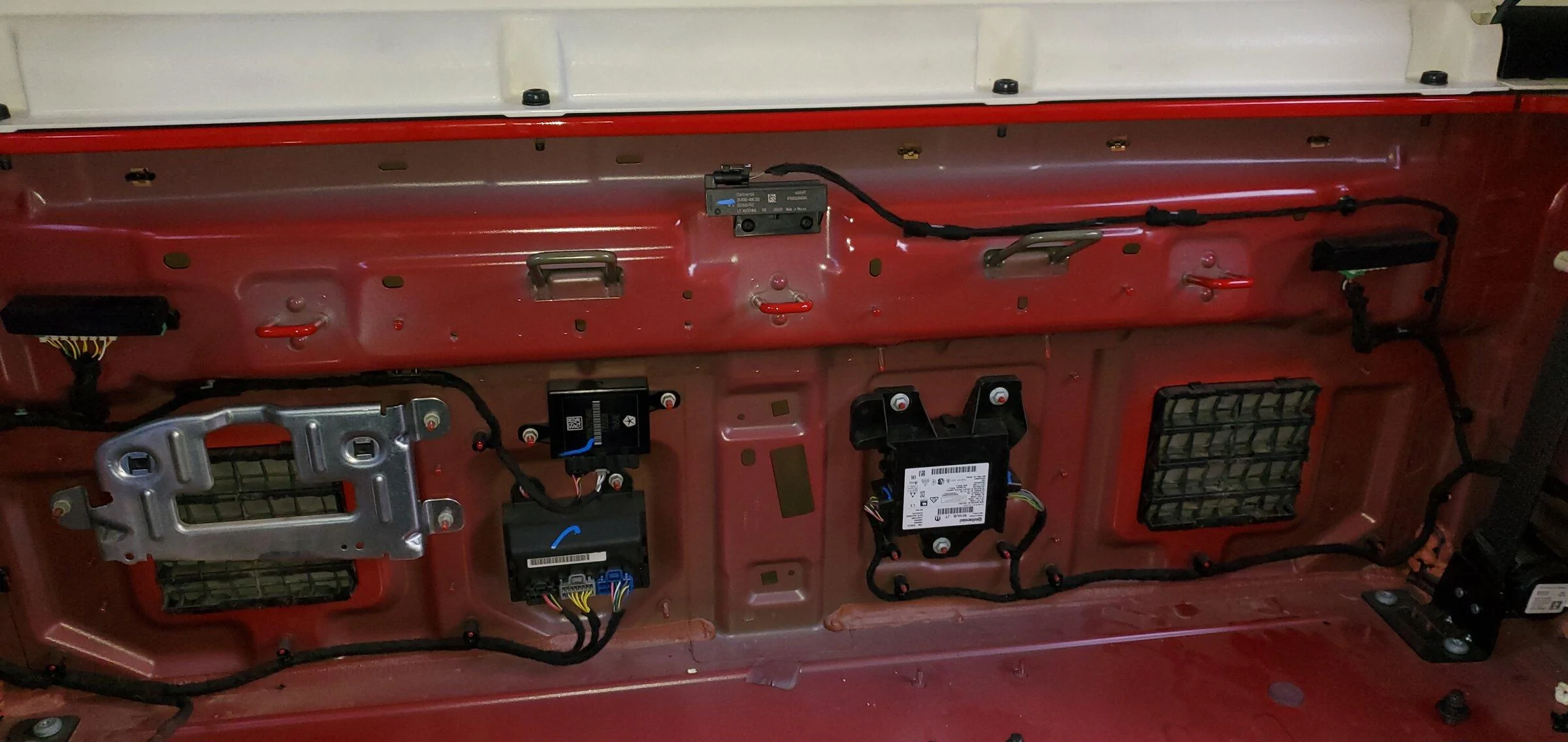

so I know that those wires will not stretch to the next bolt and the paint is probably the issue.. go to ace hardware, they make a threaded coupler for all-thread (hoping its 1/4 20) to join 2 pieces of all-thread together.. best option I got right now!

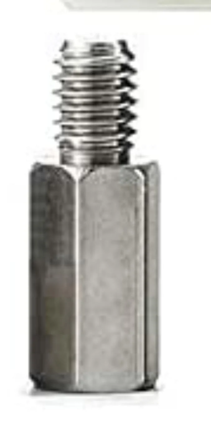

You have enough thread for this. Done. I would weld a large washer on it for the large cables to rest on. I would trust a 6mm stud to handle the load. They make larger stud extensions made for electrical connections , I'm still trying to find one on Amazon.

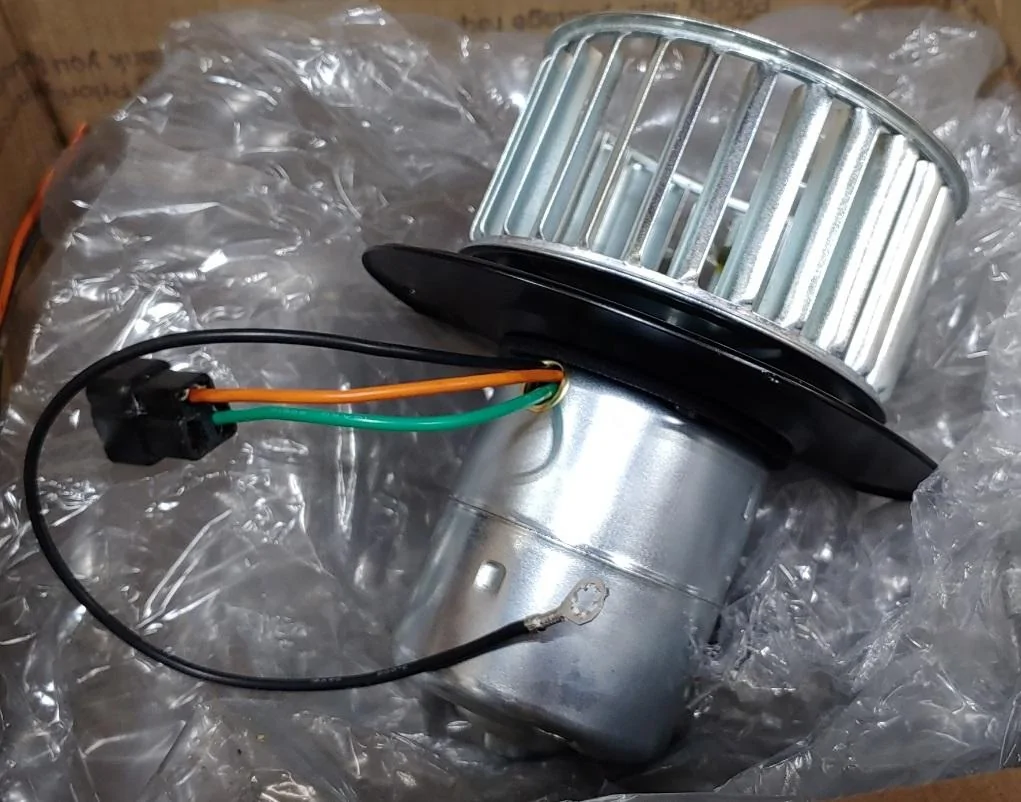

More than enough space for a ground loop and a nut. Use a flange nut and if it's a connector like the one with teeth I used on the blower motor I restored, it'll bite.
Unless the wire's loop is really thick or you need multiple wires there, I don't see a problem.

It appears that nut has been removed before. When comparing the end of the stud in your hand with the end of the other painted stud, I noticed the paint has been stripped off the thread tips. Possibly whoever removed and reinstalled the nut before, over torqued it. As others have said, I would just use the other stud. The OCD side of me would grind/file that broken stud down smooth and touch it up with paint. The overly OCD side of me would grind the entire stud down to the plate, find a stud/bolt that is identical to the existing one, have a friend TIG weld it, and touch up paint to match.

Yes, it's been off before - the paint off the threads and you can see where the wrench gripped the nut on the clockwise parts of the flats.

On a side note, there were 2 connections on that bolt, 1 of them won't reach that front bolt and I may have enough thread split them and dob1 on the front and 1 on the back. GREAT observation on seeing someone took that bolt off before. I didn't notice that and that would explain it that front bolt along with all other 10mm bolts came off with no effort. Again I didn't put hardly any effort into taking the broken one off, just twisted right in half. Must have been dealer? I got it new.
I just turned mine last night after reading your thread. It came off easily. Yours was probably hit too hard on the assembly line.
