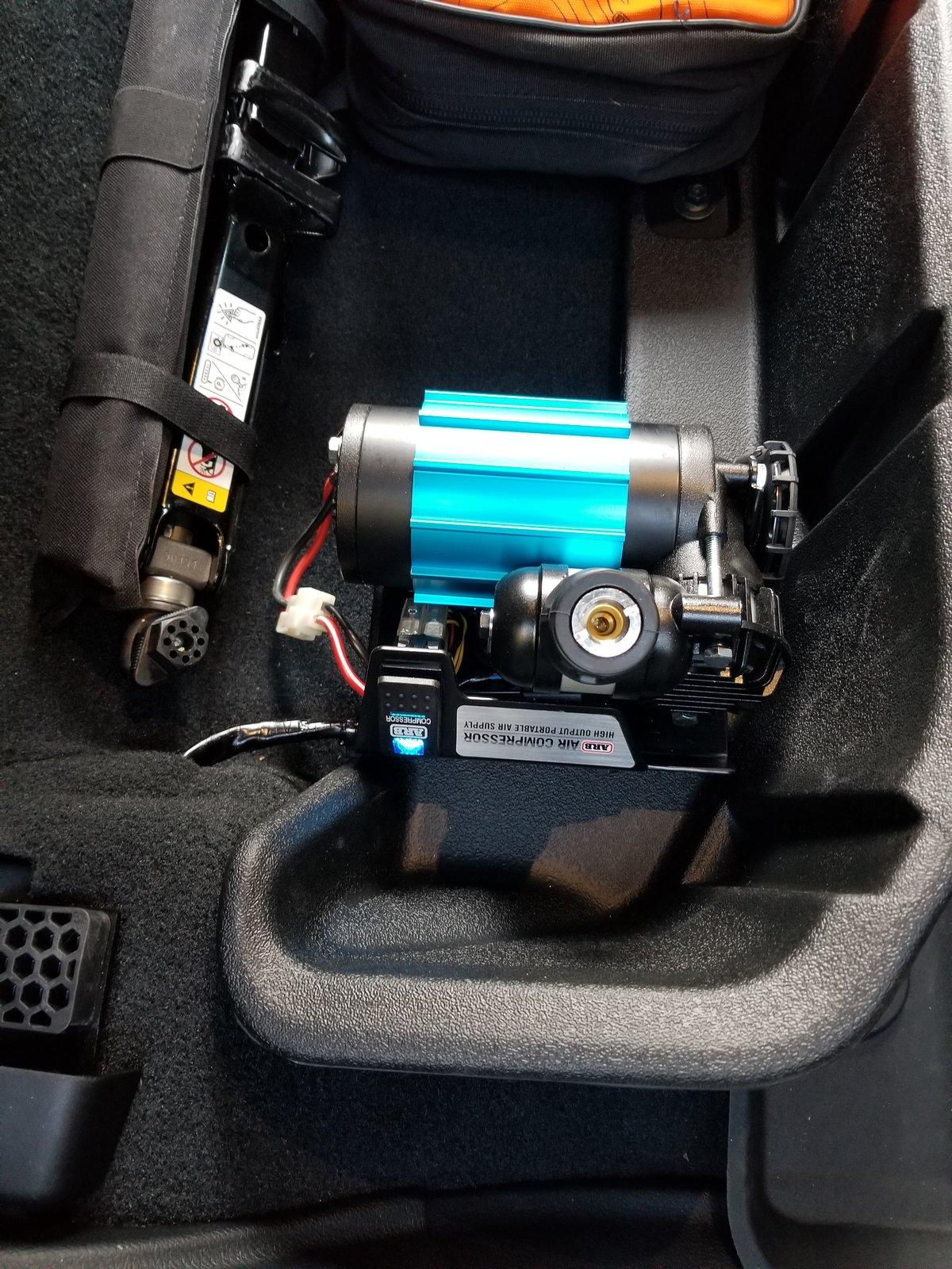

I did an under rear seat mount with the smaller ARB toolbox portable de-boxed.
Simple black and red wire hookup to aux switches.
I used the same place for the twin ARB compressor; I did have to take out the scissor jack. I'll find another place for that. The hardest part of the install was running the wire loom through the firewall. The compressor works great and it's easily accessible under the seat, while still being out of the way when my kids ride in the backseat.
How did you actually mount the compressor? I used my old Teraflex bracket from my JKU and modified it to have the bracket bolted down to the body bolts.
It's why I bought the portable, all the compressor wiring and switch are all integral, and it's mounted to a little plate in the toolbox.
I turned the under seat divider into the mount. There's the flat spots towards the end and the small compressor fits on them. Drilled the unit out of the toolbox, then enlarged 2 of the holes on the side opposite the switch large enough to put a small bolt through. Used them to template a spot to drill 2 holes through the under seat divider (I took it out to do it, 4 torx bolts) I just happened to have some little bolts with flathead screw heads and backed them with a wide but thin flat washer, and attached it to the under seat divider and put it back in place. Had to be careful to leave enough room to get the one screw back in through the inside of the compressor mount and wiring, but I don't think it would have mattered, it just holds it down and it fits onto square pegs.
Not very destructive even if I was to take it out, the plastic thingy under the seat would have a couple small holes in it, and if that was really bothersome for whatever reason it could easily be replaced.
Since it's a portable, it had a several foot long battery lead with alligator clips, just red and black. Snipped off the clips, and routed the wires under the carpet and up the door edges under the trim pieces, just swear a lot and pop them out, other than one bolt on the front one to remove to get to the ground point there. I didn't go nuts with it, just enough to tuck the wire away neatly. There's even a little cut already there in the carpet in the back where you see I ran the wire lead through.
Hook the ground to the ground point and the red to one of the 40 amp aux wires.

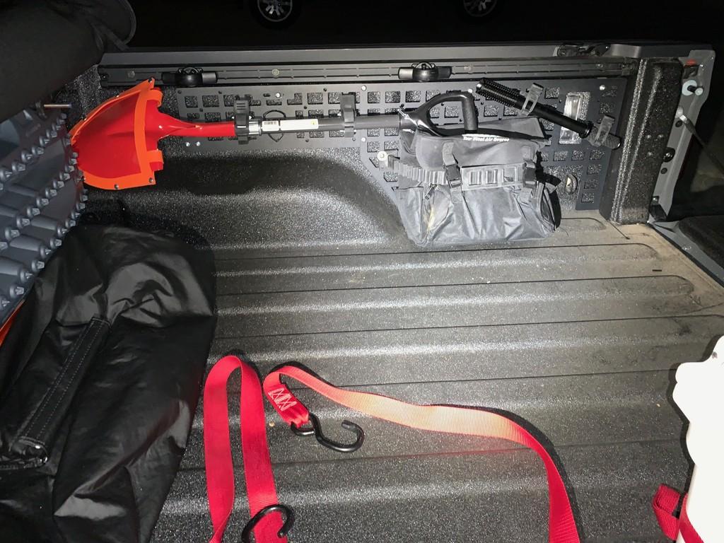

I also use the Viair 440p. I have mine for a long time. No issues. Only Viair rated at a full 3 CFM, but, not a 100% duty cycle compressor. It fills the tires fast. I keep mine in the bed in the Viair bag with all the hoses. I use a large Quick Fist to secure it to my molle panels and the Krazy shovel handle keeps it from bouncing while wheeling. Here is a pic.

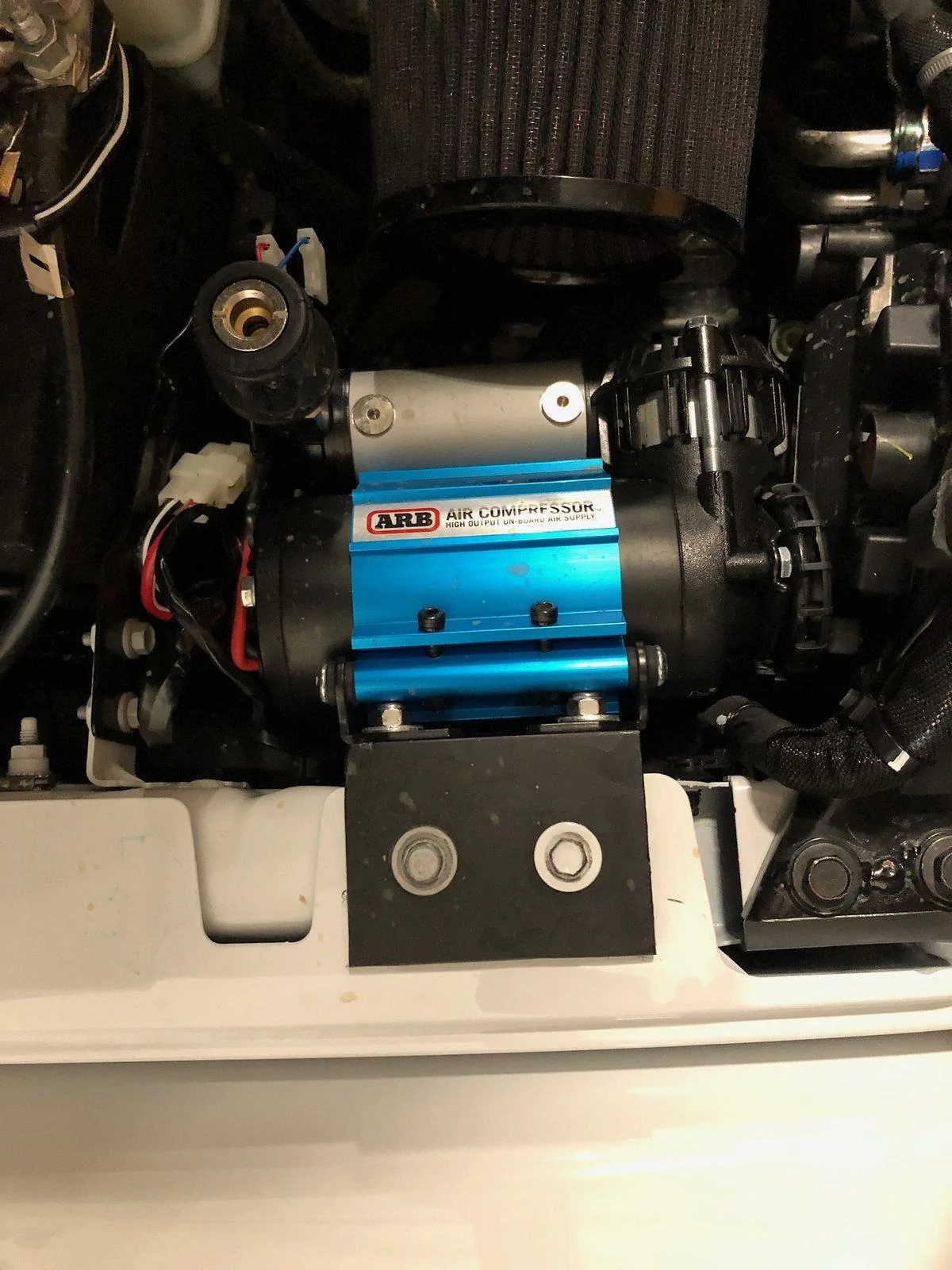

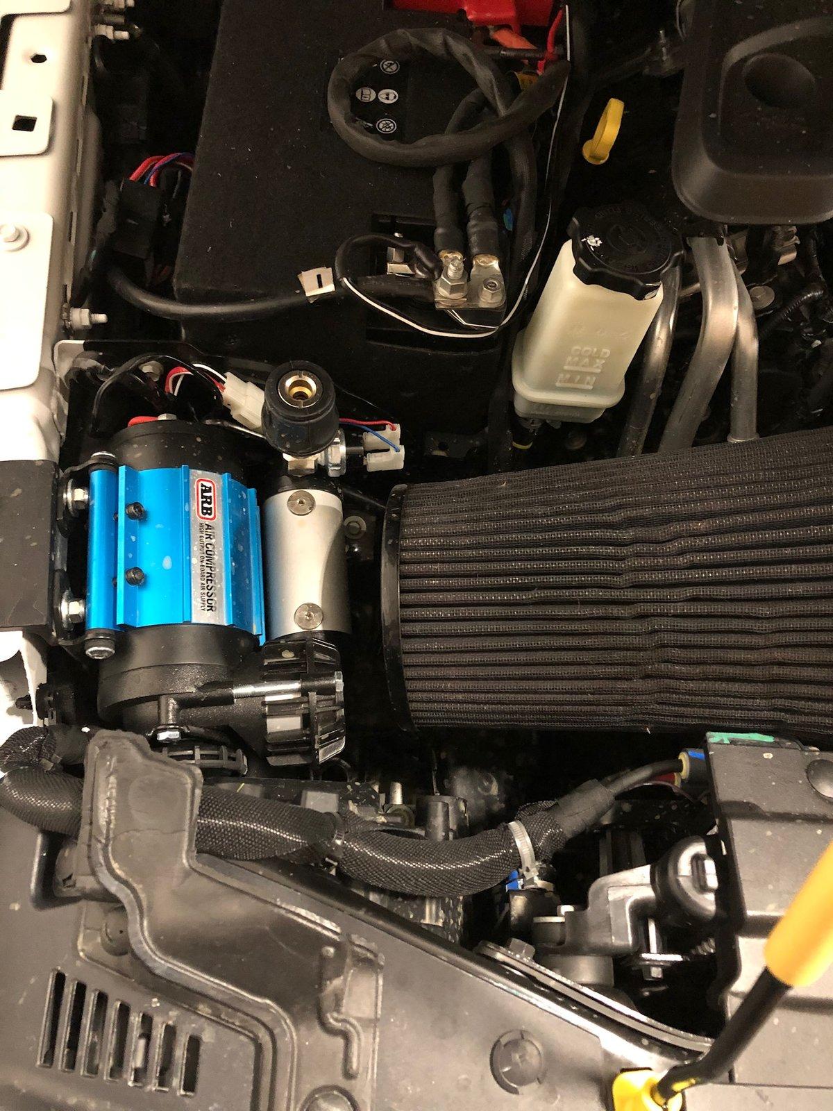

I installed my single ARB under the hood with excellent access. To create the space, I removed the factory air box and installed a conical air filter that I had used on my previous JKURX. A piece of aluminum angle that I had on-hand, so ultimate net cost was zero beyond my new compressor.
