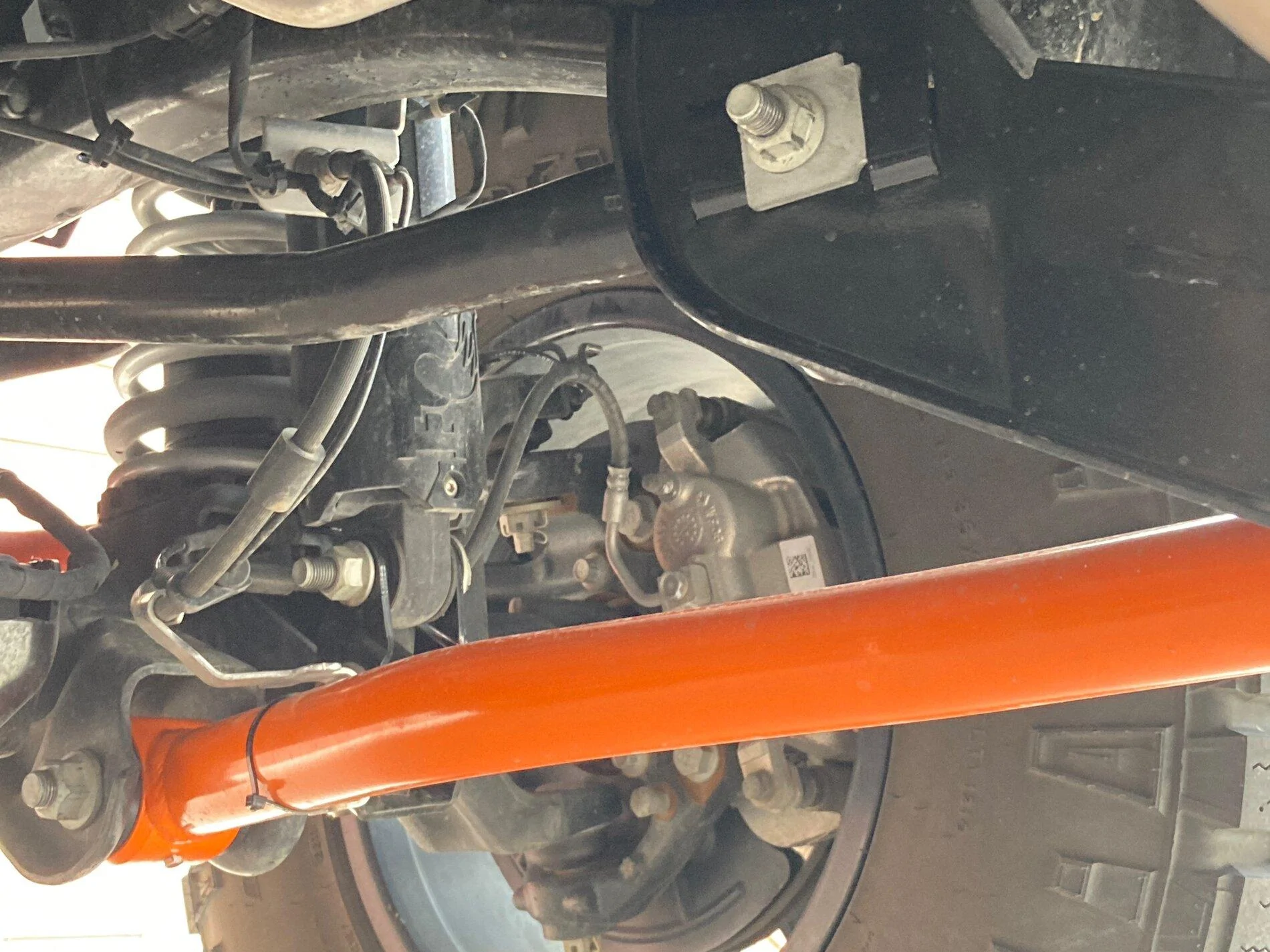

It’s where your upper control arms bolt into the frame/drop bracket. The installer or alignment tech may have rotated them incorrectly, or your control arms (if adjustable) may be measured wrong. Which arms are you running?
I hope this picture is the right spot. The square nut looks the same on both sides. The arms are Core4x4 and the bracket is AEV.

Interesting that off-center square is in a position to move the upper arm clear forward. That takes caster away (moves it in the negative direction)
So they had two ways to make caster in spec - move that square to move the upper arms back just a little, or adjust the lower arms to extend them a bit.
Those blocks should be in the same position on both sides so if they are the same, that is correct.
That block does the same thing as the eccentric on lower control arms of older cars, except for them it was setting camber, not caster -

Your lower arms are too short, and it looks to me like the square washers are installed the wrong way, pushing the upper control arms forward, decreasing caster.
Yup - those blocks should be flipped on both sides to pull the upper arm back.

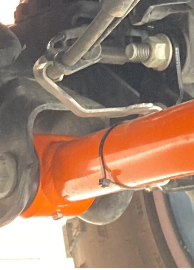

I also don’t like what they’ve done with your brake line brackets. They bent them to decrease your extension, and zip tied the bracket to the bar.

If the lift was installed per the instructions, the lower control arms would be set at 24”, and the washers oriented as specified below. Note the square and rounded corner notches.
LOL they got BOTH wrong - lower too short and upper pushed forward.
I was guessing that the uppers should be set to "medium" and that's what you are showing. Not clear forward, not clear back, one of the two middle choices.
I'd say they messed up - and good find on the tie strap on the lower arm. Ugh.
