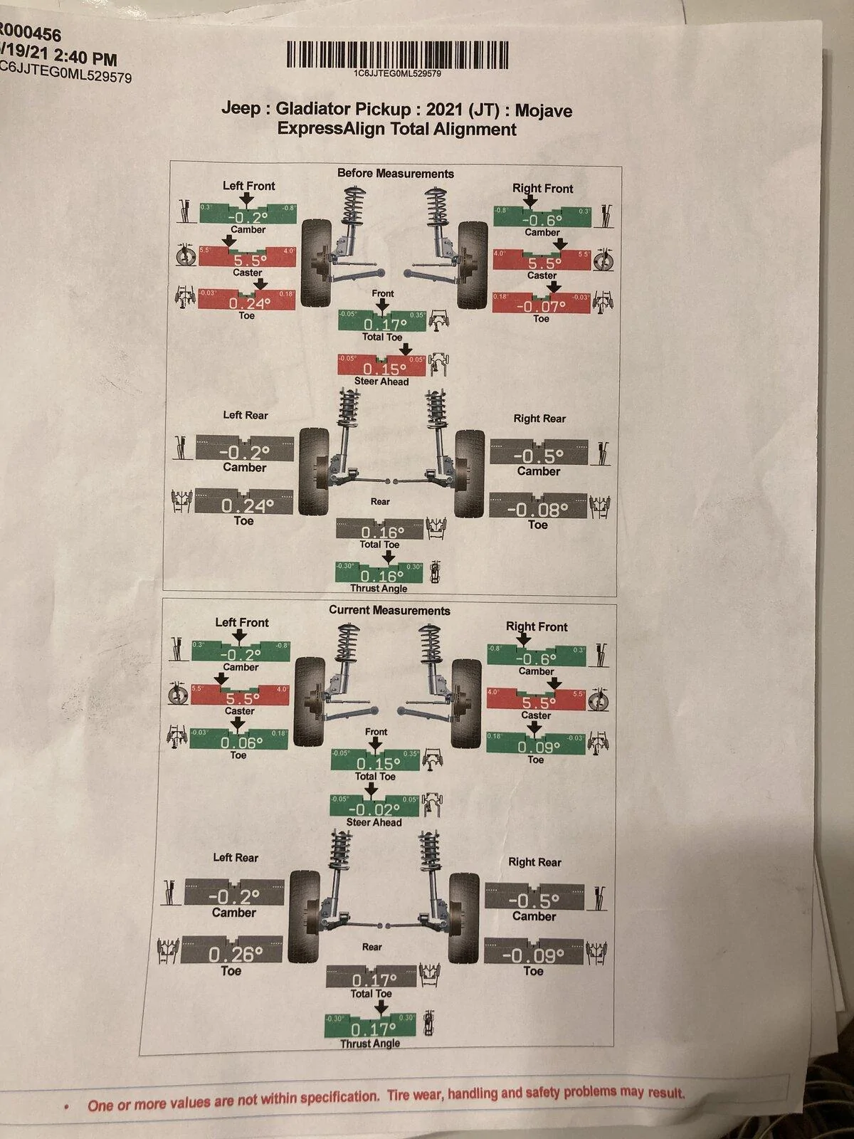

If the lift was installed per the instructions, the lower control arms would be set at 24”, and the washers oriented as specified below. Note the square and rounded corner notches.
Took the Mojave back to the dealer that did the install. They corrected the Square Nut position issue and control arm lengths. They did another alignment increasing the caster to 5.5 and the difference is drastic. Drives just like it did the day I purchased it.. Here is the new alignment seat. Thanks again to the guys who helped me get this issue resolved!!!

Caster is a huge thing for stability, preventing wandering and for the vehicle wanting to go straight (and recentering after a turn). What does surprise me is that they didn't really read directions.

Just left the alignment shop. With the brackets on the highest setting, my caster was at 5.88 on both sides. Im happy with that. (Stock everything besides aev 2inch kit + geometry correction brackets)
