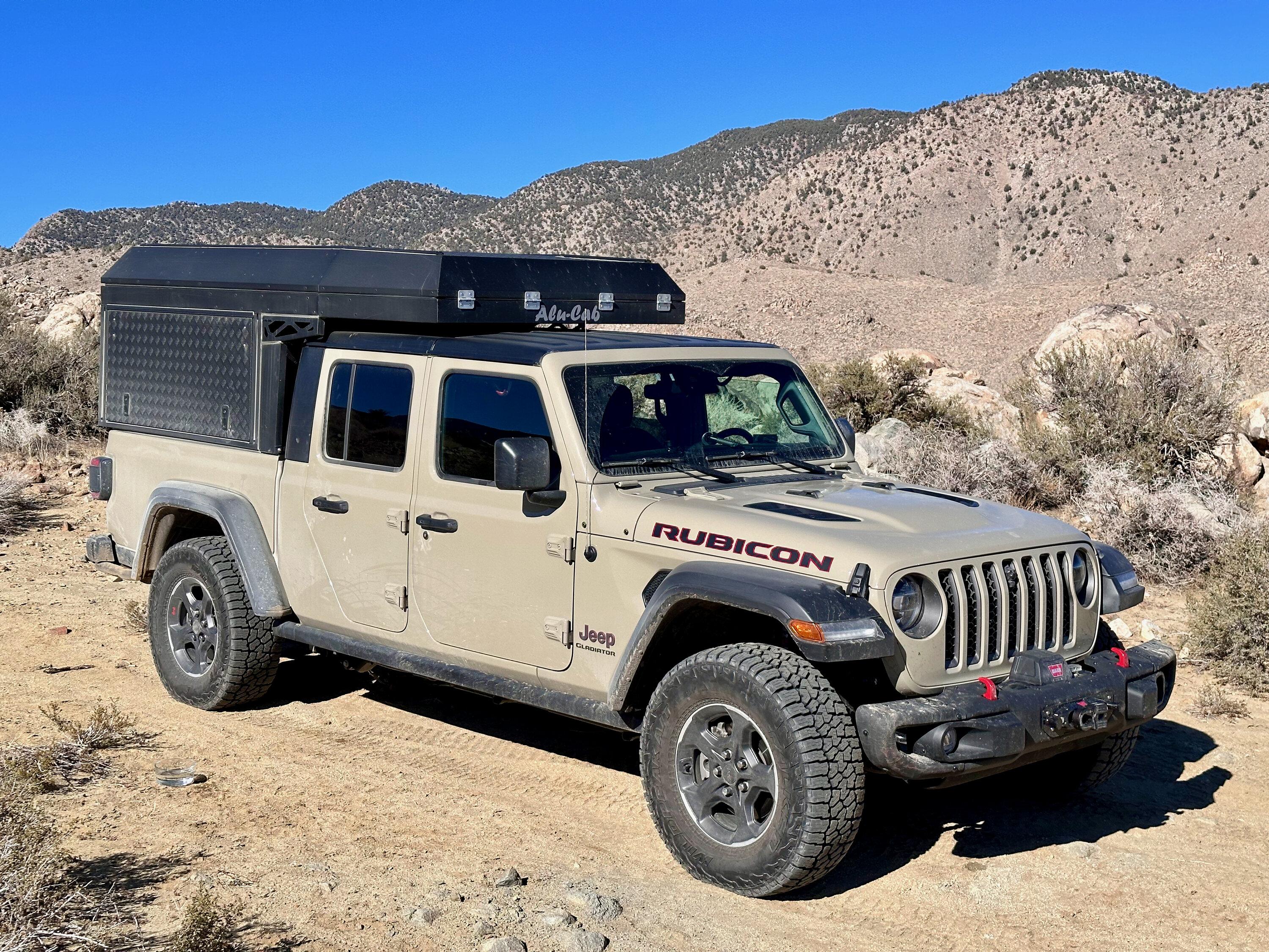

+1 to everything above. 22 JTDR + ACCC + winch, just finished a week around Death Valley with 2 ppl + 2 dogs + a week's supplies on stock suspension. Slow crawled up Lippincott Mine Rd and Silver Canyon (White Mtns) like a champ, soft stock suspension flexes great lol. Not much uptravel but plenty of down :) Floats real gentle on ungraded washboard - as long as you spot the dips and washouts coming and crawl over them slow. Rear has a little more uptravel than the front, but the rear control arms are just a little inverted (ie frame side lower than axle side). Took it very easy, no problems, and came back out into service to order a complete suspension kit on black friday :)
All in all I wouldn't recommend wheeling it stock, but if you're cautious it'll be OK until you can get your proper suspension in.
