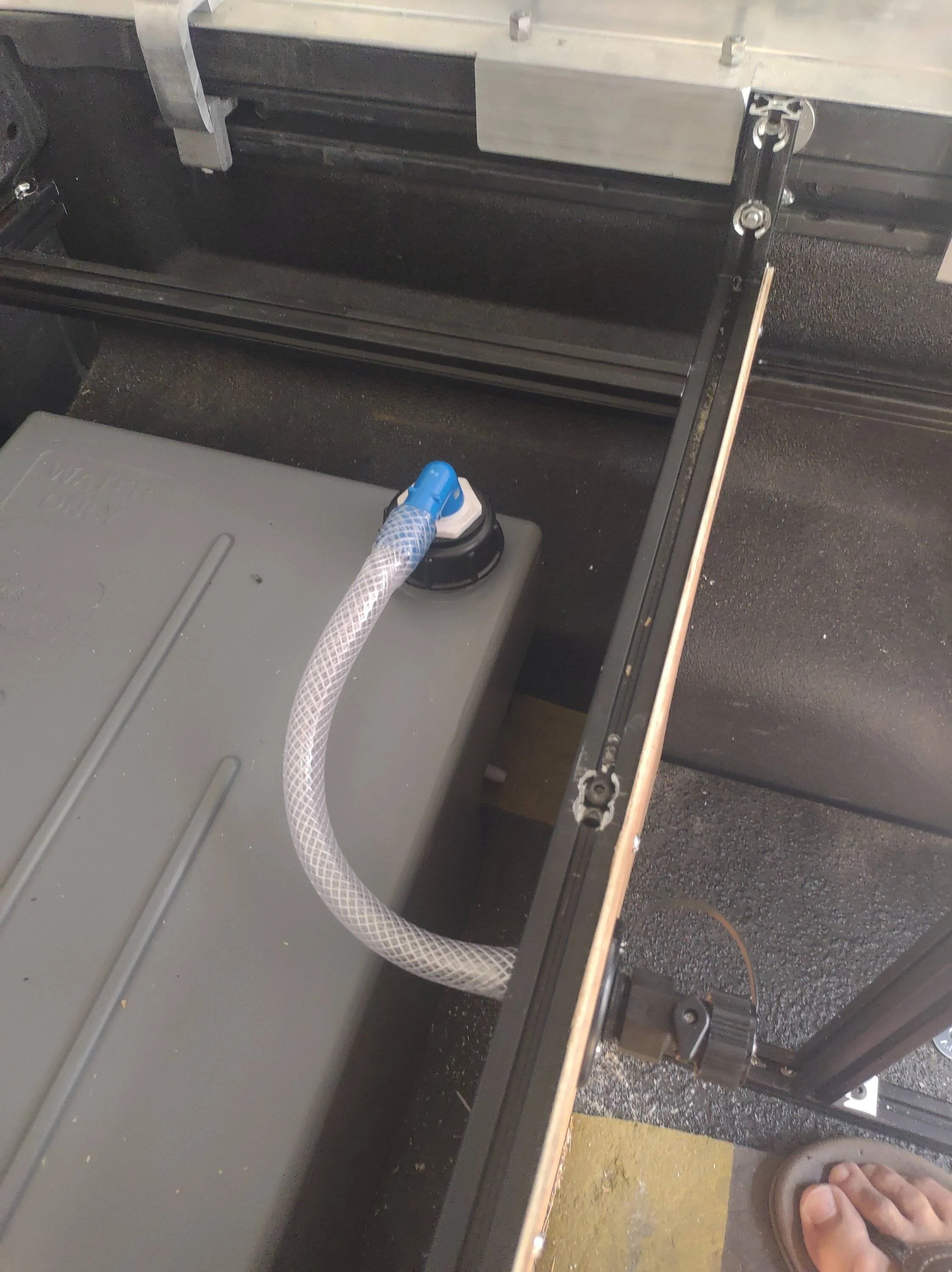

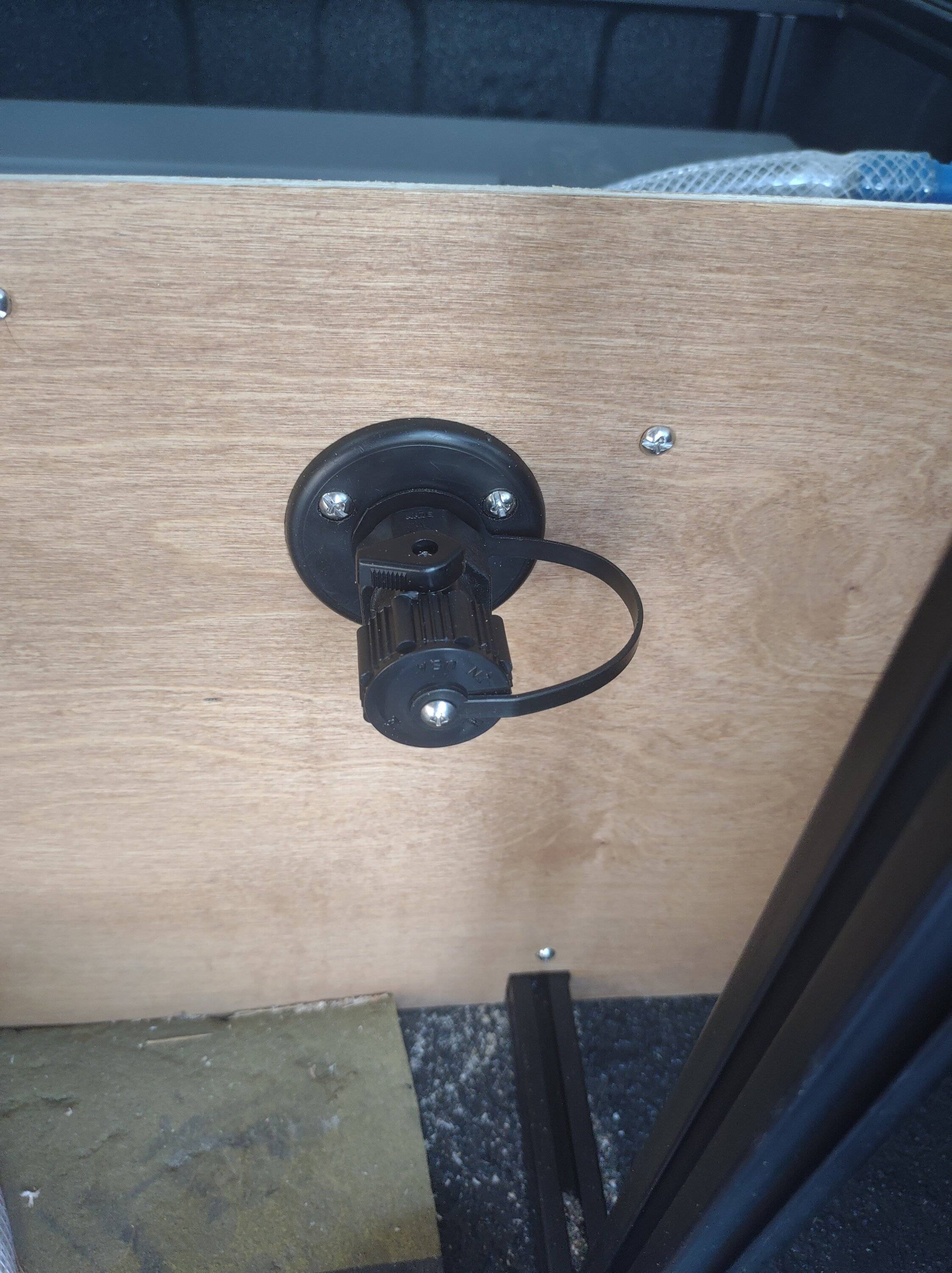

Not an ACCC but it's my idea of how to refill water. Took a water heater drip pan drain and modified it. Cut a hole directly into the cap and plumbed it in. Then found this Johnson marine bulkhead fitting and used that. For my threads because I was limited in height I used a heated up 3/4 steel pipe to make my own threads on the PVC. Pretty much all home Depot stuff. Boiling water helps stretch the hose out without burning it as well.

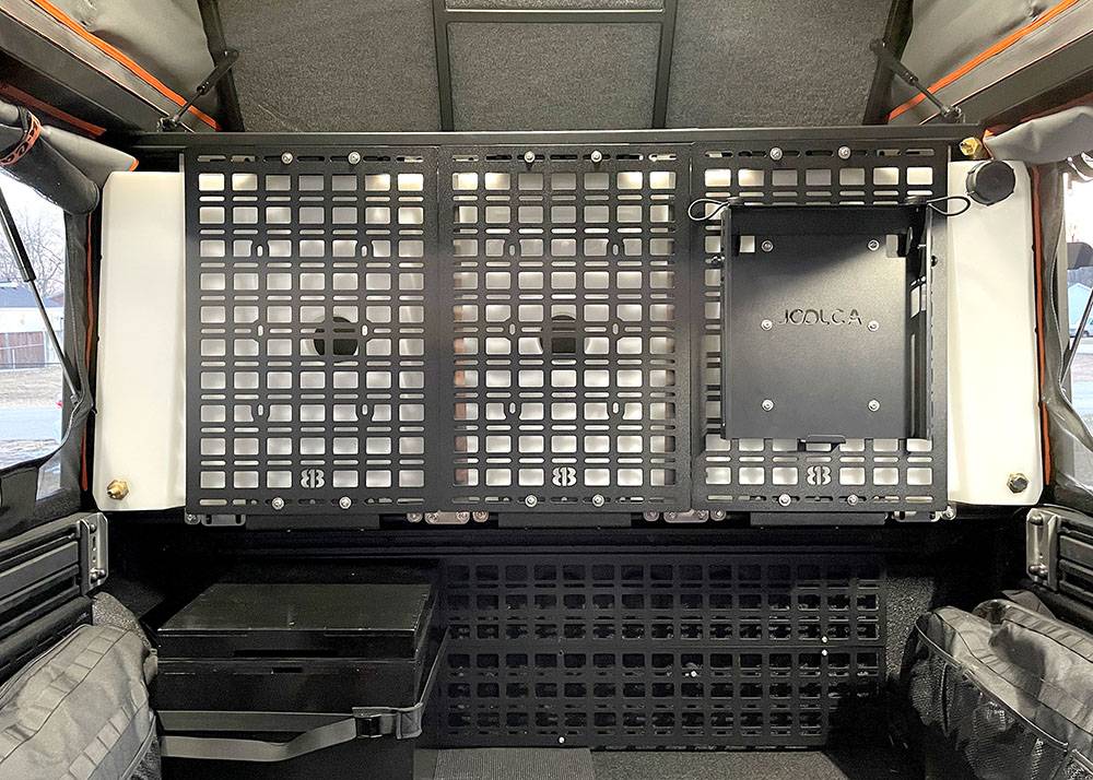

You can see it strapped to the CabSide MOLLE Panel

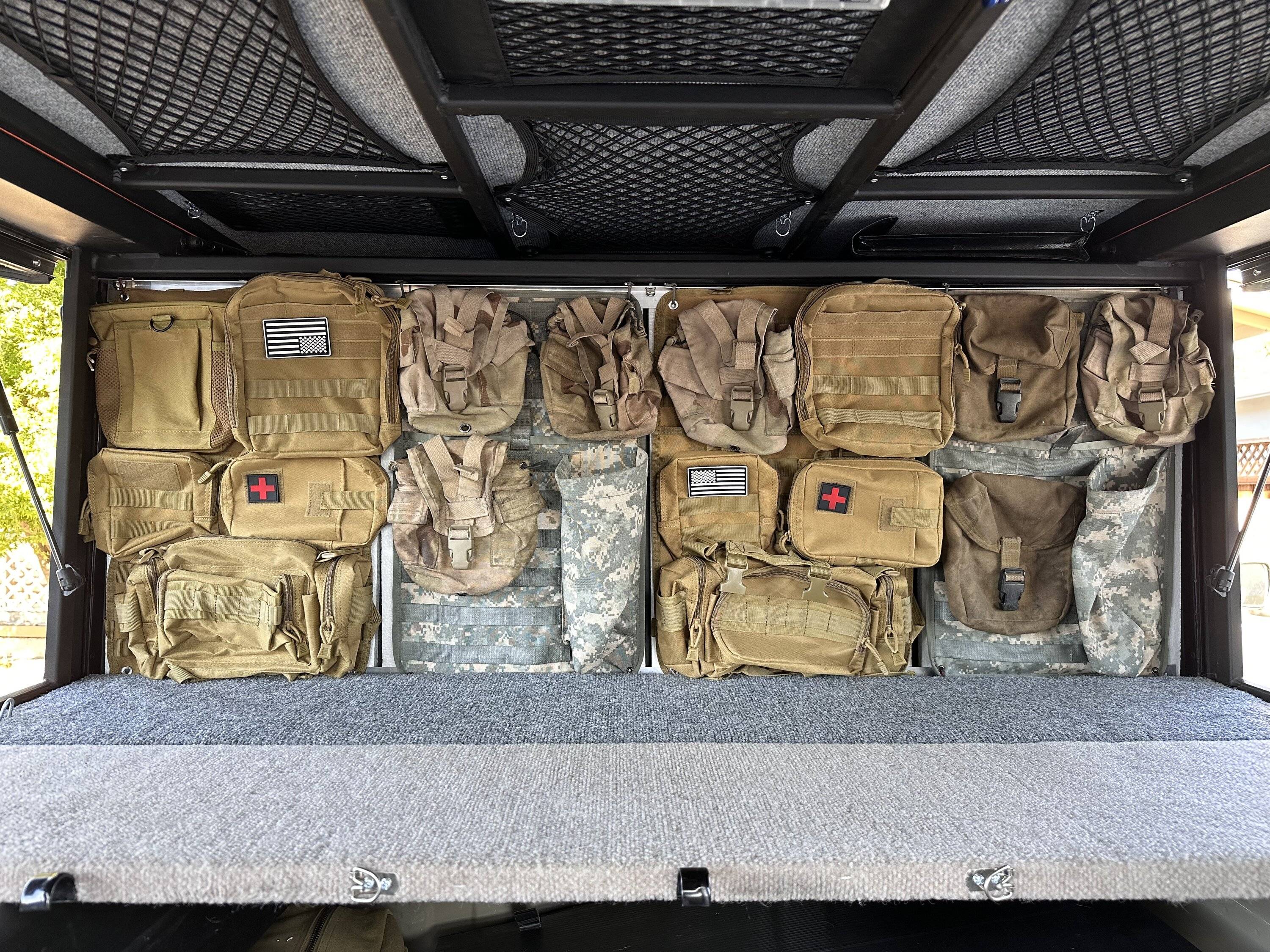

Anyone know where to find molle panels made of fabric instead of aluminum or steel? Need some for the inside of the camper
I don't know of any fabric ones. I have several sizes in aluminum. Let me know if there is something I can help get figured out.

i did a whole bulkhead of fabric MOLLE panels. Basic Amazon stuff, wasn’t expensive
