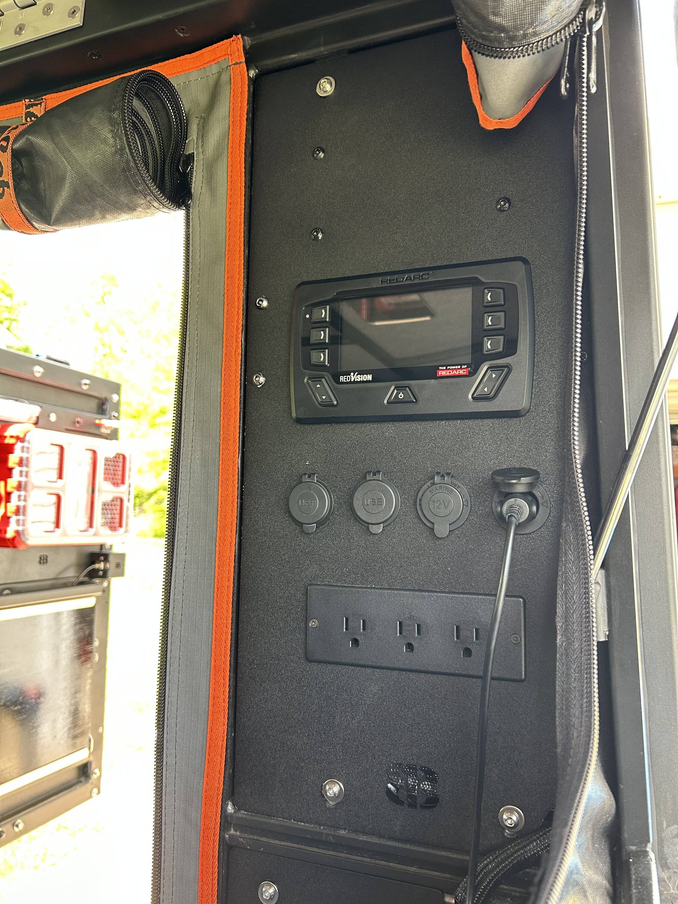

Still looking at how I can mod the Goose Gear cabinets to work..but first I need to get the camper on..maybe this weekend then have a plan for all the part below as cabinets will need to work with this.
Question for all, Anyone done a similar system that has a build posting anywhere on how/where and what all you used in mounting up your Redarc system. I have coming a manager 30 rogue system, 2ea 200w panels, a 3000w inverter and a LiTime 230ah battery.. As stated thinking about getting a GP Factor panel kit for ease of install. Not real handy with wood but have some ability plus all the tools. Metal is more my comfort zone so maybe Molle panels? Open to all ideas and parts needed.
Thanks

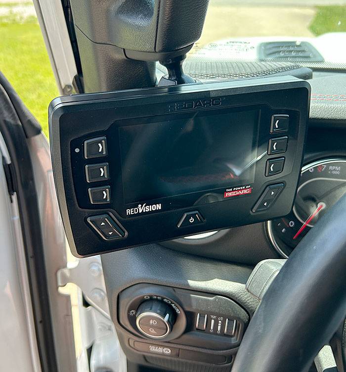

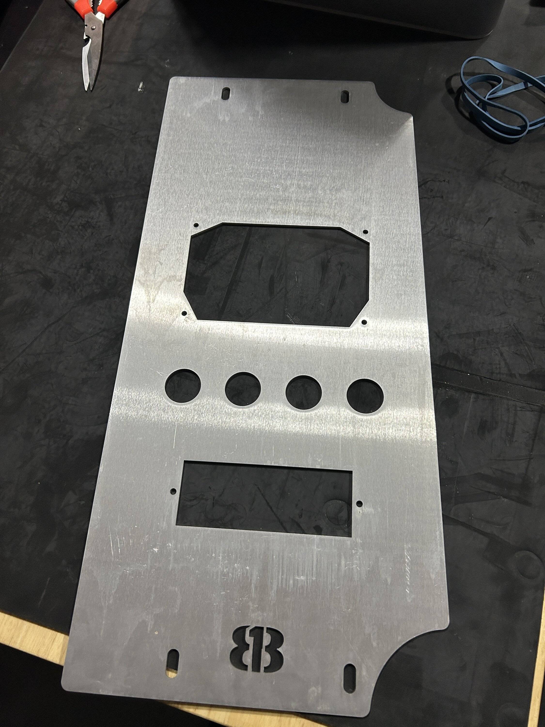

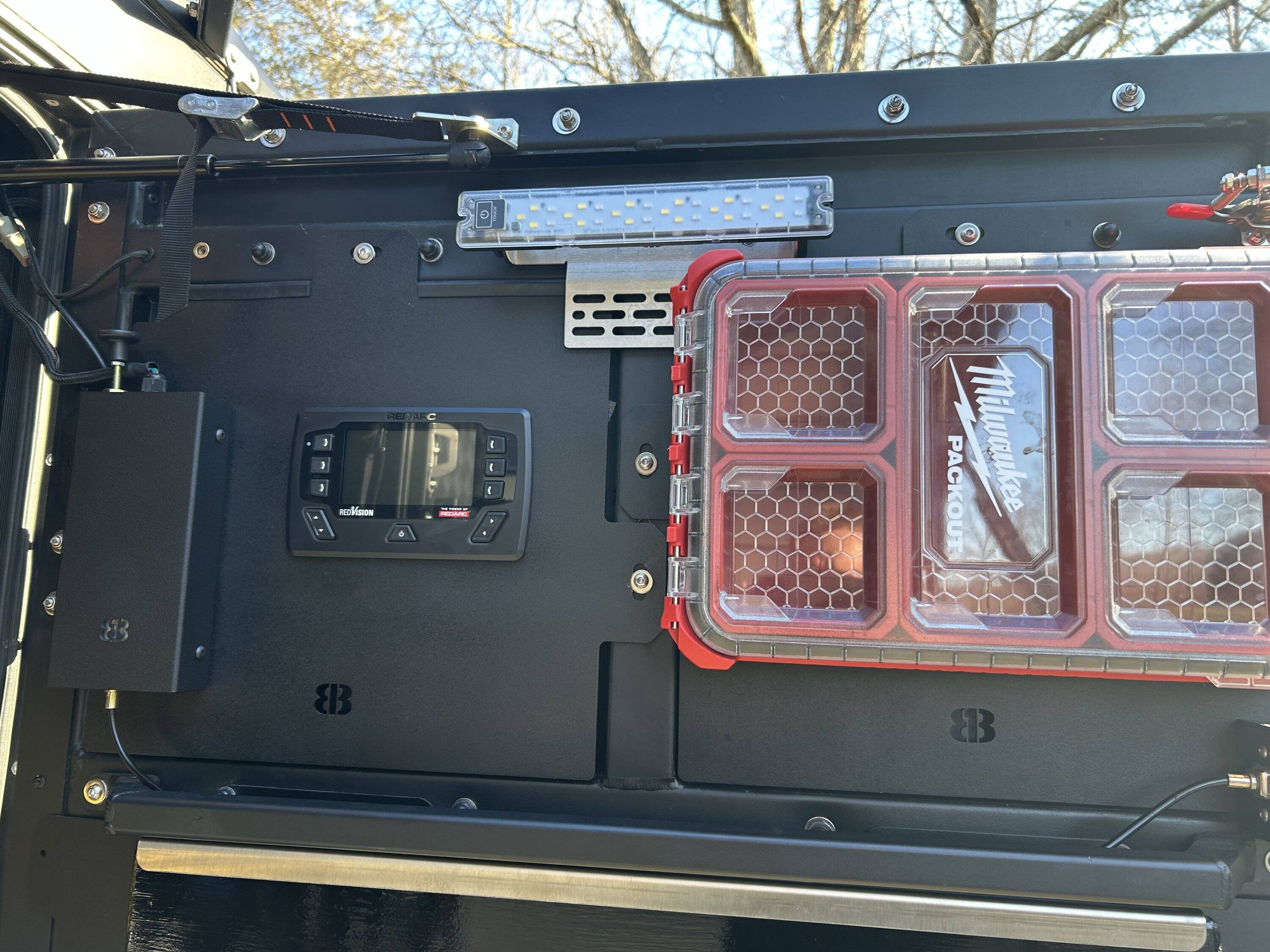

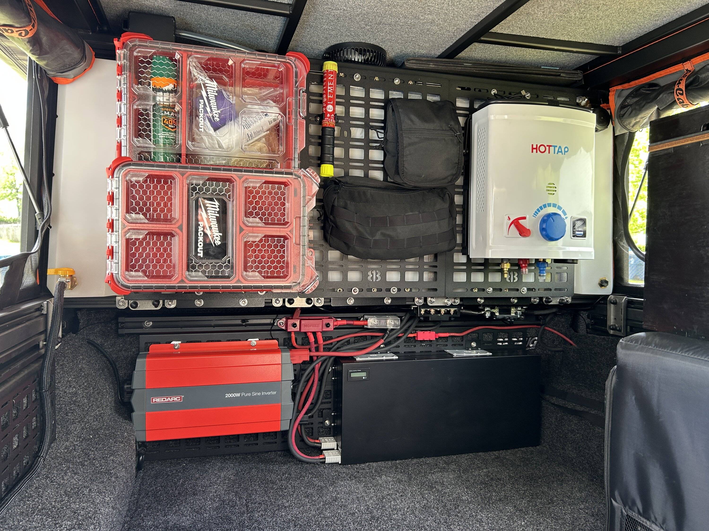

I have a very similar setup. I designed a panel to hold the display and the Rogue mounts behind it. I also have a Bluesea fuse block mounted behind it. I have the 2000W inverter and two ATEM 100ah flat batteries mounted on one of my Cabside MOLLE panels. I have a second screen mounted on a custom rear door panel (I actually have a third screen in the cab on the A-pillar). I have 3 displays since I was designing different panels for them. I don't have any photos of the backside of the Rogue being mounted. I can't find the photos. But, the 4 screws you see next to the screen are holding the Rogue with spacers over top of the backside of the screen. The 4 screws above that holding the Bluesea fuse block.
I have the raw aluminum panel available if you are interested.
Jeremy
