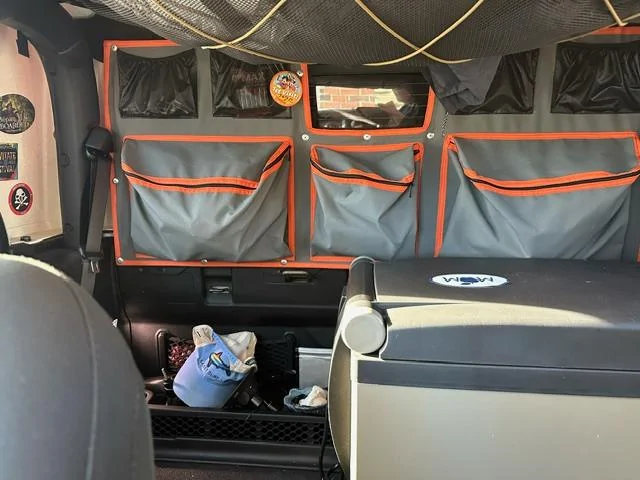

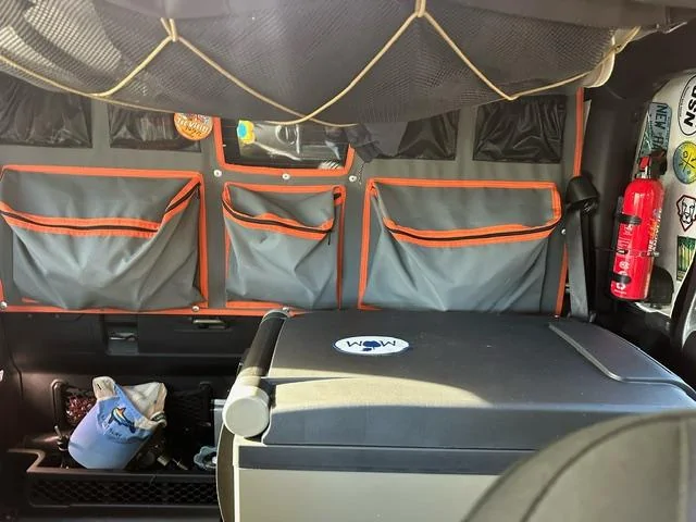

small change of subject, the alu cab water wall storage bag board (not sure the real name) fits great with a rear seat delete, it made sense to me as I am putting the 813 molle panels on the water wall for shower and star link harness. Pictures aren't the best, but you get the idea.
Took me a minute to realize that was inside the cab! Good way to reuse the pouches. I hope you like the MOLLE panels!

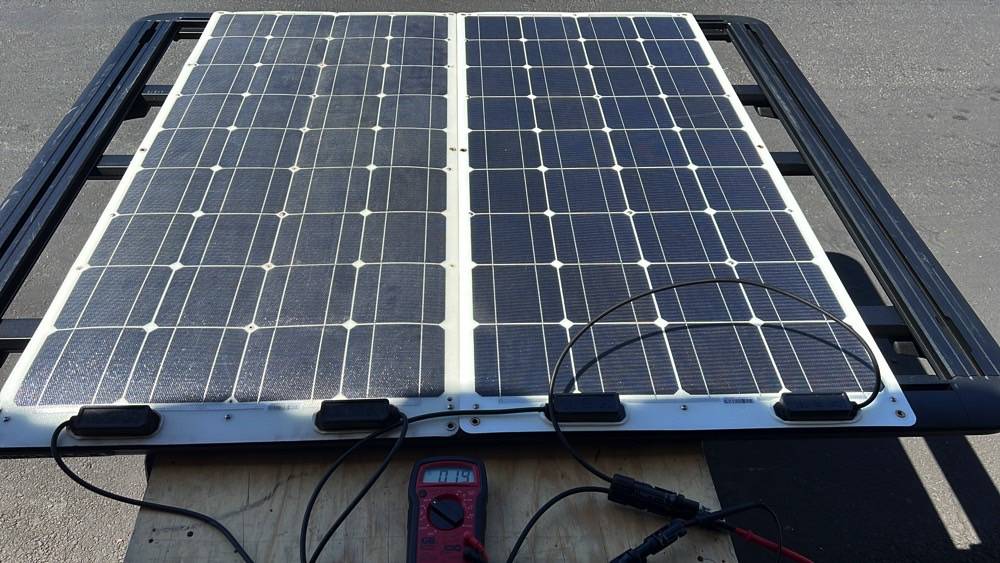

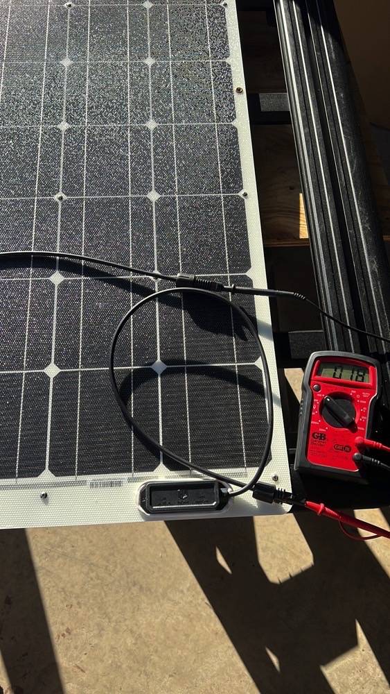

My take is: they seem to be at a point where I'm okay trying one, maybe with some additional tape to protect the front edge. Given my experience with Renogy's customer support, I'm probably not using their panel.
My experience with Renogy's customer service was decent. When they shipped my initial system they forgot to include the wiring from the panels to the MPPT. I called them and they shipped out the same day. Maybe I had a lucky day.
Anyway, I know there aren't a ton of long term reviews out there as you've said, but I have been running Renogy's 100W flexible panels; started with 1 for a year and then expanded to the 2nd and have had that for almost a year.
Jeep Gladiator Alu-Cab Canopy Camper Roll Call 14_NewSolarPlatform_4
When I added the second, I was getting about 18a in full AZ summer sun. Nowadays I will routinely see them putting out about 14-15a
Jeep Gladiator Alu-Cab Canopy Camper Roll Call 14_NewSolarPlatform_3
Initially I was worried about the leading edge. I'd seen some people use angle or flat stock (depending on where they mounted them) for that leading edge, but I just used about 8 screws and then siliconed the whole leading edge to prevent the wind catching the edge and have had no issues for two years. Food for thought.
Since I mounted them directly to this roof rack, they get air flow and probably don't get as hot as if they were mounted directly to an RTT roof.
Jeep Gladiator Alu-Cab Canopy Camper Roll Call 14_NewSolarPlatform_6
