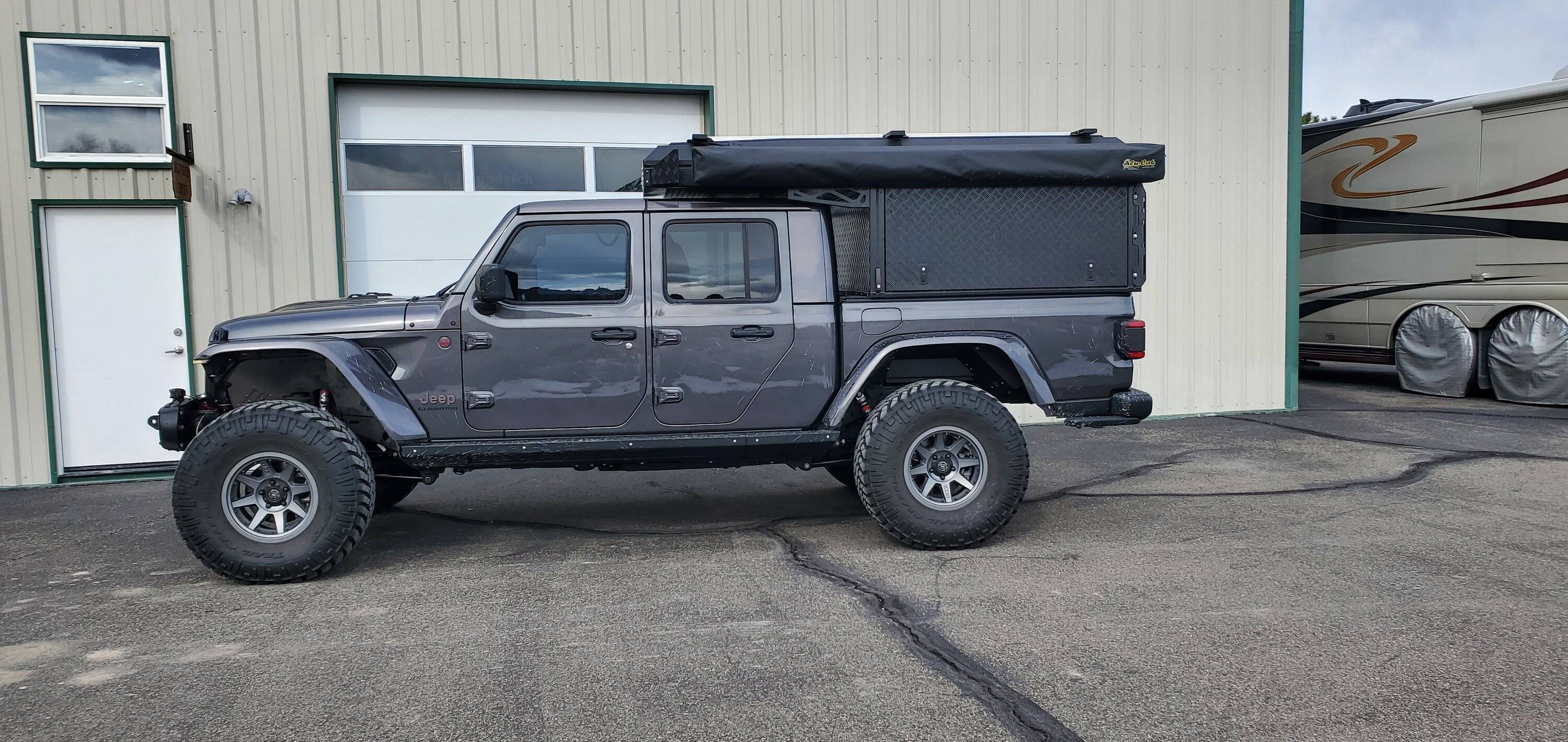

I got the camper installed doing by myself wasn't to hard but I do have a lift and my wife helped lowering the lift the last few inches while I lined all up.
Could be an optical illusion, or maybe since mine has the filler plates, but in this pic the camper looks like it's sitting back too far from the cab.
I'd say it looks about right:
Jeep Gladiator Alu-Cab Canopy Camper Roll Call IMG_5666
The missing filler plates certainly don't help.

Its sitting correctly as the end fill kit determines where the back sets. I have the side equal which took some time.
I also used a double bulb seal instead of a single.
Fill plates are not on yet as I haven't ordered the Hinges, I'm making both sides openable.

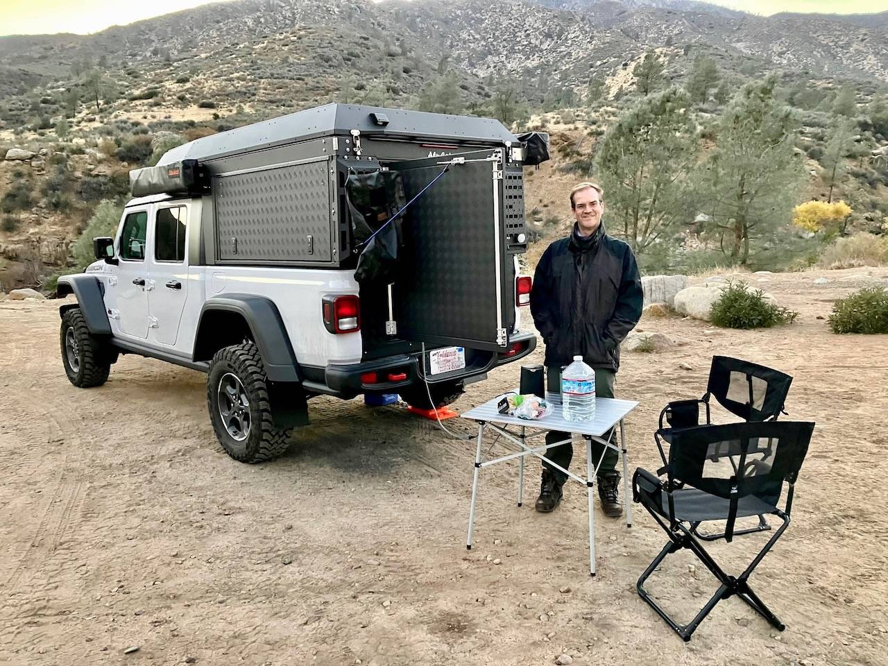

It's somewhat visible here:
Jeep Gladiator Alu-Cab Canopy Camper Roll Call IMG_5941
For travel in (grizzly) bear country we plan on replacing this with a Bear Vault:
https://www.rei.com/product/768902/bearvault-bv500-journey-bear-canister
It's roughly the size of an 11lb propane tank, I'm going to fab a very simple mounting mechanism for the Molle panel (basically just a brace underneath and a strap around the container).
