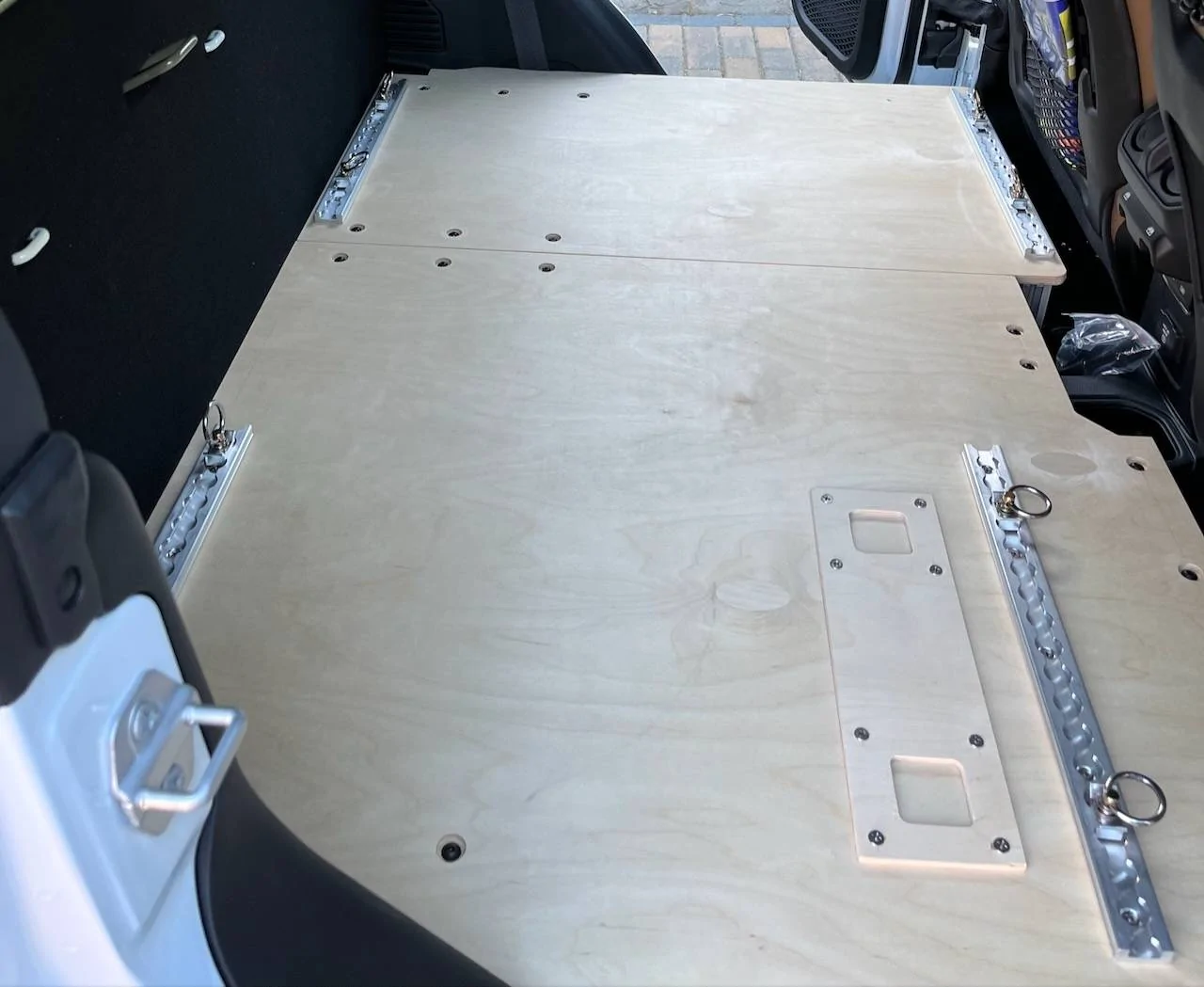

Tire repair gear is heavy and I didn’t want a missile in the case of an accident.
Makes total sense. We have these l-tracks on our seat delete platform:
Jeep Gladiator Alu-Cab Canopy Camper Roll Call IMG_5836

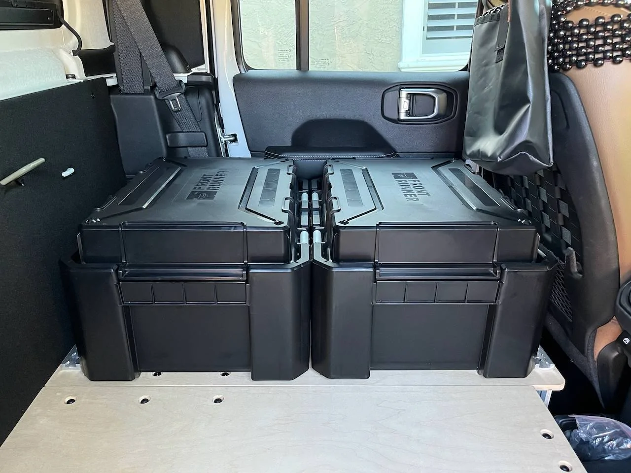

With this, we can strap down stuff sitting on it. The fridge sits in the little "retainer" and is strapped down, the other side is used with boxes:
Jeep Gladiator Alu-Cab Canopy Camper Roll Call IMG_5835
These are old photos, we've just finished the wood with Osmo (finally) and are putting rubber backed carped on it, so sliding will be minimal. The tracks will will be used to make sure heavy items aren't flying around.
I can put four Wolfpacks and one Zarges case in the rear space next to the fridge, one of the Wolfpacks will be dedicated to recovery and rarely used gear. Probably the one you see in the above picture on the left. The right one will be replaced by a Zarges box and then goes on top of the left one. Then one or two more in L-formation between these and the fridge. Strap over them to prevent them from flying around in case of an accident.

Yeah, there is absolutely no question that it'll be in a Wolfpack box, I'm not taking a chance there. I will likely leave the OEM jack in place, it's not taking too much space and sometimes the option to take the weight off with a bottle jack + safe jack accessories and then lifting the axle with the scissor jack might be the only way to get the wheel off the ground.
I'm not super concerned about this, but still, would like to have a setup I can trust to enable me to do a tire change.
One more question: What's the actual height including the handle of one of these ammo boxes? I have just under 8" of height with the low lid and 10" with the high lid in one of the Wolfpacks.
Call it just under 9" to clear the handle. Box is just over 8.75" tall.
