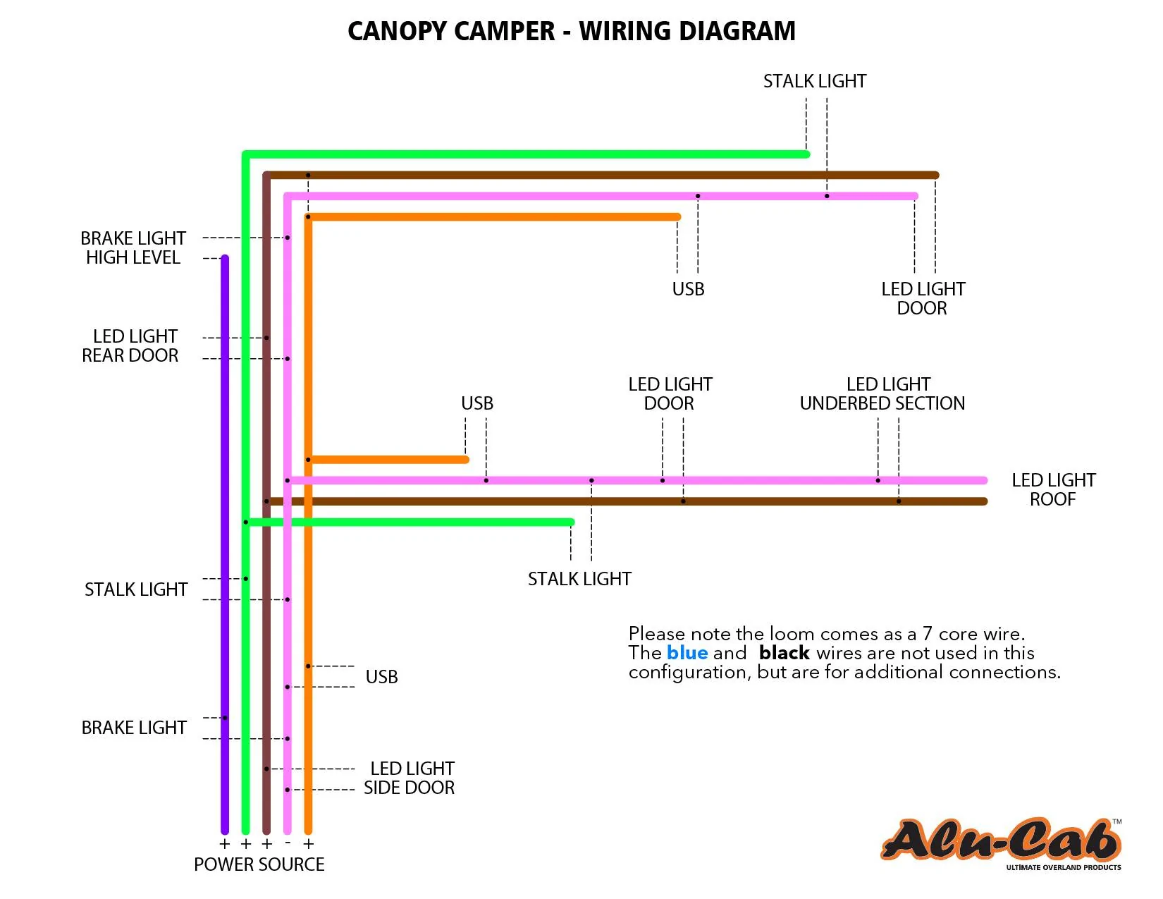

QQ: I’m rewiring my ACCC and had to dig around in the electrical harness coming down from the back left upper corner. Seven wires, brown / pink / orange / purple / green-yellow all labeled, properly hooked up and working. But up high in the loom were two short wires, blue and black, no label, not properly terminated with insulated ends - just bare copper at the open end.
I wrote to Alu-Cab and got the reply ”The blue and black leads are not utilized in the Canopy Camper wiring harness.” OK, fine - I can just cap them properly and never think about it again.
But anyone have any idea what these are meant to be used for?

Thanks, copying that down for my records too. Maybe there’s a common harness with the Alu-Cabin or Khaya? Do those come with some electrical feature that we don’t have?

I think they are just pre-run wires for the end user to use if they want to wire in extra accessories.
