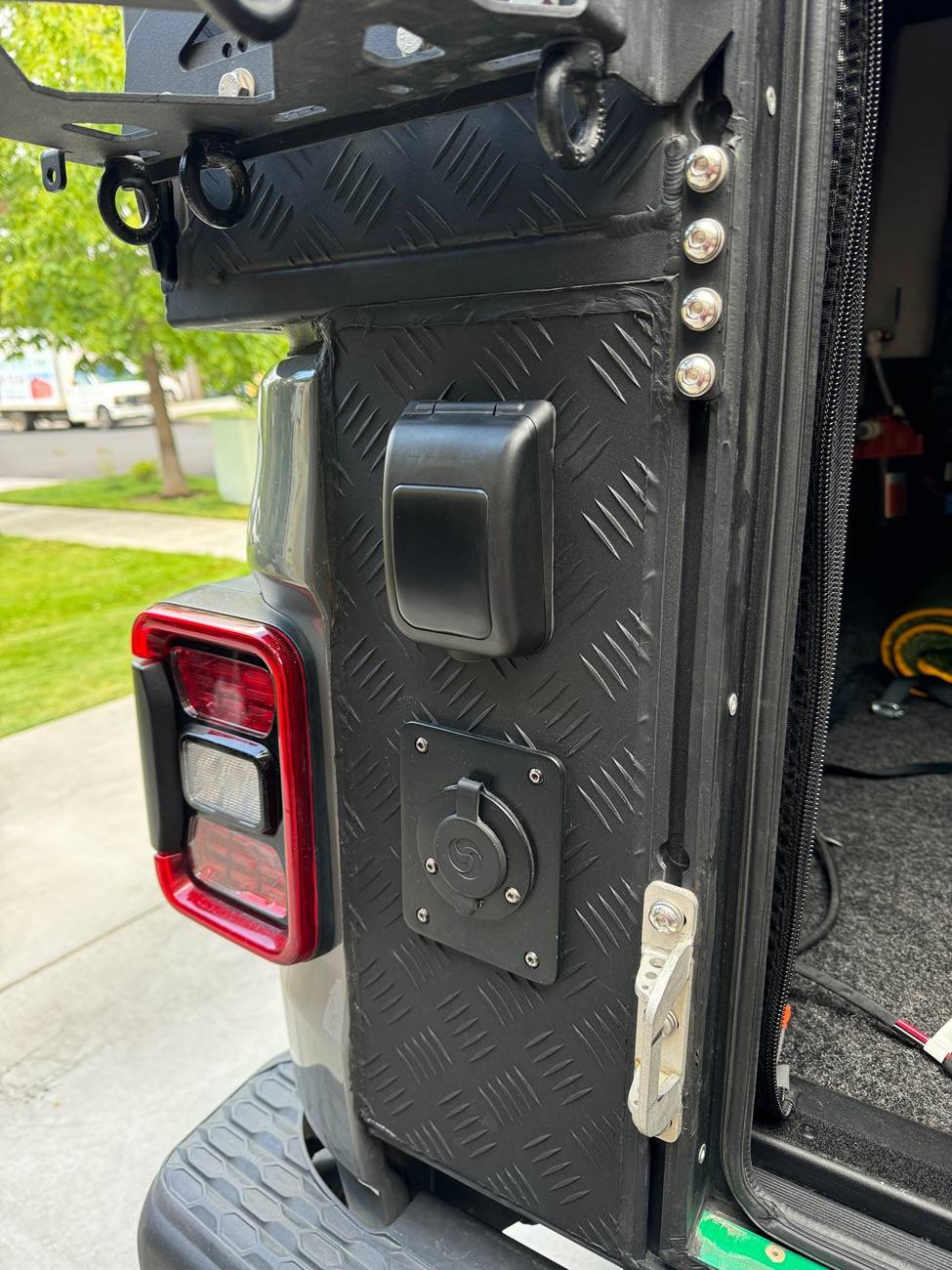

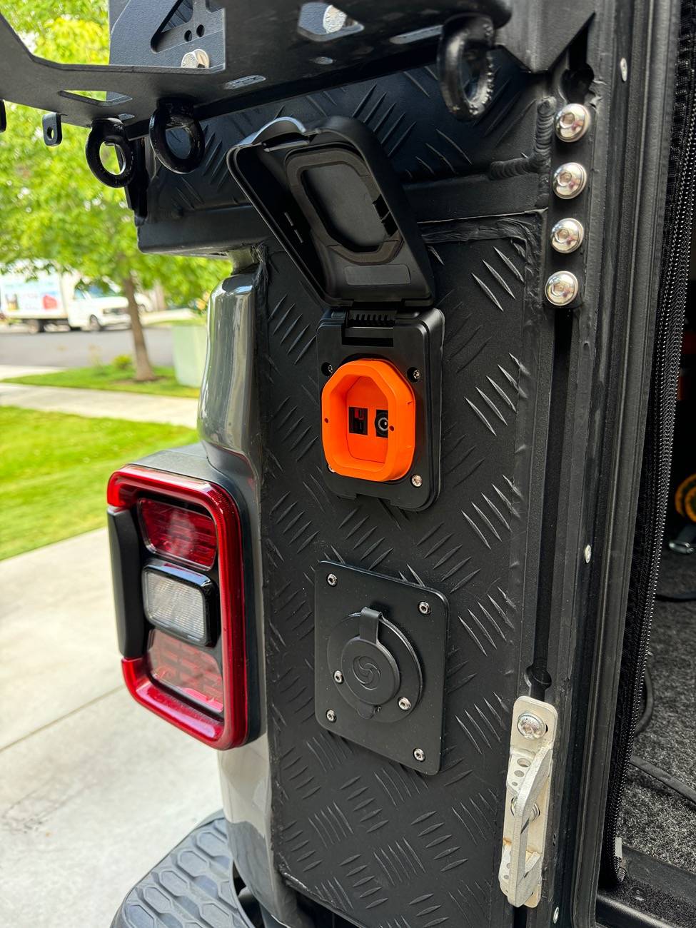

Here is what I went with for a weatherproof bulkhead fitting, it's called a SmartPlug data port. This fitting uses office/server rack keystone modules so you can equip it with the connection types relevant to your application. In my case I took a keystone blank and mounted a 5.5 x 2.1 female barrel connector to act as the 36V connection point for my starlink mini. The other spot has an Anderson Powerpole that is used to plug in a 180W solar suitcase. When the lid is closed, this provides a very weatherproof pass thru. At camp, the cover can be lowered to create a reasonable rain/snow hood.
I can't say that I'm very fond of barrel connectors, but in this application it offered 2 advantages: 1) The ability to use the starlink power cord as supplied, which creates a weather proof connection to the dish and 2) This is the only thing on my rig that uses a barrel connector, so my wife won't inadvertently plug some valuable consumer electronics into a jack that supplies 36V.
Overall I'm pretty happy with it, 7/10. The downsides are that the keystones had some wiggle when mounted. I don't know if this is smart plug's issue or the keystones I supplied or just a reality of a modular system. I didn't like it and ended up hot glueing the keystones from behind. So now they aren't so modular... but that's OK I am not planning to make any changes there. The second thing I didn't like was some obnoxious (to me) branding on the cover of the smart plug. Spray paint for the win there.

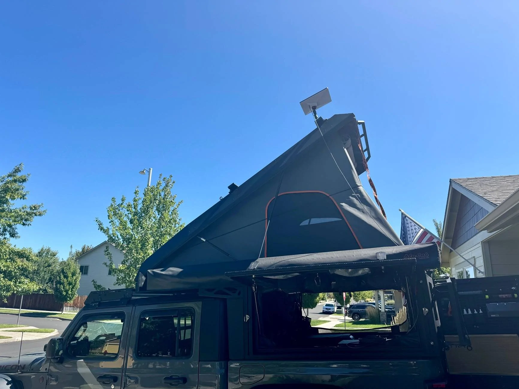

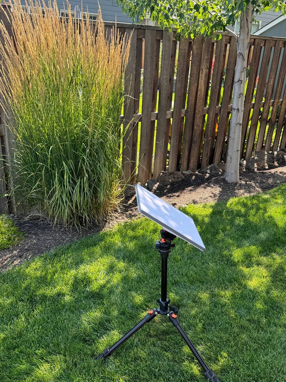

Note that the problem I was solving was having a weatherproof connector for items that I field deploy at camp... not trying to solve weatherproof connections for permanent, roof mounted hardware.
As mentioned earlier in this thread, the dish uses a tripod adapter (no affiliation) so that I can mount on the camper roof via RAM ball mount and short arm, or a tripod if I need to get the dish into clear view and I parked in the trees.

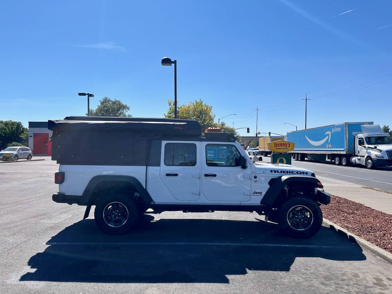

On the Gladiator I have the Teraflex HD springs with 3" lift for the Diesel. Teraflex told me this:
"I would check out our recently released Outback HD coil springs. We've designed them to carry extra payload, and to reduce sagging with extra weight. We rate them at their lift height at 400-500 pounds over factory rate, so they're true to their rating as well. "
I'd say that's about right. They do carry the weight a bit better than the stock springs, but they aren't fully keeping the same leveling as a Gladiator without anything. I'd say, slightly stiffer rear springs would be a bit better.
This is our Gladiator, about as heavy as it gets in the rear:
Jeep Gladiator Alu-Cab Canopy Camper Roll Call IMG_6610
It sagged a bit more in the rear compared to the front with the full loadout, but it's not unreasonable. It still handles fine with the Falcon II shocks in relatively soft settings.
This is with the Canopy Camper, awning, shower cube, full tank of water (let's say 4/5th full tank), full furniture build (see photos below), a rear seat conversion with one full Zarges, two full FrontRunner Wolfpack, two full Wolf Cubs, full fridge, recovery gear, tools, Maxtrax on top and so on.
When the ground is a bit uneven, the flex can make it look really back heavy though:
Jeep Gladiator Alu-Cab Canopy Camper Roll Call IMG_6781
It looks much worse than it is as can be seen in the first photo.

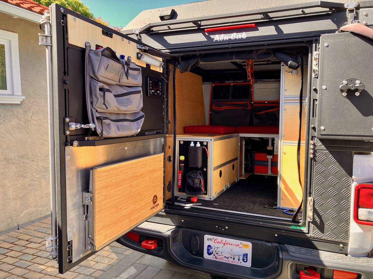

Rear build out:
Jeep Gladiator Alu-Cab Canopy Camper Roll Call IMG_6496
Jeep Gladiator Alu-Cab Canopy Camper Roll Call IMG_6589
In the parking lot photo the Rotopax were empty though.
The interior is a little less weight than a full Goose Gear buildout (for all intents and purposes it's about the same, since the difference to what they quoted me as weight are maybe 20lbs or so), but the photos abovce are WITH all our stuff in there as well.

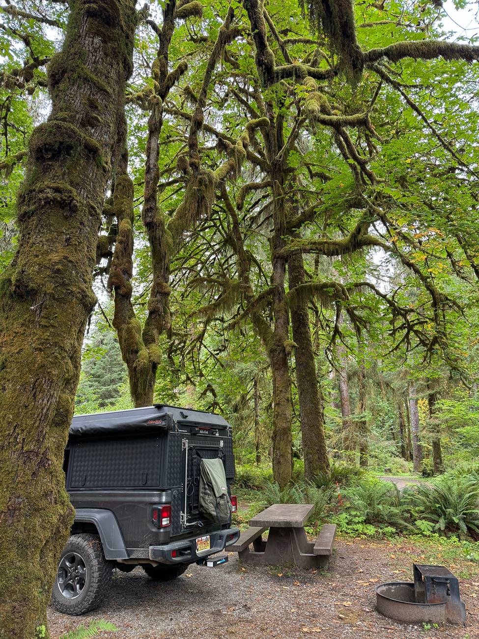

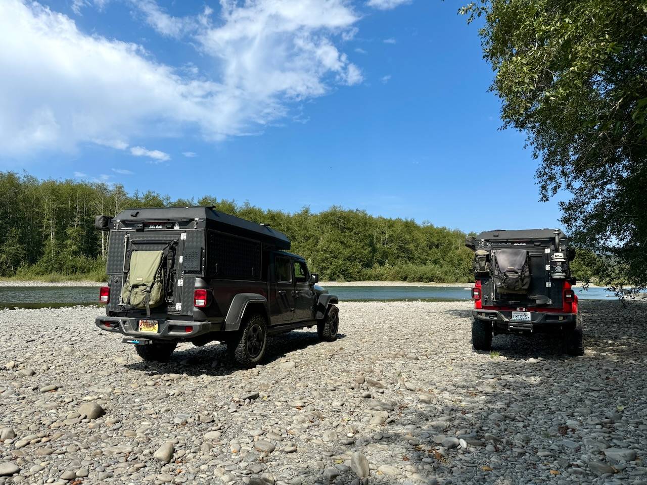

Did anyone get out this past weekend?
I met up with my father and sister and we explored areas near the Olympic National Park that we had never explored before.

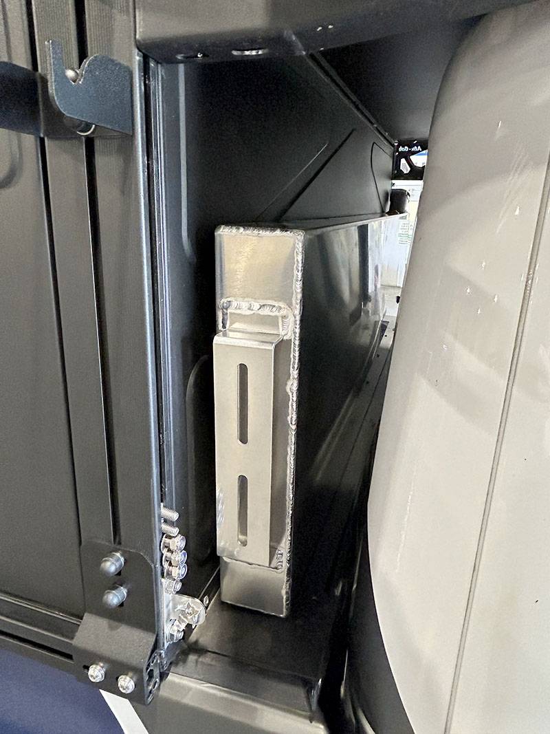

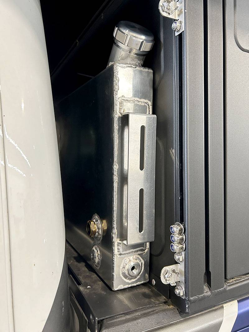

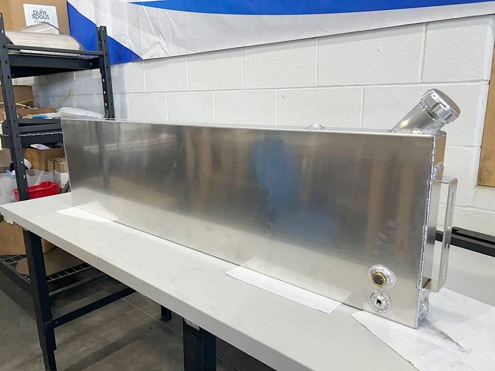

Test fitting our prototype aluminum fuel tank to fit in the bulkhead area between the cab and Alu-Cab camper. Approx 10 gallons. We are making a few tweaks for the final version and I need to make the mounting brackets. What do you think?? Not sure on pricing yet but will know more soon. Should hold gas or diesel.
Jeep Gladiator Alu-Cab Canopy Camper Roll Call 01
Jeep Gladiator Alu-Cab Canopy Camper Roll Call 02
Jeep Gladiator Alu-Cab Canopy Camper Roll Call 03

That's pretty neat.
That would give us just over 1000km (620 miles) realistic range when traveling. We've been consistenly getting around 22.6mpg over the last 6000 miles on our current trip with the EcoDiesel, fully loaded with camper (fully furnished), water, etc.

That's pretty neat.
22.6 is pretty good fully loaded!

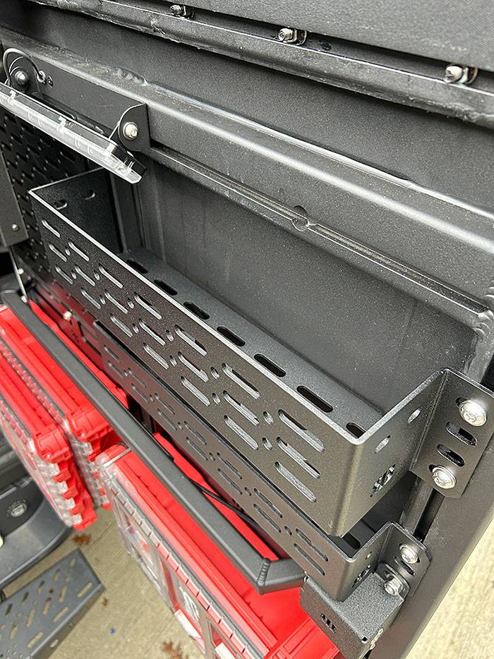

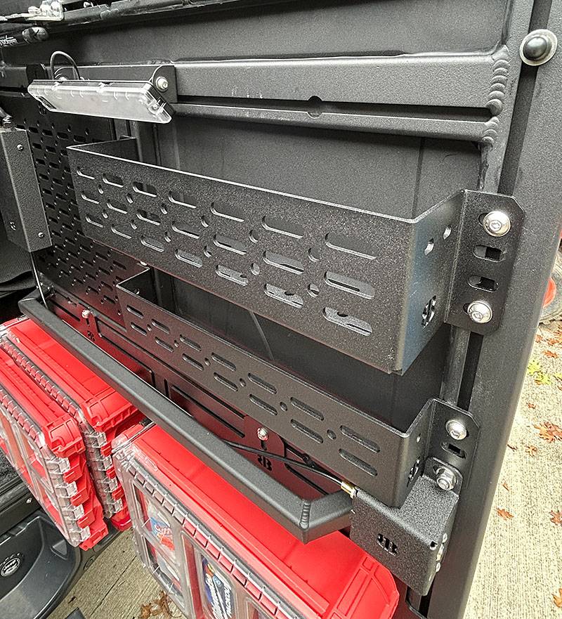

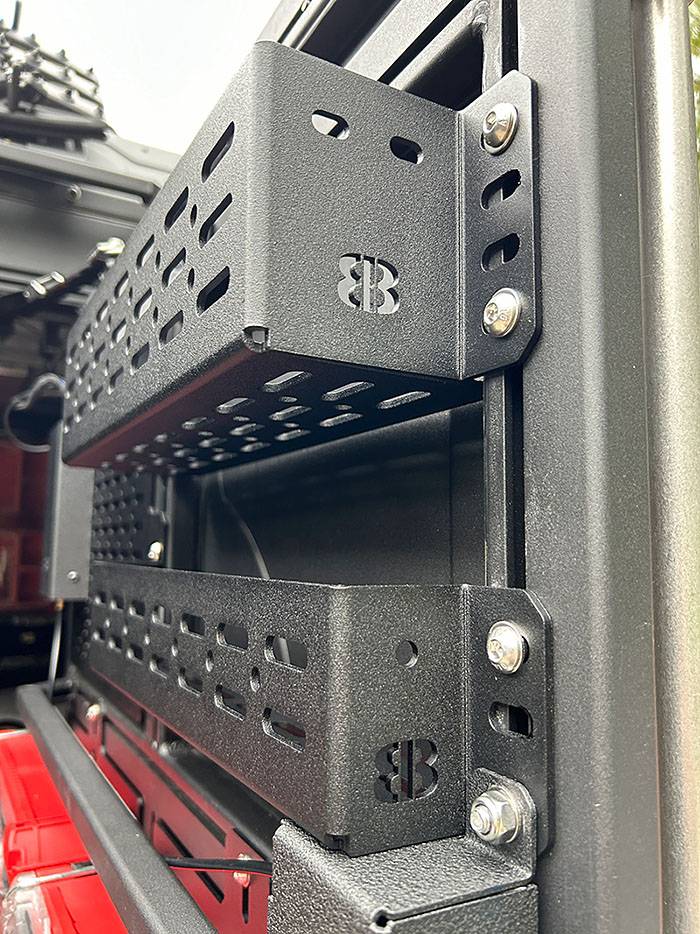

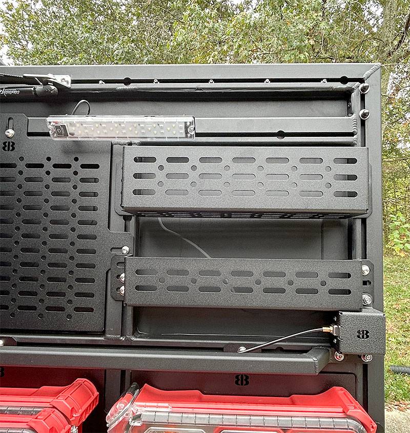

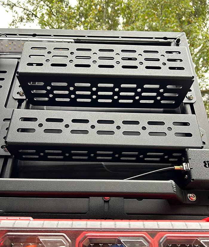

Our new Rear Door Storage Trays are now available! I have shallow and deep versions. Made from 1/8" powder coated aluminum. The trays will fit on any section of the door. After looking at mine I think I will move my PACKOUT panel to the top left and add the trays to one of the lower sections. The pattern matches the Rear Door Accessory Panels that I have. The holes will hold up to an M8 bolt or an M6 or 1/4" rivnut
Jeep Gladiator Alu-Cab Canopy Camper Roll Call AC-RD-TRAY-1
Jeep Gladiator Alu-Cab Canopy Camper Roll Call AC-RD-TRAY-2
Jeep Gladiator Alu-Cab Canopy Camper Roll Call AC-RD-TRAY-3
Jeep Gladiator Alu-Cab Canopy Camper Roll Call AC-RD-TRAY-4
Jeep Gladiator Alu-Cab Canopy Camper Roll Call AC-RD-TRAY-5

That’s exactly what I was going to build, been thinking about making 2 storage tank with say 60% for fuel and 40% for water, with fuel inlet and outlet on the driver side and the water inlet and out let on the passenger side, please post up photos of final install and pricing
813 Fabrication & Design
Rock Sponsor (Level 1)
Jeremy
Dec 21, 2019
51
927
1,342
Louisville, KY
www.813fabrication.com
I was going to make the prototype tank an 80/20 tank so I can have gas in the 80, diesel in the 20 for a heater setup I am working on. I decided to do a single at the moment since it will be the production tank.
I need to get opinions on the tank pricing. Since I am a small company, if I have 5-10 made, they are going to be approx $900-$1000. Expensive I know, but small runs make it more expensive.
