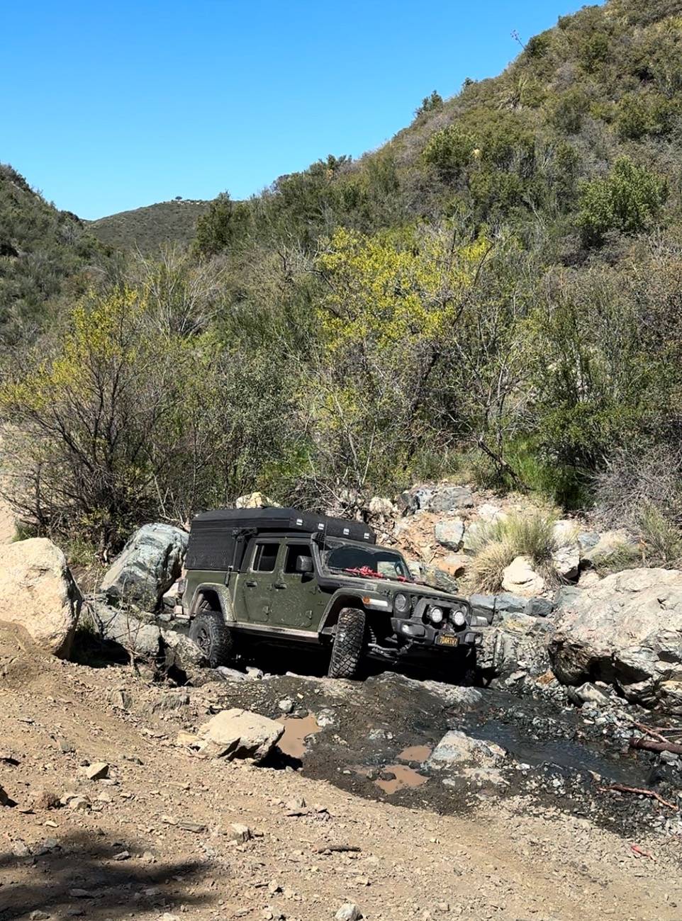

Been really thinking about downsizing on tires at a minimum lately. Honestly, the AEV high capacity suspension and 37x12.5s are just too much Jeep for my uses.
I've been considering in the range of 35x11.5 and I can see that BFG and Falken ATs (my favorites) have that available, but only in load range C. Anyone have any input on getting in that size range and if load range C would be passable for this? Current 37s are load range D. Weight wise I'm just under GVWR as the camper is just the shell without further mods.
Jeep tax picture

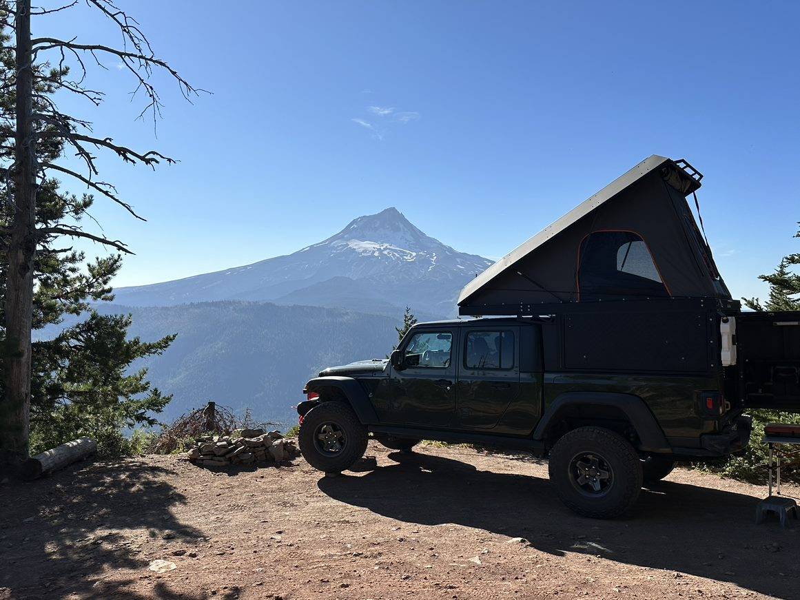

This is a huge reason we decided to chase summer on our travels. I think it might be different if we had the side walls for the Shadow Awn but we don't have room to store them in the Jeep.
Same here. The Canopy Camper setup is okay in good weather, but very suboptimal in conditions that make you want to spend more time inside. We do have the mosquito tent my wife made, which helps with time spent outside. We have the same problem with the sidewall kit: it's too big and heavy for what it is. We had been thinking of making a sidewall kit from ripstop nylon instead of canvas, it would likely be a quarter of the weight and half the stored size, but we never got to it and likely won't ever since it's likely that we'll have to sell the truck in the near future.
The awning itself is also very suboptimal, it's just not good in rain. While it does create a shelter, it only shelters the rear door if you install the extra insert, which is a pain in the ass to do, and even on the side there is too large a gap between awning and canopy. The tent canvas is also no good in rain, at least for long distance travel as over time it will soak through into the bed area. It wasn't a problem for us in Alaska, but that was because we spent a good number of days in hotels/motels due to shitty weather.
Overall, it's a South African product, coming from a climate like Southern California, and it shows in many ways. It's great for good weather, but falls short in bad weather. It's okay for short trips, like (long) weekends, or even a week or two, but if you're traveling for months or even years, it's not good. I'd get a different vehicle for this type of travel.
