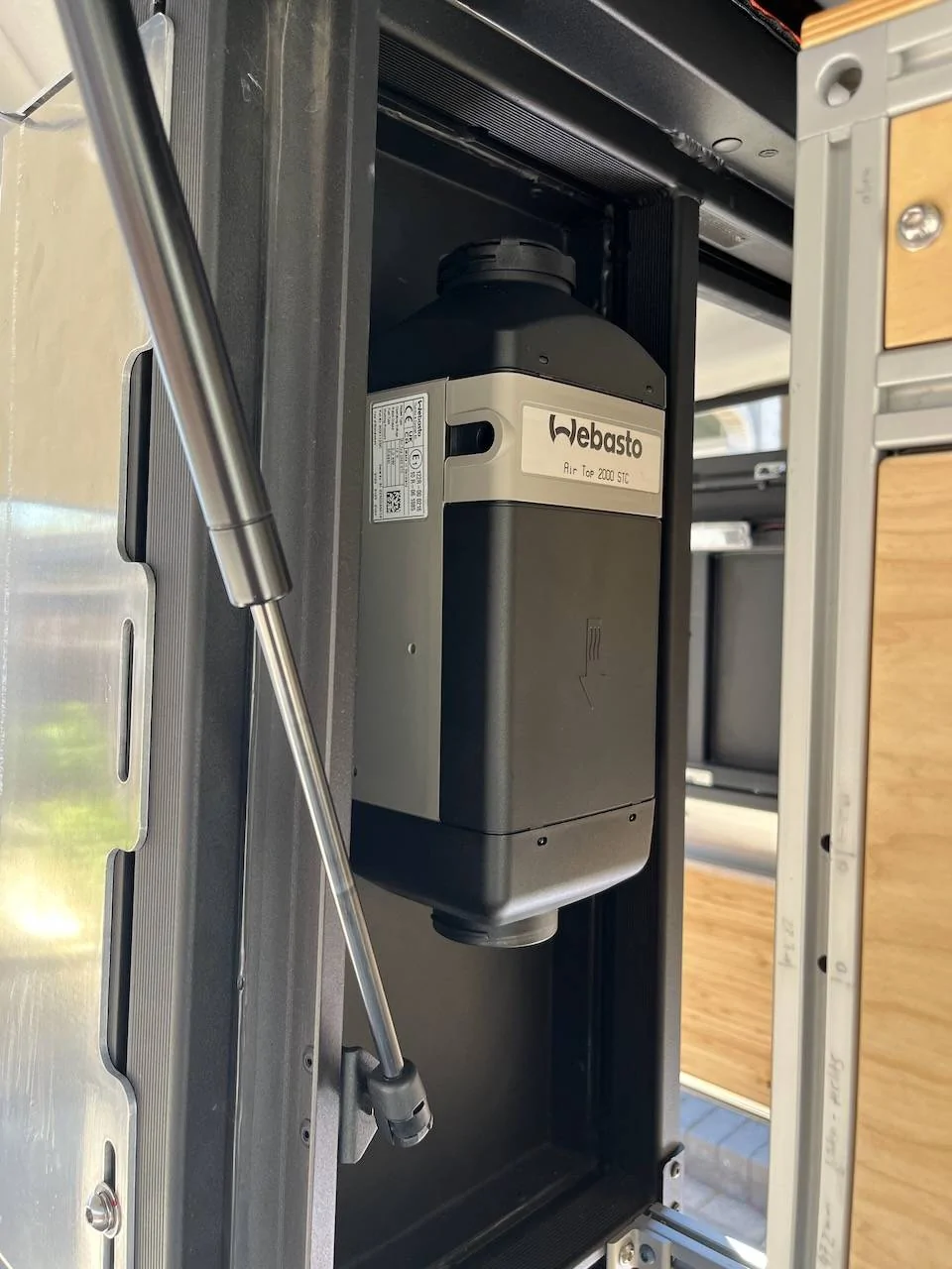

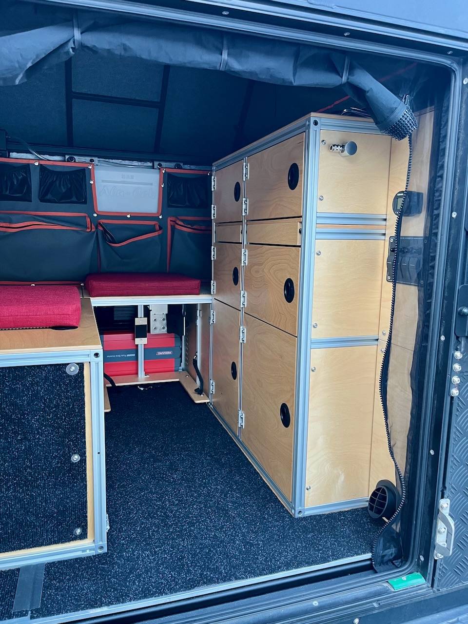

Mine is more complex than that. If you're interested, there is a full build thread, documenting in fairly fine detail. I do have seating, a higher "kitchen" cabinet with sink, water filter, pump, electrical (for induction cooking), a composting toilet, a 12V oven, Webasto heater. Let me know if you want to know more.
It could easily go around in just seating height though if that's desired. We use a GP Factor setup for most of our electrical (with modifications though) and and the heater is in the interior corner where normally the passenger side rear molle panel is:
Jeep Gladiator Alu-Cab Canopy Camper Roll Call IMG_6496

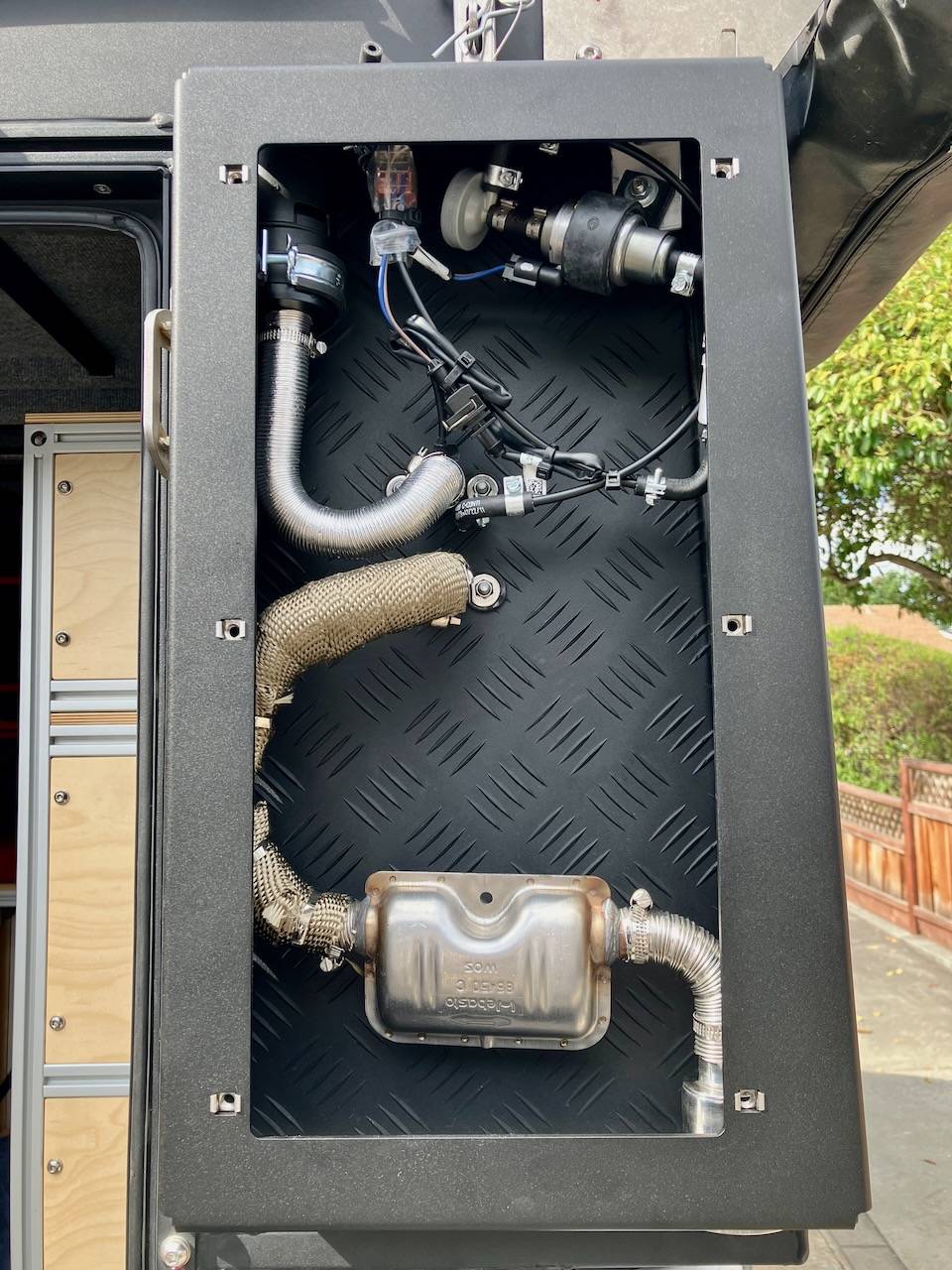

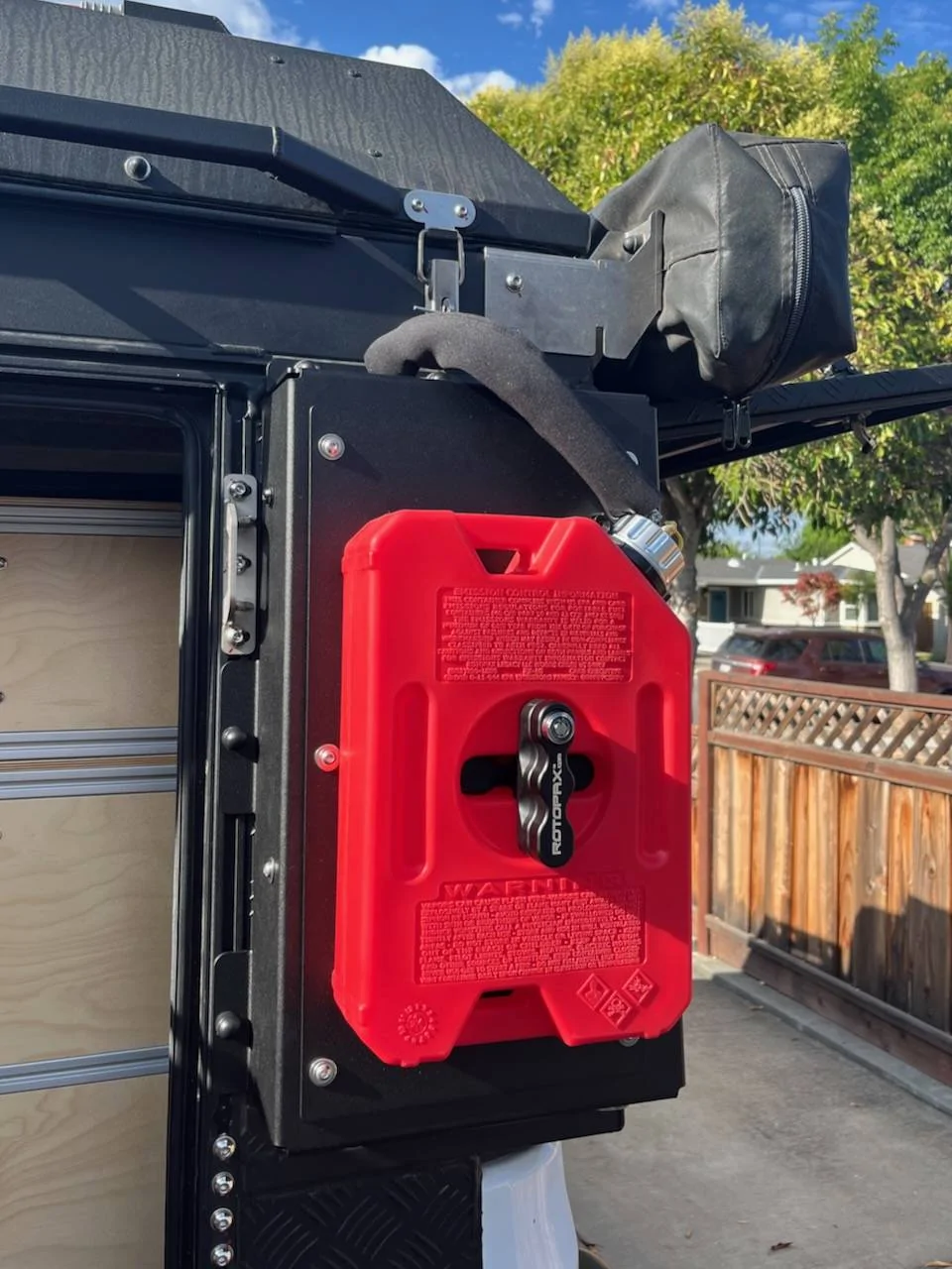

The heater unit is inside the camper, the outside plumbing is behind a custom panel which also doubles as a carrier for a Rotopax diesel container:
Jeep Gladiator Alu-Cab Canopy Camper Roll Call IMG_6441
Jeep Gladiator Alu-Cab Canopy Camper Roll Call IMG_6462
We've plumbed the heating to a low outlet through a cover panel that also carries some more switches for electrical stuff and the Webasto controller, right side in this photo:
Jeep Gladiator Alu-Cab Canopy Camper Roll Call IMG_6589
It's a bit hard to see, but the heater is in a very good position there, the Webasto is rated to work upright and we are down to one fuel only: diesel. The truck is a diesel, the heater takes diesel, all our cooking is electric.

And the outside diesel container:
Jeep Gladiator Alu-Cab Canopy Camper Roll Call IMG_6492
Yes, we've marked it as diesel.
And yes, it does fit a 2 gallon container as well.

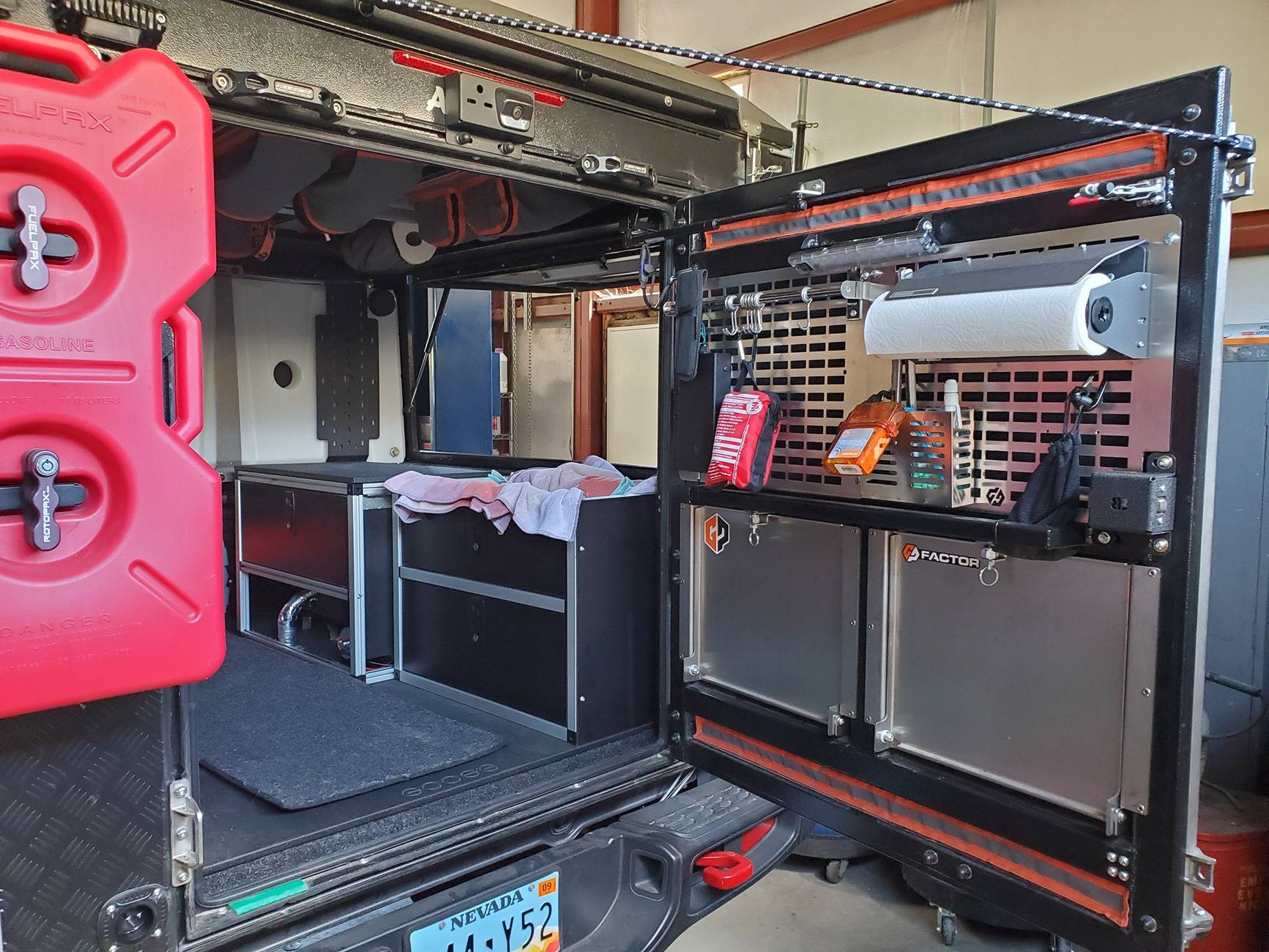

Please keep the camper furniture builds coming ,have seen a few including Cugs, that I like a lot, but need to come up with an option for boondocking in the back with top down, the more ideas the better, goose is not cheap, and shw has a cool option...I am 5'9 so not tall, but also a pain to jam into the back inconspicuously at rest stops etc....my travels are mainly runs down from Boston to Harkers Island, and Florida, but summer of 2025 looking to do the Dempster, thanks

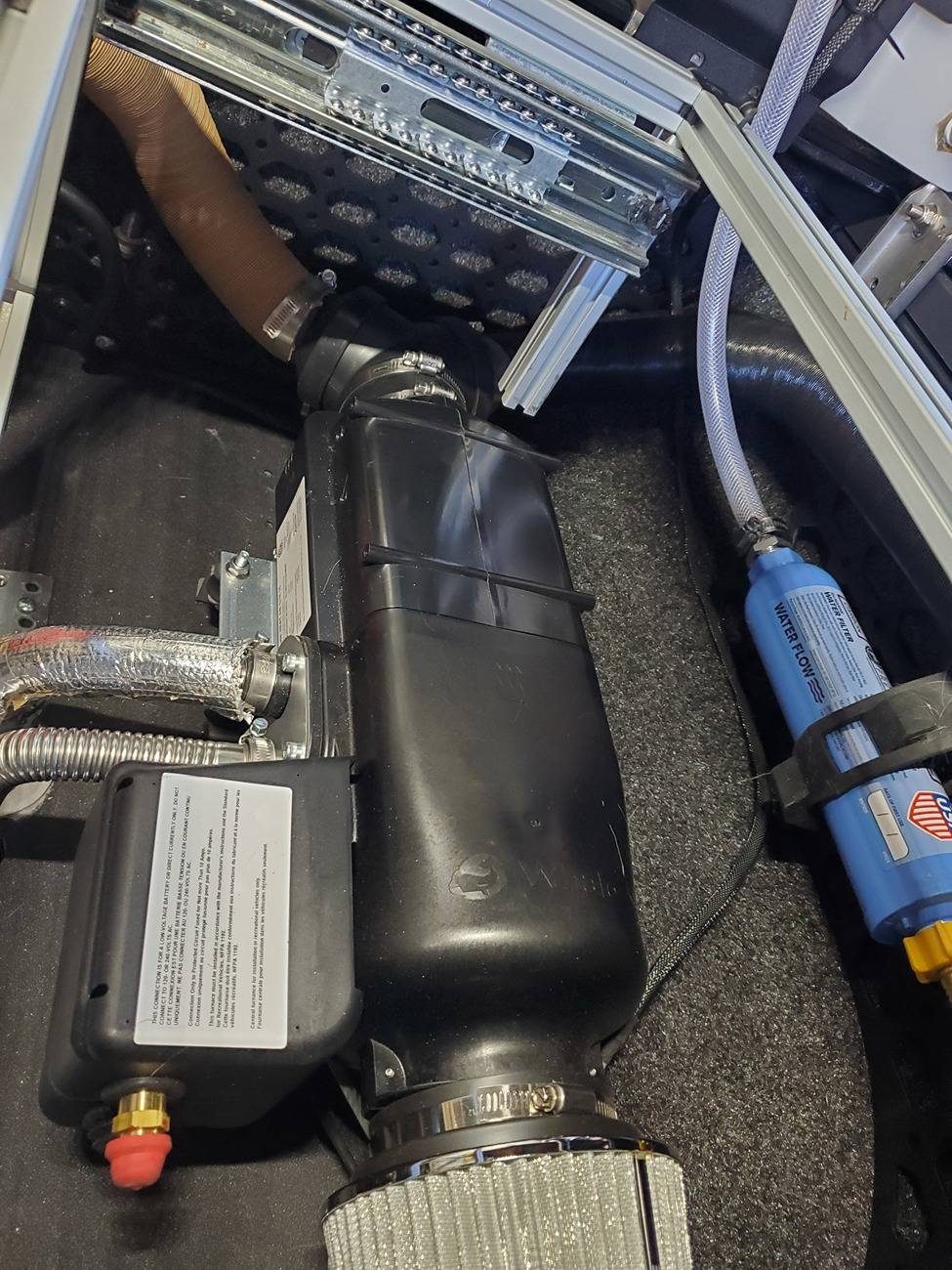

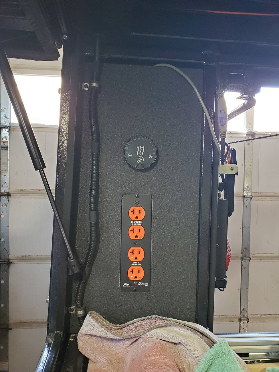

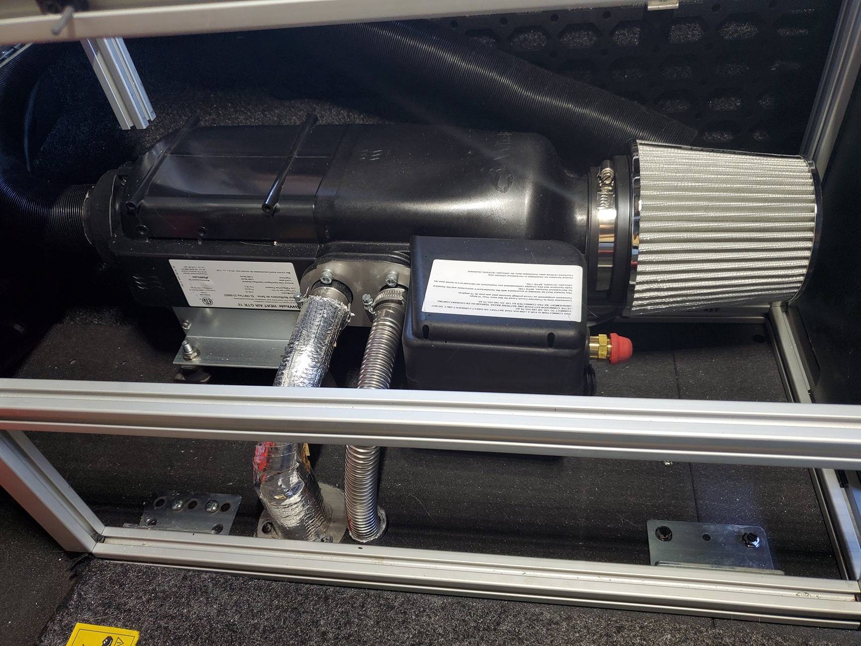

I did a Whale heater for many reasons..efficiency and smell are the main reasons plus dealing with diesel..even though I have a Diesel.
I revamped the Tacoma Goose Gear cabinets to fit how I wanted and flopped the big drawer on top and remaking the small drawer face into a tilt down to close off where the heater is but allow access. Thermostat went into a Goose gear panel that the canopy came with.
115v 4 plug comercial hospital grade plug plate I tied to the Redarc 3000w inverter. Have a extra one if anyone is interested pm me.

heater has varable btu
Heat Input [BTU/hr] 4,000 - 9,400 BTU
Consumption [oz/hr] 2.9 - 7.0
CFM is 88
Propane for me is $1.25-1.30 a pound so cheaper. NO stink outside..so when going out or warming up the interior outside doesn't smell. Plus dead quite.
Diesel heaters require lots of maintence, propane just about never..I have diesel heaters in my MH and they are great but lots of maintence and just smells outside.
I'm a retired HVAC design build contractor so my requirements and needs are different.

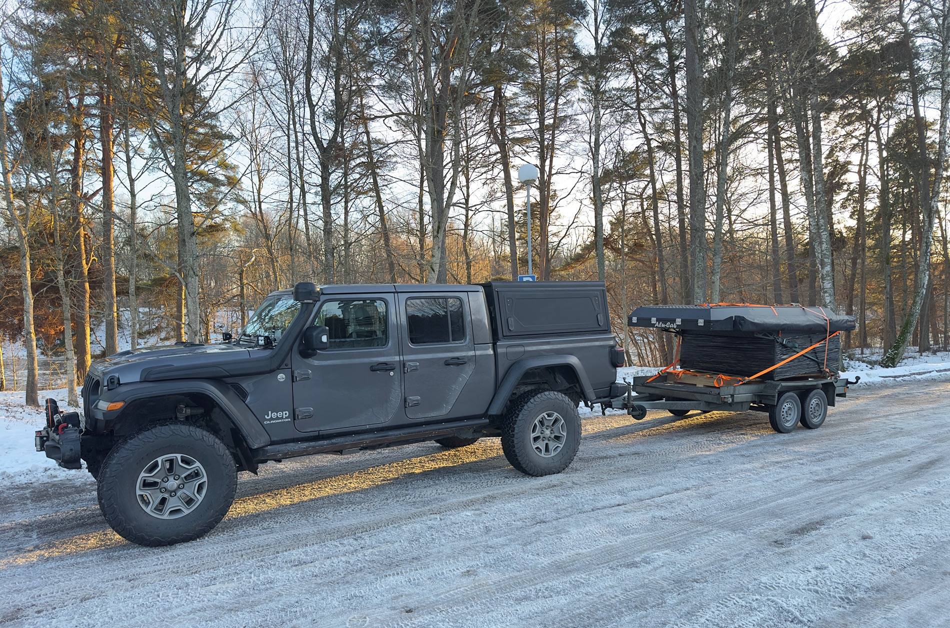

Bought week ago used Canopy Camper from Sweden, install kit also arrived at last week. Maybe in this week i have time to install the camper.
Previous setup was the 3.1 tent + contour canopy.
