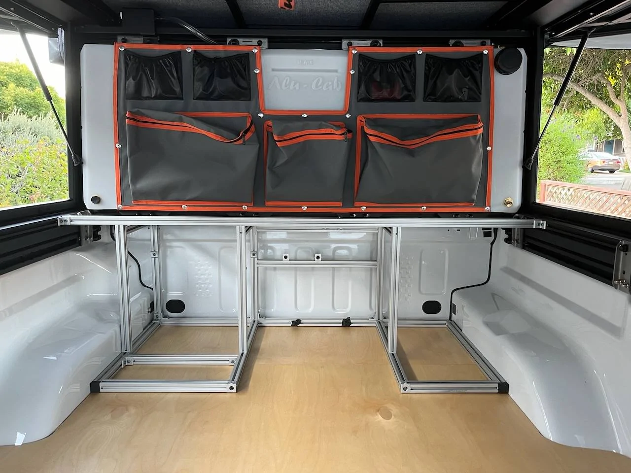

As some of you may know from my build thread, I've been working with 80/20 material quite a bit for my camper interior build.
While this is going on, I also searched for options to mount materials nicely to the extrusion in the camper. Here's what I have found to be pretty good options so far:
  • Standard M8 bolts fit into the extrusion nicely.
  • Low profile M8 nuts also fit very well.
  • And now for a nice way of mounting with M6 bolts: the 80/20 "M6 Self-Aligning Roll-in T-Nut (Part 13092)" fits reasonably well as well. The best part is that it can be rolled into the slot even when no opening is available or convenient.
  • The 80/20 economy nuts for 25 Series profile also fit, but the surface area for the connection is relatively small, so I use these only for temporarily fixing things.
I'm going to use M8 nuts for most of the interior connections to get a slightly tighter fit in the channel. Some of the connections will be made with the 80/20 roll in nut as well. M6 is plenty given the shear-off strength of a steel bolt and that most of the force is distributed on muliple anchor points.
For the table I will mount in the door I will definitely use the 80/20 nuts since they allow me to use smaller and less obtrusive hardware.
Just thought, some here might be interested.

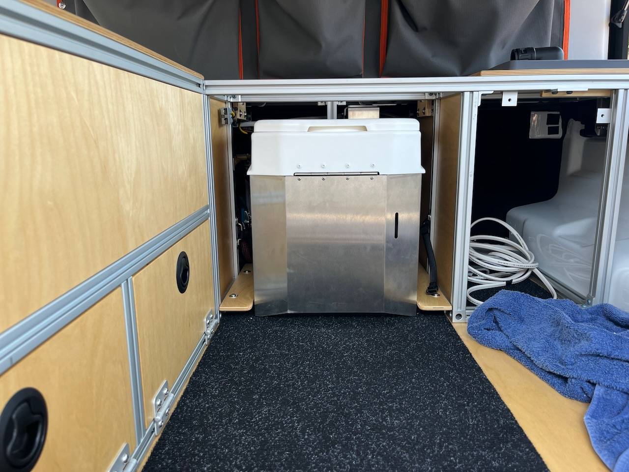

Hey, looking good,
can you do me a favor
what height is between floor and lower edge of the cross aluminum profile that goes from left to right?
I need to verify height for a fridge. Thanks
(I would measure myself, but the modCap will only be installed in week with 7th of April, and we want to leave for first 2 weeks trip already 1,5 weeks later.
cug
Guido
Apr 1, 2023
602
664
Christchurch, New Zealand
JTR EcoDiesel, Land Cruiser 79, BMW R1250GS
Just keeping busy
You mean the AluCab profile going left to right on the front (car cabin) side of the camper? I can try, but due to the build it's not easy to get in there. I can definitely measure the height of the 80/20 profile we have going left to right between the AluCab profiles on the sides, basically bottom plate to lower edge of the profile above the BioToi:
Jeep Gladiator Alu-Cab Canopy Camper Roll Call IMG_6545
That should give you a reasonable measurement, since it connects straight to the AluCab profile. I should have the drawings somewhere, but as we are preparing a (household) move, I have no clue where they actually are.
Wife is out with the truck right now, I'll measure this afternoon. If I find the (hand) drawings, I'll have something earlier. Note that on our truck the height was slightly different at the front and back due to the install. My guess is, there is more Sikaflex towards the rear ... or the truck is just not straight, which is absolutely possible as well.
Regarding the baseplate I'm sending you a template. Just be aware that ours is a very tight fit and might need sanding/grinding due to sample variation in the trucks.
