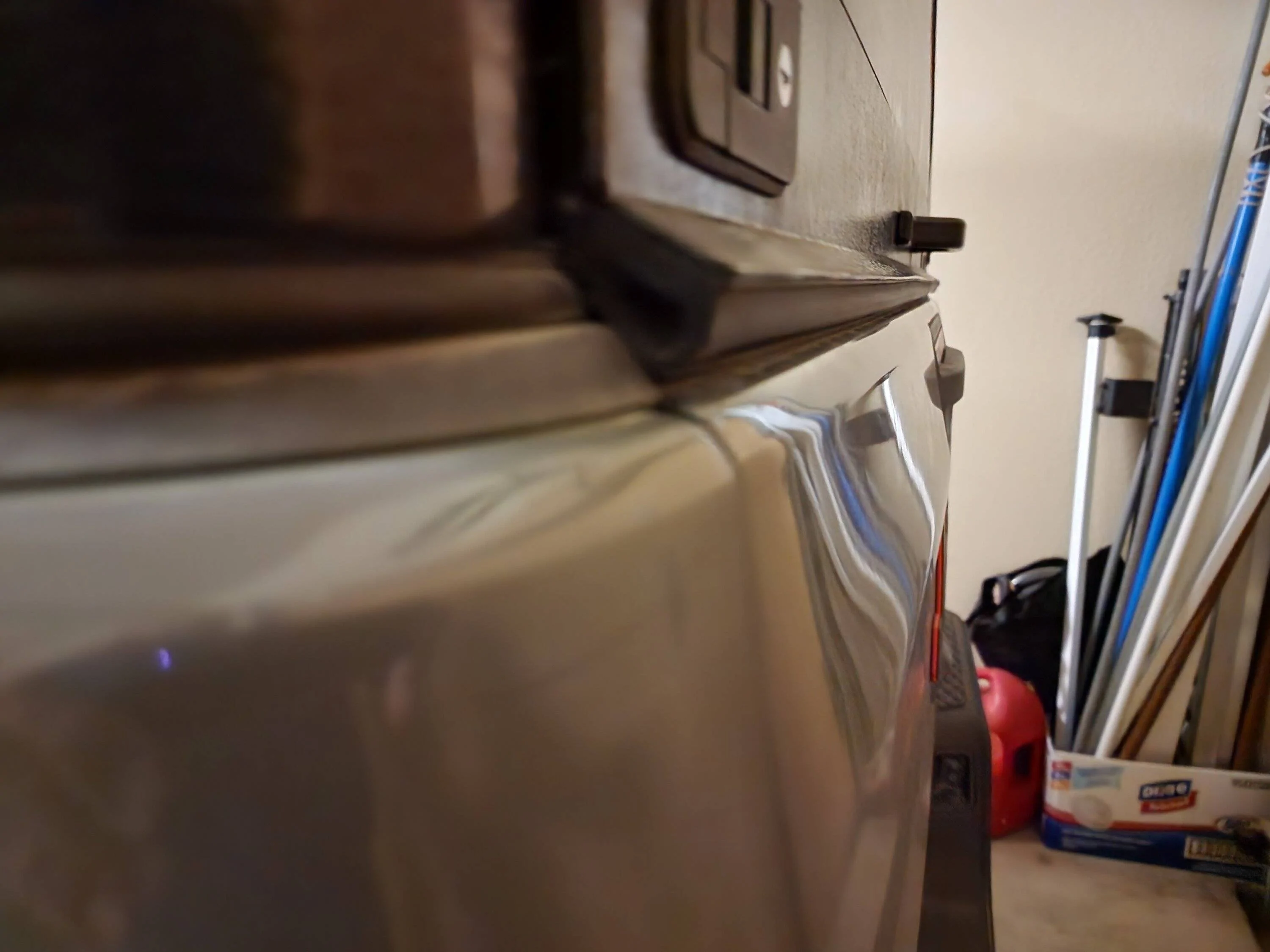

Here are some photos of the RLD Canopy fit. Have had it on for 18 months and several trips to desert. Put a little strip of weatherstrip vertical down side of bed where tailgate closes and a piece of 6" wide bed seal joining the floor and tailgate. Seems to keep dust out very well. Have not had any issues with the fit. Also, I like the steel canopy, as I can attach lights, tarps, etc at camp with just a magnet. Also used magnets to help support the reflectix I put in ceiling and end. Very well built and pleased with it.
Believe ithey said it weighed @ 185lb without windows and just under 200 with windows. I never weighed it.
I like that weather stripping.
Do you have a link for the 6” wide bed seal?
