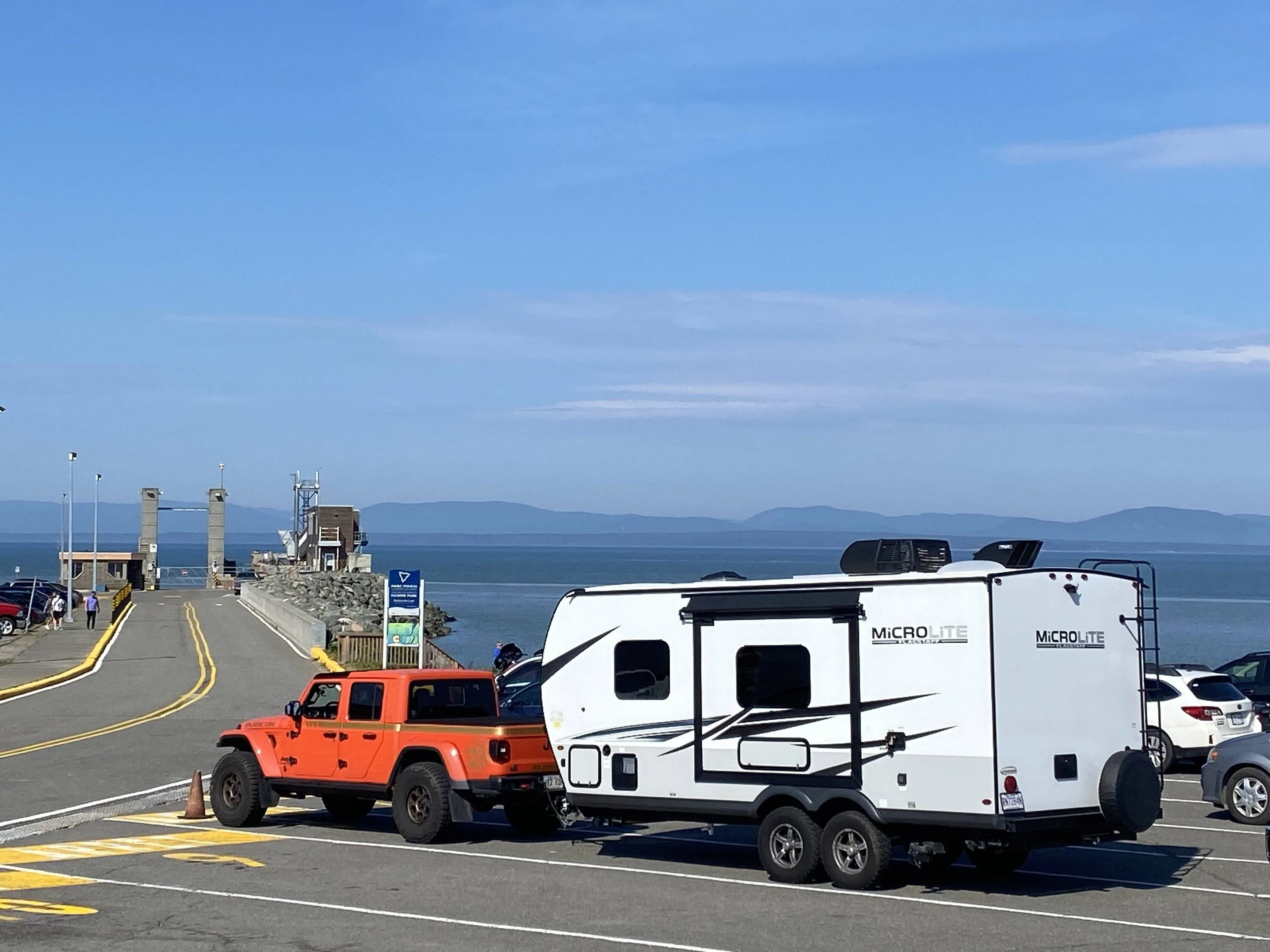

I just got a 2020 Jeep Gladiator Rubicon 4x4, 8-spd automatic with the 3.6L V6, that also has the Trailer Tow Package (Class IV Trailer Hitch and Heavy Duty Engine Cooling). I’m trying to pair this with a travel trailer and while I’ve done the math, I’m worried that I may be pushing the limits with my trailer choice. I would like others opinions/feedback.
The Jeep Gladiator towing specs show:
  • Curb Weight -> 5,050
  • GCWR -> 12,450
  • Max Gross Trailer Weight -> 7,000
  • Max Trailer Tongue Wt -> 700
  • Payload Capacity -> 1,200
I’m looking at the Winnebago Micro Minnie or the Micro Minnie FLX. I’ll give the specifics for the FLX while the numbers are a tad more demanding.
  • Dry Weight -> 4,330
  • Dry Hitch Weight -> 462
  • GVWR -> 5,500
Subtracting out the dry hitch weight, that means I can carry 738 pounds including passengers in the truck.
Again, it seems like I’m within the numbers, but I don’t know if I’m pushing the limits or not. I plan on getting WDH, Sway Controller and a Brake Controller.
What do you guys think? Am I pulling too much?
Same kind of numbers for me Flagstaff 21FBRS you’re ok if not too much mountain passes. Now I have the Ecodiesel pulls better
Jeep Gladiator Am I trying to pull too much? IMG_3366

Thanks everyone for all the information and opinions. It's been a great help. If you care, I've decided I'm going to be looking for a little lighter trailer. I'm hoping to find one that still has dual axles.
