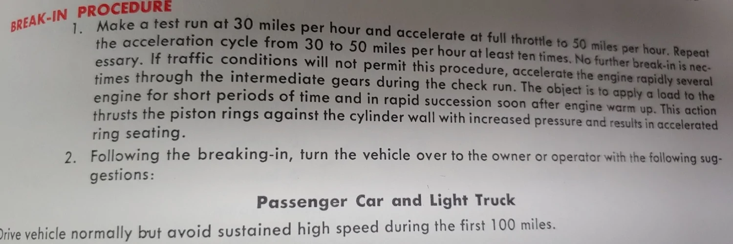

Best thing you can do is vary the RPM and load. Load it up a few times right away and done. Vary the RPM . Don't baby it, don't granny drive it, but don't take it to the track right off the show room floor (although that's less likely to be a problem than babying it)
The stupid part about the cam break-in bit I posted like you get from the major aftermarket cam people since the 1990s is that they say - if for any reason you have to stop the engine within the 30 minute break-in period, you have to start all over from minute 0.
Now how does that make sense? They want 30 minutes, you make it to 22 and find a leak, fix it, and they want you to start over again? I guess I don't get where that comes from.
From an engine rebuilding book from the late 60s-
Jeep Gladiator Another Cam bites the dust... engine-break-in_car

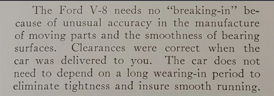

From a Ford owners manual from the late 1950s/early 60s -
Jeep Gladiator Another Cam bites the dust... 1755549733000-iv
