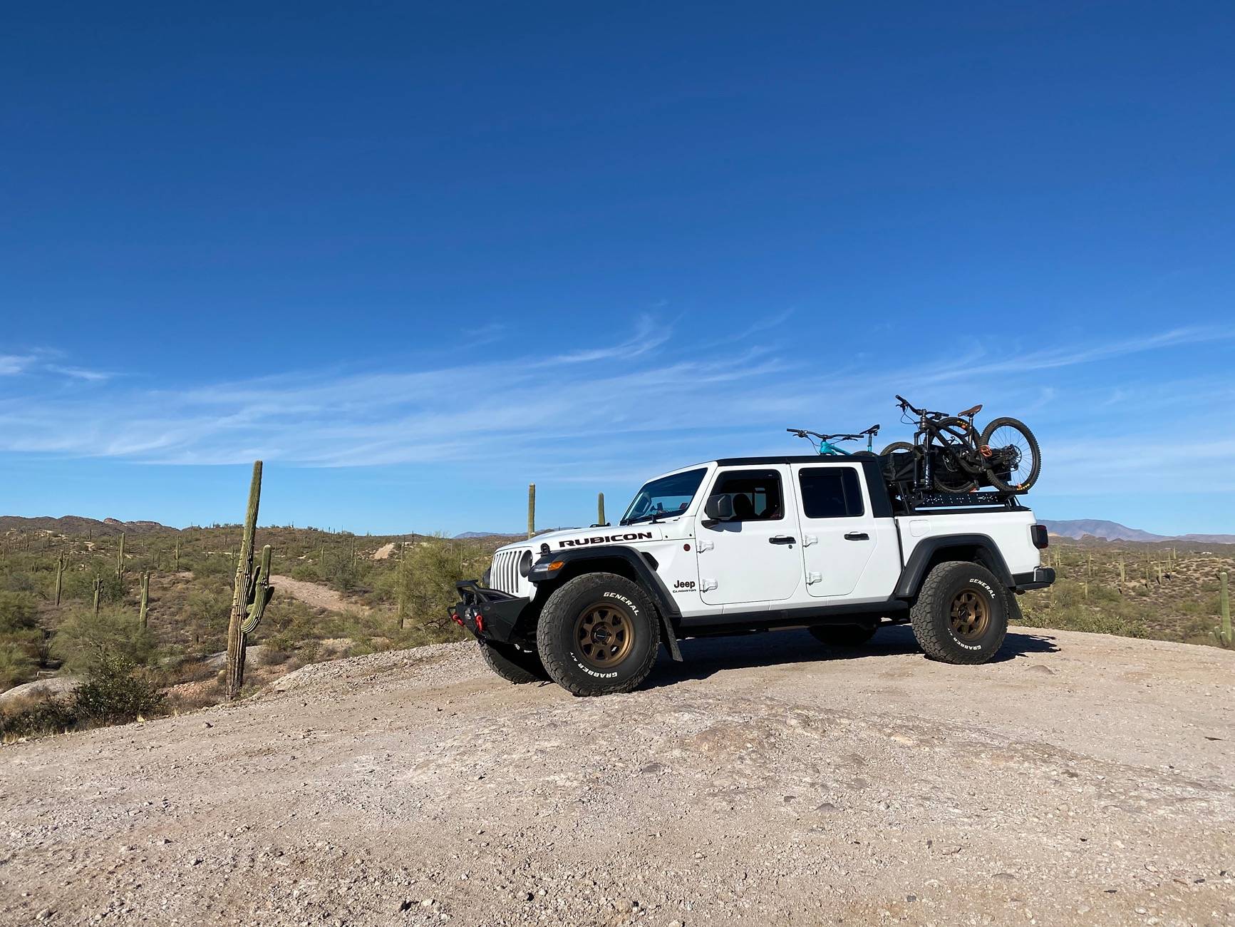

I dunno about some stories as accounted; but my experience was beyond expectation for 37s on a stock rig.

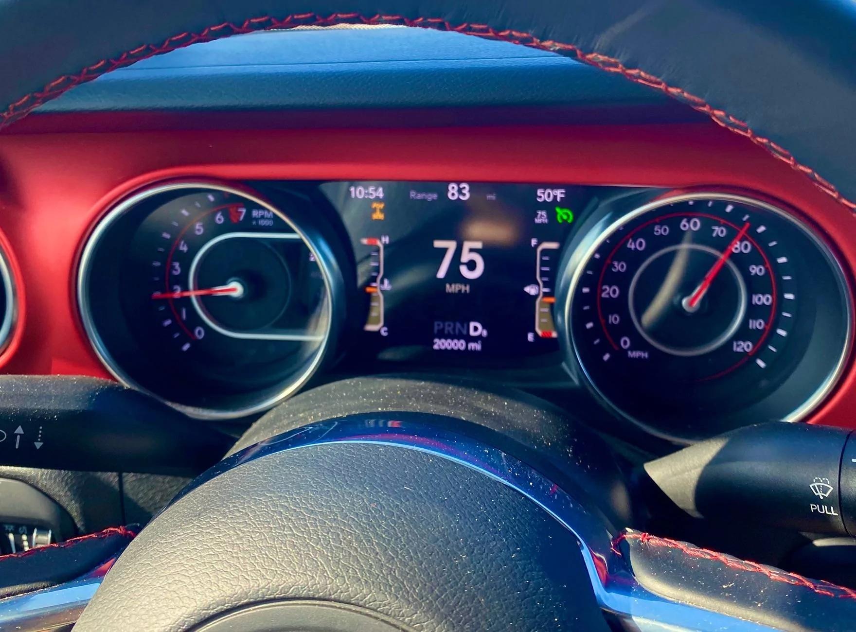

Here's a pic of doing 75 accelerating up an onramp and in 5th gear. I had to take the pick because I had the locked light come on and needed "proof" of the issue existing for the dealership.
And another pic showing how much was in the wind packed out. The the tent and bikes sucked down another 2ish mpgs.
I had a stock JTR on 37's (although I did pick wheels and tires based on weight also) 103lbs for the Methods mounted with Grabber ATXs.
Factory mpgs: 21ish (all mpgs around 55-70pmh) Over 70, minus 1-2mpgs for ea. below.
37s: 19.5
Packed down: 17.5
It was an auto, but calibrated with a Tazer; all was pretty Ok.
I live on a resort at 4.5k, and surrounded by passes about 3-4.5k in every direction with no issues.
Yes, it was a hit to the mpgs, about 2mpgs on flat highway at close to posted limits and 3-4mpgs less at 80+ or when loaded down.
Several XC trips to Az, Utah, and WC, and more. Worse issues, the flats of Tx at 80+. 6th gear was the best it would do and mileage was about 13.5.
Crossing passes though, even coming home through Co; no issues and always stayed up with traffic. Even loaded with rack, tent, 2 bikes and gear needed for off grid 30-day trip.
All said, I plan in the long term to add 4:88s in if I go 37s again.
1) I'll be using heavier tires
2) 4:88s so I can easily drop to 35s if I want and not be over geared.
Haven't driven a manual JT to be educated on one.

Ok, 5th gear in an auto is like 3rd in a manual, so yes 3rd gear will accelerate pretty good too. You can’t compare auto to manual, that’s apples and oranges.
