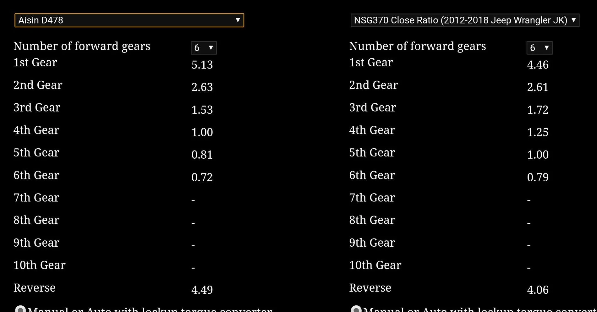

Umm. Point of order. The JT has a deeper reverse than the JK did. I'm no fan of the new forward gearing either (bought the auto) but the JT should be deeper geared than the JK in reverse.

The gearing of this transmission sucks. It's clearly geared for getting the best MPG on the EPA circuit. No one is expecting high performance "wow" out of Jeep truck. I do expect it to do 30 MPH uphill in third gear and maintain speed, it can't. I expect it to be able to back out of my driveway with out stuttering and stalling, it can't. We have two other manuals in the house and they are fine with the same task. The gearing in the JT is absolute crap for anyone that lives where there are hills. It's tough to admit that your $45k trucks transmission sucks but it does. Anyone saying otherwise lives in flat lands or doesn't want to admit it.
Interesting comments. I live at 7,000 feet and mine does fine. Easily pulls steep hills in 3rd at 30, 40, 50, mph. Just finished an overlanding trip with a full load and two guys and it did fine at 9,000 passes. And this was on 35s.
Like you, I wish 5th and 6th were both lower, but I frequently use 6th on the highway.
I do agree that reverse is crap. But it was crap on my JKU, too. If you need to reverse up and kind of hill, or over any obstacle, 4-Lo is required.

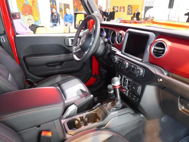

I have been driving manuals since I was 17...from 1970 crap boxes to 2016 C7 Z06's.
Never found 2 that were the same...Never found one I couldn't figure out...Never found one I didn't enjoy.
6 speed Rubicon incoming...No regrets.
6 speed Rubicon incoming...No regrets. View attachment 45481
That's an 8 sp auto pictured...
