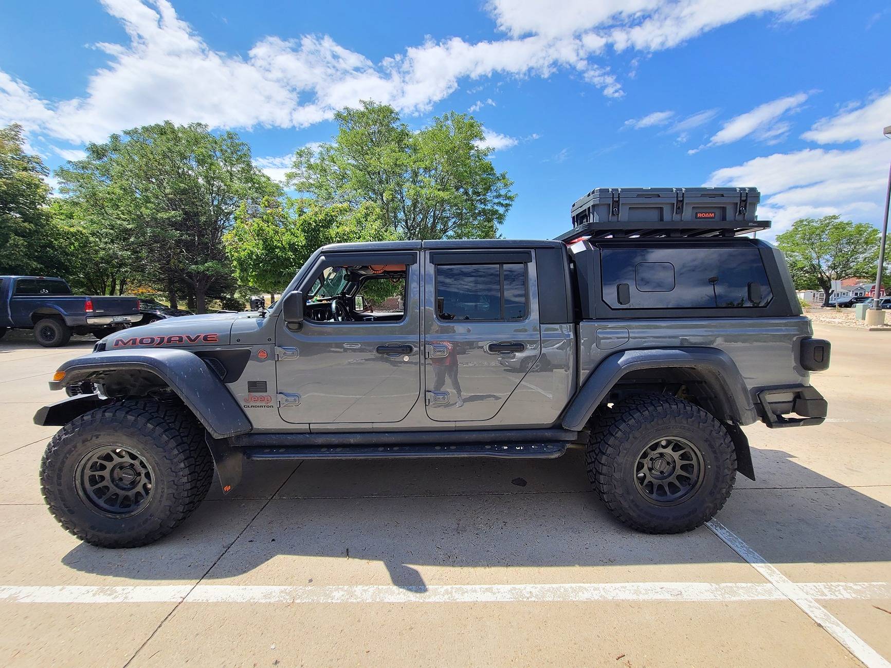

Wanted to give an update now that I've had my Toyo 37x12.5x17R Open Country RT Trail tires for almost 2 months. My mpg has gone up about 1 to 1.5 MPG! Before I would fluctuate between high 13 to mid 14 MPG never even sniffed 15 MPG. Now Im avg about 15.4 mpg with a high of 16.2 which has been a nice surprise. The biggest difference is how much further they coast with no gas pedal. With the MTs the second i took the foot off the pedal was like applying the brake even down hill, lol. Nice smoother, quieter ride with very good grip. The Mojave handles great on those down hill curvy mtn roads, feels really planted for a truck. They have done great on dirt, hard pack gravel and rocky trails, only been out twice. Another surprise is the 4.10 gearing seems fine, a little struggle when going up into the mtns but not so bad where Im like I gotta regear ASAP. I have not loaded it down in Overlanding mode or towed anything so that will be the true test for gearing. I could not be happier with 37in Toyo RT Trail tires!
