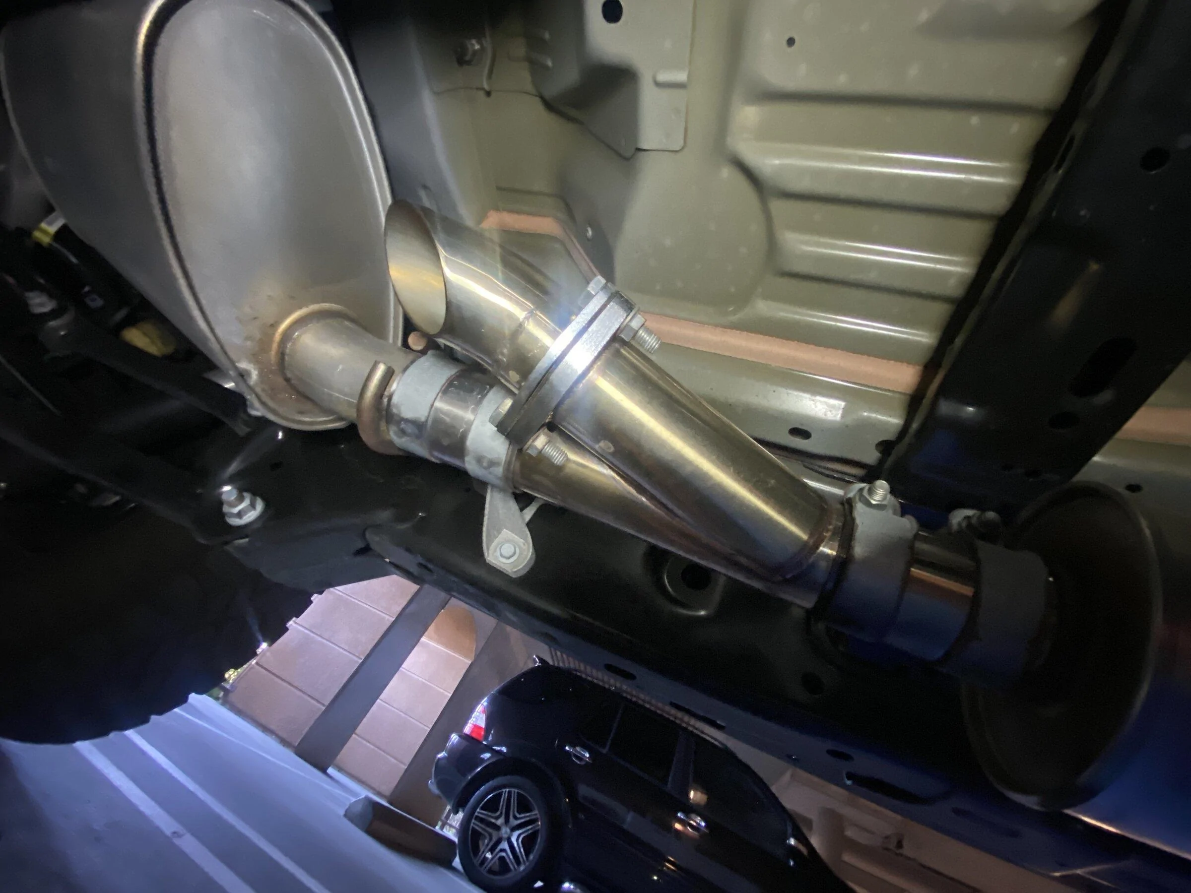

I bolted on an exhaust cut out between the first resonator and the suit case muffler. It basically deletes everything from the rear axle to the tail pipe but can be reverse by simple bolting on the original section of pipe.

Can we see some pictures of your install?

This Cut Out and a silicone plug basically deletes the suitcase muffler and rear resonator. AND if I need to revert to stock configuration I simple remove the two pipe clamps and replace the cut out with the original section of pipe.

Nice, thank you for taking the time to do that. I have one of the 12v powered exhaust cutouts with a remote from Summit Racing that has been sitting in the garage for 6 months while I deal with other projects and stuff thats higher on the list of priorities... this is pretty much exactly where I am hoping to install mine and the image really helps me visualize what Ill be dealing with.

I ran it with the bypass valve for maybe 2 weeks. I realized that I pretty much left it open all the time so I just ditched it and got a turn down tip.

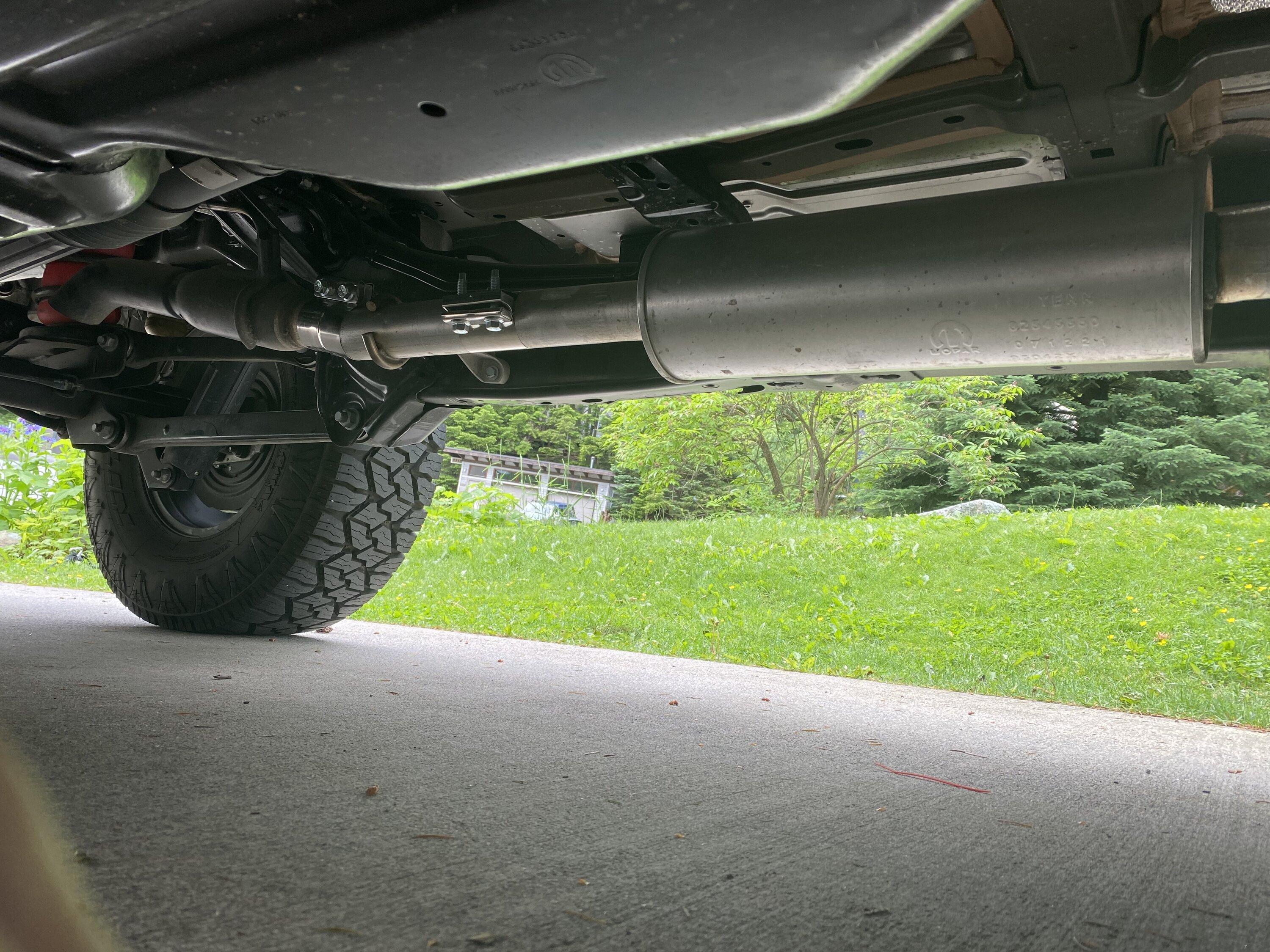

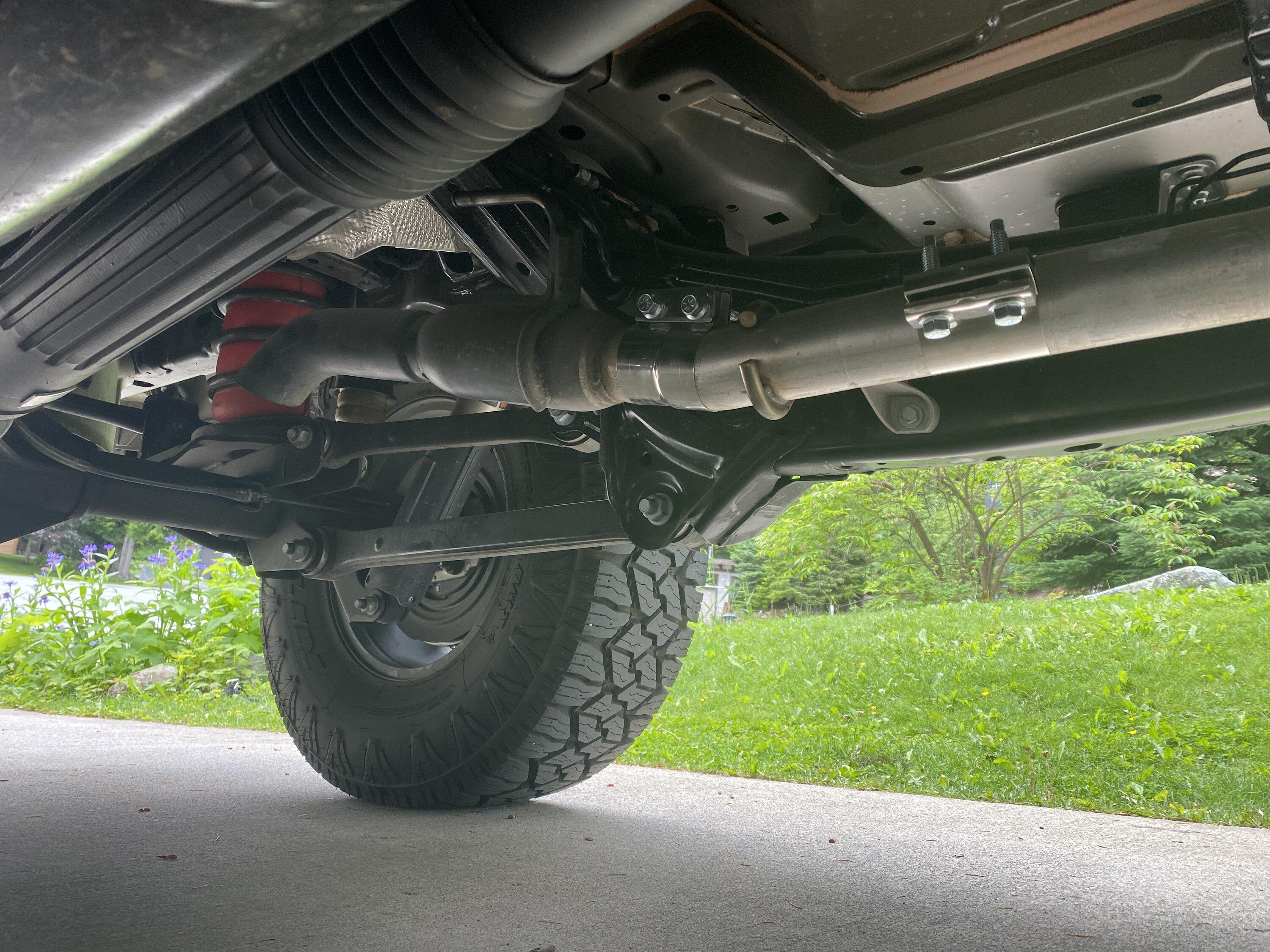

This is what I did on my 22’ Mojave today. Ordered the AFE rock basher 3” I just chopped mine for poops n giggles. Turned pretty awesome! I really like it. The OEM resonator does an excellent job of killing drone. As you can see the 22’ 3.6 gets a smaller rearward resonator tailpipe now.
