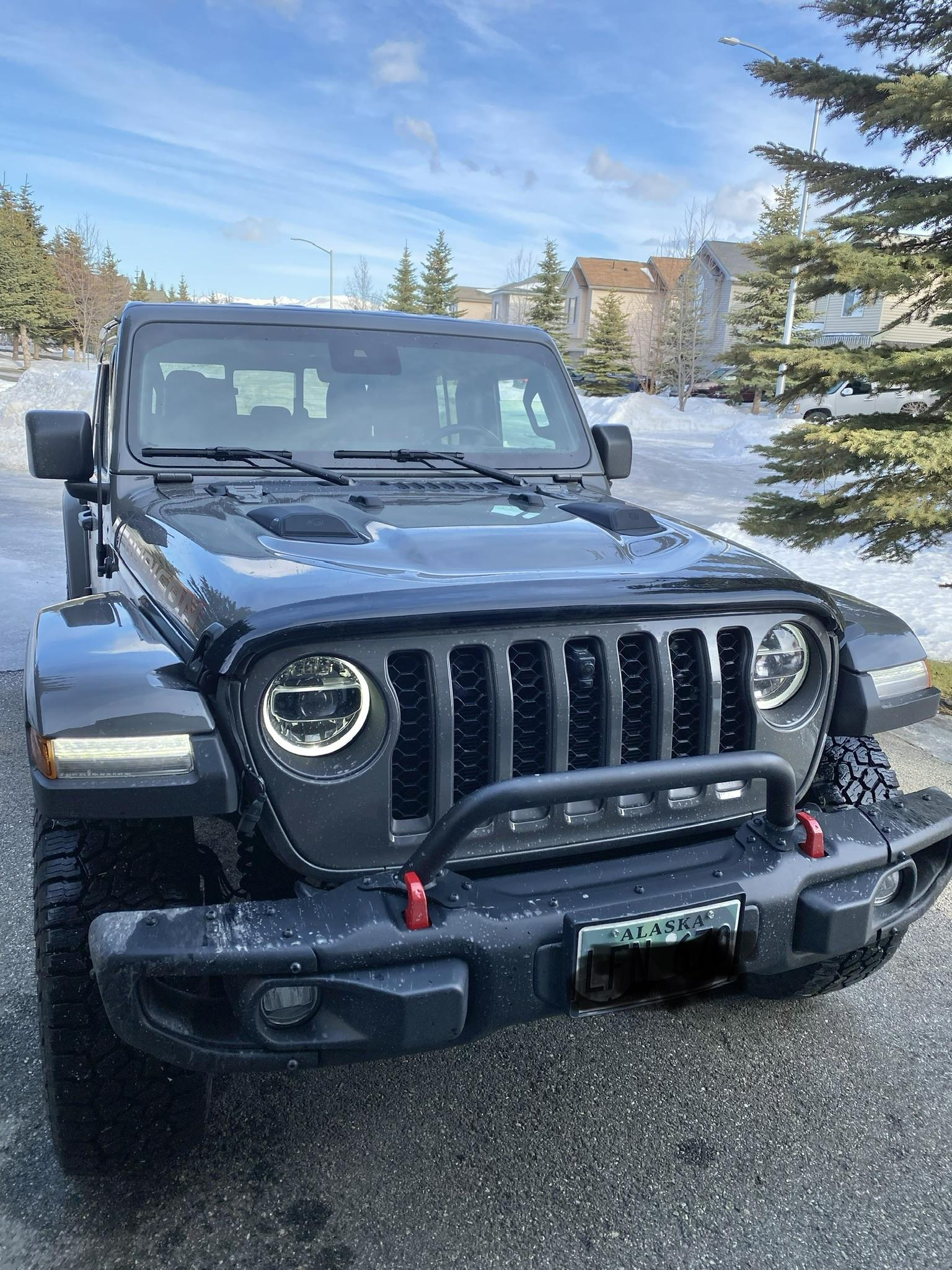

I don’t have much of a problem with over heating up here. I plan on snow birding down in the Nevada and Arizona desert this fall and winter. So to avoid over heating problems I installed S & B air scoops on the hood. They were pretty easy to install.
A guy in another thread tested that, along with a few other ventilation strategies, and none of it seemed to mitigate temperatures. From that thread, he and others were speculating that oil temp is the primary problem. I keep reading these threads to see if anyone has investigated strategies to better cool the oil. I'll be towing a small trailer in CO and I'm already worried about it ?
