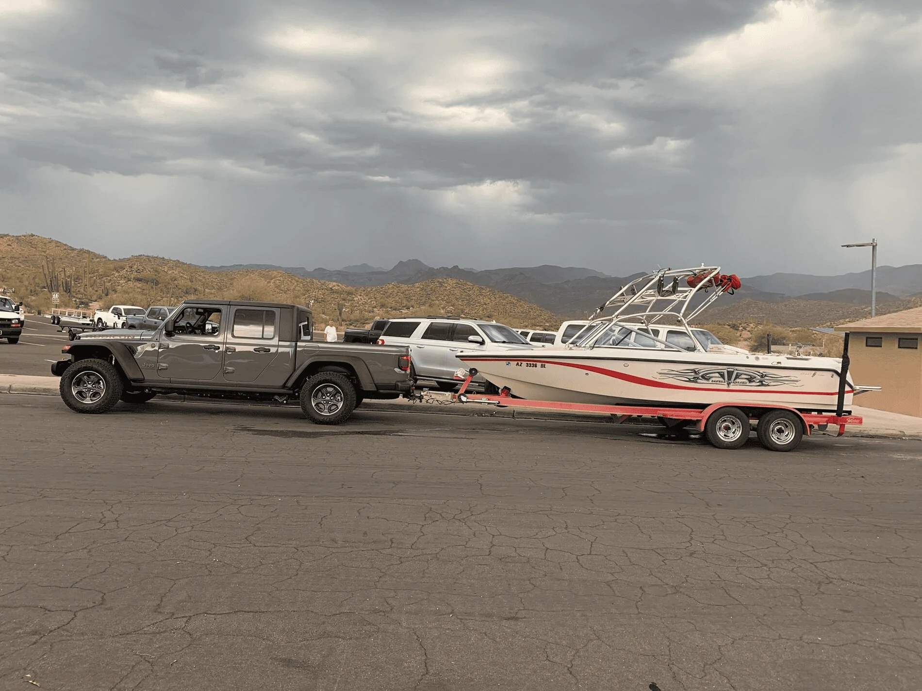

I derated this weekend coming back from Bartlett Lake pulling my 5,300 pound trailer and boat. Oil temp as 264.
