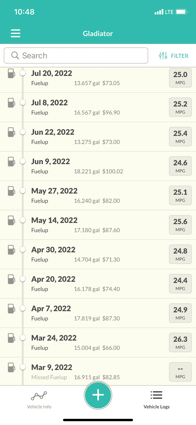

Disagree on the speed component, specifically having to drive below 65 to get in the high 20s on the interstate, in my normal interstate driving I go between 70-75 around 80% of the time, when not passing or slowing for traffic. My mix of highway to city miles is about 70/30 and below is my last 4 months of Fuelly calc mpg, no towing or heavy hauling in this time period. I do agree on the truck setup, wind conditions, and elevation/topography being big factors; although I think the same is true for any engine, maybe to varying degrees, the harder it has to work the lower your mpg.
You are getting that on what, stock tires? I have very heavy 38's so there's the difference. The thing is I would say the majority of JT owners end up increasing their tire size. Hell the thing was designed with bigger tires in mind.
