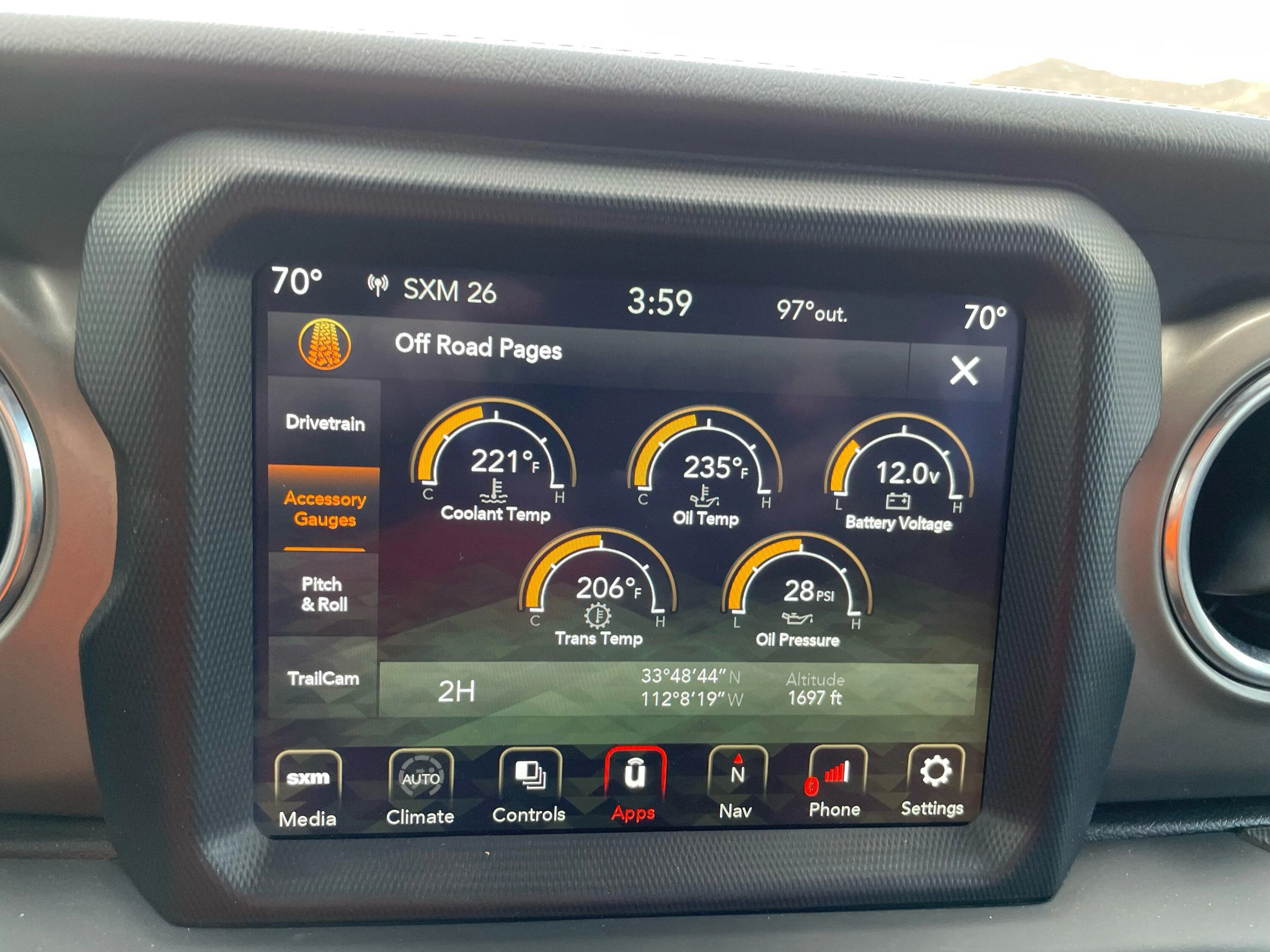

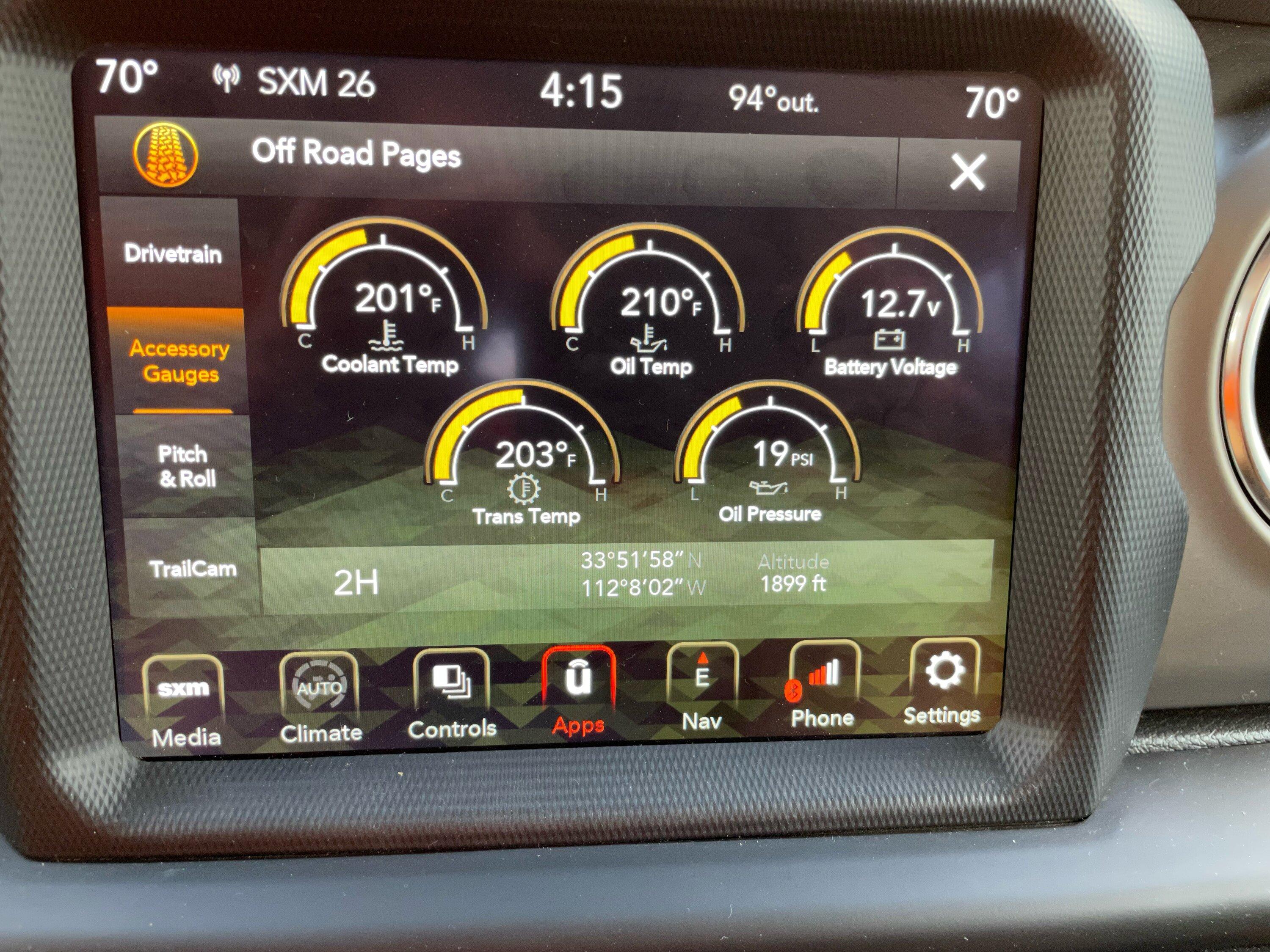

I was driving in AZ a couple days ago, outside temp was 94 and everything seemed about "normal" as far as operating temps go (coolant low 200s and oil about 210). I stopped at a store for about 20 minutes then back on the highway at about 70 mph to head to the hardware store. On the way to the hardware store I noticed the temps spiked under similar driving conditions. Coolant went to 221 and oil to 235. I spent about 15 minutes at the hardware store then back home at about 50 mph.
Not sure why this spiked like it did, but it did come back down, could the stop impact this either time? The other thing I noticed in the two photos is that although the coolant and oil temp varied 20 and 25 degrees respectively, the temperature rings on the gauges are in virtually the same place.

You got a bit of heat soak at the hardware store. You stopped long enough to heat everything up, and nothing had a chance to cool off.
