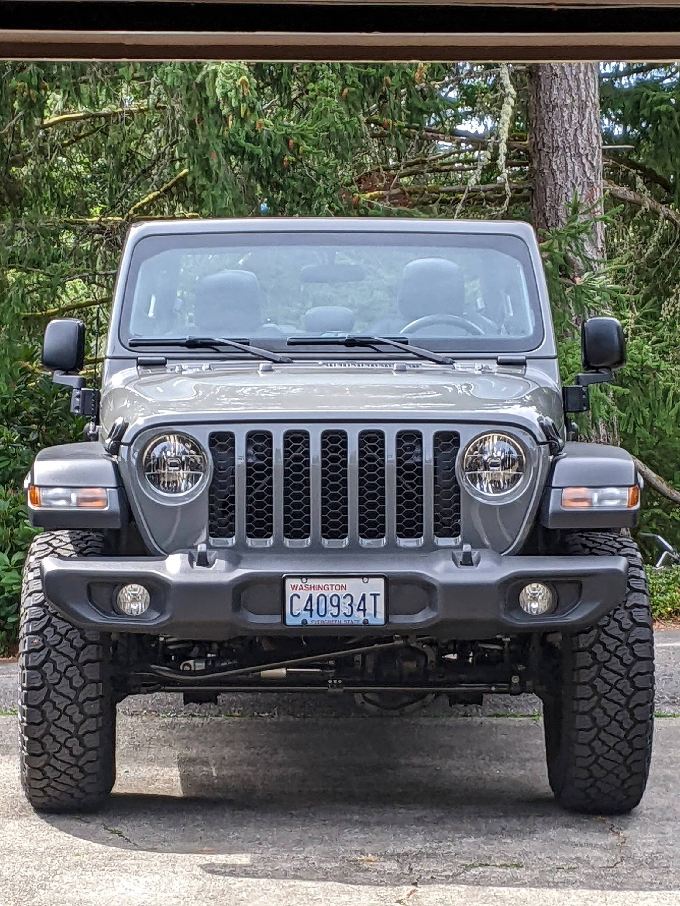

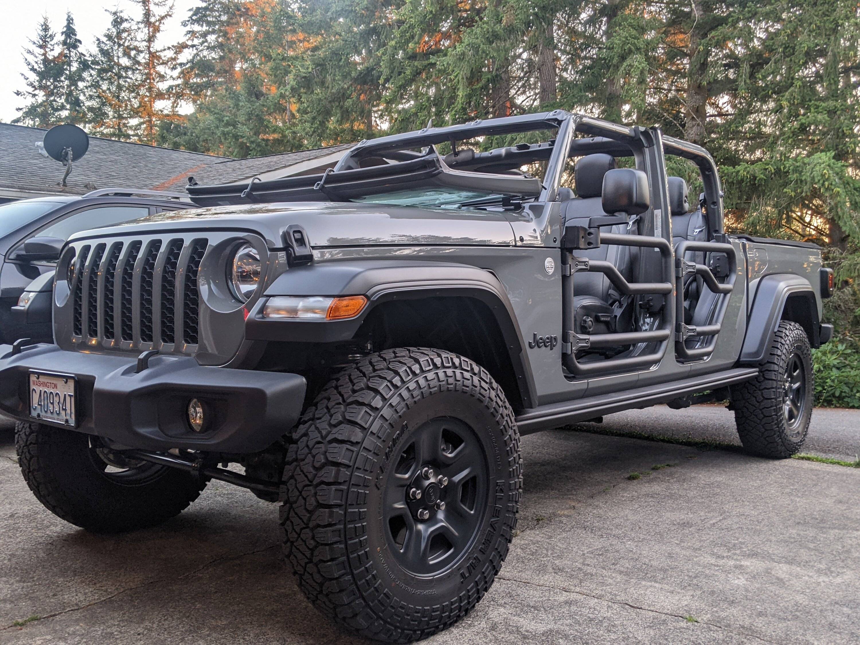

I'm running Eibach in the front. 2.5" and love them. Been on for about 2 years and rides great. So far no sag from when they were installed.
Max Tow so only added the 1.38 spacer in the rear. Sits perfectly level.

Love your rig! Eibach springs in the front or are you using their shocks too?

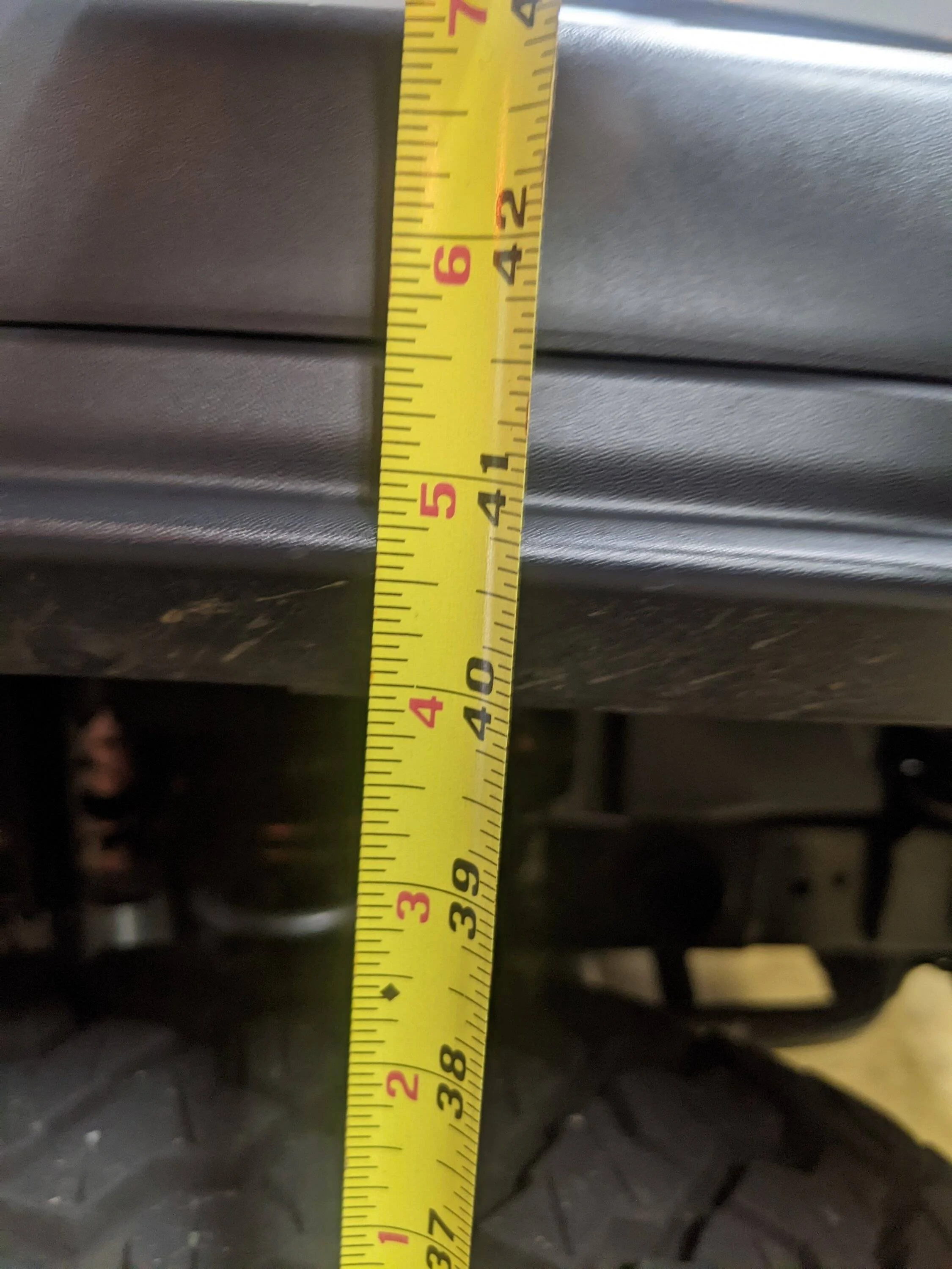

Your Jeep looks great! I actually really like the stance. What did you net in height after you swapped the springs up front out curiosity? Some springs seem to provide more and some provide less than the stated lift.
I didn't measure before. But this is the height now with these springs. Running 35" Kenda tires.

And I'm not certain but I think they were listed as 2" springs. Not 2.5"
