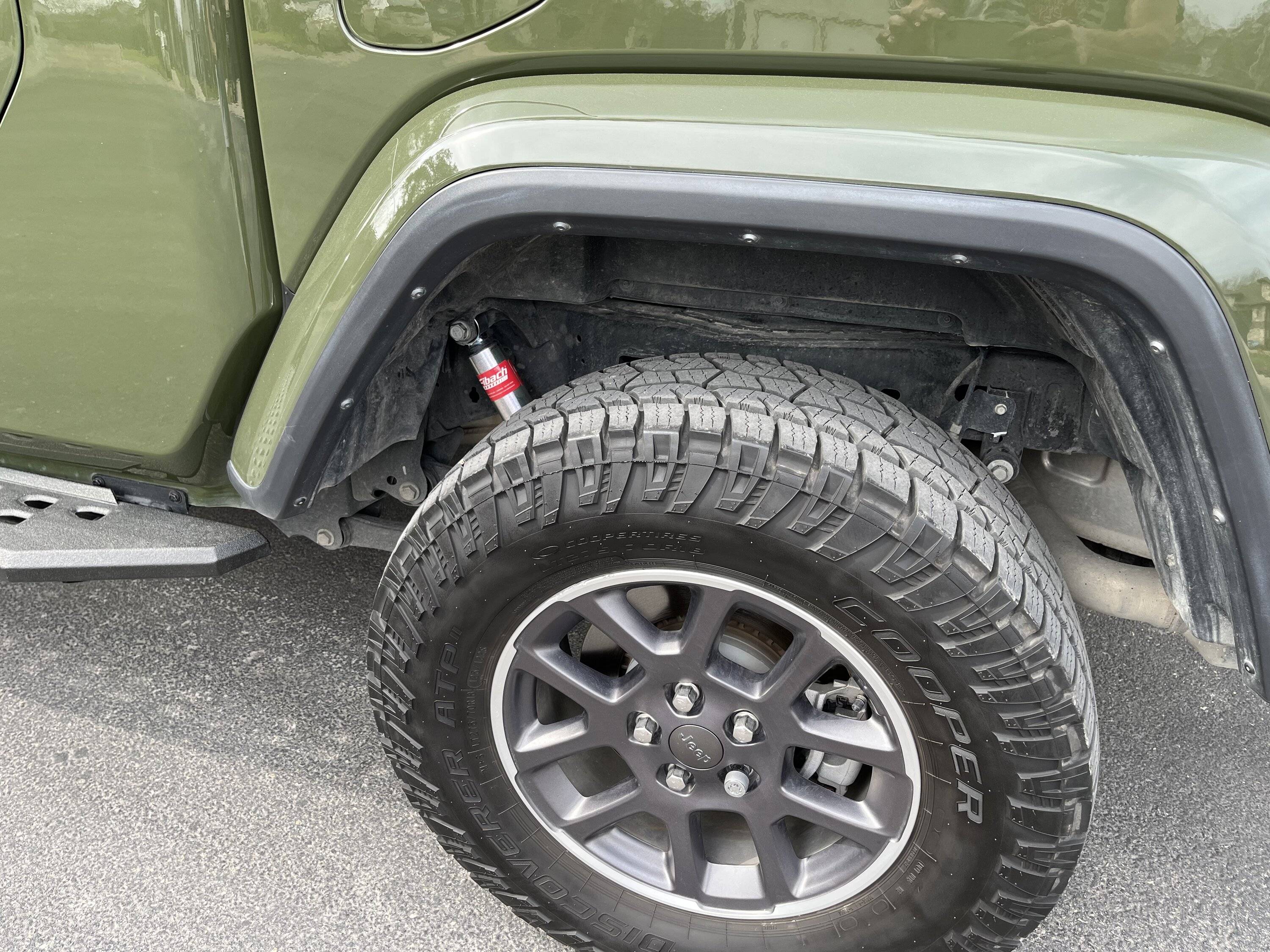

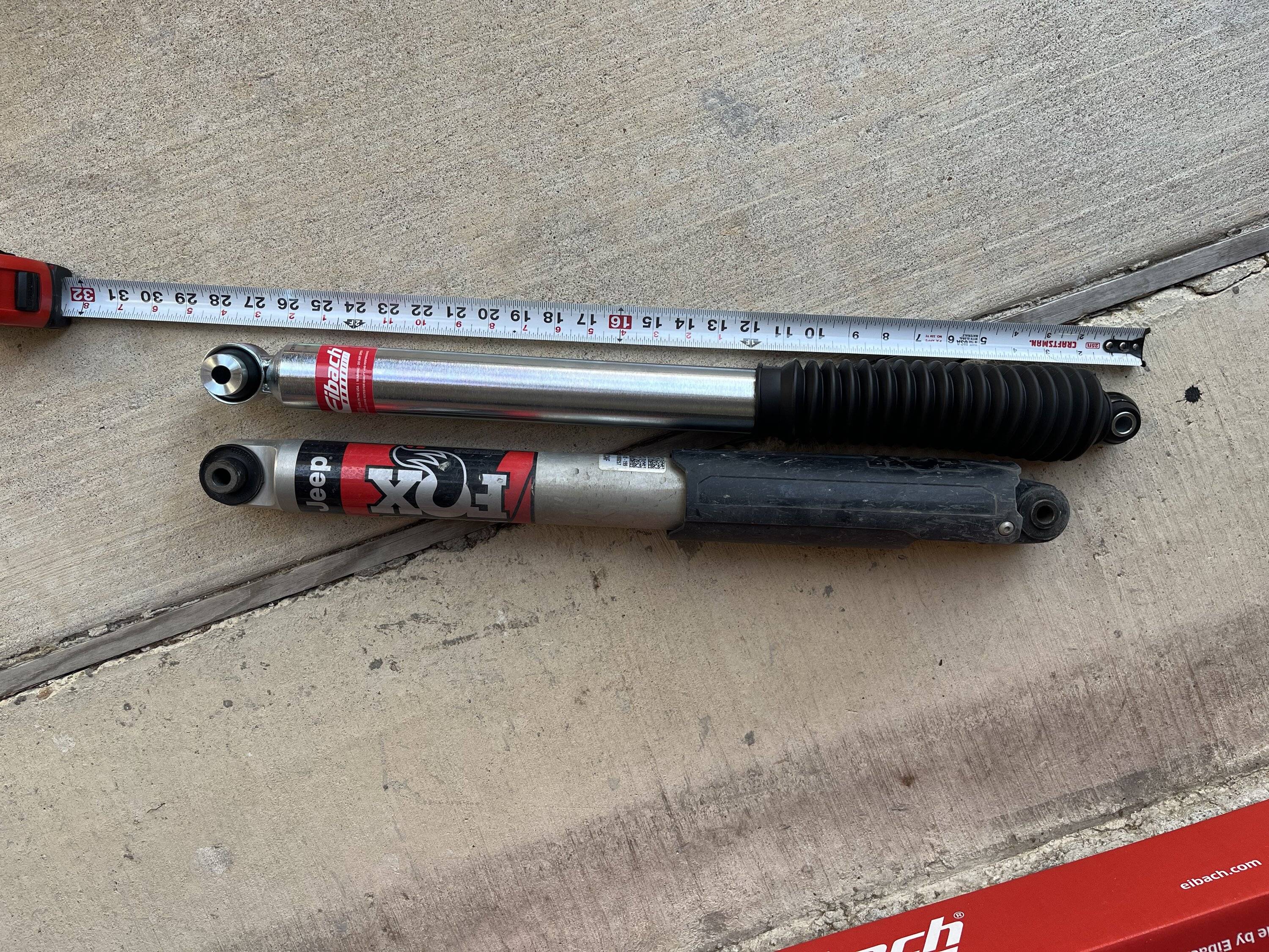

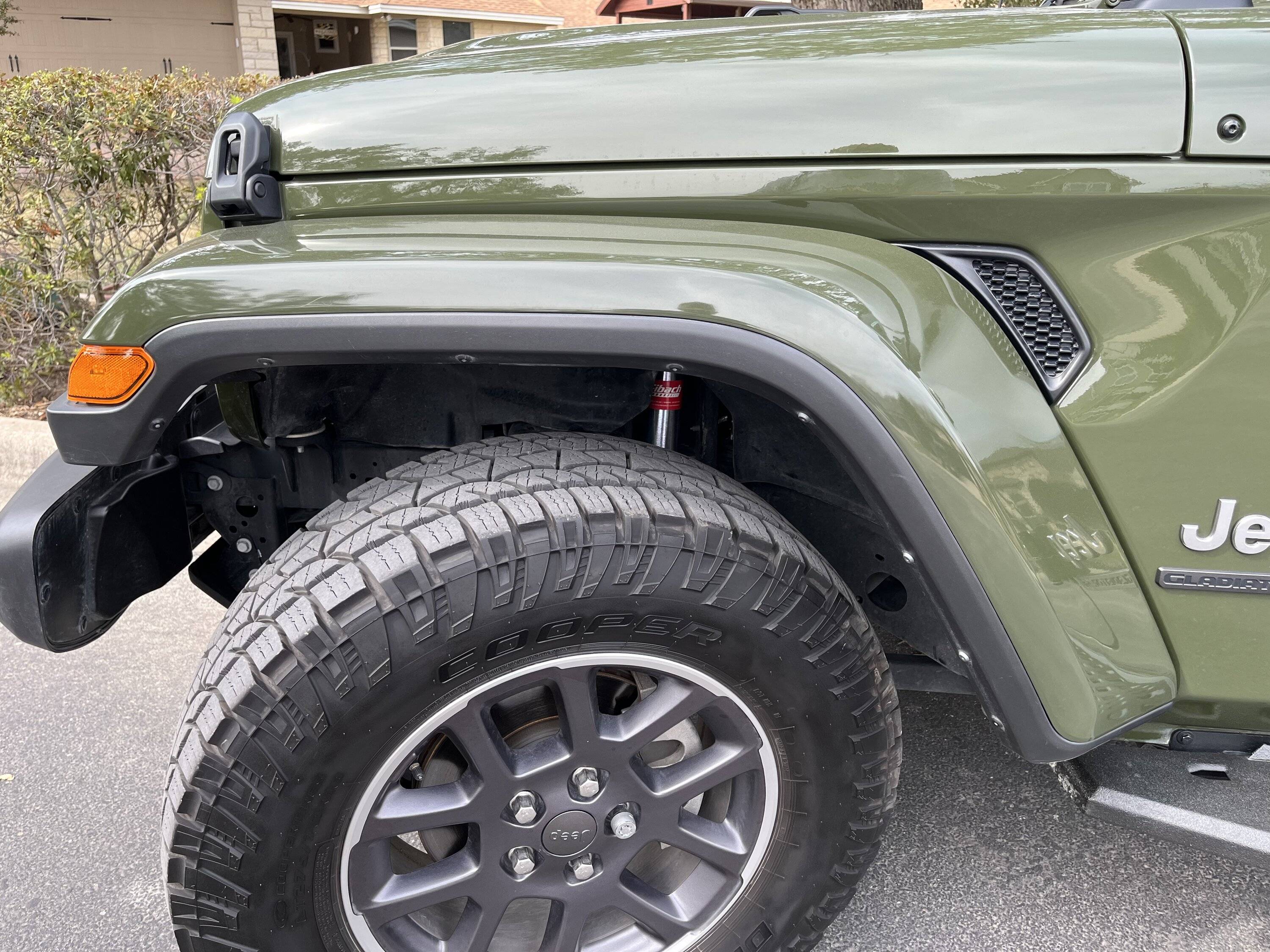

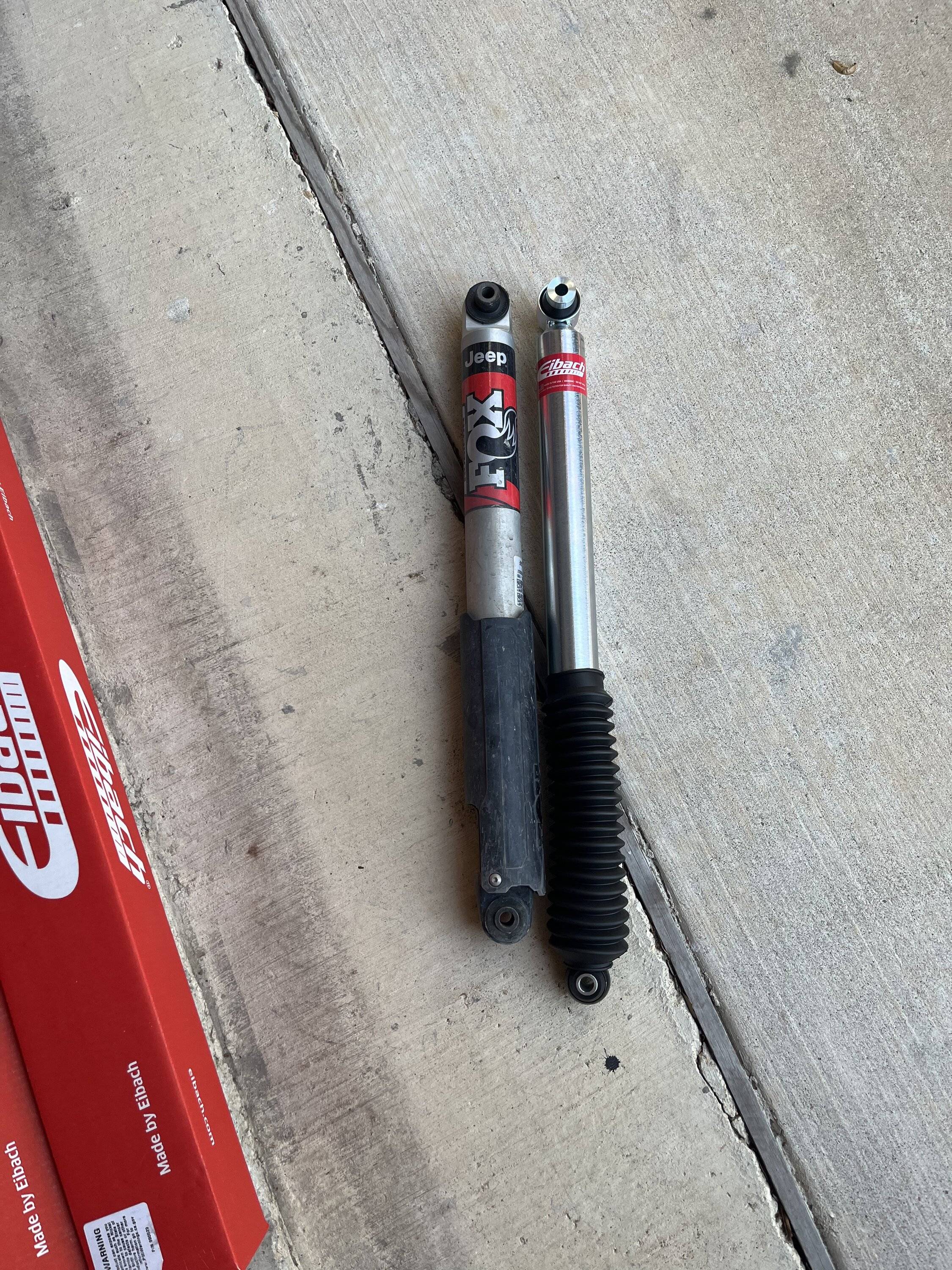

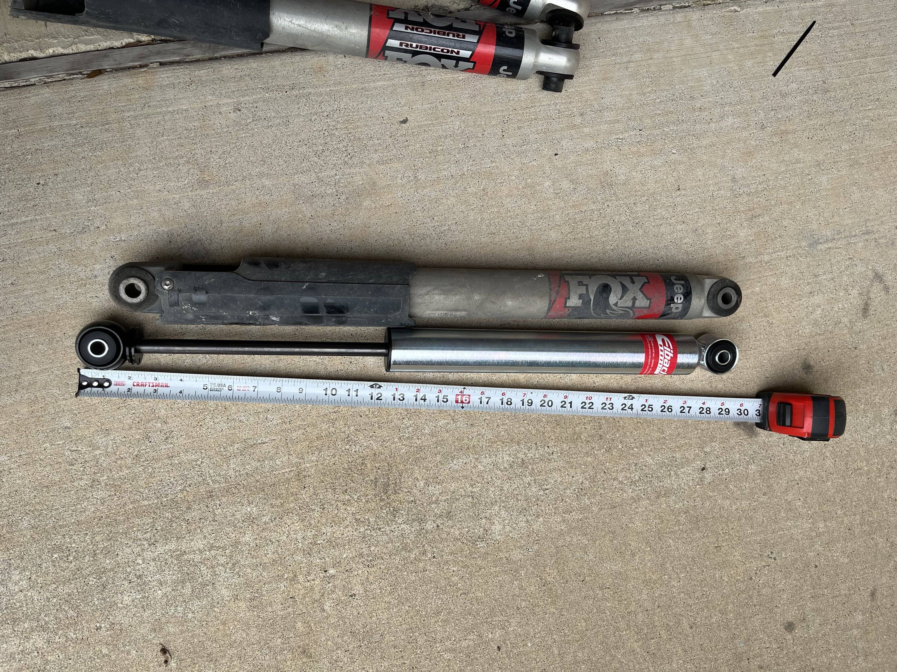

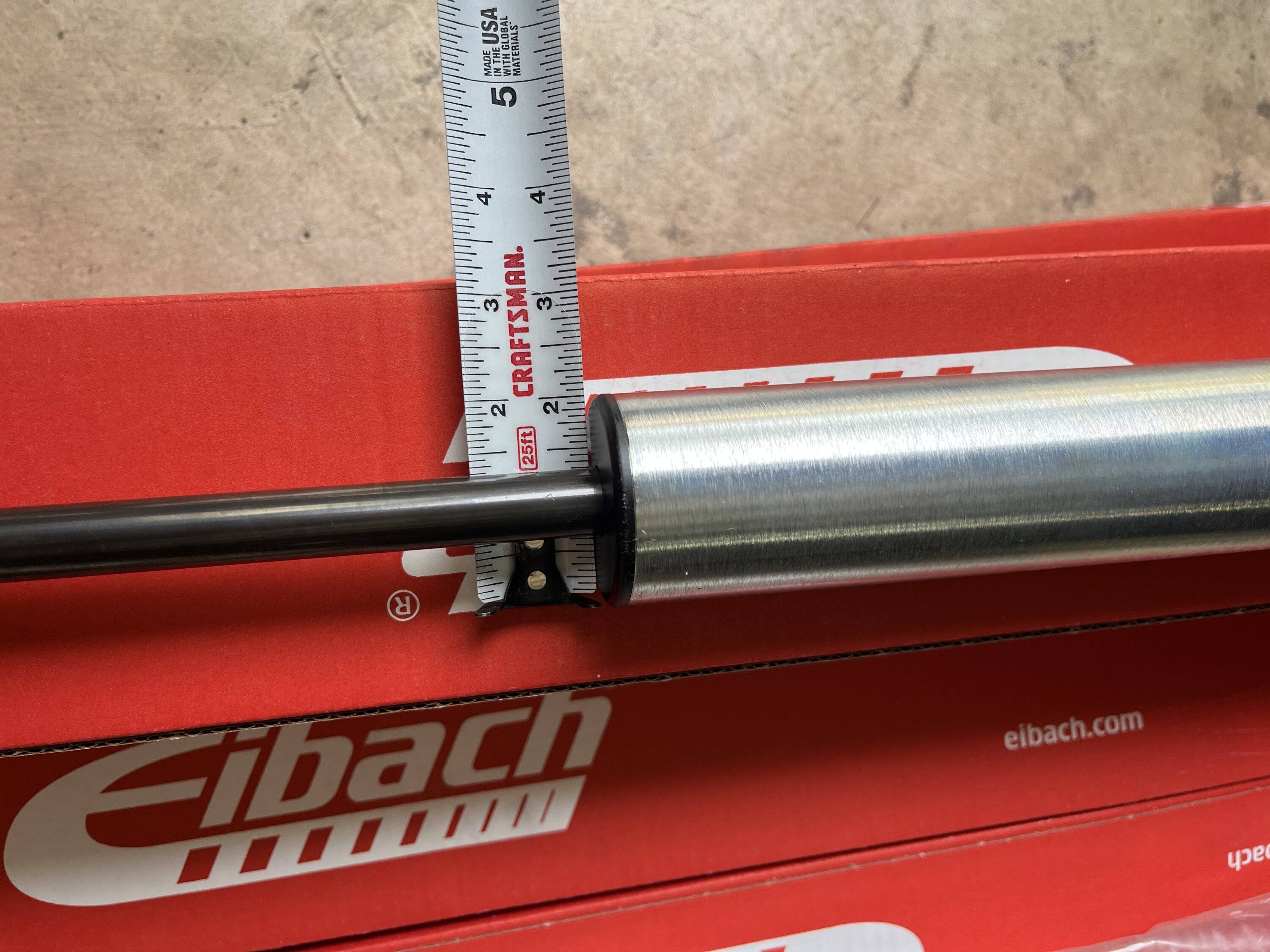

The shocks arrived today via UPS and I promptly installed them. My first impressions is they are really close to the ride I had before on the Overland stock shocks before I switched over to the Rubi takeoffs. The ride is firm and controlled again and honestly feels like the truck is heavier is the best way to describe it. The body roll around corners is mostly gone as well as the boat floating feeling.
These are really what I was hoping they would be. I took a trip down some pretty bad roads around our area and they performed well. On uneven or patched up roads you feel the bumps, but they are not harsh and the bump is dampened immediately. The rail road tracks are a little more noticeable than with the Rubi Fox shocks as are bumps at slower speeds. This is honestly just a little more noticeable and not at all pronounced enough to where someone would tell as a passenger though I think. I'll have to take my wife out and see if she can tell. At higher speeds these really shine and I felt almost none of the bumps and the floating feeling is completely gone and some of the sway is better too. Overall it feels much more planted going down the highway at speed. The biggest difference of all though is going across the swales on a section of road where the road is sinking in various spots. Before with the Rubi Fox shocks I would hit these and sometimes hit the bump stops at 45mph followed by a nice up and down cycle. Now I just follow the contours of the swale and their is no shock cycling at all. I'm extremely happy and they look great too!
