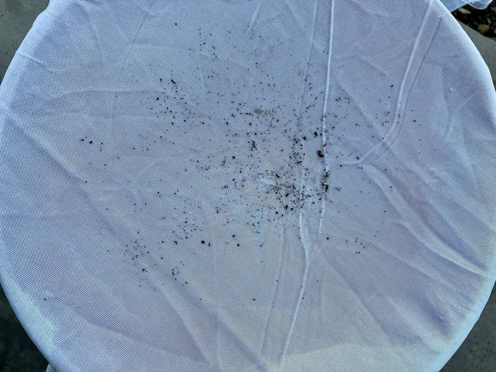

Here’s a reason to do a coolant flush early. This flush was about 10k kms into the second engine.
It doesn’t matter how good your coolant is or how long its life is or even if it can outlive your “lifetime” transmission oil. Manufacturing crap and sand debris in the system doesn’t do any engine any good. If some of you are inspired to do a flush after seeing what I had, screen your captured fluid like I did and post what goodies you found!

Yep; I’m not a fan of trusting the long-life promises; I see those as an upper bounds in happy-path conditions. I’m no expert on coolant, but I know that changing the coolant is cheaper than replacing corroded head gaskets ( and a heck of a lot easier too ). Those fluids can become corrosive over time. Combine that with filter pics above, along with any possible contamination or gelling, and in my mind it makes a heck of a lot of sense to change out that coolant at 70k to 100k; I can only hope that would help to prolong my water pump too. I’m NOT doing the garden hose approach either.
