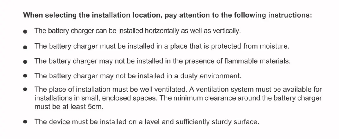

The manual specifically states that the dc charger and battery not be put in the same compartment because it could be a fire hazard but if you dont care, to each their own.
Agreed but some additional information is my battery is a LiFeSO4 battery, so it doesn’t have any gasses as it is sealed and also is not a “flammable material”. I’m no expert but I thought I was adhering to all the info in the manual. If I missed something please let me know.
Below is the what I was following from the manual
Jeep Gladiator Anyone using a Dc to Dc charger for a second battery? 7A6FC25C-1250-4F8C-AA15-3D1FF883D7C0
once again. I’m not an expert so I do appreciate the criticism and forcing me to circle back ??

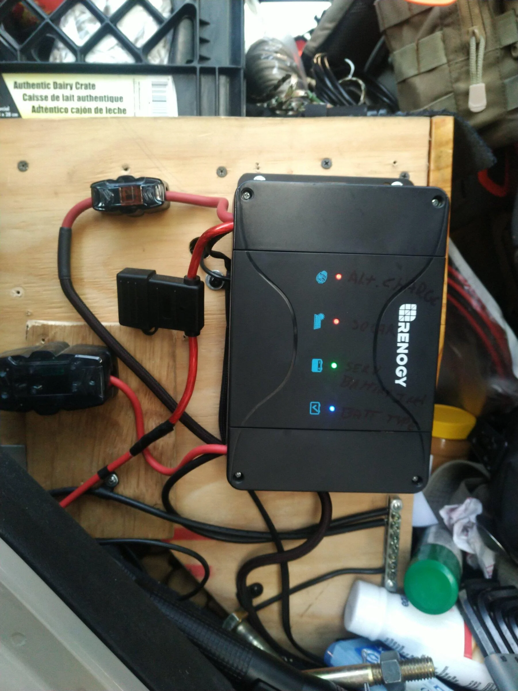

Some cheap buzzbox welders use the same guage of wire as I used but lower quality.
The wiring looks kinda jacked
Jeep Gladiator Anyone using a Dc to Dc charger for a second battery? IMG_20220404_183257
The wiring does look jacked up but open to air and ventilation.
